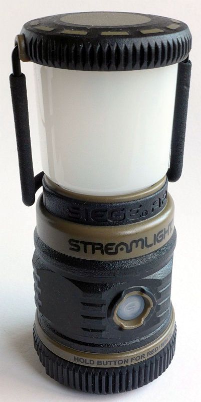

    Taking a more detailed look:

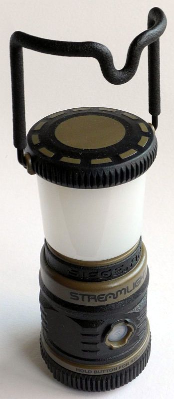

    Normally folded down around the body, the carrying handle / hanging hook is show in the upright position
    A feature of the Siege lanterns is the ability to remove the top section with the diffuser. The top diffuser is attached with a bayonet fixing so requires only a quarter twist to release it.
    You can then hang the Siege AA using the folding clip found in the base. Overall this makes the Siege AA smaller and the light more direct. This is reflected in the output figures giving the full output. (the diffuser results in a 45% loss of output)

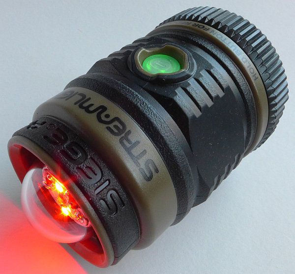

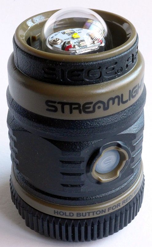

    This is a closer look at the dome covering the LEDs. One central white LED and two red LEDs either side of this.
    To show the switch illumination, here the Siege AA is on the red output mode. The switch illumination acts as a battery power meter. Going from Green (as shown) to Yellow, to Red as the cells become depleted.

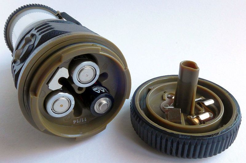

    The battery door is keyed to allow it to be refitted in total darkness.

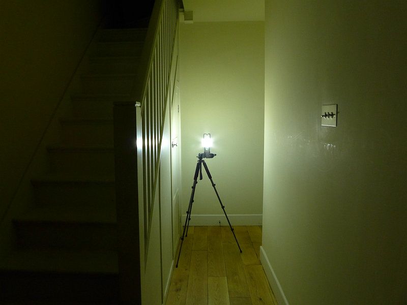

    The beam

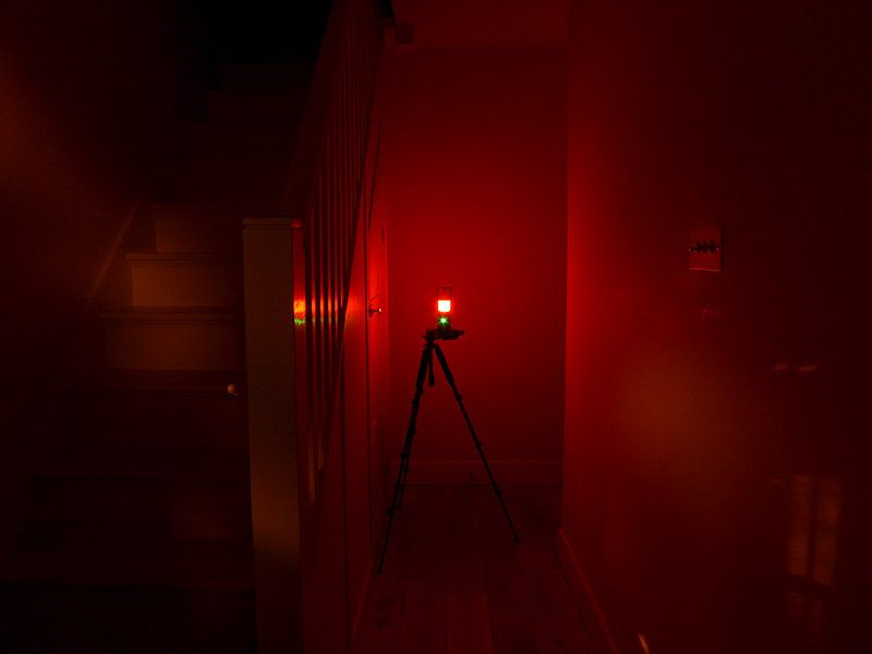

    Being a lantern, its beam pattern is that of, well a lantern. You can see the diffuser creates a lovely even spread of light.
    The red output is also nice and even, and here the exposure has been adjusted to show the light. Red output is very dim compared to the white, so do not take this image as representing the White vs Red output levels.

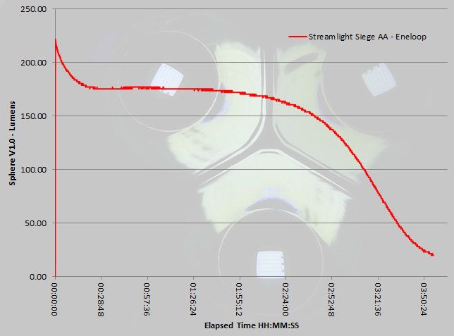

    The Siege AA runtime trace was carried out using 3x 1900mAh Eneloop cells on High White output.
