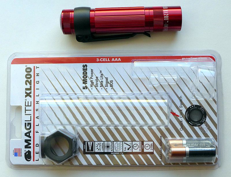

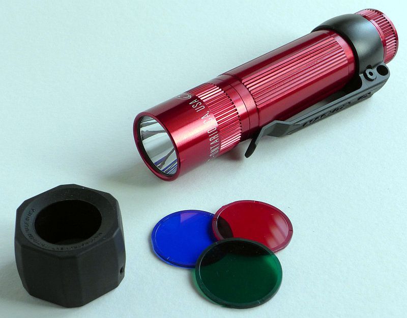

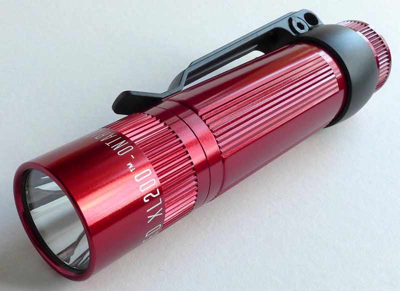

    MAG-LITE's newest XL Series light is the XL200. It uses the same "QuickClick" interface as the other XL lights, but also incorporates motion controlled functions.
    The light on test here was a display sample at SHOT SHOW, so the photos may show some signs of use.
    Taking a more detailed look:
    The XL200's blister packaging had already been opened when I got it and the pocket clip fitted. The package also includes a set of coloured filters and 3 Duracell AAAs.
    The clip is sturdy and a nice 'pocket-safe' plastic.

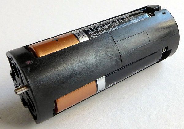

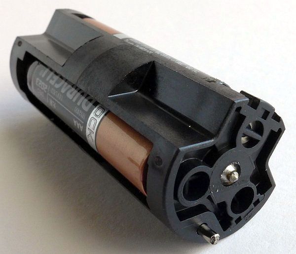

    The tailcap off and battery carrier taken out.
    The head-end of the carrier has two contacts.
    The tailcap end of the battery carrier has three contacts. There the central pad is the positive and the ring around it is the negative.
    There is a moulded arrow on the side to remind you which way it goes into the tube.

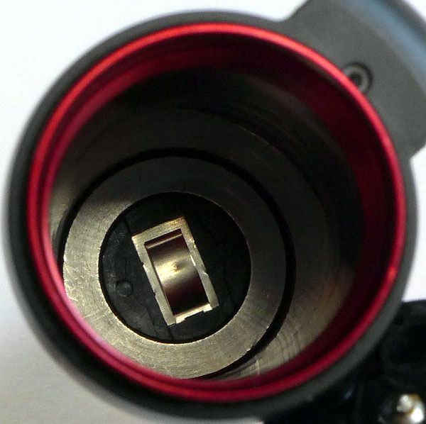

    The tailcap has two pin contacts and a contact ring. The grooved scratched into the contact ring looks like damage caused by someone inserting the battery carrier the wrong way round as the pin on the correct end is very smooth whereas the pin on the head end of the carrier could cause scratches.
    At the head end there are the two contacts to match those on the battery carrier.

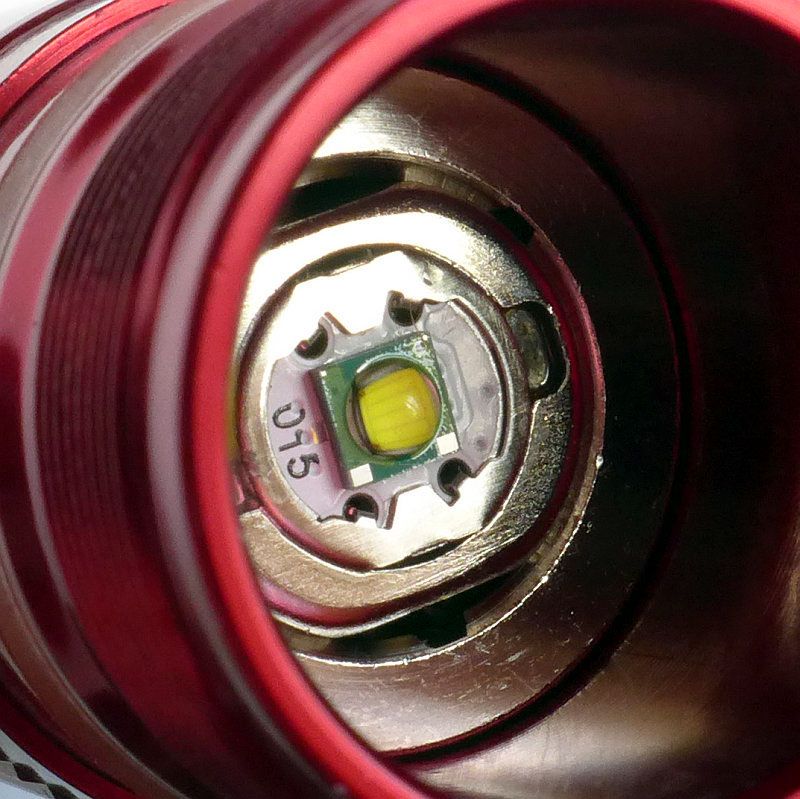

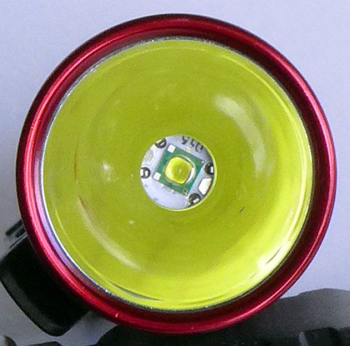

    Looking down into the focus adjustable reflector at the XP-G LED.
    And after removing the head and reflector the LED can be seen more clearly.
    The threads are super slick MAG-LITE quality and the o-ring is a special shaped one.

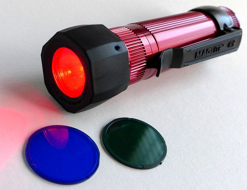

    Red, Green and Blue filters are included with a slide on filter holder.
    The filter holder acts as an anti-roll feature if you didn't have the pocket clip fitted.
    For an idea of size, here is the XL200 amongst a batch of lights on test.
    From left to right these are: Olight S10R, Olight S15R, Olight S30R, FOURSEVENS Bolt-Action, FOURSEVENS Preon P2, FOURSEVENS MMU-X3R, Streamlight ProTac HL3, MAG-LITE XL200, NITECORE TM06, Lumintop ED20-T, V54 DC25Cvn and the Streamlight Siege AA.

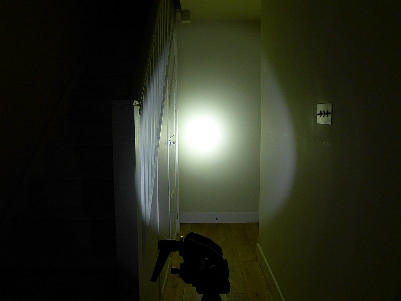

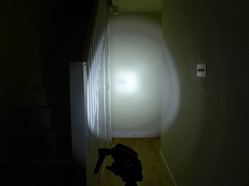

    The beam
    In the tightest focus, the XL200's beam is quite narrow with a bright hotspot.
    Like most other MAG-LITEs, the XL200 has an adjustable focus allowing the hotspot to be opened out to put more light into the spill beam. This has the unfortunate consequence of introducing a lot of artefacts and rings into the beam, but is effective at spreading the available light over a larger area.
    Outdoors the XL200's limited output becomes more apparent as the central hotspot is the only area of the garden that is lit up.

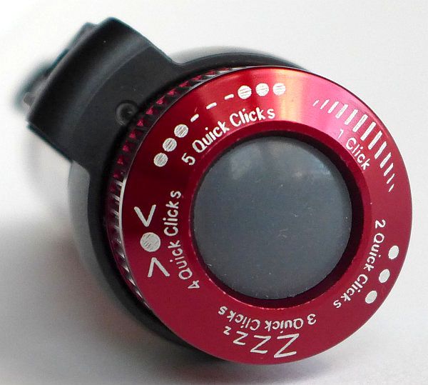

    MAG-LITEs XL200 has a few tricks up its sleeve. Combining the "QuickClick" interface with motion controlled functions.
    On the tailcap there are a few reminders as to the functions available.

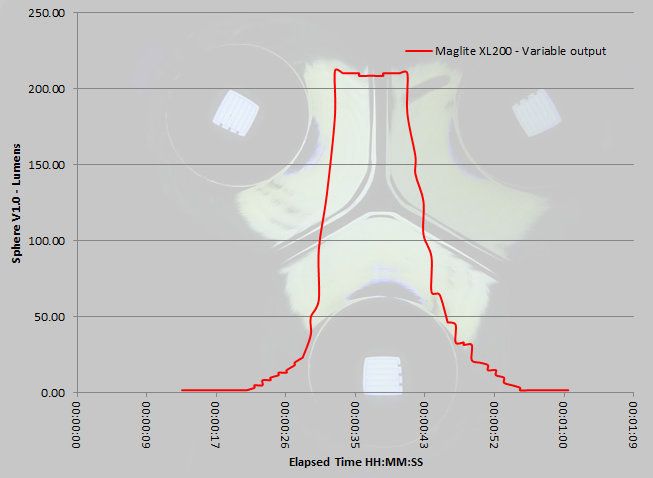

    Main Beam Brightness - Holding the XL200 level (or at a slight angle off level), press and hold the button. Now, while holding the button rotate the XL200 and you will change the brightness. Once you have the level you want, simply let go of the button to memorise this level.
    This level is then used for the Main Beam, Strobe, Signal and SOS
    Using the integrating sphere to measure the changing output, rotating the XL200 at a consistent rate, the output varies as shown here.
    There appear to be a set number of steps which can be seen more clearly as the output decreases in the right hand side of the graph.
