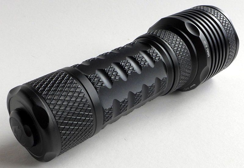

    The model is neatly engraved at the base of the head.
    The charging port cover is very low profile (you might even miss it if you didn't know this had one) and here is unscrewed and drawn back to show the charging port's micro USB connector which is next to the charging indicator light.

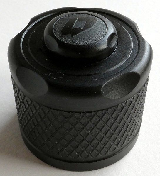

    The FOURSEVENS logo is moulded into the tailcap switch.

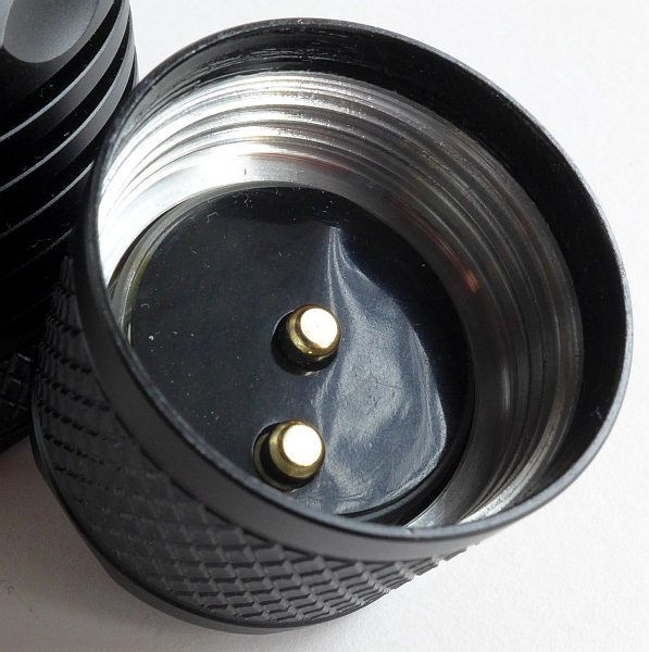

    The tailcap has three contacts – the threads, and two sprung posts.
    Though you don't really need to take off the tailcap as the MMU-X3R has built in charging, the threads are nicely cut square threads.

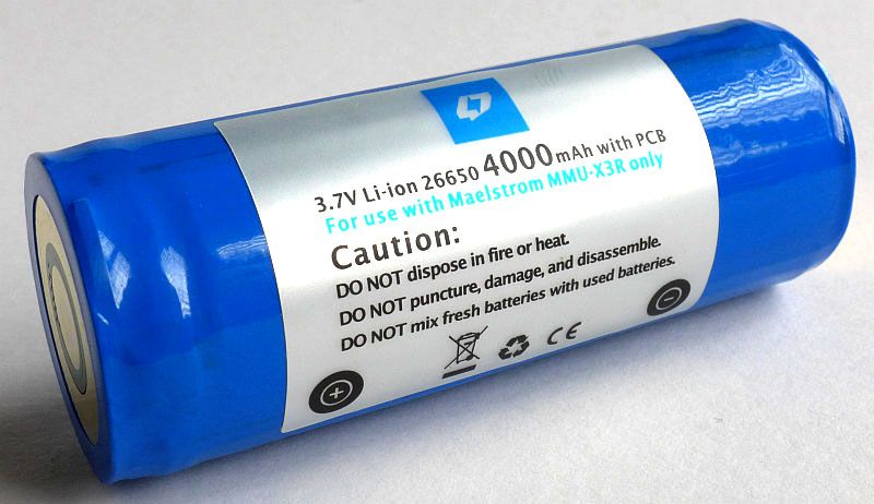

    Powering the MMU-X3R is a proprietary 26650 with a double contact at each end.
    This is the tail-end double-contact of the 26650 cell. You can also see an arrow indicating which way to fit the cell. Despite other lights where the cell has twin contacts each end not minding which way round it goes, for the MMU-X3R it does matter which end is inserted first. Always ensure the arrow points towards the head. It won't damage the MMU-X3R if inserted the wrong way round, but it will not function if you do.
    Inserting the cell the wrong way round can actually be used as a lockout facility for travelling.

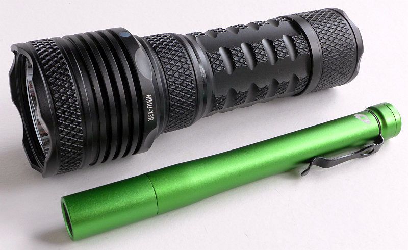

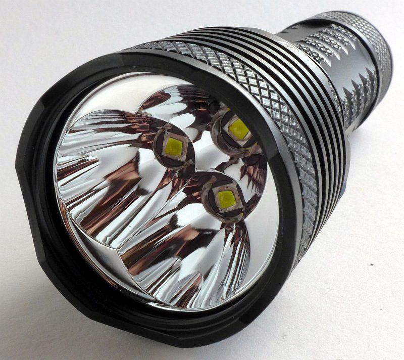

    With three XM-L2 LEDs in a compact head, the MMU-X3R has a compound reflector.
    Now for the size - this is the MMU-X3R next to the Preon P2. The Preon is a 2x AAA light so is very small. The MMU-X3R is a compact light.
    For a further idea of size, here is the XL200 amongst a batch of lights on test.
    From left to right these are: Olight S10R, Olight S15R, Olight S30R, FOURSEVENS Bolt-Action, FOURSEVENS Preon P2, FOURSEVENS MMU-X3R, Streamlight ProTac HL3, MAG-LITE XL200, NITECORE TM06, Lumintop ED20-T, V54 DC25Cvn and the Streamlight Siege AA.

    The tailcap switch of the MMU-X3R is a momentary type with latching if fully pressed, but importantly the 'partial' or full presses are interpreted as a two-stage like a camera shutter button during use. – I'll explain further.
    Once the output mode is selected, the first stage of the button press (the momentary part) can be pressed as many times as you like, as rapidly as you like and it will only output the mode that was set.
    Fully pressing the switch latches the output ON, but this also indicates to the MMU-X3R that mode changing can happen.
    The user can actually change the list of available modes, but more on that in a moment.
    Assuming you have several output modes available, after the MMU-X3R has been latched ON, a rapid full double tap on the tail switch (turning it off and back to being latched on again) will progress the MMU-X3R to the next output mode.
    This can be repeated as many times as needed to find the mode you want. Half presses on the switch immediately allow momentary use of the active output mode, but if another full press is carried out within a few seconds of it being latched on, it will change mode again.

    The MMU-X3R uses its own proprietary 26650 cells with dual contacts each end. You cannot use any other 26650.

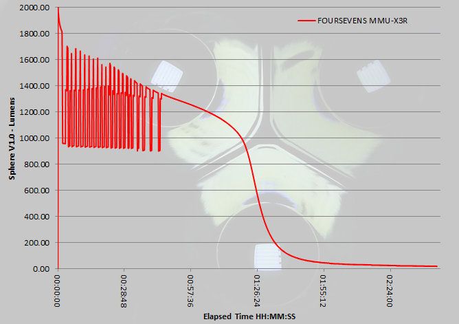

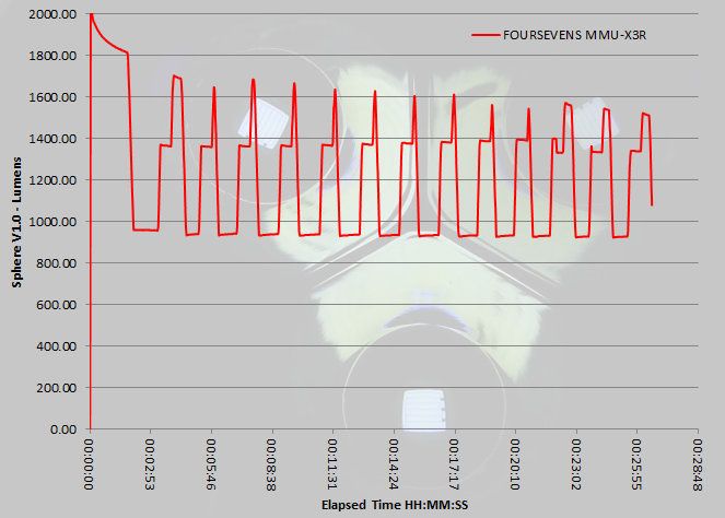

    With the MMU-X3R set on Max and a cooling fan in place, this runtime trace was recorded. I have intentionally gone beyond the ANSI runtime cut off to see if the MMU-X3R would leave you in the dark, but for a rechargeable light that you won't have a spare cell for, you can see that, importantly, in won't. The output tails off but does not shut off.
    ANSI cut off would be at 1h34m for Maximum.
    You might notice the output has quite a bit of variation in the first part of the trace. Zooming in a bit it looks like this.
    And going in closer, like this. What we are seeing here is the MMU-X3R's thermal regulation stepping in to protect the light from damage by lowering the output as needed, but also taking it back up again when it can.
    Considering the compact size of the MMU-X3R, its triple XM-L2 LEDs and the 1962lm output it is hardly surprising there is just too much heat being produced to allow it to run consistently at full output, even with a cooling fan. What this shows is that the MMU-X3R can be run hard and it will look after itself as well as giving you absolutely as much as it can, when it can.

    I recall that the 2000 lumen level is specified to be a one-minute Burst mode, and then 1000 lumens after that. Your graph shows about two minutes for the initial 2000 lumens to go down to 1800 lumens. So, the battery needs to be recharged after every two minutes of use, to stay in the 2000 to 1800 lumen range, correct?
    In Max mode, the MMU-X3R is giving all it can and this is a heavy load on the cell. The drop in output will be partly the cell's charge level and partly due to heat build up. The point it reaches 1800lm in this graph is also where the thermal regulation first kicks in. So at this point the internal temperatures have reached their working limit. The runtime graph does not allow for any cell recovery or cooling. Given some recovery I expect it to give over 1800lm, but not for long.
    Remember this is a very compact light and you won't 'see' the difference between 2000lm and 1800lm, but in direct reply to your question, yes, you will need to keep it topped up if you want all 2000lm.
