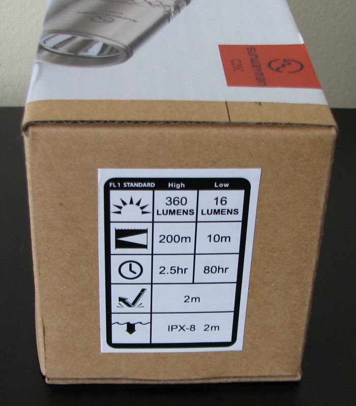

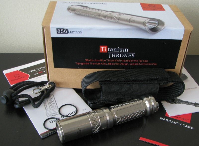

    Packaging is a hard cardboard box with packing foam. As always, detailed specs and information are printed right on the box. Inside, included with the light are spare O-rings, wrist lanyard, holster with Velcro closing flap, product inserts, warranty card, and manual.

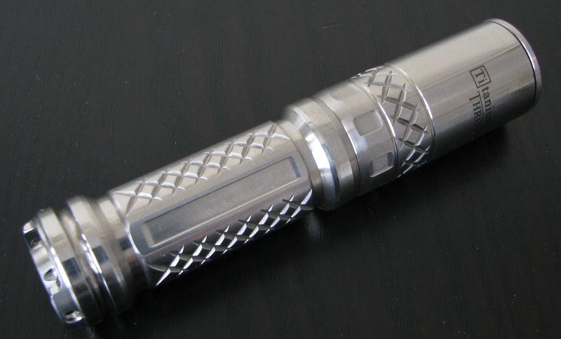

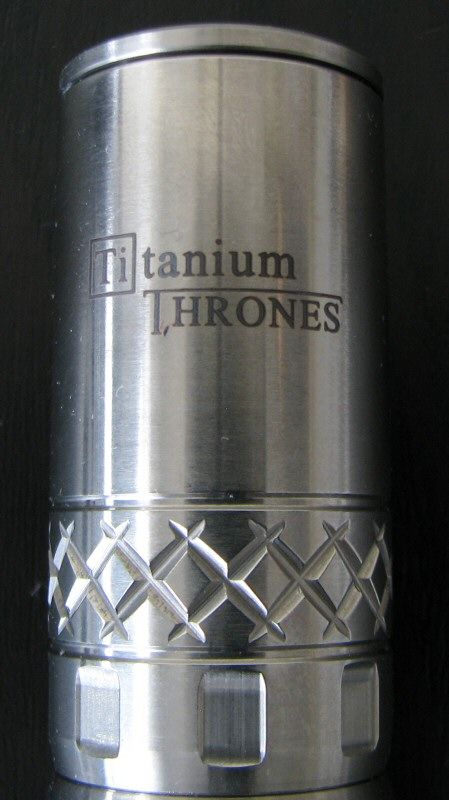

    As you would expect for a titanium light, the C25C-Ti is heavier than most of the competition – but is still quite reasonable for the class.
    The C25C-Ti is a distinctive light. Featuring CNC-machined titanium alloy, this "throne" has a distinctive look and feel.
    Weight has obviously increased over a comparably sized aluminum light, and the C25C-Ti has a substantial feel. There is good ridge detail all along the body and base of the head – nice and deep. This is something that is often limited on titanium lights. As a result, I would say overall grip is reasonable in this case (i.e., better than I was expecting, but not as high some lights). Unfortunately, the light can roll easily.
    As always, I find fingerprints show up easily on the shiny titanium finish (but are easily wiped off). Labels are laser engraved, and fairly subtle and elegant.

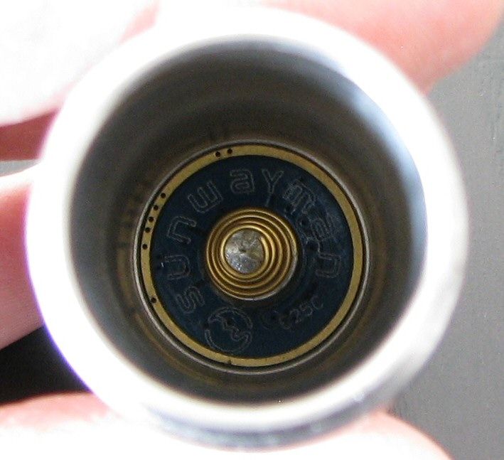

    There is a slightly raised contact point on the positive contact board in the head, so flat-top cells work fine. There is a spring at the base of the light.

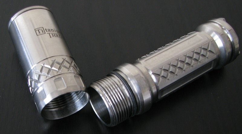

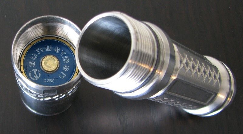

    The light uses standard triangular cut screw threads (and a good number of them). There is some galling on my sample (common to titanium lights), but it seems better here than on smaller titanium lights I've handled. There is no physical lock-out available – the light makes contact with the battery within the first turn of the threads.

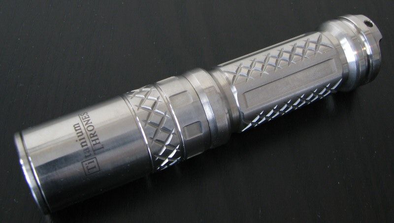

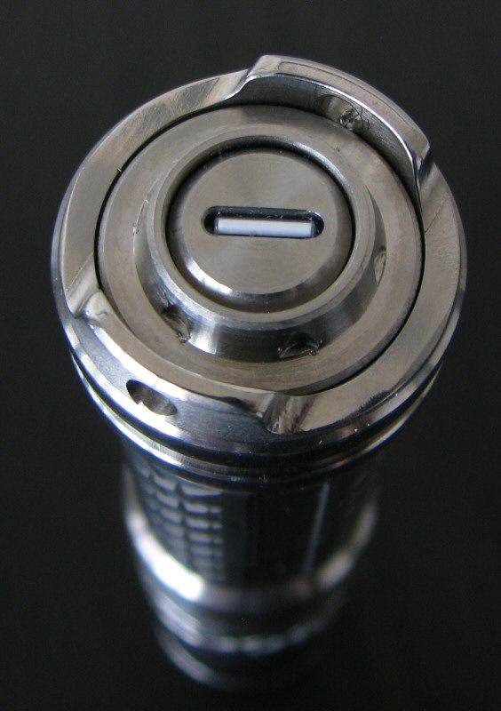

    The tail region is where things get interesting:
    Unusually, the light uses an electronic switch in the tail. Not sure why they went with an electronic switch, but I have noticed that physical clickies with metal switch covers (especially on titantium lights), can be problematic for smooth and consistent operation. The switch here is recessed within a surrounding area, and has a very short traverse (consistent with electronic switches). There is a subtle click when fully pressing it. There are raised guards along the outside of the tail, where you can attach a wrist lanyard. The light can tailstand stably.

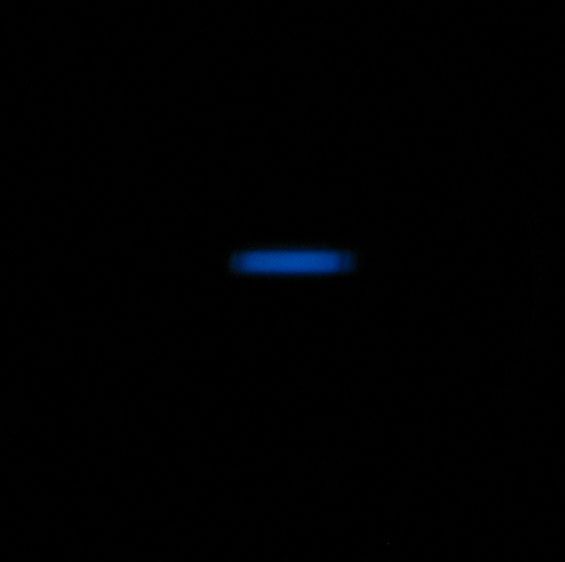

    What really interesting here is the addition of the blue trit. While popular with a number of the custom makers/modders, this is the first time I can recall seeing one on a mainstream light from a major manufacturer. Trits are small glass vials that contain a radioactive isotope of hydrogen – tritium – which is a weak beta emitter (don't worry, it's quite safe). The emitted electrons interact with a phosphor coating inside the vial producing fluorescent light (blue in this case), through the phenomenon of radioluminescence.
    As this sort of illumination requires no electrical energy, you will commonly find it in high-end wrist watches and emergency exit signs. And unlike the more common glow-in-the-dark phosphors you'll see on cheap watches (and o-rings, boot switch covers, etc), you don't need to pre-charge with visible light first – the tritium is a regular source of electrons (well, for a while anyway – its half-life is a little over a decade).
    As with most trits, the fluorescent light emitted isn't very bright – but it doesn't need to be. For dark-adapted eyes, it's a very comfortable level of light to help you find the switch in the dark.

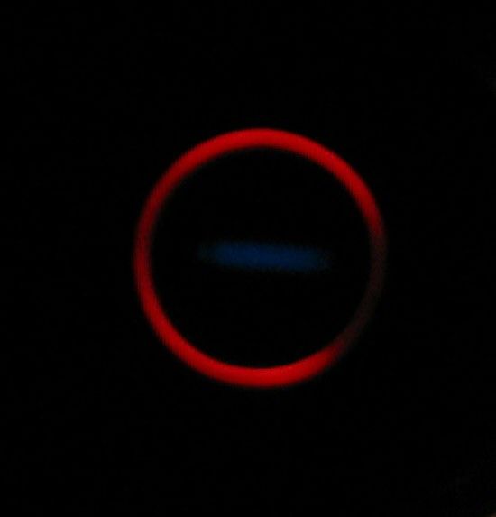

    Another interesting feature is the battery read-out indicator upon activation, which is a red light around the switch button.
    For the shot above, I turned the light on while head-standing the flashlight in the dark. As you can see, the indicator glows red when you first activate the light (you can faintly see the blue trit in the middle of the pic above). With a fully charged cell, the red indicator flashed 3 times. According to the instructions online, it will flash once when voltage is between ~3V-3.4V, twice when ~3.5-4V, and three times when ~4V-4.2V. Oddly, it is supposed to flash five times when below 3V.

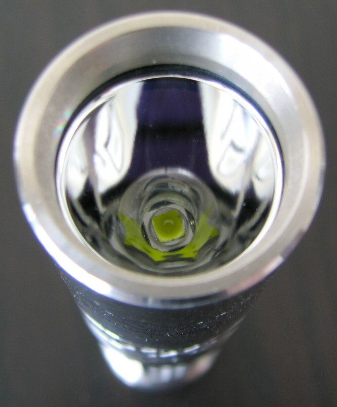

    Let's look at the head:

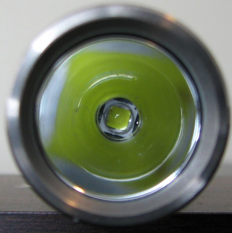

    The C25C-Ti comes with a flat titanium bezel. Reflector is smooth, and surprisingly deep given this size head. Coupled with the XM-L2 cool white emitter (which was well centered on my sample), I would expect a fairly narrow spillbeam, with above average throw for a light this size. Scroll down for beamshots.

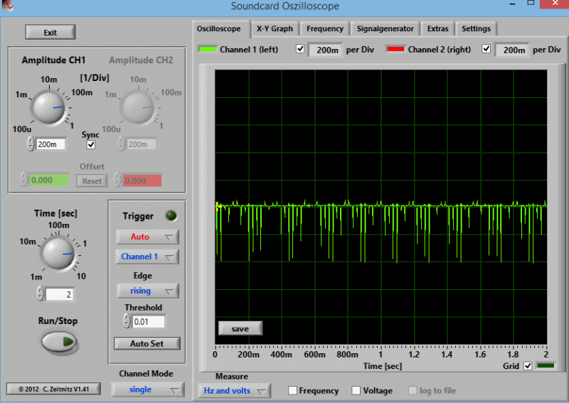

    PWM/Strobe
    The C25C-Ti uses pulse width modulation (PWM) at all levels.
    Lo:
    Med:
    Hi:
    Turbo:
    This is a classic PWM pattern, with an increasing pulse duration as you go up in output level, all with a common 964 Hz frequency. What is a little unusual is its continued presence on Turbo. I suspect this latter point reflects how the electronic tail switch interacts with the circuit in the head (and how it responds to different battery voltages). See runtimes later in this review for additional commentary.
    In any case, I find this 964 Hz frequency noticeable in use, especially at the lower levels. You will want to keep this in mind if you are particularly sensitive to PWM flicker.
    There is also a secondary signal noise pattern, noticeable at longer time scales on my oscilloscope. Here is an example on the Lo level:
    This doesn't produce any visible effect, however.

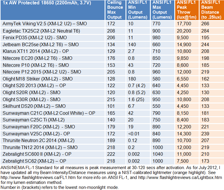

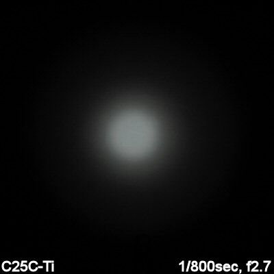

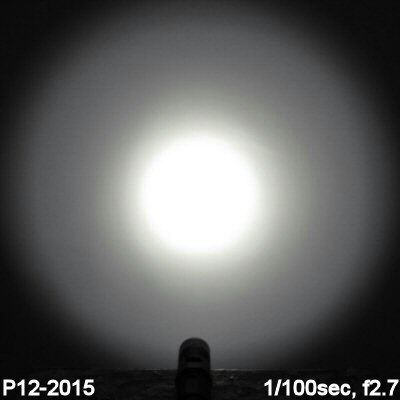

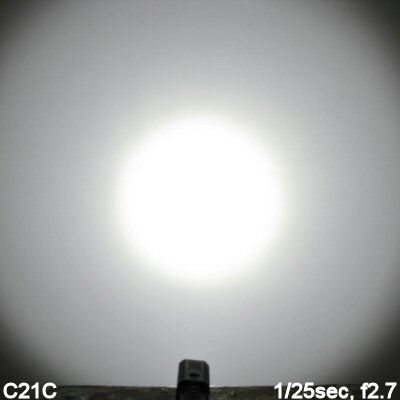

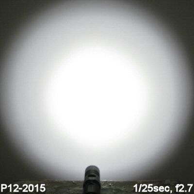

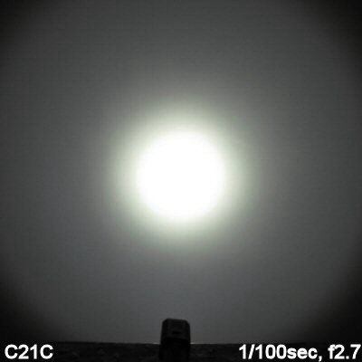

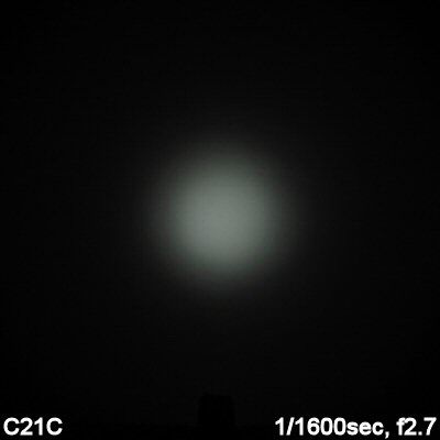

    For white-wall beamshots below, all lights are on Max output on a protected 18650 battery. Lights are about ~0.75 meter from a white wall (with the camera ~1.25 meters back from the wall). Automatic white balance on the camera, to minimize tint differences.
    One main observation is that the C25C-Ti has a narrower spillbeam than typical - consistent with a narrow and deep reflector. While generally focused for throw, overall output is not as high as some of the competing lights in this class. Scroll down for detailed output and throw measures.

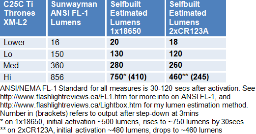

    Max output is a little hard to characterize on this light, for reasons I will explain below. Let's start by looking at all the output levels, on both 1x18650 and 2xCR123A.
    My ANSI FL-1 lumen estimates are close to the Sunwayman specs – although fairly consistently a bit below what is reported. But as I note in the footnote above, the initial output on max is a good amount lower, at ~500 lumens to start. Over the next 30 secs or so (on 18650), it rises to ~750 lumens, and then starts to slowly drop off. As such, the ANSI FL-1 rating above refers to the peak max output (since it falls within that time window). On the 2xCR123A, output is slightly lower across the board – and it barely changes on max.
    What seems to be going on here is that when you switch to Hi, the circuit starts at an intermediate Med-Hi level, and then adjusts depending on the voltage source (i.e., stays Med-Hi for 2xCR123A, rises to the true Hi level on 1x18650). Can't say I've seen that before. Let's check out the runtimes …

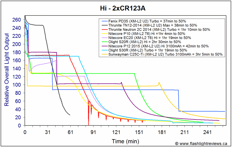

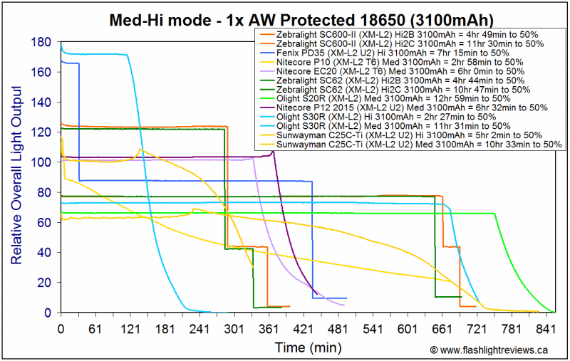

    Output/Runtime Graphs:
    All runtimes are done under a cooling fan. 18650 runtimes done using protected batteries based on the Panasonic NCR18650A core.
    Overall efficiency of the C25C Ti is reasonable for a PWM-based light. Note that the current-controlled lights will always have an efficiency advantage. As such, the Nitecore P12 is a good example to compare to above.
    The C25C Ti is not as flatly regulated as most of the competition, although this quite reasonable (i.e., you cannot see the slight changes over long periods of time).
    Unlike other Sunwayman offerings, the C25C-TI uses PWM on all modes (including Hi) at a visually detectable 964 Hz. I find the PWM not very noticeable on Hi on this light, but those sensitive to PWM will notice it on the lower modes (i.e., as perceptual visual "flicker").
    Light uses an electronic switch in the tail, and therefore requires a stand-by current when fully connected - but this is completely negligible at ~11uA, and not a concern. There is an electronic lock-out feature if you are worried about accidental activation (although this is relatively unlikely due to the need for a sustained press turn on). Unfortunately, you cannot physically break the current on this light (i.e., there is no thread anodizing)

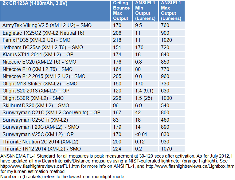

    Max output is lower on 2xCR123A compared to 1x18650, at all levels. Note that max output is toward the lower end of this class, on all batteries.
    Overall efficiency is not as high as the current-controlled competition, and regulation is typically not quite as flat-stabilized (but still quite reasonable). Please see my runtimes above for more info.

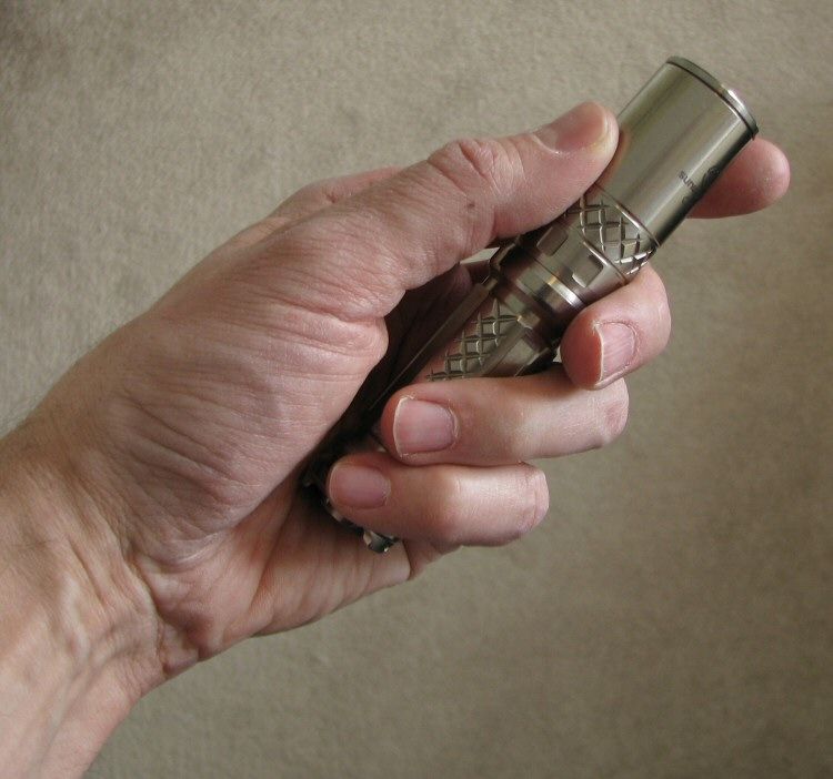

    Titanium is a very solid material, but it is heavier than aluminum, and you should expect some "galling" with the screw threads (i.e., titanium on titanium is not as smooth as aluminum).
    There is no anti-roll feature, and grip may be reduced from traditional lights in this class (but is good by all-titanium standards).
