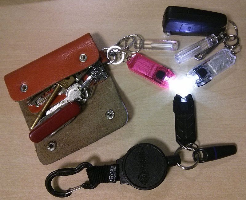

    I've been EDCing three TUBEs for a couple of months now and find the guilt free almost weightless lumens incredibly useful. In everyday urban scenarios, these give a useful backup light that almost unnoticeable to carry.

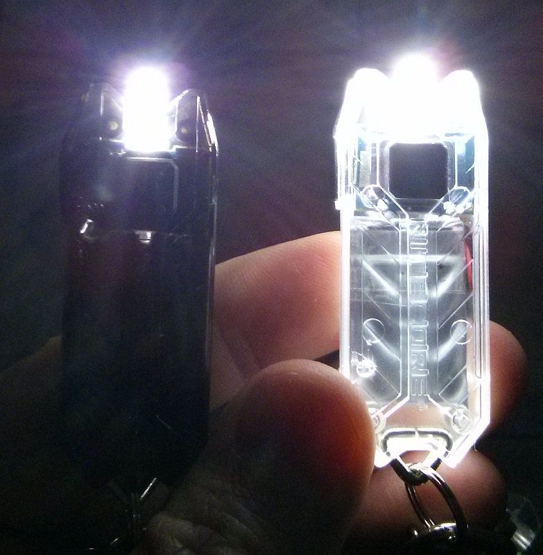

    It must be noted that the colour you choose can have quite an impact on their effectiveness in use (also depending on what you want). As you can see here, with a black and clear TUBE on maximum, the clear body lights up like a lantern, and can be distracting. If you want a mini lantern though, it is excellent.

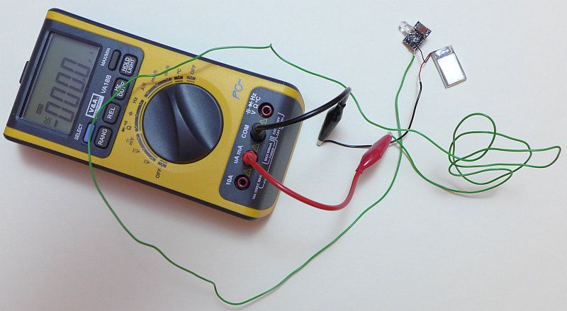

    The only way to measure this is to take it apart and unsolder the cell. Initially, when measuring the drain, the cell had been disconnected, and the TUBE had not been turned on then off. The drain in this situation was 320uA. At this rate the cell would be fully discharged in 13 days.
    Knowing this is not the case in reality, like other NITECORE lights where the initial drain on connecting the battery if significantly higher than once the light has been turned on then off again, this needed another approach. With the multi-meter on uA it could be damaged by switching the light on and off, so I needed a way of connecting the circuit, then short-circuiting out the meter but then maintaining the connection to allow the drain to then be measured. This was done by soldering additional wires and using crocodile clip probes which could be touched together to short out the meter as needed.
    Once done, as you can see here the drain drops to negligible. The meter's lowest measurement is 0.1uA, and the current is less than this. From time to time it did show 0.1uA, but was generally lower.
    This makes a huge difference. It means that the 100mAh cell would take 114 years to discharge. Safely negligible!

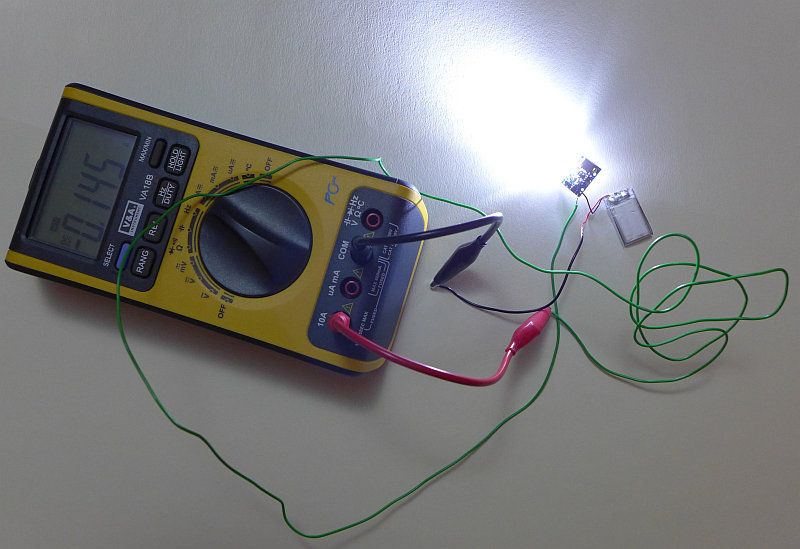

    While hooked up like this it gave the opportunity to test the running current. On low this was 2.53mA
    And on Maximum it was 0.145A. Though as the cell drains this will drop, it does fit well with the hour long runtime.

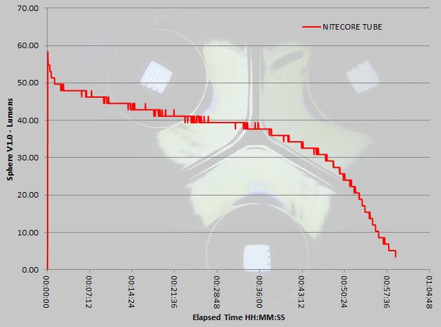

    Running on Maximum, this is the output graph for a freshly charged TUBE.

    I am glad you pointed out the "lantern effect", as I call it. I got a black one and a pink one. Pink on glows too. The wife put the pink one on the zipper for diaper bag duty. She loves it. No weight at all! As she put it, "I can find the zipper and stuff in the bag and it doesn't look like a flashlight, it so cute"

    Thank you for putting all this data together. Interesting and helpful. The lantern effect of the clear model seems useful - I may have to pick up another one.

    Thank you for your in deth information and testing i like the way you positioned the 3 to resemble your avatar
