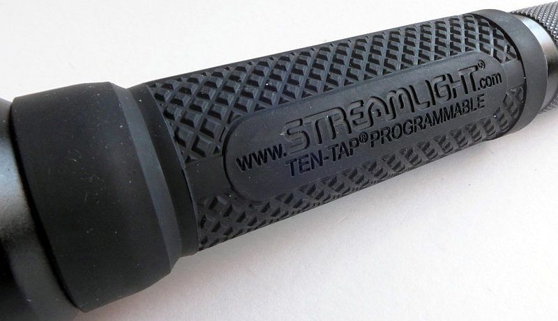

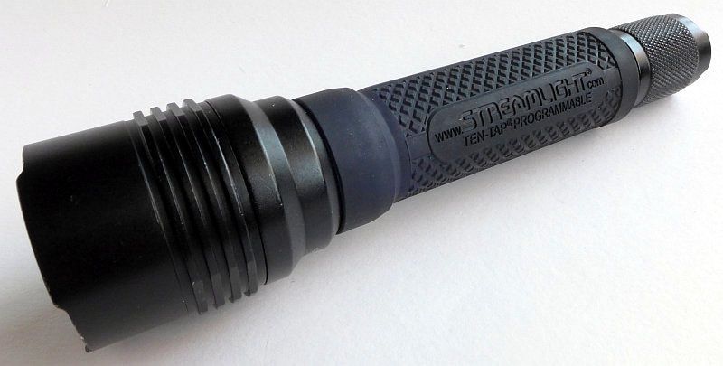

    This ProTac HL3 is wearing its new rubber overcoat.
    The moulding in the rubber is crisp.
    With one side having the model, and the other having Streamlight's logo and the TEN-TAP Programming legend.

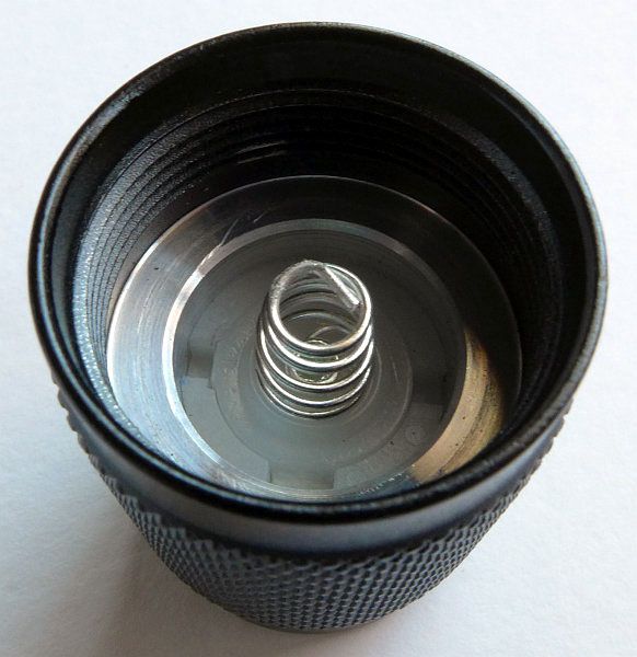

    Here are the contacts inside the tailcap.
