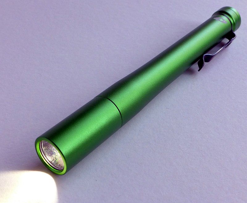

    Like the other lights in the FOURSEVENS range, the Preon P2's packaing allows you to look all round the light and looks very clean and crisp.

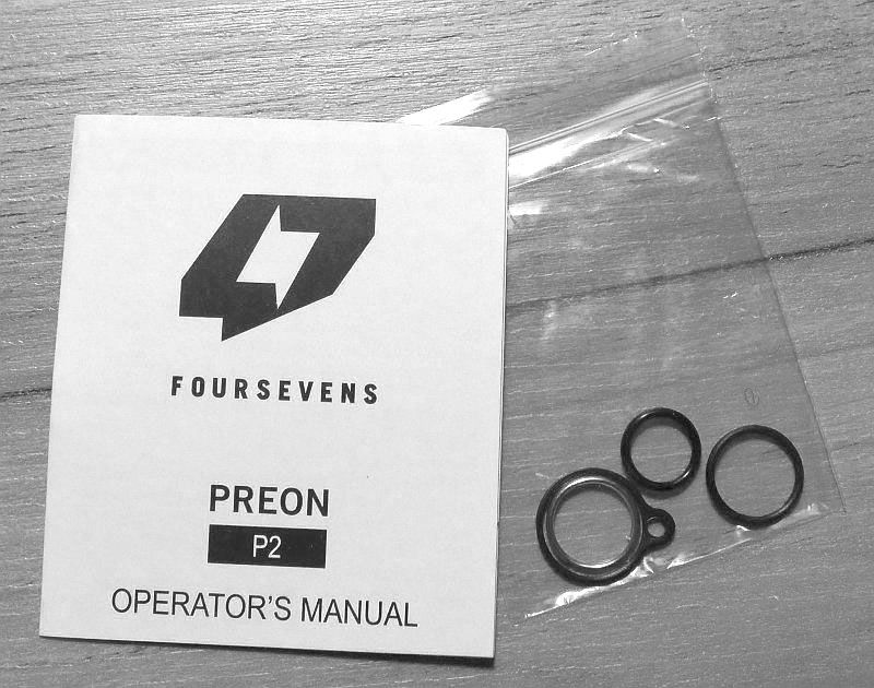

    Included with the Preon P2 are spare o-rings, and a lanyard ring with split ring. The lanyard ring can be fitted in place of the pocket clip.

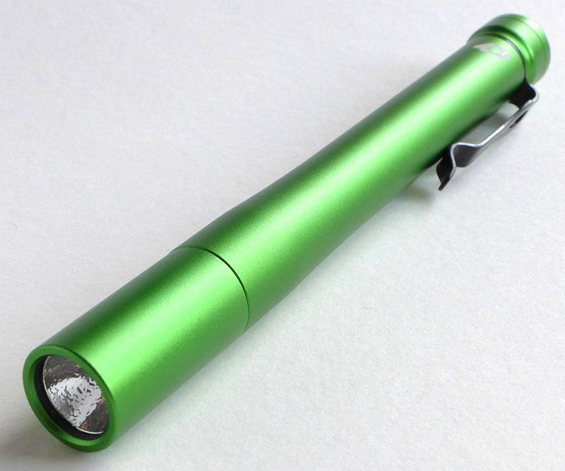

    Black is SOoo old-hat! The Preon P2 is in 'Toxic Green' to inject some colour into your lighting line up.

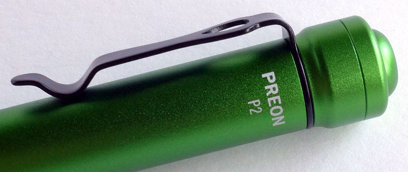

    The P2's pocket clip. This can be removed and substituted for the lanyard ring.
    Another view showing the pocket clip design and model designation printed on the side.

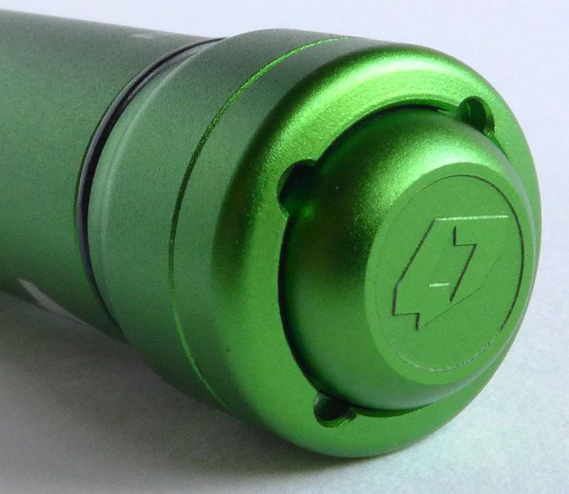

    Unlike most other tailcap switched lights, the P2's switch has a metal button cover.
    Using a metal button gives the P2 a great feel, and allows for a crisp engraving of the FOURSEVENS logo.
    Another look at the lovely button and awesome Toxic Green colour.

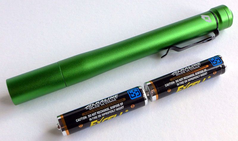

    The P2 is not much larger than the two AAAs it houses.
    The XP-G2 LED sits in a textured reflector.
    Looking at an angle lets you see the reflector depth.

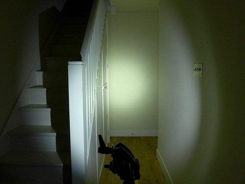

    The beam
    An ideal all-rounder beam for this size of light. There is a wide spill making it great for indoor close-range use, but there is enough of a hotspot to give you some range. No harsh transitions anywhere from the hotspot to the outer edge of the spill.

    The Preon P2 uses 2 x AA either Alkaline or NiMh. The batteries can be inserted either by unscrewing the tailcap, or the head. I find it easier to unscrew the head.

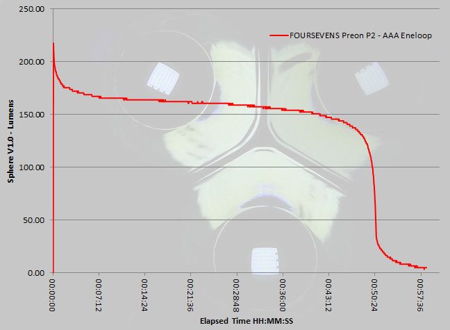

    FOURSEVENS Preon P2 I.S. measured ANSI output Lumens PWM frequency or Strobe frequency (Hz)
    High 193 0
    Medium 41 2500
    Low 3 2430
    Strobe 68 10
    SOS 103 0
    Beacon High 202 Flash every 11s
    Beacon Low 45 Flash every 11s
    An impressive performance from a slim 2 x AAA powered light, keeping output at over 150 lumens for most of the runtime. Not using hard regulation, but a pretty well maintained output.

    The metal switch cover gives the P2 a very different feel to most lights making it seem somehow more refined than rubber booted switches. However, the other side to that is that the switch cover can rattle slightly and the switch's click seems slightly amplified. While talking of rattle, the batteries do suffer from a bit of rattle too.
