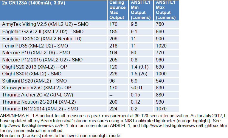

    • CW Modes & Run-time: Firefly: Firefly: 0.26 lumens(69 days); Low: 14 lumens(128 hours); Medium: 184 lumens(11 hours); High: 840 lumens(125 minutes); Strobe: 840 lumens(340 minutes).
    • Working voltage: 2.6-8.4V.
    • Battery: 2 CR123 or 16340 batteries or one 18560 battery.(not included).
    • CW Max beam distance: 124 meters.
    • CW Peak beam intensity: 3870cd.
    • WEIGHT: 66g without battery.
    • Dimensions: 128mm in length, 24mm bezel diameter.
    • MSRP: $40 (CW)

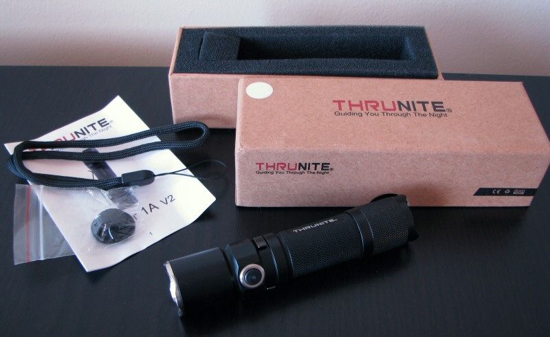

    Packaging is the same for all models, and includes a hard cardboard box with packing foam (a sticker on box indicates cool white or neutral white). Inside, you will find the light (with pocket clip installed), extra o-rings, extra boot switch cover, basic wrist lanyard, and manual.
    Note that Thrunite has recently updated their warranty policy for all lights, available here.

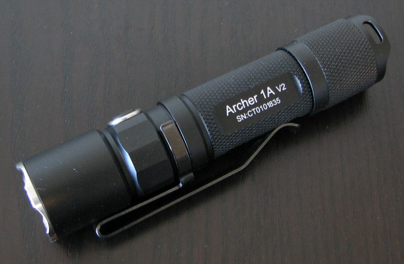

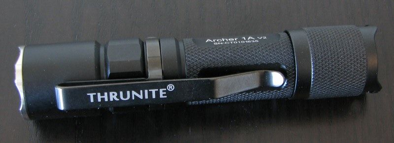

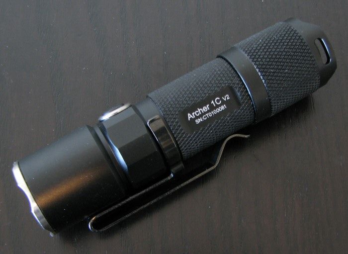

    Archer 1A:
    Archer 2A:
    Archer 1C:
    Archer 2C:

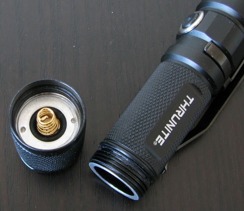

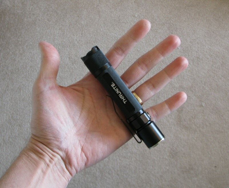

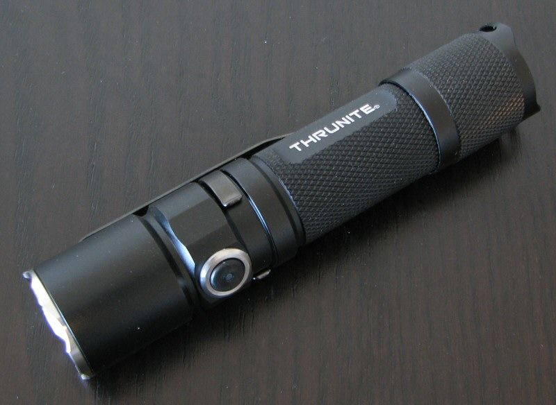

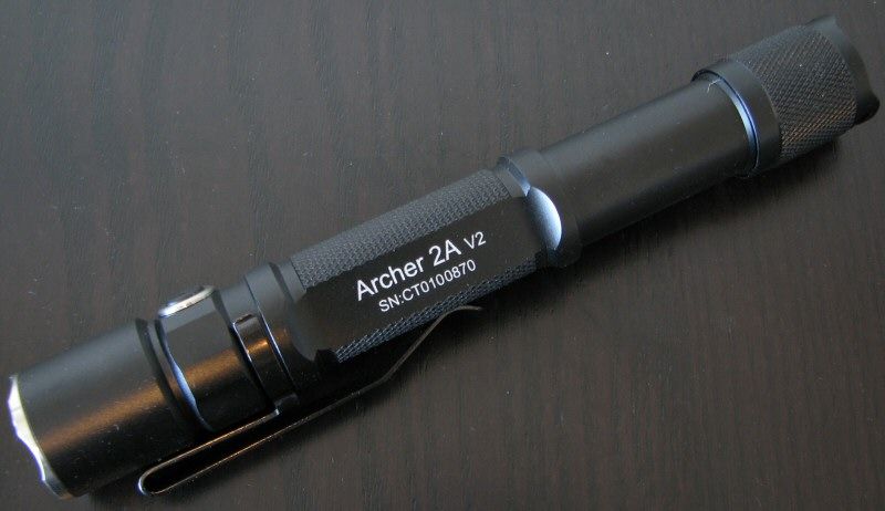

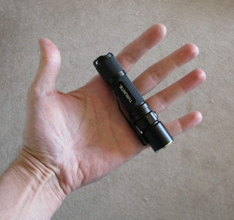

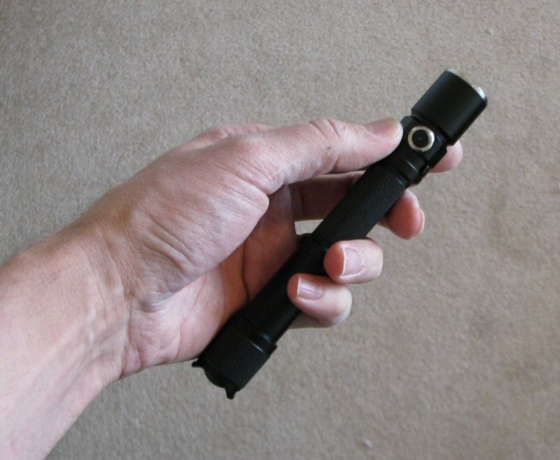

    Physically, the new Archer lights are very similar to one another. Indeed, it is just the 2C that has a wider body (to accommodate the thicker 18650 cells) – the heads look the same across all models. All lights feature a classic tailcap clicky-switch for on/off, as well as side electronic switch for mode changing.
    All lights have knurling, which is of reasonable aggressiveness, and glossy black anodizing. Hand feel is good, and the included clips help with grip (and serve as anti-roll).

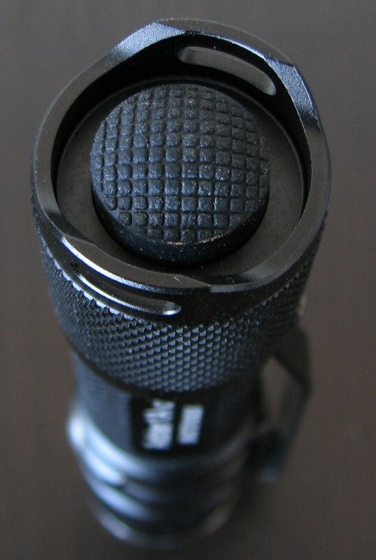

    The tail-switch is a typical forward clicky switch, with a raised surround (that serves as a lanyard attachment point and allows stable tailstanding). The side-mounted electronic switch protrudes slightly, and has a definite "click" (with typical traverse). The center of the switch is clear, but there doesn't seem to be an LED indicator underneath (as there is on some of the other recent Thrunites).

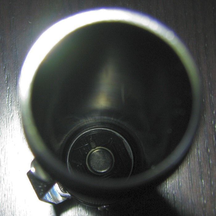

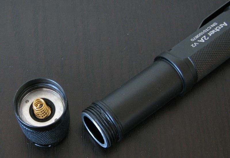

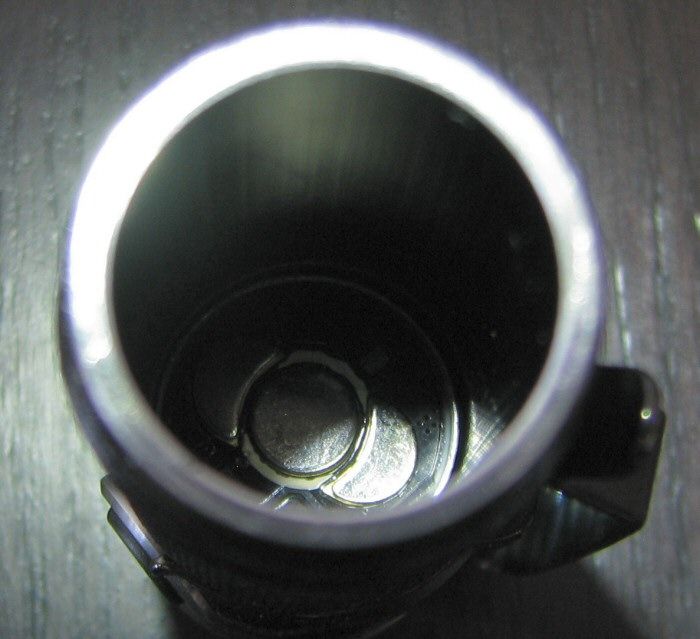

    The only difference inside the lights is on positive contact board in the head – the 1A, 1C and 2A models have the classic reverse-polarity feature seen on many AA lights (i.e., only small button top can be used). The 2C lacks this feature, and so will take flat-top cells just fine.
    Screw threads are square-cut and anodized, allowing lock-out on all models. Oddly, there are some differences in the tail threading, and only the 1A and 2A have interchangeable tailcaps.

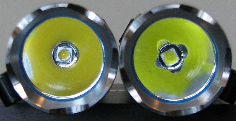

    The new Archers use a crenelated bezel design, in stainless steel. Reflectors are smooth finish, and appear to be identical across models and emitter. Centering of the emitters was reasonably good on samples (although not perfect). The Cool White versions come with the XP-L emitter, the Neutral Whites the XP-G2.

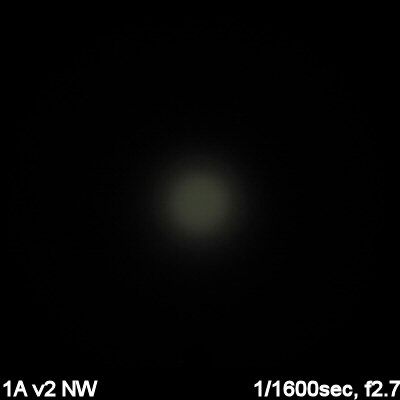

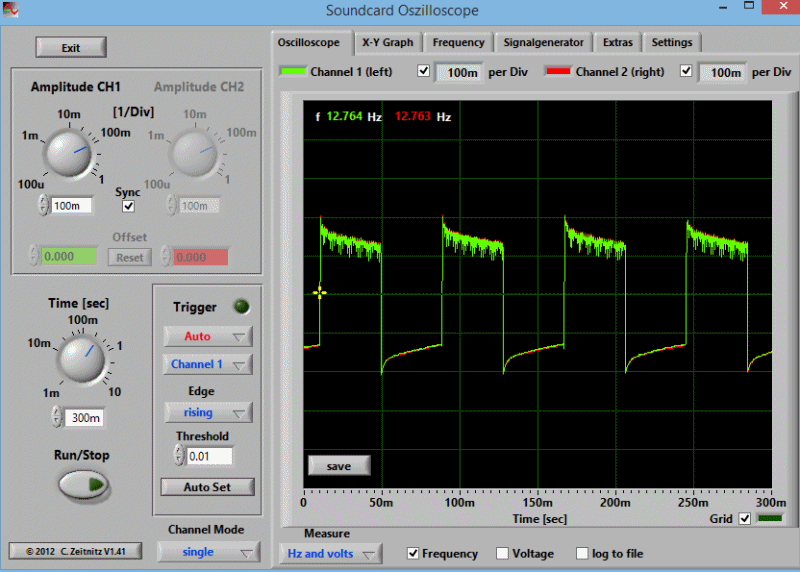

    PWM/Strobe
    The new Archer v2 series lights are current-controlled on all modes – there is no indication of pulse width modulation or circuit noise on any constant-output mode, on any model.
    Strobe is a consistent 12.8 Hz on all models, although there is variation in how the oscilloscope traces looks:
    Archer 1A CW:
    Archer 2A NW:
    Archer 1C CW:
    Archer 2C:
    None of this is visible to the naked eye – in all cases, strobe is a consistent "fast" strobe across this series.

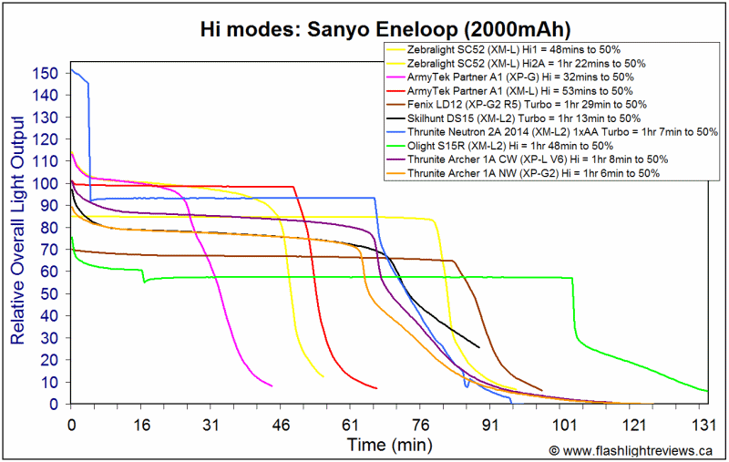

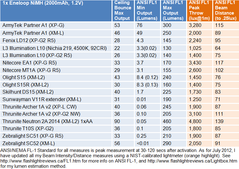

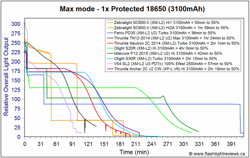

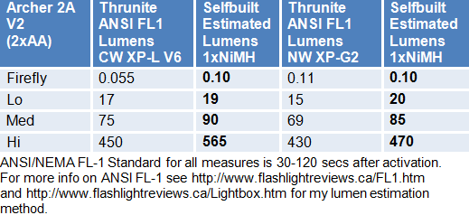

    Throw/Output Summary Charts:
    Individual Comparisons

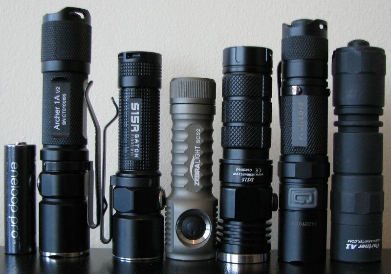

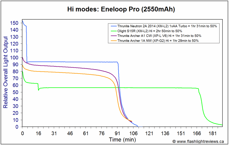

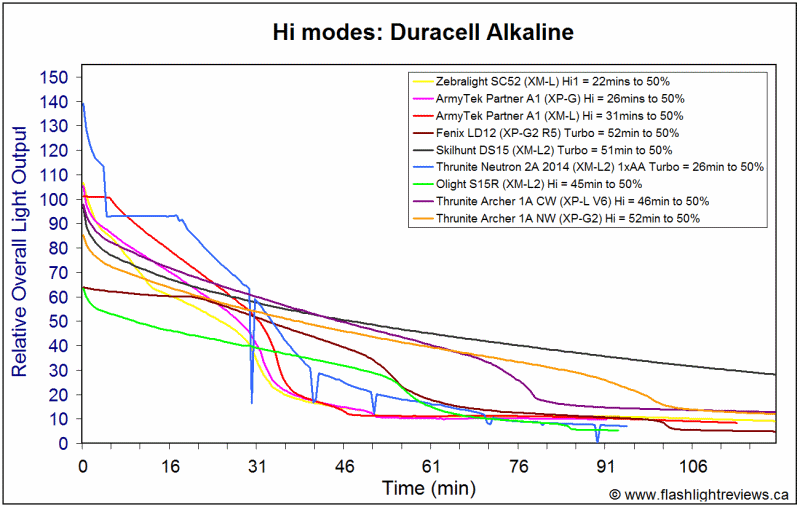

    Archer 1A – 1xAA/14500
    From left to right: Panasonic Eneloop Pro NiMH AA; Thrunite Archer 1A, Olight S15R; Zebralight SC52; Sklihunt DS15; Fenix LD12; Armytek A1.
    Thrunite Archer 1A v2 CW: Weight: 66.9g, Length: 109.6mm, Width: 23.1mm
    Thrunite Archer 1A v2 NW: Weight: 66.8g, Length: 109.3mm, Width: 23.0mm
    Thrunite Neutron 2A 2014 (1xAA form): Weight: 57.6g, Length: 95.6mm, Width (bezel): 25.6mm
    Thrunite T10S: Weight: 60.9g; Length: 93.7mm, Width (bezel): 17.8mm, Width (widest): 18.7mm
    Fenix LD12: Weight: 52.3g, Length: 99.9mm, Width (bezel): 21.6mm
    Nitecore MT1A: Weight: 54.6g, Length: 104.6mm, Width (bezel): 22.7mm
    Nitecore SENS AA: Weight: 26.1g, Length: 82.7mm, Width (bezel): 19.8mm
    Olight S15R: Weight: 47.6g (69.2g with Olight 14500), Length: 89.6mm, Width (bezel): 23.1mm
    Olight S15: Weight: 46.4g, Length: 87.0mm, Width (bezel): 23.1mm
    L3 Illumination L10: Weight: 20.7g, Length: 79.4mm, Width (bezel): 17.1mm
    Lumintop ED15: Weight: 59.7g, Length: 100.2, Width (bezel): 21.9mm
    Skilhunt DS15: Weight: 52.0g, Length: 92.1mm, Width (bezel): 24.0mm
    Xeno E03:: Weight: 48.1g, Length 96.7mm, Width (bezel): 21.5mm
    Zebralight SC52: Weight 39.5g, Length 79.0mm, Width (bezel): 22.6mm, Width (max) 25.4mm

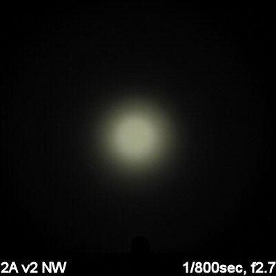

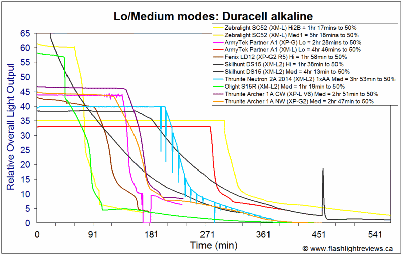

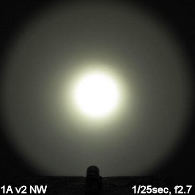

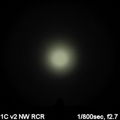

    For white-wall beamshots below, all lights are on Max output on an NiMH or 14500 AA-sized batteries. Lights are about ~0.75 meter from a white wall (with the camera ~1.25 meters back from the wall). For NW lights, a Daylight white balance (on my Canon) is used to provide a more consistent visual comparison to the CW lights.
    Note that "2A 2014 1xNiMH" below refers to the Neutron 2A 2014 in 1xAA form.
    In the interest of space, scroll down to the 1C RCR beamshots if you want to get an idea of what 1x14500 in the 1A looks like.

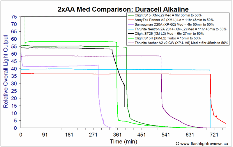

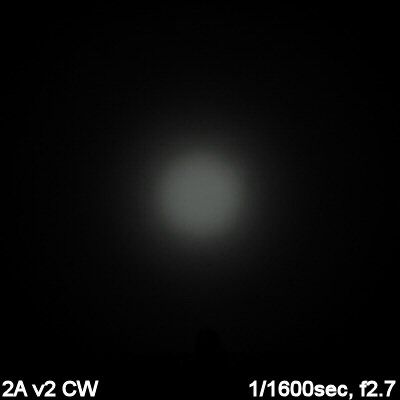

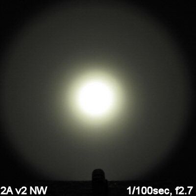

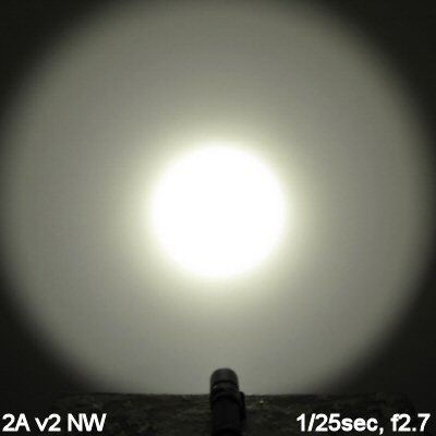

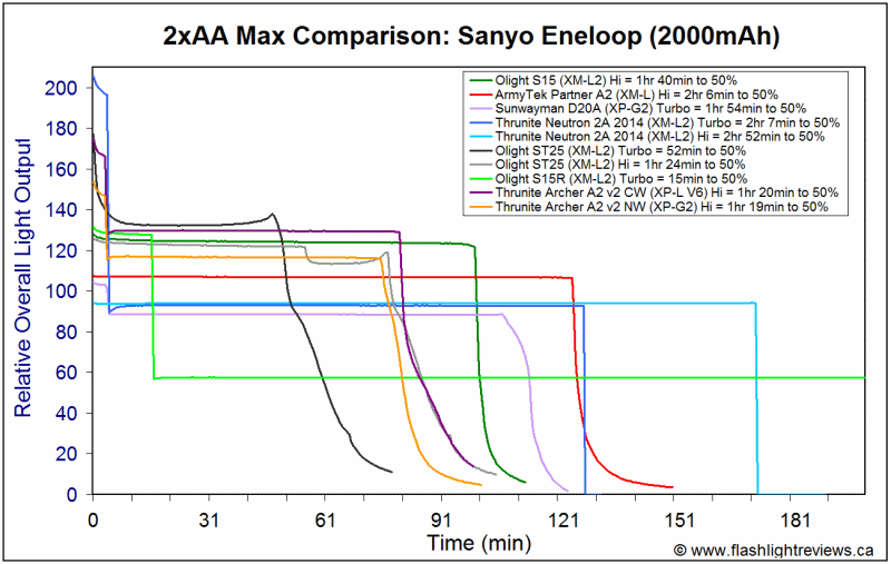

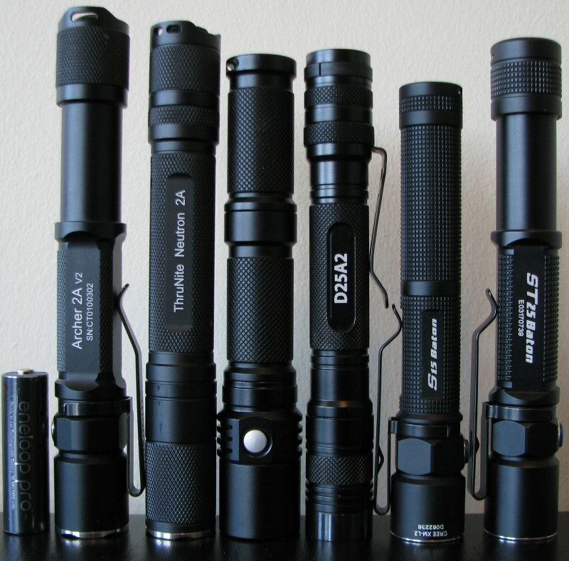

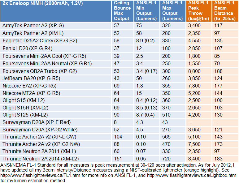

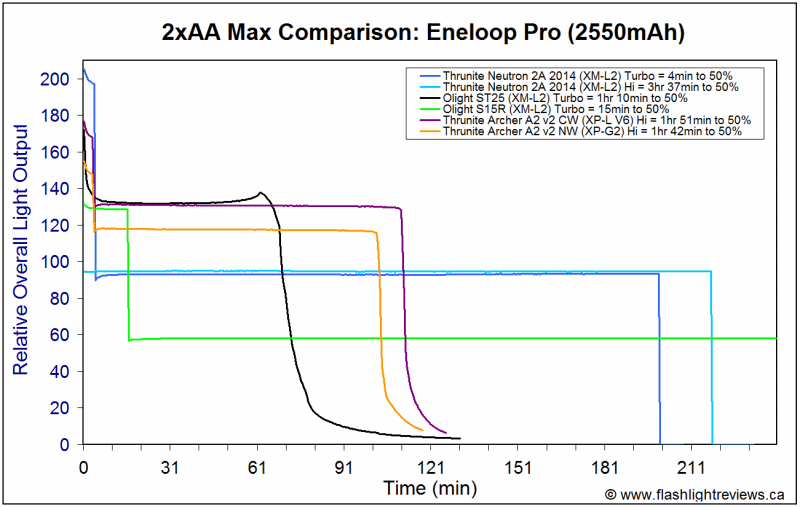

    Archer 2A – 2xAA
    From left to right: Panasonic Eneloop Pro NiMH AA; Thrunite Archer 2014, Neutron 2A 2011; Neutron 2A 2014; Eagletac D25A2; Olight S15 with extender, Olight ST25.
    Thrunite Archer 2A v2 CW: Weight: 80.0g, Length: 159mm, Width: 23.0mm
    Thrunite Archer 2A v2 NW: Weight: 79.7g, Length: 159mm, Width: 23.1mm
    Thrunite Neutron 2A 2014 (2xAA form): Weight: 73.46g, Length: 146.2mm, Width (bezel): 25.5mm
    Eagletac D25A2: Weight: 54.8g, Length 148.5mm, Width (bezel): 21.0mm
    Foursevens QAA-2 X (Tactical tailcap): Weight: 60.1g, Length: 149.1mm, Width (bezel) 22.0mm
    Jetbeam BA20: Weight: 70.2g, Length: 156.4mm, Width (bezel) 23.2mm
    Nitecore MT2A: Weight: 66.9g, Length: 154.3mm, Width (bezel):22.7mm
    Nitecore EA2: Weight: 68.9g, Length: 134.4, Width (bezel): 26.1mm
    Olight ST25: Weight: 76.1g, Length: 152.4mm, Width (bezel): 23.0mm
    Olight S15 2xAA: Weight: 59.2g, Length: 137.9mm, Width (bezel): 23.1mm
    Sunwayman D20A: Weight 118.4g, Length: 102.6mm, Width (head) 20.9mm, Height (head) 35.1mm

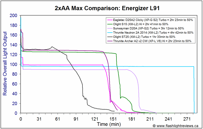

    For white-wall beamshots below, all lights are on Max output on 2xNiM AA (Sanyo Eneloop). Lights are about ~0.75 meter from a white wall (with the camera ~1.25 meters back from the wall). For CW lights, automatic white balance is used on the camera, to minimize tint differences. For NW lights, a Daylight white balance (on my Canon) is used to provide a more consistent visual comparison to the CW lights.
    Note that "2A 2014" below refers to the Neutron 2A 2014 in 2xAA form.

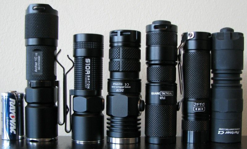

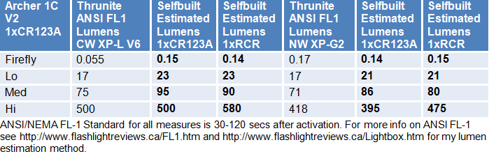

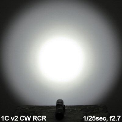

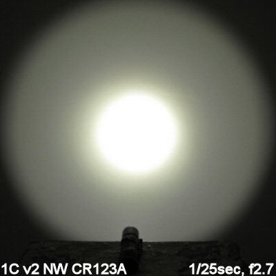

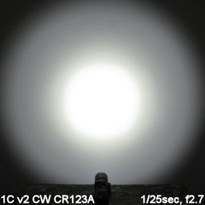

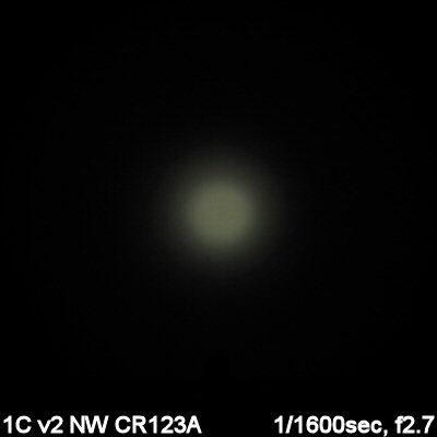

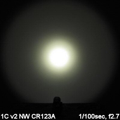

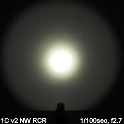

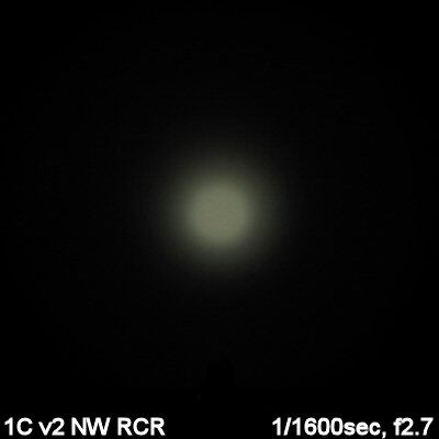

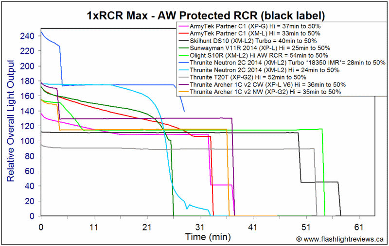

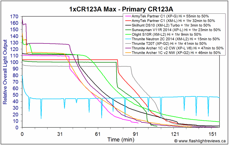

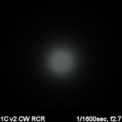

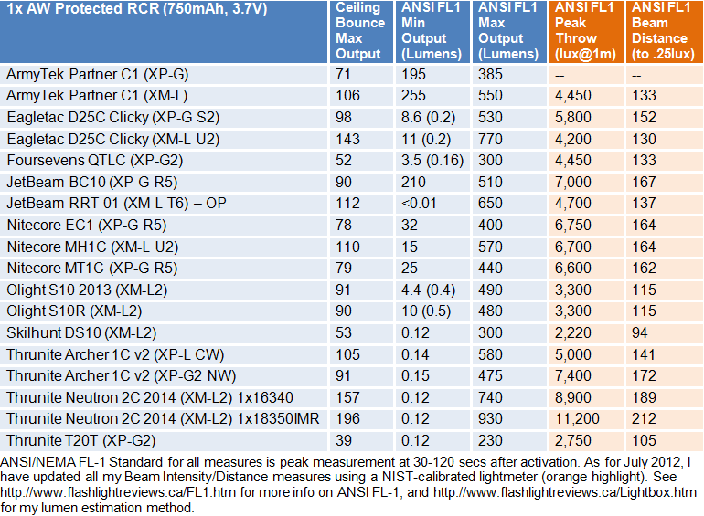

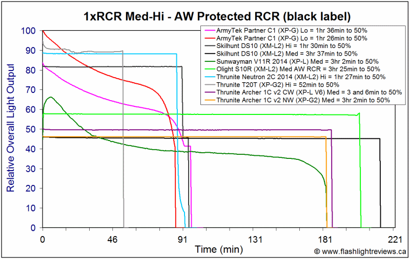

    Archer 1C – 1xCR123A/RCR
    From left to right: Rayovac CR123A; Thrunite Archer 1C; Olight S10R; Skilhunt DS10; Foursevens QTLC; Eagletac D25C; Armytek C1.
    Thrunite Archer 1C v2 CW: Weight: 59.9g, Length: 93.9mm, Width: 23.1mm
    Thrunite Archer 1C v2 NW: Weight: 59.2g, Length: 93.9mm, Width: 23.1mm
    Thrunite Neutron 2C 2014 (1xCR123A/RCR form): Weight: 63.0g, Length: 87.7mm, Width (bezel): 25.5mm
    ArmyTek C1 XM-L: Weight: 43.0g, Length: 80.2mm , With (bezel): 23.1mm
    Eagletac D25C Clicky: Weight: 30g, Length: 76.0mm, Width (bezel): 20.0mm
    Foursevens QTLC: Weight 36.4g, Length 84.1mm, Width (bezel) 22.1mm
    Jetbeam PC10: Weight: 50.5g, Length: 93.6mm, Width (bezel): 22.6mm
    Lumintop ED11: Weight: 44.1g, Length: 83.7, Width (bezel): 21.8mm
    Olight S10 (2013, XM-L2): Weight: 40.5g, Length: 70.8mm, Width (bezel): 23.1mm
    Skilhunt DS10: Weight: 47.0g, Length: 76.1mm, Width (bezel): 24.0mm
    Sunwayman C10R: Weight: 57.3g, Length: 76.2mm (no lanyard plug), 82.3mm (with plug), Width (bezel): 25.6mm, Width (head at widest part): 28.6mm

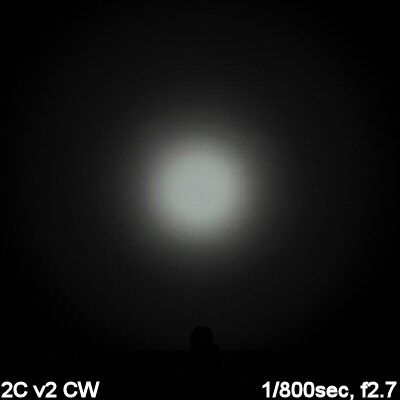

    For white-wall beamshots below, all lights are on Max output on an AW protected 18650 battery. Lights are about ~0.75 meter from a white wall (with the camera ~1.25 meters back from the wall). For NW lights, a Daylight white balance (on my Canon) is used to provide a more consistent visual comparison to the CW lights.
    Note that "2C 2014" below refers to the Neutron 2C 2014 in 1xCR123A/RCR form.
    1xCR123A
    1xRCR

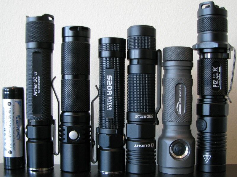

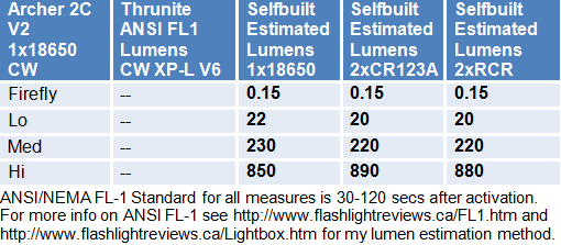

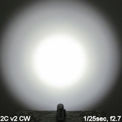

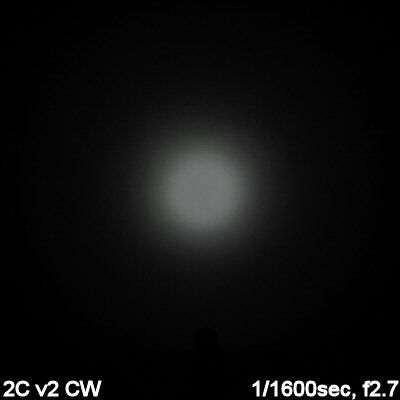

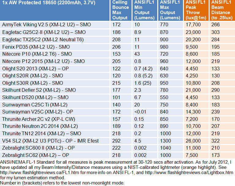

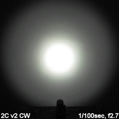

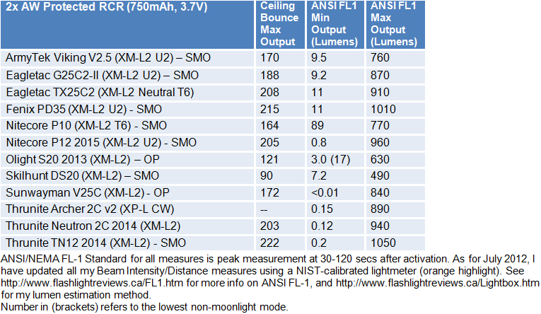

    Archer 2C – 2xCR123A/RCR, 1x18650
    From left to right: Keeppower Protected 18650 3100mAh; Thrunite Archer 2C, Neutron 2C 2014; Olight S20R, 30R; Zebralight SC600-II, Nitecore P12
    Thrunite Archer 2C v2 CW: Weight: 66.3g, Length: 128.1mm, Width: 23.0mm
    Thrunite Neutron 2C 2014 (2xCR123A/RCR form): Weight: 71.2g, Length: 117.7mm, Width (bezel): 25.5mm
    Thrunite TN12-2014: Weight: 80.0g, Length: 140.5mm, Width (bezel): 25.4mm
    Eagletac D25LC2: Weight: 50.0g, Length: 116.3mm, Width (bezel): 22.5mm
    Eagletac S200C2vn (V54 mod): Weight: 168.7g, Length: 155.0mm, Width: 47.0mm
    Fenix PD35: Weight: 82.7g, Length: 138.1mm, Width (bezel): 25.4mm
    Olight M22: Weight: 148.4g, Length: 144.8mm, Width (bezel): 41.2mm
    Nitecore P12 2015: Weight: 88.7g, Length: 139.5mm, Width (bezel): 25.5mm
    Skilhunt DS20: Weight: 53.8g, Length: 110.0mm, Width (bezel): 24.0mm
    V54 Sky Lumens 2: Weight: 83.1g, Length: 119.2mm, Width (bezel): 24.0mm
    Zebralight SC600 II: Weight 79.3g, Length: 101.8mm, Width (bezel) 29.7mm
    Zebralight SC62: Weight: 42.3g, Length: 96.5mm, Width (bezel): 23.2mm, Width (max) 26.1mm
    Note that "2C 2014 1x18650" below refers to the Neutron 2C 2014 on 1x18650 form.
    The side switch button is fairly small, and may be hard to locate by touch alone (even though it is slightly raised).

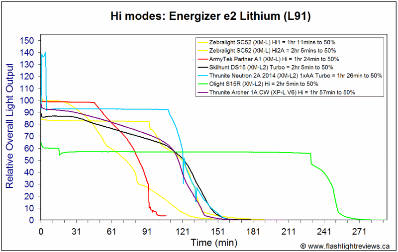

    All lights show a timed step-down from Hi after ~3.5 mins runtime (except on 1xAA batteries).
    Most models are not driven as highly on max as other recent lights in their respective classes. However, they all produce a reasonable Hi level.
    Ok, that's a LOT of data.
    Let me start with the physical build, since it is fairly consistent across models. Personally, I found the Neutron v2 refresh in 2014 to be a bit "plain vanilla" in styling. As such, I'm happy to see that Thrunite has kept a more traditional design for the Archer v2 update.
    While this design is not particularly novel or innovative, it has the advantage of being familiar and well thought-out (i.e., very similar to a number of Fenix and Olight lights over the years). I like the forward clicky switch (with ability to tailstand), the side switch for mode changing (with low voltage warning underneath), the decent bi-directional pocket clip, the stainless steel crenelated bezel, and the reasonable knurling.
    I like the user interface, with its separation of on/off from mode changing. The mode sequence (and level spacing) is generally good, with strobe mode "hidden" under a press-hold of the side switch.
    Circuit-wise, all models show a good customized current-controlled circuit, with reasonable interface. Output/runtime efficiency is typically excellent - very similar to the Olight and Skilhunt series lights, and the earlier Neutron V2. Regulation patterns are similarly good, with most models (on most levels) showing flat stabilization. Please see the individual runtimes above for more information on the model relevant to you.
    Output levels and beam intensity are generally consistent with Thrunite specs. As a general rule, Hi output increases as you go up to higher voltage sources on any given model, but the Firefly-Med modes remain relatively unchanged. Again, please see my detailed summary tables earlier in this review, for the individual models you are interested in.
    Beam patterns are also good for the series, with a reasonable trade-off between center beam throw and spill. It is nice to see the option of the XP-G2 Neutral White or XP-L Cool White emitter on each model (except the 2C so far). There is not a big output difference on most models (on most batteries), although the NW versions to tend to be a bit throwier (thanks to the smaller emitter die). I am surprised to see how low the prices are for these lights, considering everything you are getting here (especially for the NW versions).
    There really isn't much to criticize here. Thrunite has done good job in providing an extensive series of lights with a consistent interface and build - but customized circuits for best performance. You also get the option of Neutral White and Cool White for each model (except the 2C at present), with a lower price point for the Neutral White version. Frankly, either tint seems to be a bargain for the various battery classes. A very nice series at an even better price - I can certainly see the new Archer series doing very well for them.
