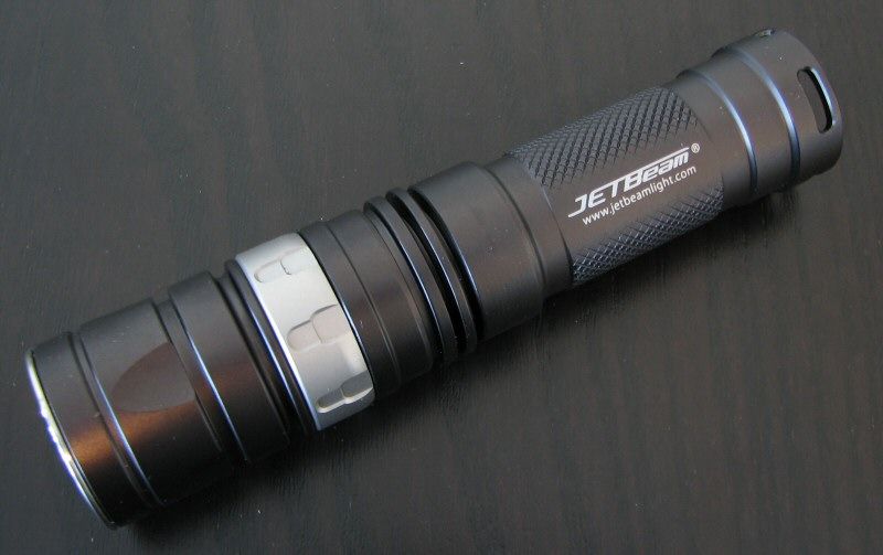

    Packaging is similar to the Jetbeam RRT26 that I recently reviewed – a simple clear plastic container, heat-sealed. You have to cut open the plastic to access the interior. This is not my favorite style of packaging, but seems to be the new norm for Jetbeam.

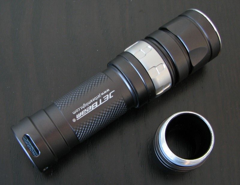

    Included with the light (with removable AA extender installed) is a basic wrist lanyard, extra o-rings, spare switch boot cover, basic holster (with Velcro closing flap), reversible pocket clip, product insert and warranty card.

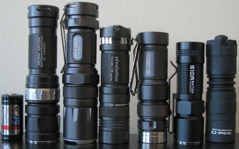

    From left to right: AW protected RCR; Jetbeam RRT0se; Nitecore SRT3; Sunwayman V11R; Jetbeam RRT-01; Olight S10R; Armytek Partner C1.
    From left to right: Panasonic Eneloop Pro AA NiMH; Jetbeam RRT0se with AA extender; Nitecore SRT3 with AA extender; Sunwayman V11R with AA extender; Olight 15R; Zebralight SC52.
    Jetbeam RRT0se: Weight: 74.7g, Length: 98.7mm , With (bezel): 26.4mm
    Jetbeam RRT0se (with AA extender): Weight: 83.4g, Length: 115.7mm , With (bezel): 26.4mm
    ArmyTek C1 XM-L: Weight: 43.0g, Length: 80.2mm , With (bezel): 23.1mm
    Lumintop ED11: Weight: 44.1g, Length: 83.7, Width (bezel): 21.8mm
    Foursevens QTLC: Weight 36.4g, Length 84.1mm, Width (bezel) 22.1mm
    Olight S10 (2013): Weight: 41.5g, Length: 70.8mm, Width (bezel): 23.2mm
    Skilhunt DS10: Weight: 47.0g, Length: 76.1mm, Width (bezel): 24.0mm
    Sunwayman V11R (no extender): Weight 50.5g, Length: 84.3mm, Width (bezel): 23.1mm
    Eagletac D25C Clicky: Weight: 30g, Length: 76.0mm, Width (bezel): 20.0mm
    Jetbeam PC10: Weight: 50.5g, Length: 93.6mm, Width (bezel): 22.6mm

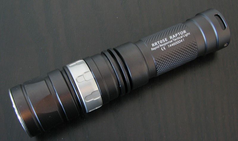

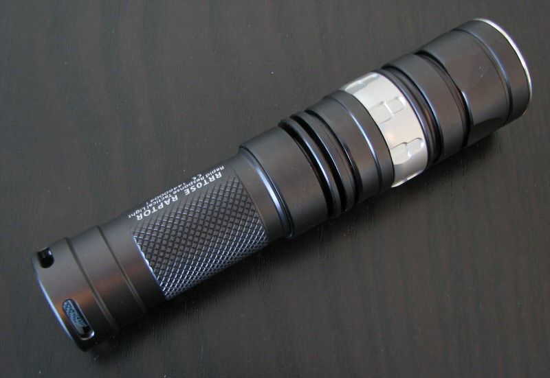

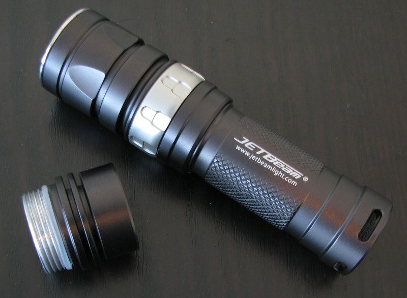

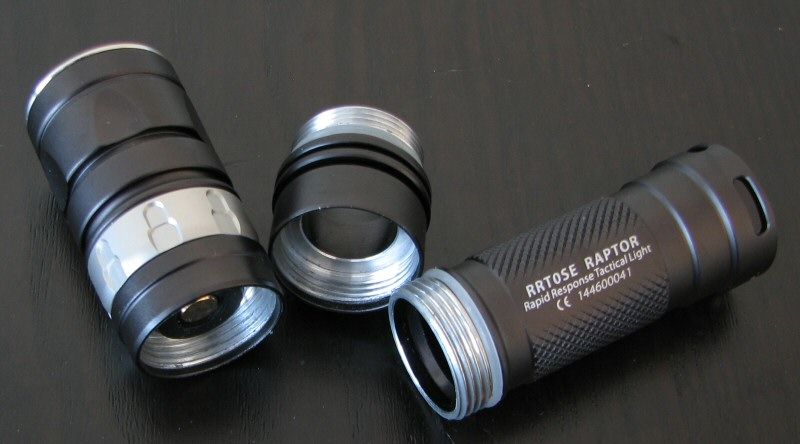

    Physically, in both stock and AA-forms, the RRT0se is longer than the Sunwayman V11R - more like the Nitecore SRT3 in fact (though not quite as beefy). Anodizing is a rich, dark gray natural finish (one of my preferred colors, personally). Labels are clear against the dark background. Knurling is very mild, but the ridge detail helps with grip (there is also a removable pocket clip, which can serve as an anti-roll device).

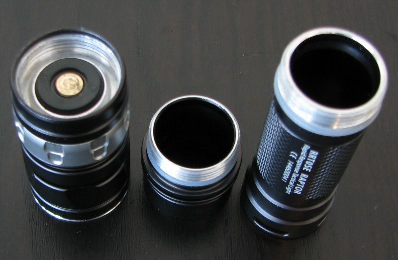

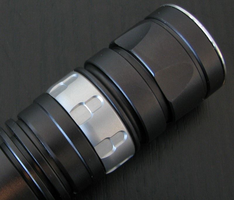

    The light uses a silver-colored aluminum control ring in the head, similar to the RRT26 that I recently reviewed. Feel is also similar – not quite as firm as I would like, but serviceable. Like the other Jetbeam lights, there are very clear "detents" that the RRT0se ring enters into before switching through the various output modes. There seems to be a mm or two turn required out of the standby detent before any light is produced (and the lowest level is higher than competing products). See my User Interface and testing results for further discussion.

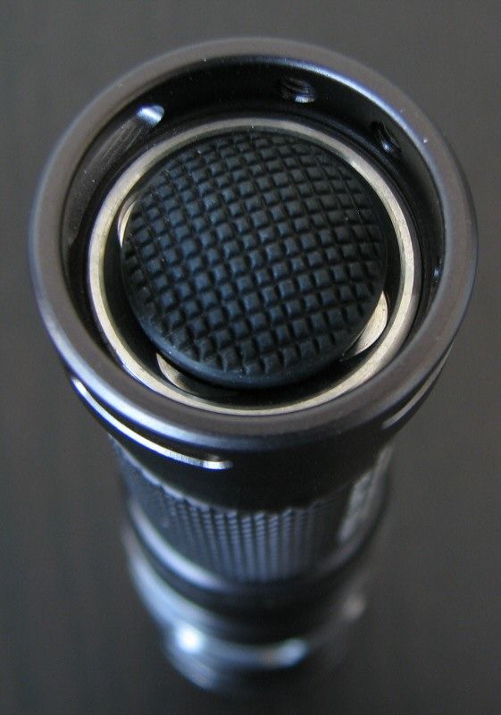

    The tail switch is a forward electronic switch. There is a built-up surrounding cover which allows tailstanding (and also somewhat restricts access to the switch).
    Screw threading is a standard triangular cut, and is not anodized (i.e., no head lockout possible). Same goes for the AA extender piece, which fits in between the body and the head. Threads feel unusually "gritty" even after a cleaning – on both the main body and extender regions. As with other lights with this feature, the extender piece has a narrower internal diameter, to prevent rattle of the thinner AA cells.

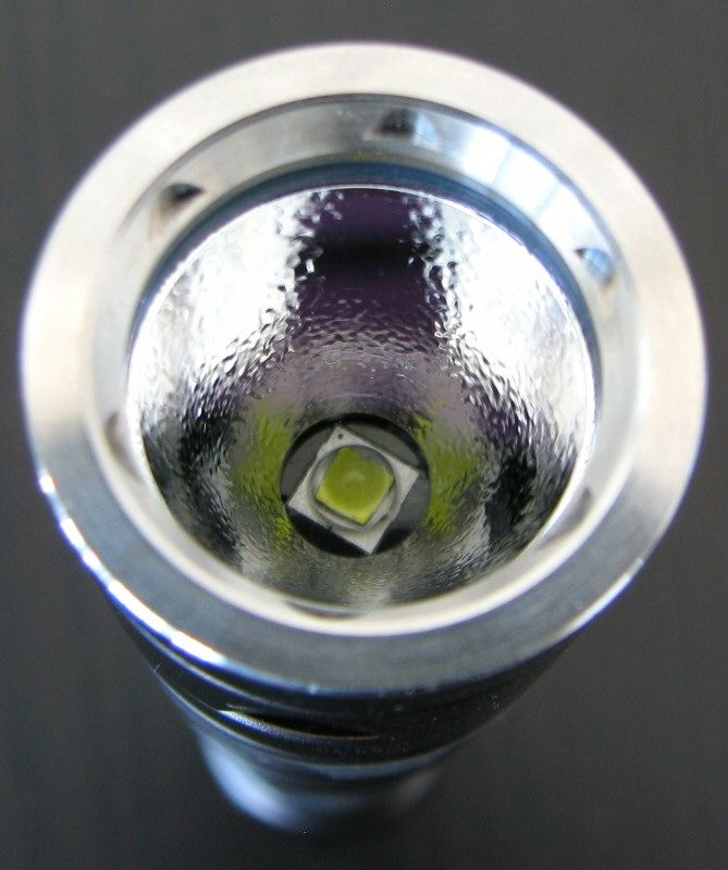

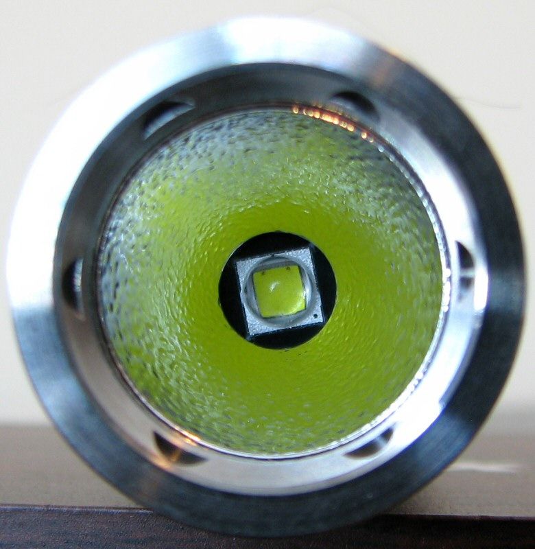

    The RRT0se uses a standard XM-L2 Cool White emitter. The emitter was reasonably well centered on my sample, coupled with a light orange peel reflector. Please scroll down for beamshots.
    The RRT0se has a forward tailcap clicky - press and release for momentary on, click for locked on.
    Mode switching is controlled by the magnetic control ring in the head. As previously mentioned, the RRT0se features a continuously-variable interface, as well as a couple of extra modes. Note that you can select your desired mode while the light is off, if you remember the sequence.
    The various output modes on the ring are separated by very clear detents (i.e., the ring stays firmly in position, and needs a bit of force to move into the next mode). Starting at the far left (i.e., holding the light out in front of you, with the ring all the way counter-clockwise), as you turn the ring to the right (clockwise), you get the following outputs modes:
    Strobe > SOS > Standby off > Continuously-variable ramp (>200 degree turn of the ring between detents) > Max.
    Each mode is set in a clear detent of the ring (except for the continuously-variable ramp, which is between the Standby off and Max detents). There is a slight delay of a mm or two, coming out of the standby detent, before any continuously-variable light is produced.

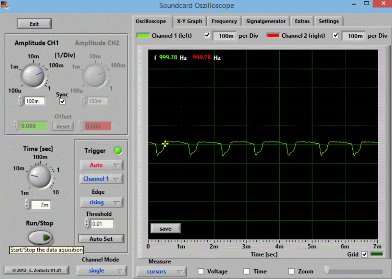

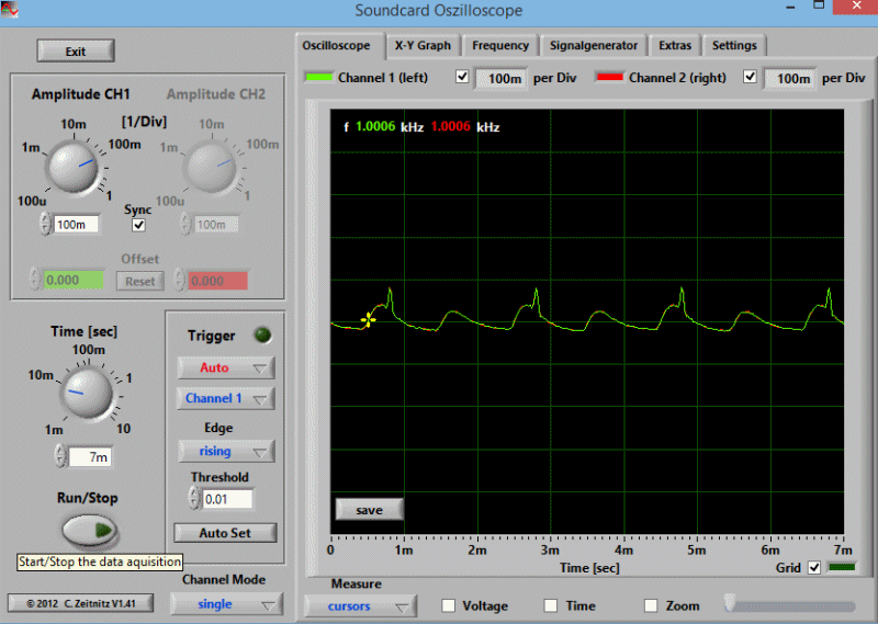

    PWM/Strobe
    The RRT0se shows signs of pulse width modulation (PWM). It's a little unusual though, so let's go through two sets of conditions, starting with 3.7V Li-ion (14500), followed by 1.2V NiMH (AA).
    RRT0se 14500 Max:
    As you can see, there is a small reoccurring signal on max output, at 545 Hz. But watch what happens when you first start to dial down the control ring
    RRT0se 14500 Near-Max:
    Now, a new sine wave-like harmonic appears at a reoccurring 1.0 kHz frequency. The 545 Hz signal is still present, superimposed over this signal (i.e., it looks like it is "riding" every other crest of the wave).
    RRT0se 14500 Hi:
    Quickly, this max signal disappears and we just left with a pronounced harmonic. This does not look like PWM yet.
    RRT0se 14500 Med:
    By the med level, the shape of the signal changes, suggesting a reduce on-time. However, this is still not the classic square-wave PWM pattern.
    RRT0se 14500 Lo:
    The on-pulse cycle seems further reduced, consistent with PWM.
    And now for a lower voltage source:
    RRT0se AA Max:
    RRT0se AA Med:
    RRT0se AA Lo:
    Ok, again, these are not the classic square-wave PWM signals that I am used to seeing. But there does seem to be a varying on/off duration (with constant frequency), consistent with a PWM control mechanism. I am guessing that there is some sort of additional filtering going on that is smoothing out the PWM on the oscilloscope pattern.
    At the end of the day, the "flicker" from this PWM is pretty minimal, given the 1kHz frequency. I am quite sensitive to PWM and can see it in use, but I suspect most will only notice when shining on a fan or running water (or similarly fast moving objects).

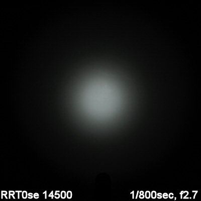

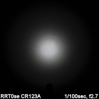

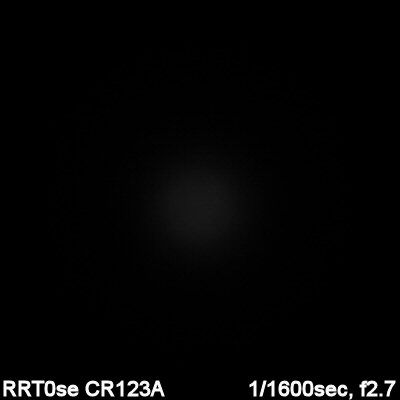

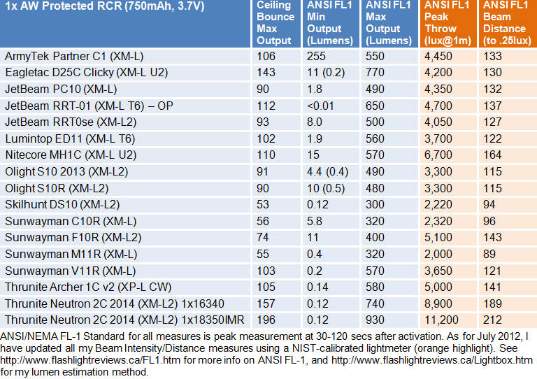

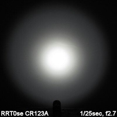

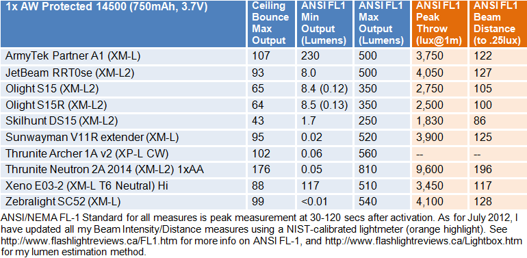

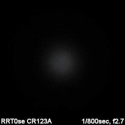

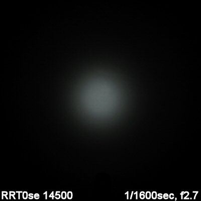

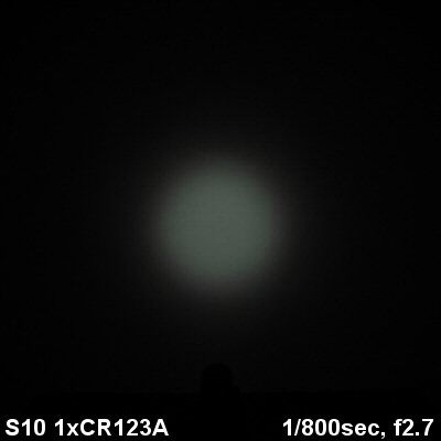

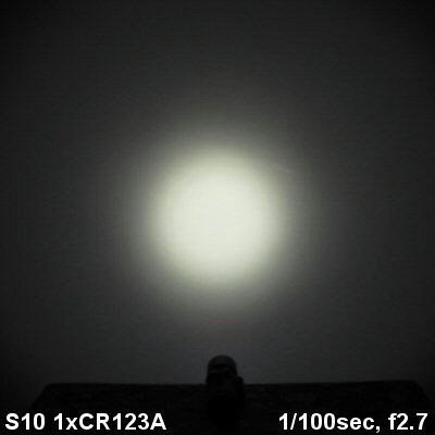

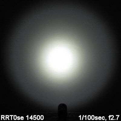

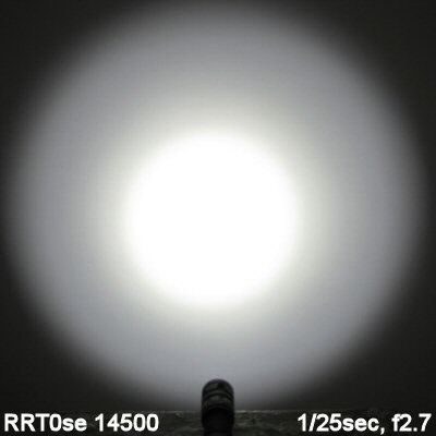

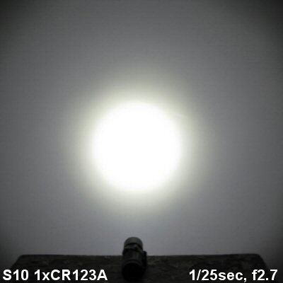

    For white-wall beamshots below, all lights are on Max output on an 3.7V Li-ion (RCR) battery. Lights are about ~0.75 meter from a white wall (with the camera ~1.25 meters back from the wall). Automatic white balance on the camera, to minimize tint differences.
    1xRCR Comparison (note that I used a 14500 in these tests, as output is exactly the same as RCR)
    1xCR123A Comparison

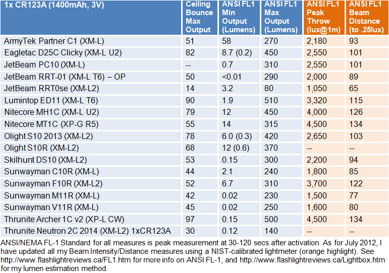

    First thing you will notice is that max output is greatly reduced on the CR123A battery source. That's because I waited ~30 secs before taking this pics - initial output on CR123A is much higher (but not as high as RCR). Scroll down for discussion.
    As usual with the recent Jetbeam lights, the stated max output spec ("730 lumens") doesn't seem very believable – the best that I found was ~500 estimated lumens, on 3.7V Li-ion sources.
    The other issue is how the light handles lower voltage sources. As you can see above, max ANSI FL-1 output levels are a lot lower on CR123A/AA. Note that 3.0V CR123A is brighter initially (~300 estimated lumens), but my sample suddenly steps-down (usually within ~15 secs) to approximately match the level of 1.2V AA sources. I suspect that that this is an issue with my sample, as the time was variable when it jumped down to AA levels (i.e., sometimes it last longer, sometimes faster). I would have expected consistent intermediate performance between AA and RCR/14500 at around this ~300 lumen level.
    Also, the minimum output levels are a bit disappointing, at ~8 lumens on 3.7V Li-ion. I would have liked to have seen true moonlight/firefly modes.

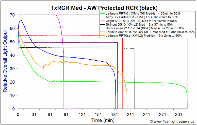

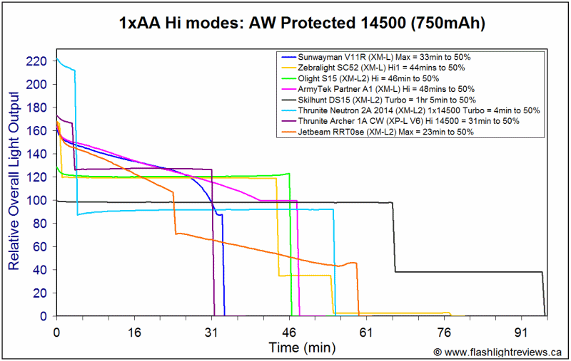

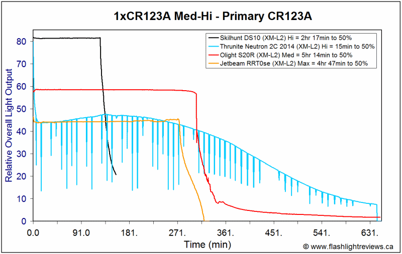

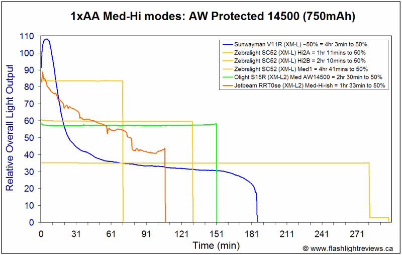

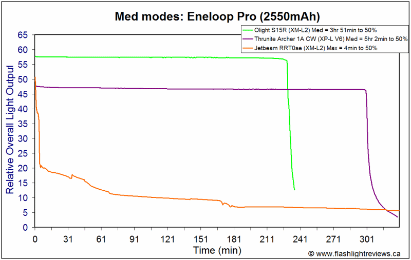

    Output/Runtime Graphs:

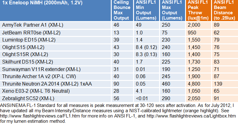

    First the good news – at least at the higher outputs, overall efficiency seems very similar to the Sunwayman V11R. The RRT0se even shows similar "output drift" issues over time). But the RRT0se shows a somewhat "noisier" regulation pattern, with small changes in output occurring on most modes over time.
    It is also disappointing to see the fairly low max output on AA/CR123A. The CR123A issue is one I suspect is specific to my sample, as it should produce be able to consistently keep its ~300 lumen max initial high level without drop-off to AA levels. I tried various brands of CR123A, with no difference – all drop down within the first minute of testing.
    In any case, the ~80 lumen max level for AA is also low. The RRT0se is really a light to be used on 3.7V Li-ion sources if you want to get the full range of features.
    Note as well that although I don't test min outputs (for max runtime), don't expect much more than what you are seeing reported above. There is a high overhead current on the circuit, limiting long-term runtime (see the Standby Current section above).
    Although the RRT0se has a physical tail switch, there is a standby off detent on the ring that requires a stand-by current. This current is high, and will drain all types of batteries within a few days. The high overhead means that max runtimes are also limited to under a couple of days as well.
    Similarly, minimum output is higher than most lights with variable control rings (i.e., ~8 lumens min, on 3.7V Li-ion). I would have preferred to see true Moonlight/Firefly modes (with lower currents).
    The RRT0se is only able to produce the widest range of output on 3.7V Li-ion sources (i.e., RCR/14500) – and even these are well below the rated specs, at ~500 estimated lumens. On AA, you are limited to a max output <100 estimated lumens. On CR123A, you get initially an intermediate ~300 lumens on max – although my sample consistently steps down to the AA <100 lumen level within seconds, on all brands of CR123A that I have tried.
    The RRT0se uses some form of filtered PWM at all levels, at a visually detectable 1kHz. This is high enough as to not be distracting in actual use (although some may be more sensitive to it than others).
    Overall output/runtime efficiency is similar to competing PWM-based lights with comparable features, but the RRT0se shows a less consistent regulation pattern.
    The control ring does not appear to use a "visually-linear" ramp of output, but rather a circuit-linear ramp (i.e., the light subjectively appears to have a lot more relatively higher outputs than lower ones).

    In terms of output, the RRT0se does not meet its rated "730 lumens" spec (a consistent over-statement that I've noticed across all the recent Jetbeam "se" lights). While the true ~500 max lumens here is still quite reasonable for 1xRCR/14500, it is disappointing that CR123A and AA are so much lower (i.e., it produces only ~80 max lumens in my testing on these sources). It's true that fresh CR123As do start at an intermediate ~300 max lumens in my testing (as I would have expected). However, my sample always drops down to the AA level of <100 lumens very quickly. Ultimately, this low performance really limits the broad usefulness of supporting multiple battery sizes in the first place.
    While overall output/runtime efficiency (at higher outputs) is similar to the competing lights, my RRT0se shows less consistent regulation (i.e., a more "noisy" pattern). It also has a higher circuit overhead than the competing lights, limiting maximum runtime available here. The RRT0se doesn't go to as low in min output as the V11R or SRT3 either.

    I use an Orbotronic 700mAh RCR123 in it and I just ran it on "turbo" mode for five measured minutes with no noticeable reduction in output. In direct comparison, it appeared to be putting out more light than my Thrunite TN20 and Fenix UC35 on "high" (both running 18650s; 440 lumens and 480 lumens, claimed on "high" respectively). I also ran it for five minutes on "turbo" using the battery extension and a 14500 battery; same result. It is much less bright running on a AA Eneloop Pro.
    That's perfectly consistent with my sample - there is no issue on RCR or 14500. The change in output over time (on turbo) looks significant on the graph, but you cannot see it by eye. Exactly the same performance as the Sunwayman V11R in that regard.
    How does your sample do on CR123A? That is where mine steps down from the intemediate max (between RCR and AA), down to AA level after a variable number of seconds.
    Funny... I had never even tried a CR123A in my light. I just did, and the results were consistent with yours! It started out fairly strong, but faded after a half a minute or so (or less?).
    Thanks for testing. Good to know it is not just my sample (but of course, not good that that this happens).
