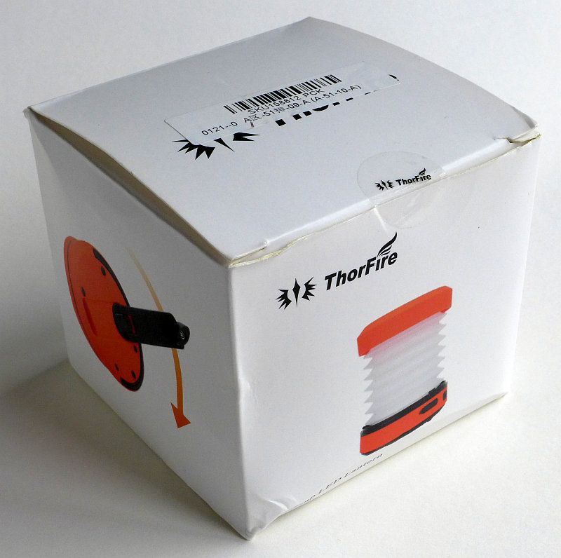

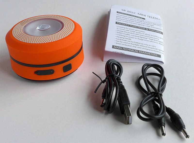

    The supplied box.
    And the box contents.

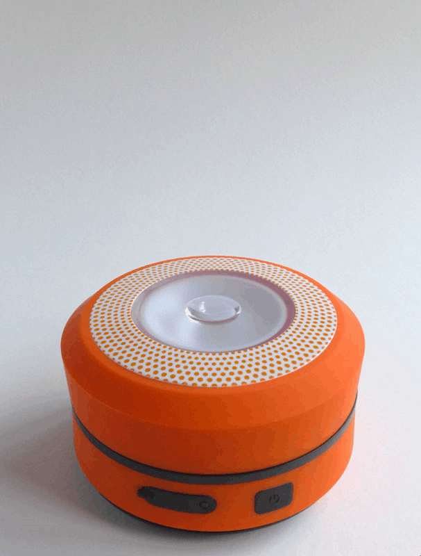

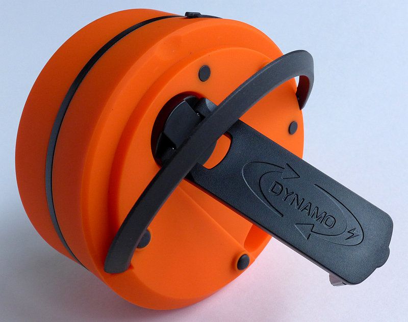

    The base has the hand-crank and hanging loop

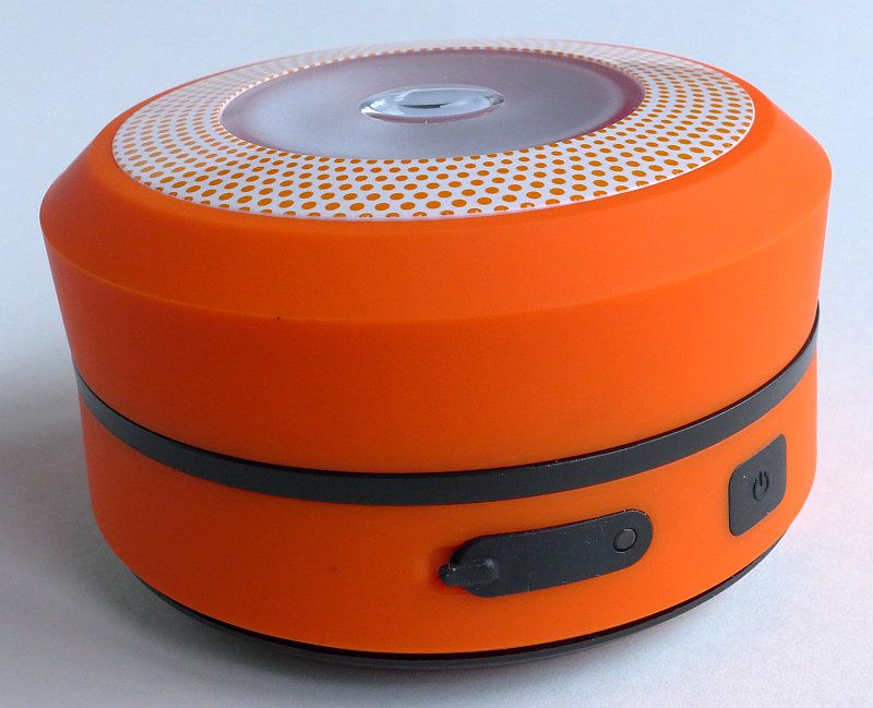

    The charging port has a rubber fold out cover which also has an indicator light and next to this is the power switch.

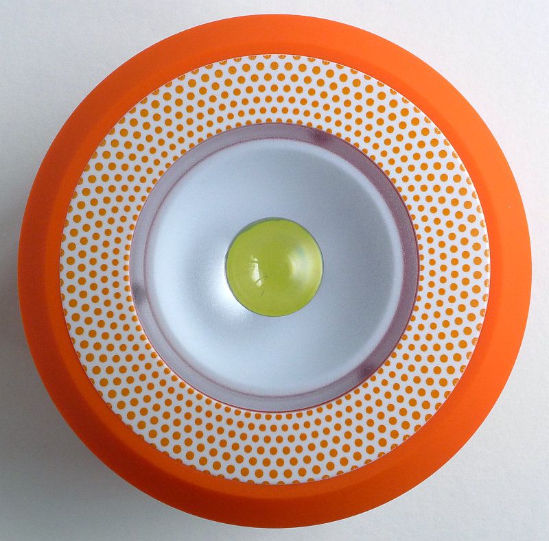

    When folded the camping lantern can be used as a torch.
    The body has a concertina like collapsible body that can be stretched out to become a lantern.

    On the base is a Hand Crank which allows for recharging of the built in 300mAh cell with no other power source.

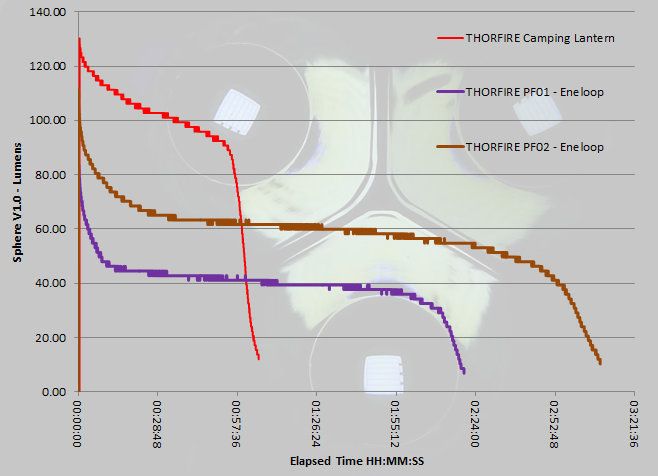

    THORFIRE telescopic camping lantern I.S. measured ANSI output Lumens PWM frequency or Strobe frequency (Hz)
    High 125 0
    Low 29 0
    There is no measurable PWM.

    Running on Maximum, this is the output graph with a freshly charge. It is shown along with the PF01 and PF02 also tested for a Performance Review.

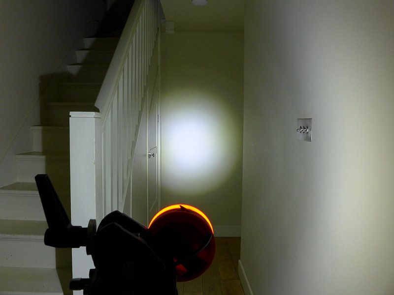

    Used in torch mode, the beam looks like this
    Stretching out the body the lantern is in area lighting mode.

    The original sample was not supplied with the correct cables. It should have included the female USB-A cable seen here. The package now includes the male and female USB-A cables.
    This allows the hand crank to be used to charge a phone in an emergency (as well as charging the internal cell for the lamp. When a phone is connected, the hand crank resistance does go up quite a lot and using the USB charge doctor it showed the charging current delivered varied between around 0.25A and 0.4A depending on how fast you crank it.
    A useful feature to have, but not one you will want to use regularly as it is hard work to keep it up for any extended period.
