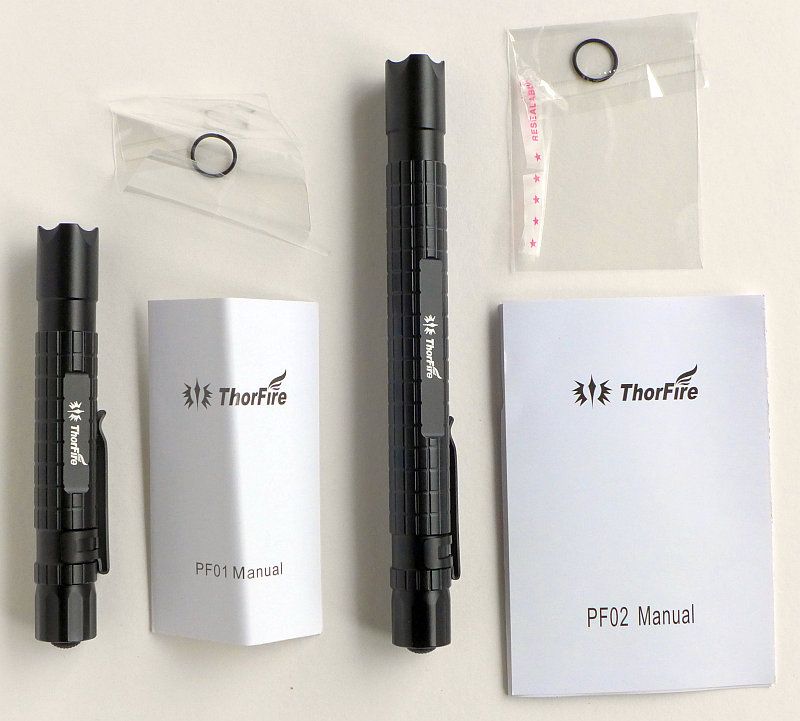

    Each light has a spare O-ring and instruction manual.

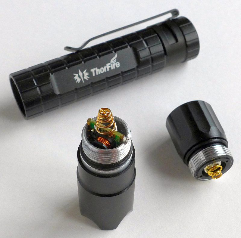

    Easily dismantled, both lights have an in-line circuit board with edge mounted positive contact spring.

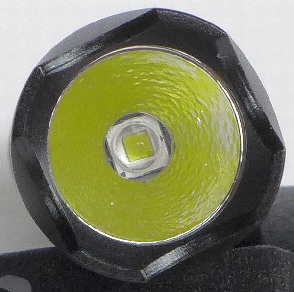

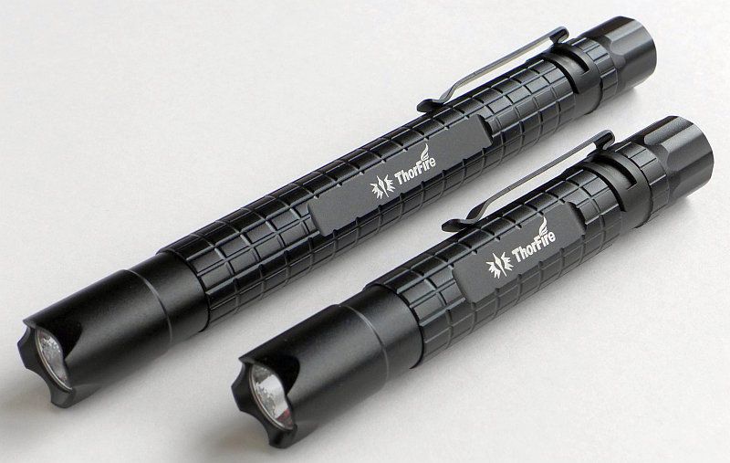

    Both models use the XP-E2 LED and a small textured reflector.

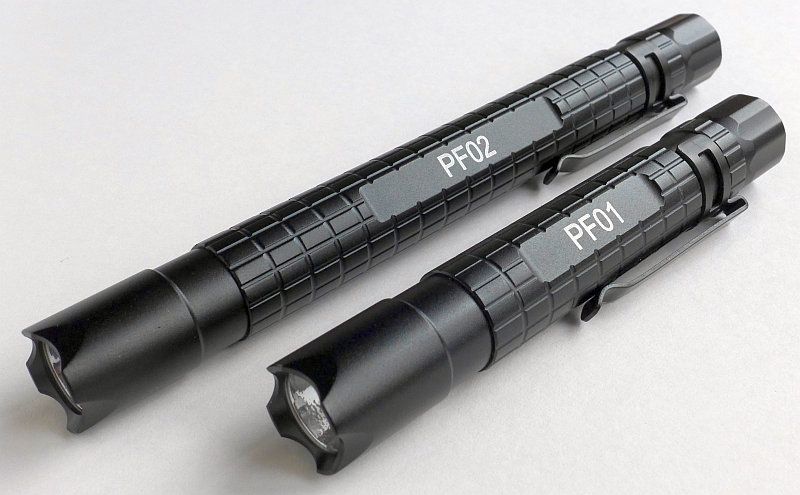

    The model is laser engraved on each light.

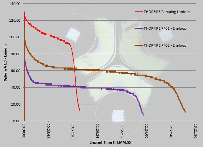

    Running on Maximum, this is the output graph when using NiMh Eneloop cells. The THORFIRE Camping Lantern is also included in this graph.

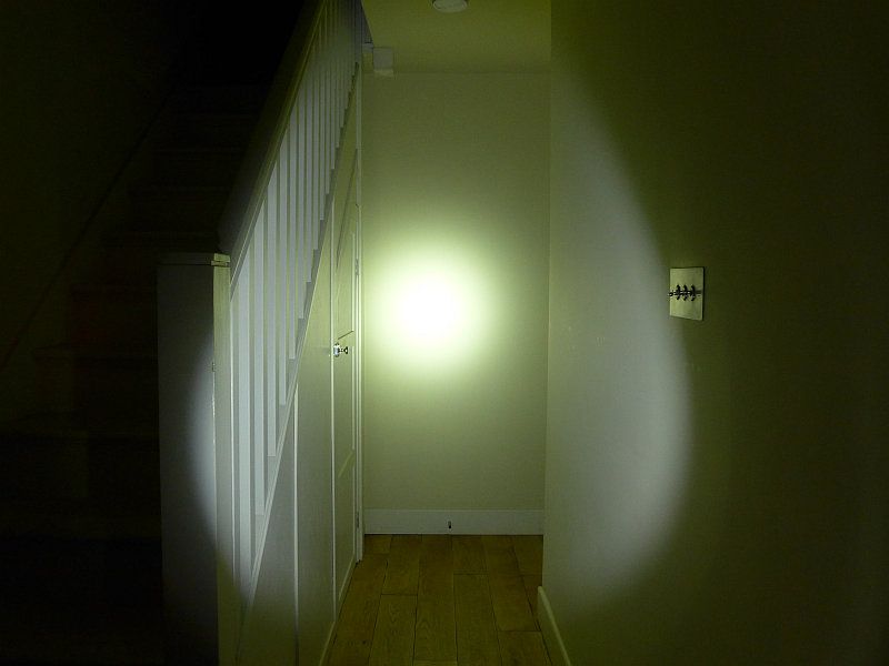

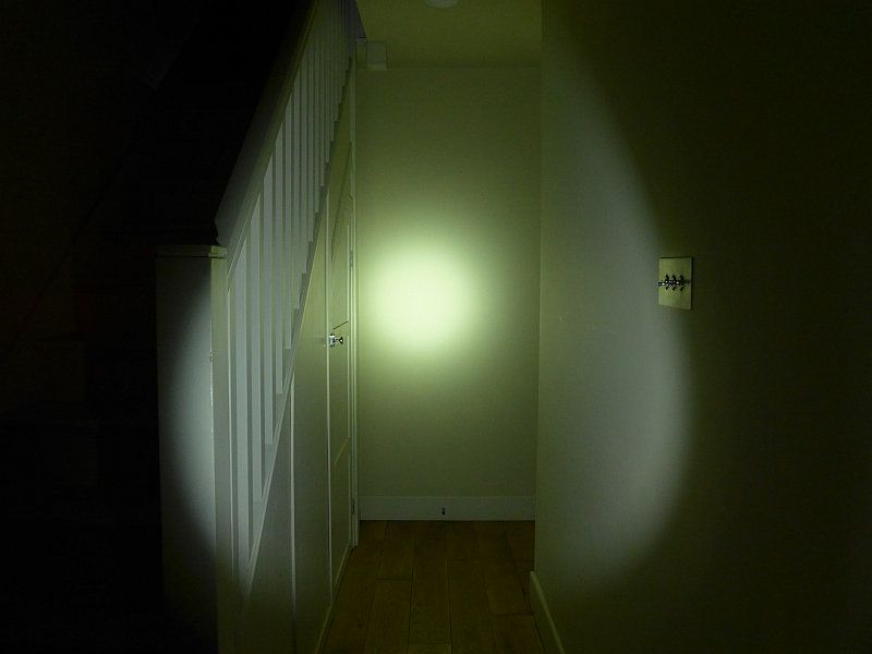

    The PF01's beam looks like this.
    With the reflector looking identical to other model, the PF02 has much the same beam as the PF01.
