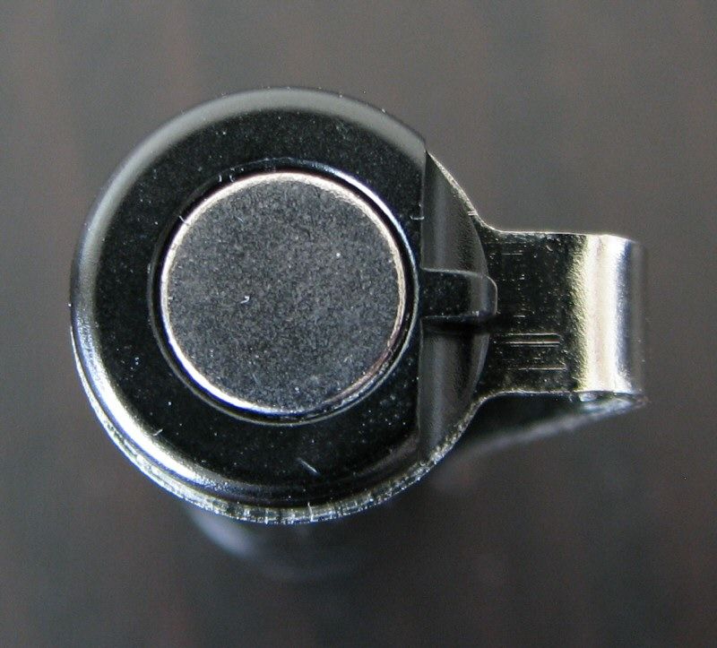

    • Strong rare earth magnet installed at the tailcap (grey color coated)

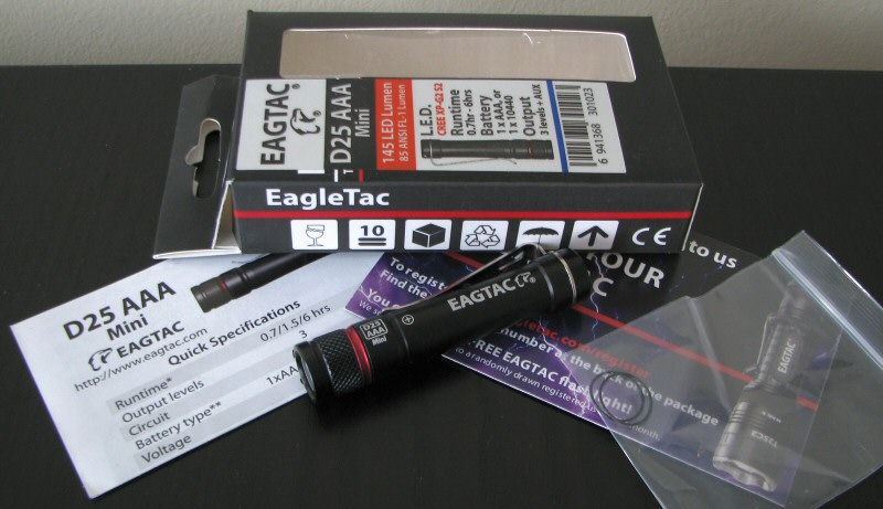

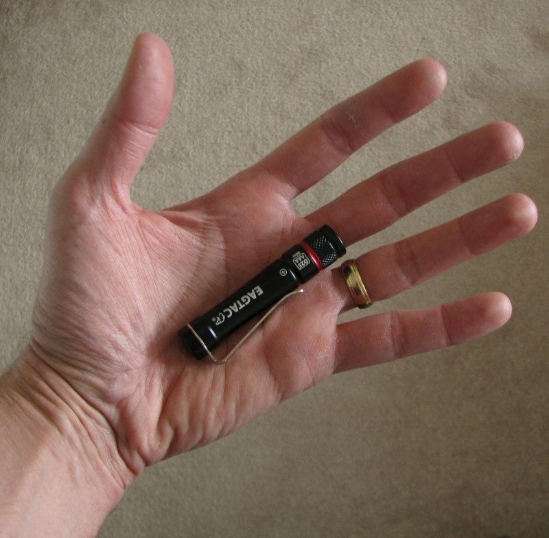

    Packaging is pretty basic, consistent with this class. Outside of the box has the usual detailed specs. Inside, you get the light and standard extras – extra o-rings, pocket clip (attached), manual, and product inserts.
    You'll note the wide range of emitters available. This review of the XP-G2 S2, specifically.

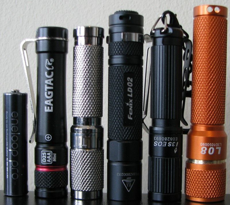

    From left to right: Panasonic Eneloop Pro NiMH AAA; Eagletac D25 AAA; Thrunite Ti; Fenix LD02; Olight i3S (2014); L3 Illumination L08.
    All dimensions directly measured, and given with no batteries installed (and without keychain ring, where removable):
    Eagletac D25 AAA (with clip): Weight: 13.4g, Length: 69.8mm, Width (bezel): 14.1mm
    Fenix LD02 (with clip): Weight: 16.5g, Length: 76.9mm, Width (bezel): 14.4mm
    Fenix E99Ti: Weight: 18.7g, Length: 66.1mm, Width (bezel): 14.1mm
    Foursevens Preon P0: Weight 13.0g (with keychain clip), Length 55.0mm, Width 12.6mm (bezel)
    Foursevens Preon P1: Weight 15.3g (with keychain clip), Length 75.6mm, Width 14.0mm (bezel)
    Klarus Mi X6: Weight 16.2g, Length 72.9mm (battery installed), Width 12.8mm
    L3 Illumination L08: Weight: 22.4g, Length: 77.8mm, Width (bezel): 17.0mm
    Lumintop Worm Aluminum: Weight: 14.3g, Length 72.0mm (battery installed, off), Width 14.1mm (bezel)
    Olight i3 (2013/14): Weight 12.3g, Length: 69.3mm, Width (bezel): 14.0mm
    Thrunite Ti3: Weight: 11.5g, Length: 69.9mm, Width (bezel): 13.6mm
    Titanium Innovations Illuminati Aluminum: Weight 13.9g (with keychain clip), Length 68.8mm, Width 14.0mm (bezel)

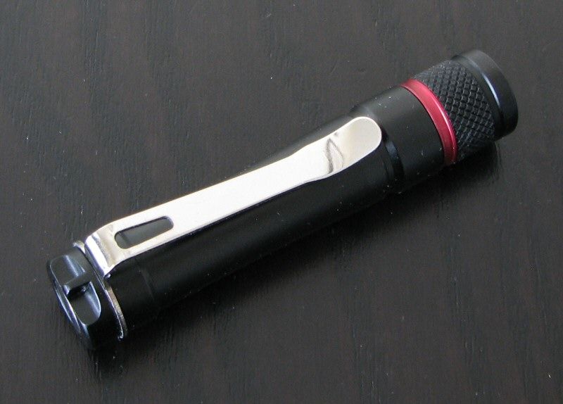

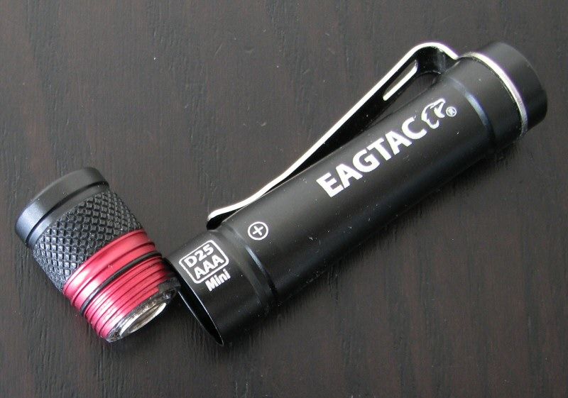

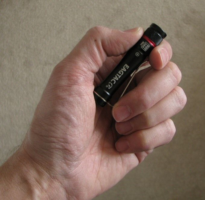

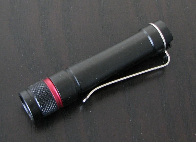

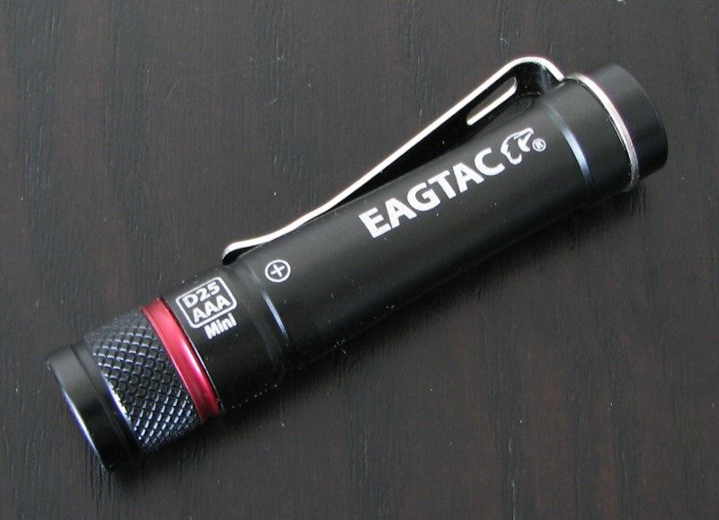

    Anodizing is typical matte black, with no chips or blemishes on my sample. White lettering is clear and sharp. There is very little knurling – just a bit on the head. The body would be rather slippery to handle, if it weren't for the attached clip (which seems solid). The light is easy to use one-handed.
    With the pocket clip in place, the light will not roll. Clip base holds on to the light extremely securely, and cannot be pulled off. You can however easily unscrew the tailcap portion of the light, and simply remove the clip (and re-assemble without). Of course, the clip not reversible.
    Screw threads actually seem somewhat trapezoidal (i.e., square cut). Threads are anodized to different colors – you can pick what you like (red shown here). Light uses a twisty control interface.
    There is a physical reverse polarity feature in the head, so only standard button-top AAA cells can be used. This will likely be a problem is you plan to use 10440 – most ones I've seen have too large of a button top. I needed to solder a dab to the center of the head to be able to use my 10440s.

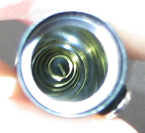

    There is a spring in the tailcap, which should limit potential denting of batteries (always a concern on twisty lights)
    There is a small cut-out on the tail for a split ring attachment point. Tailstanding is good. There is a fairly strong magnet in the tailcap, allowing you to stand the light horizontally on any metal surface.

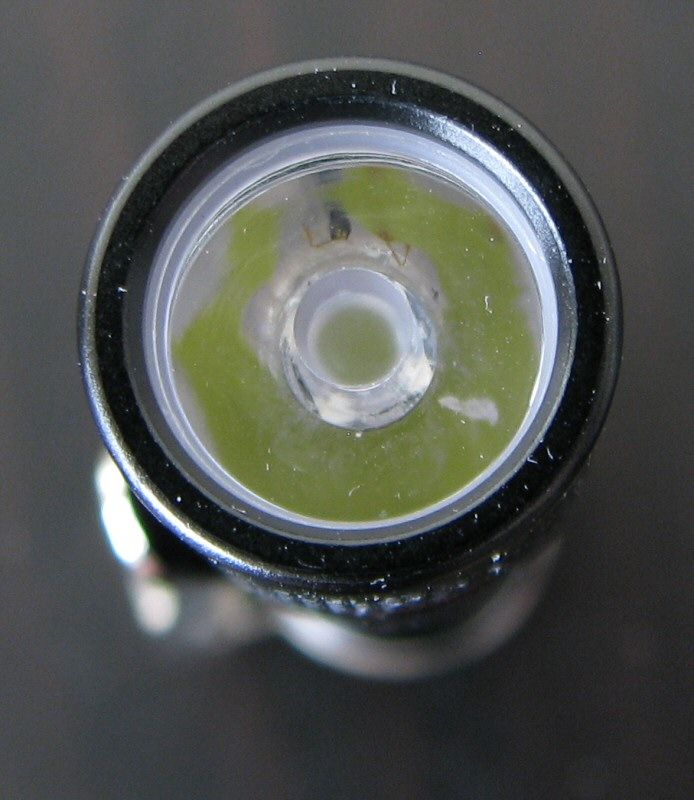

    Unlike many keychain lights (which use a small reflector), the D25 AAA uses a small optic for focusing. I'm starting to see this more and more though (e.g., my recent Fenix LD02 review).
    Note there is no damage to the optic above – those are just reflections being picked up and distorted. Please see my detailed beamshots later in this review.

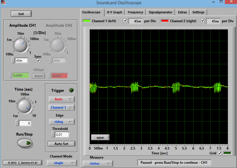

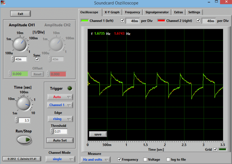

    No PWM
    There is no sign of pulse width modulation (PWM) at any output level on the D25 AAA. There is however a circuit pattern visible on the lower outputs on my oscilloscope (which is uncommon on many lights).
    Hi:
    Again, there is no obvious circuit signal on Hi.
    Med:
    Lo:
    There is a high frequency re-occurring patter on Lo/Med. However, this is not PWM, and it is not visible to the eye. As usual, I simply report on anything that I can measure with my oscilloscope. This does not manifest as any visual effect that you can see.
    Strobe 1:
    The main strobe is a high frequency strobe, measured at 10 Hz on my D25 AAA.
    Strobe 2:
    The second strobe mode is an alternating or "oscillating" strobe, switching between 6.3Hz and 15.0Hz every 2 seconds.
    Strobe 3:
    The third strobe mode is really a slow flash signaling strobe, with a 1.7 Hz frequency.
    SOS 1:
    First SOS is relatively fast.
    SOS 1:
    Second SOS is relative slow.
    Beacon 1:
    First beacon mode is a 1.5 sec full power flash every 13 secs.
    Beacon 2:
    Second beacon mode is a reduced power flash of 0.5 secs, every 2.5 secs.

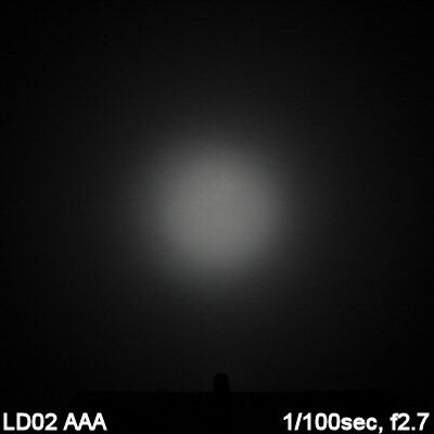

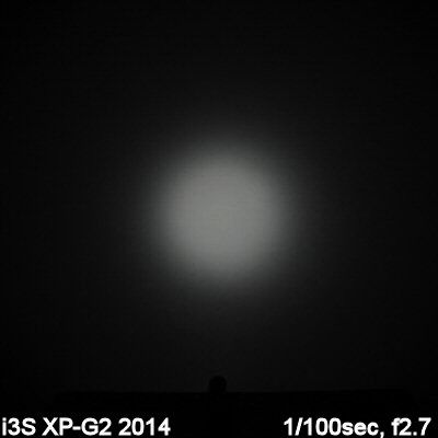

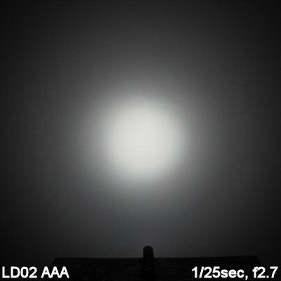

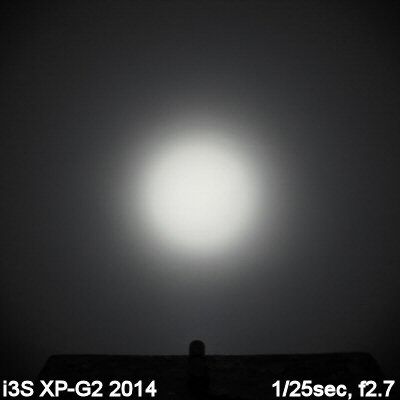

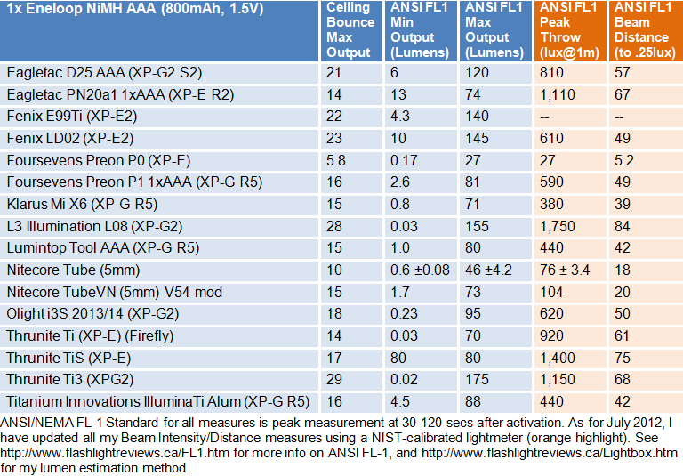

    For white-wall beamshots below, all lights are on Max output on an Eneloop NiMH AAA. Lights are about ~0.75 meter from a white wall (with the camera ~1.25 meters back from the wall). Automatic white balance on the camera, to minimize tint differences.
    The optic on the D25 AAA focuses a lot more light into the hotspot (i.e., spill beam is relatively dim). As a result, these pics make it look like the D25 AAA is brighter than it actually is (scroll down for actual output measures).
    Max output is reasonable for the class, although not as high as some other recent lights I've tested. The low mode seems higher than most other multi-level lights, although likely still reasonable for most.
    To explore output levels further on AAA vs 10440 Li-ion, here is an estimated lumen table on all modes:
    It is really only the Hi mode that is significantly different on the D25 AAA.

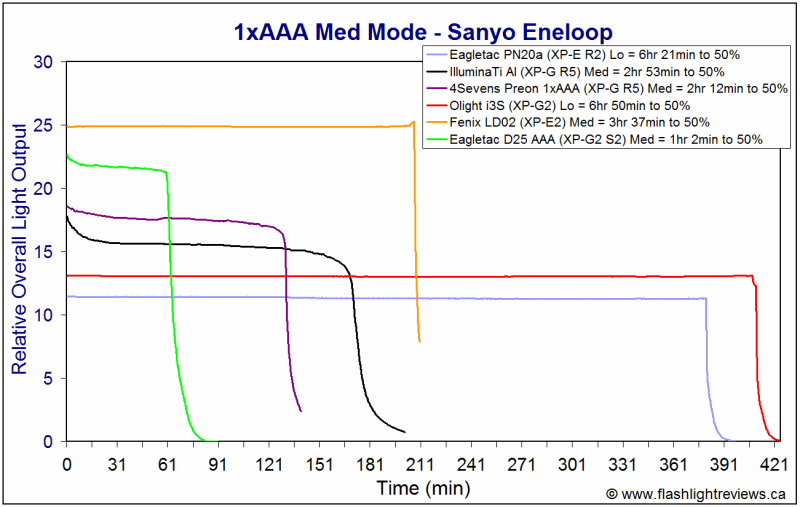

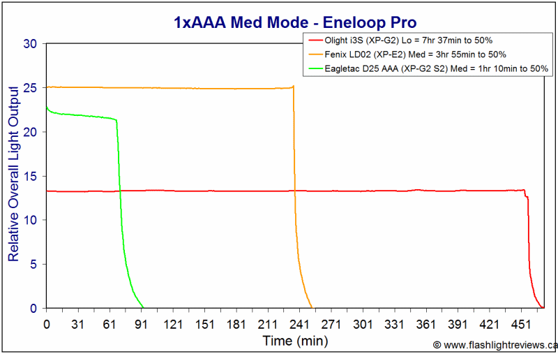

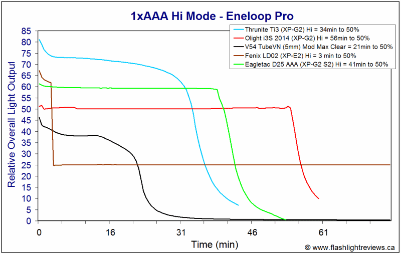

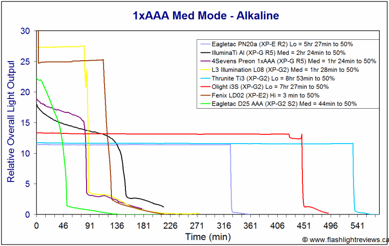

    Runtimes

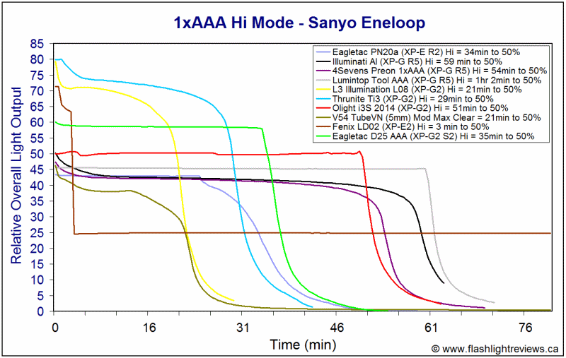

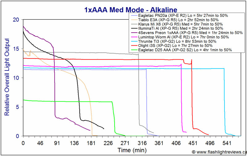

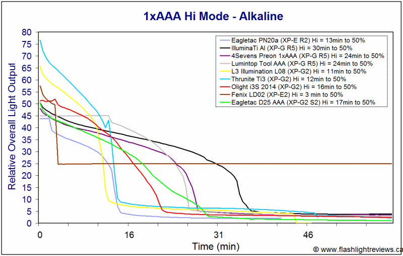

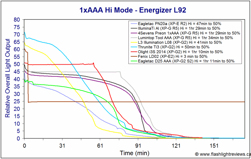

    For all my AA/AAA reviews, I've started including Panasonic Eneloop Pro NiMH cells. For AAA, these are basically the same as the second generation Sanyo Eneloop "XX-powered" Pro cells, now manufactured under the Panasonic name. They have a typical capacity of 950mAh (900mAh min), which is higher than the original Sanyo AAA Eneloops (typical 800mAh). For the time being, I will show both types of cells in my reviews.
    Standard AAAs:
    Ok, that's a lot of data up there. First thing I noticed is the relatively poor efficiency of the Med/Lo mode on the D25 AAA. I am at a loss as to why this would be the case – although I note the Eagletac specs are at least consistent with my testing results.
    On Hi mode, performance is pretty good – although there is a drop-off in max output on L92 for some reason.
    It seems to be really on the Lo/Med modes where this light significantly under-performs the competition.

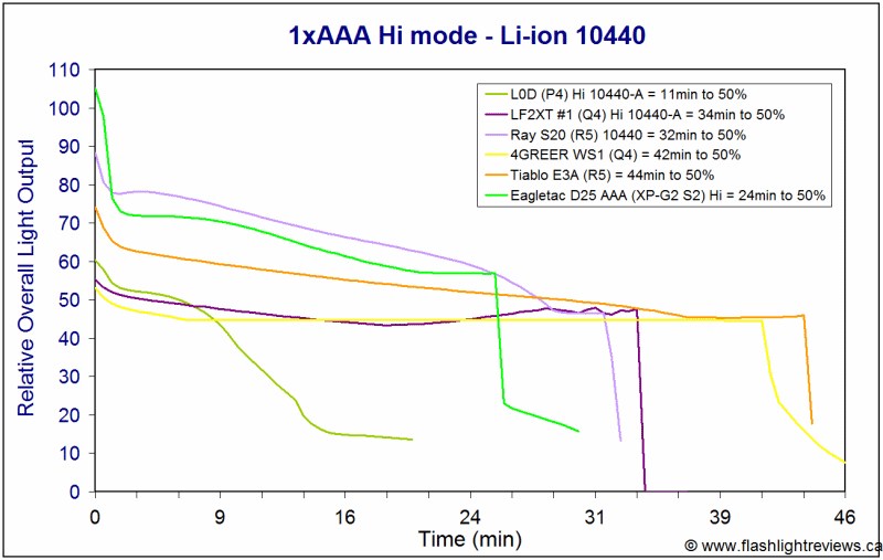

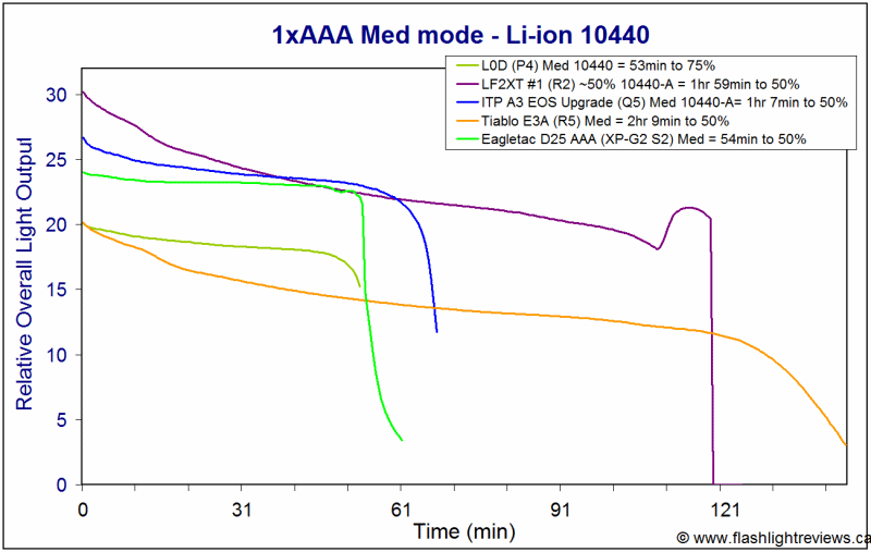

    10440 Li-ion:
    I don't have a lot of data on recent lights on 10440, but the results above suggest a similar pattern (i.e., reasonable efficiency on Hi, poor efficiency on Med). Note that max output drops rapidly on Hi on 10440, soon approaching a slightly higher output than standard AAA NiMH Hi levels.
    Efficiency of the Med/Lo modes is much lower than you would have expected for this class (although is consistent with published Eagletac specs). Hi mode seems perfectly reasonable, in comparison.
    Lo mode (min output) is not as low as some in this class (i.e., no moonlight mode).
    There is no memory mode, and the D25 AAA always starts on Lo.
    The reverse polarity protection feature prevented any of my 10440s from working (i.e, you need to have a very small projecting button on the positive battery terminal). A dab of solder on the center of the contact disc in the head was required to get 10440s working on my sample.
    The D25 AAA drops down from Hi rapidly on 10440, as you might expect. After a few mins runtime, output is only slightly higher than the standard AAA NiMH Hi mode

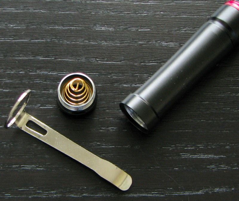

    Hmmm...I thought EagleTac was ditching this clip for one that is removable? Guess that's not going to happen anytime soon.
    I'm waiting for the updated clip and I'd like to get the UV version.
    Default Re: Eagletac D25 AAA (XP-G2 S2, 1xAAA/10440) Review: BEAMSHOTS, RUNTIMES+
    Thanks for the review. Seems a lot is compromised in AAA lights to keep them small, of course that's the purpose.
    6,936
    Quote Originally Posted by Nighted View Post
    Ah sorry, I should have shown how easy it is to remove:
    The tailcap easily unscrews, and the clip comes right off. Advantage of this approach of course is that the clip cannot come off by accident.
    Enlightened Nighted's Avatar
    Jun 2013
    23
    Ahhhh...much better. Thanks!
    Selfbuilt, you rock! Thanks always for your incomparable reviews.
    Did you use a pair of pliers to unscrew the tailcap so you could remove the clip? (I guess I have weak hands?)
    -LetThereBeLight!
    6,936
    No, it came off by hand on my sample. But it does hold on quite stiffly, so there is no risk of accidentally unscrewing.
