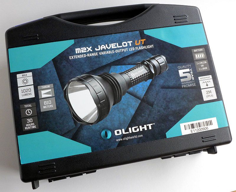

    The M2X-UT is supplied in a nice plastic carry case.

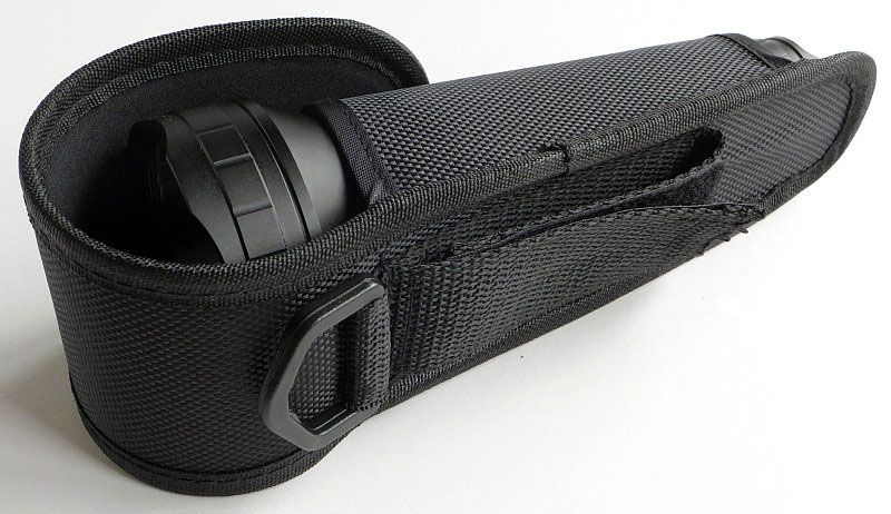

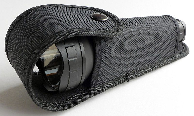

    Fitted into the holster, the tail-cap protrudes from the bottom.
    Carry options include a D-loop and Velcro closed belt loop.

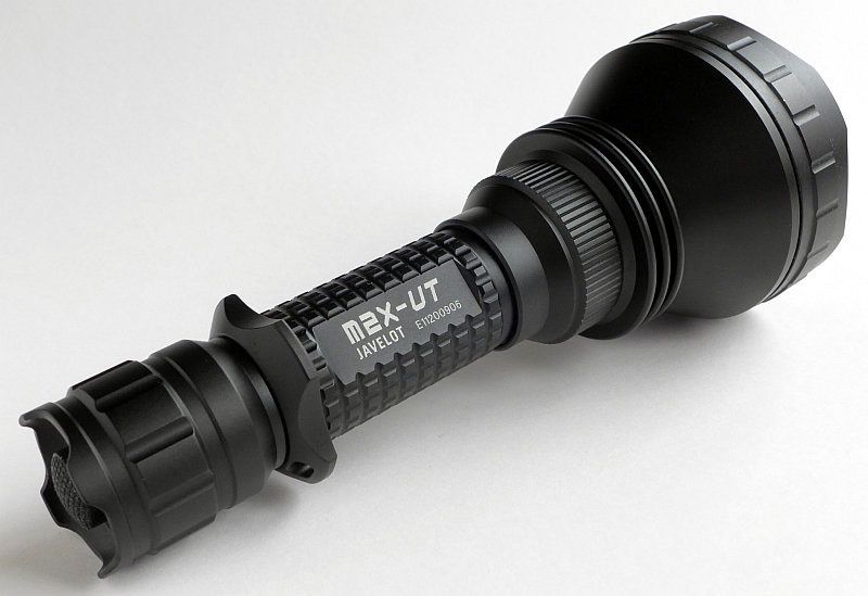

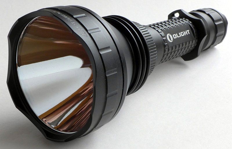

    A very large head and reflector top off this light. We will be looking at this in much more detail.
    Details of the heatsink, grip ring and machining can be seen.

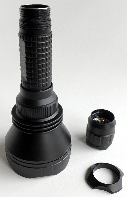

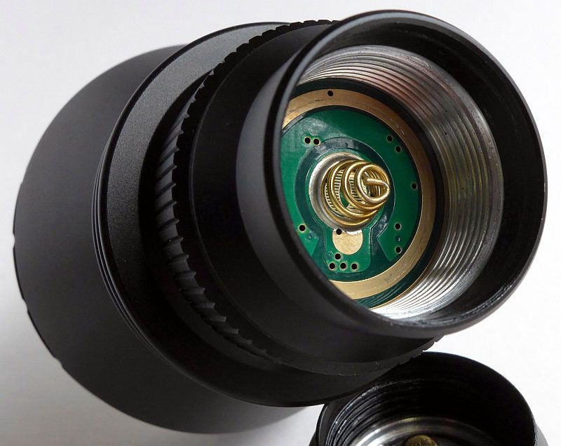

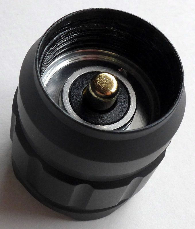

    Taking the battery tube out shows the contacts in the head consisting of the bare threads, contact ring and sprung positive contact (allowing the use of flat top cells).
    The tailcap has a contact for the end of the battery tube and a sprung plunger negative contact.

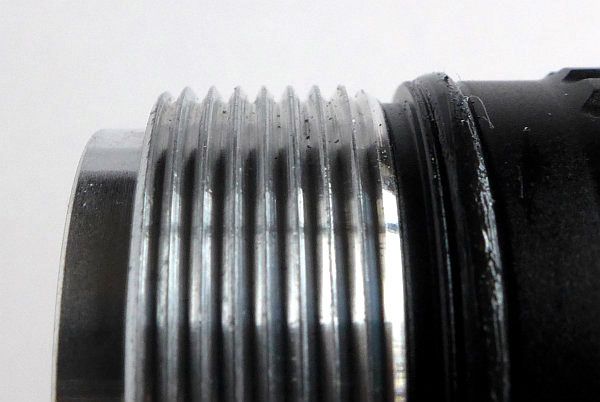

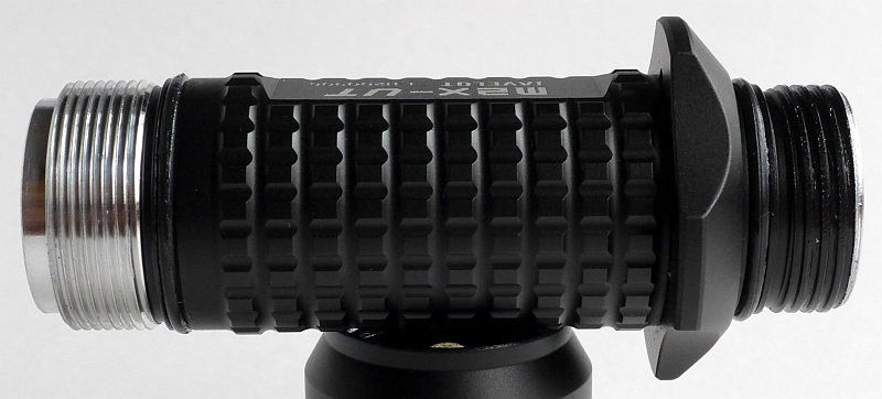

    The threads used at each end of the battery tube differ.
    At the head end they are standard bare metal threads.
    At the tail-cap end they are anodised square cut threads.
    The grip ring can be slid off when the tail-cap is removed. When fitted, it 'floats' so moves slightly when used.

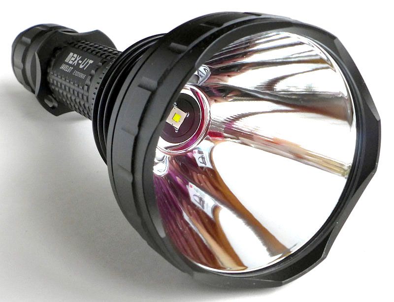

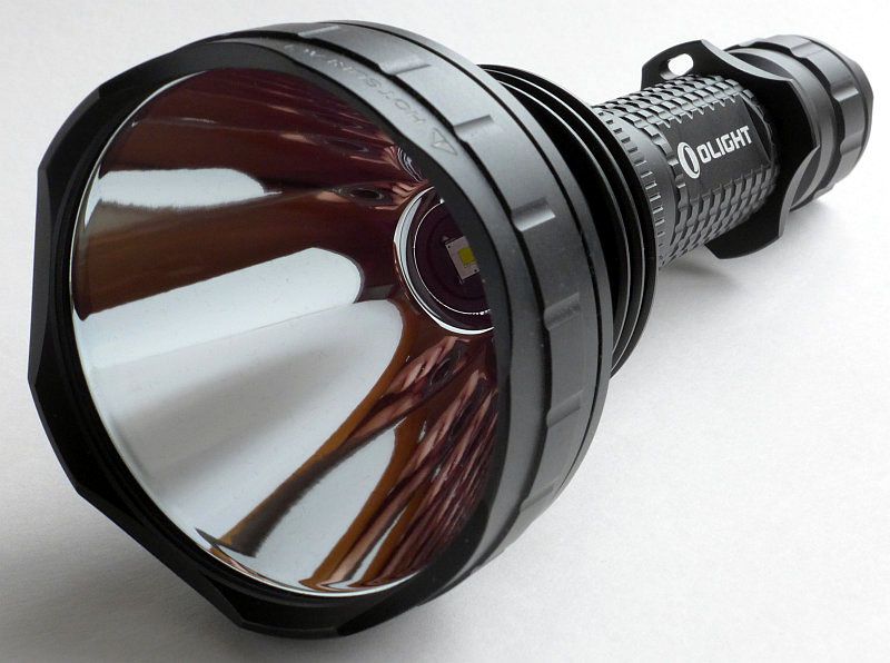

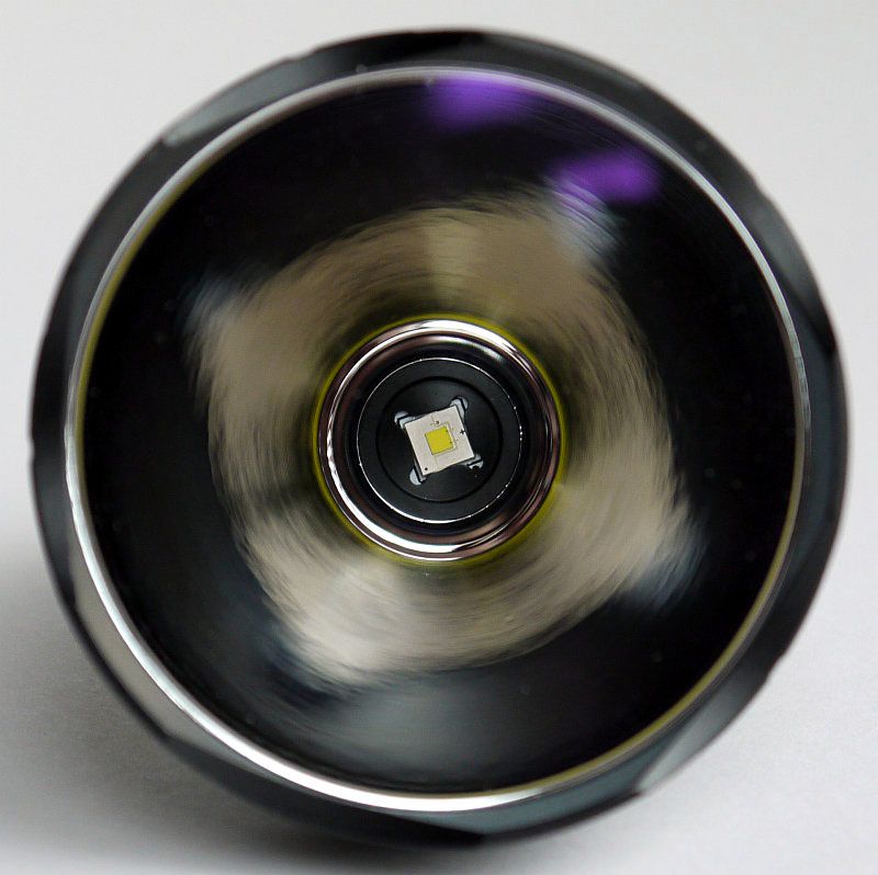

    Now for the business end, starting with the deep, wide, reflector.
    Peeking round the corner the domeless XM-L2 LED comes into view.
    Looking dead-on to the reflector and LED.
    The LED is so clean did it ever have a dome?

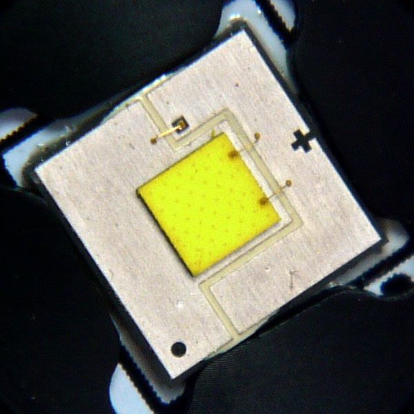

    The Domeless XM-L2 LED

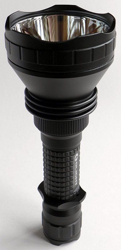

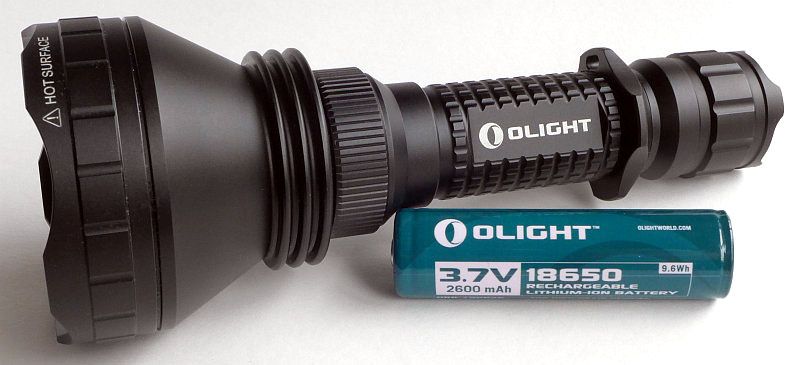

    Though the head is relatively large, overall the M2X-UT is still a compact light, using only one 18650 cell.

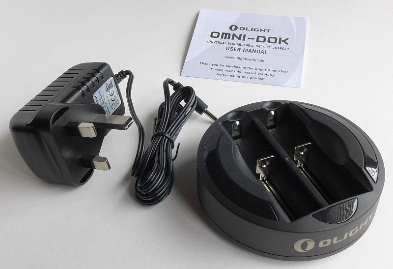

    Keeping the test 100% Olight, the Omni-Dok charger was used for charging test cells.
    An interesting 'puck' shaped universal charger for li-ions and NiMh/Ni-Cd. Li-ions are charged at 1000mA, so be careful when using RCR123 and 14500. Li-ions came off this charger at 4.21-4.22V.

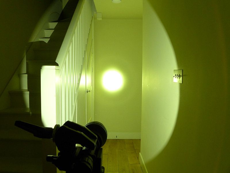

    The beam
    Though the M2X-UT is not really an indoor light, it has a very useful spill beam, so despite the high intensity spot, the M2X-UT is very usable indoors.

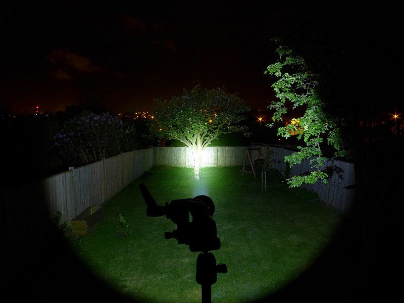

    But it is outdoors that the M2X-UT really sings!
    To get the full impact of the M2X-UT, first here is the reference Fenix TK41 I regularly use for comparison.
    And then the M2X-UT. The hotspot is more intense, the spill wider, the colour rendition better and in a smaller package.

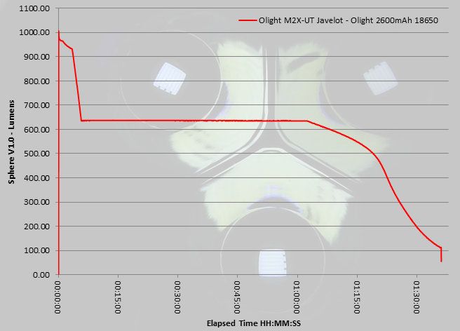

    Peak beam intensity is the highest I have yet measured, coming in at 182800lx @1m. This gives a beam range of 855m!
    After the initial peak output, the M2X-UT makes a controlled reduction in output to around 630lm which is regulated for the majority of the maximum output runtime.

    The holster is a bit of a tight fit, so much so, the heat sink fins have started to rub off the press-stud cover patch on the inside. At some point this cover will come off the press stud and there will be metal on metal contact between the press-stud and the M2X-UT. If you are careful to push the M2X-UT towards the back of the holster as you insert it, this rubbing is reduced.
    Also on the holster, the flap usually needs to be 'folded' round the head to get it tight enough for the press-stud closure to work. This is not a problem in real use and keeps the holster neater than if the flap were longer.
    Having the switch exposed does not seem to provide any real advantage as the large flap will always get in the way if the M2X-UT were turned on while still in the holster.
    As the grip ring is floating (though it cannot come off, it is not fully constrained and has some play in it), you do find there are occasional metallic clicking/rattling noises when handling the light or fitting or removing it from the holster.
    All the machining is crisp, but there are no sharp edges. This makes the M2X-UT feel great and very well made.

    As mentioned in other threads, Olight is no longer using a de-domed emitter on the M2X-UT. They've switched to an XP-L that they refer to as "customized". Same goes for the M3X-UT, IINM. It's been suggested that this was to address the issue of green tint with the de-domed XM-L2. My M2X has the new emitter:
    The dome appears flatter than other LEDs I have, and it covers the metal plate behind the emitter, as well (is that the die?). I don't know what's typical, but I wonder what Olight did to "customize" the emitter? De-dome it, and then add their own minimal dome to control the tint, while keeping the output higher than a stock domed XP-L?
    It's kind of a shame, since "factory de-domed" was part of the kewl-factor of this light, but I can't complain about the light's performance. It throws like nobody's business, and it's less green than the beamshots I've seen before the emitter change.
    subwoofer: I'm curious when you received your sample? The emitter change happened some time ago.

    The M20SX sample I have on test has this similar flat, but not fully de-domed emitter.
    I will have an early M2X-UT, as the sample was set aside for me at SHOT Show in January, but I received it quite a bit later than that. It would be interesting to do a comparison with the XP-L version.

    Hi i just received my olight m2x ut and it has different led it is completely without dome and its F serial number ? it is defrent from your light from this thread and from the first light they where seling , on mine there is no gaps by the led and black plastic , plastic is completly to the led .
    so olight updated this led once more ?

    Sounds like a XP-L Hi led, instead of the regular XP-L that had to be dedomed after.
    Agreed it does sound like an XP-L HI V3.
    Nikola3000
    Is your M2X UT cool white? If it is, then it's most likely to be XP-L HI V3. Olight has been waiting for these for a while and used them in the SR52 UT.
    The only problem with this is that doesn't throw as far as XM-L2 U4 Dedome or XP-L HD V6 with a factory mini dome.
