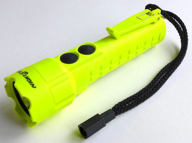

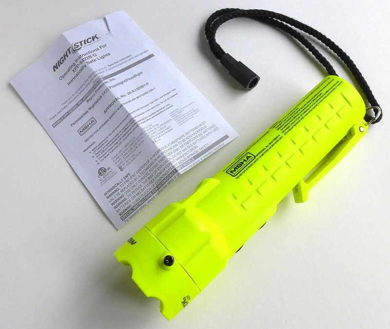

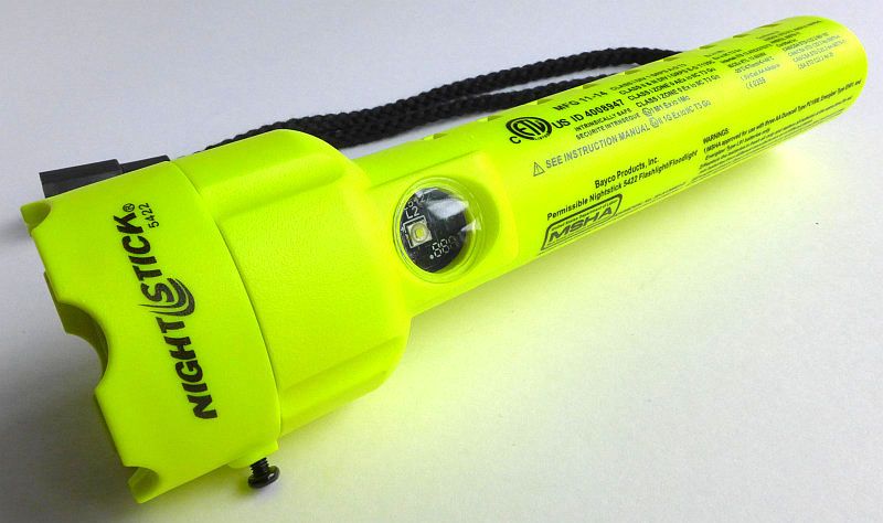

    Next up is the Dual-Beam XPP-5422G
    Only an instruction leaflet is supplied with the XPP-5422G. You need to supply a set of approved cells.

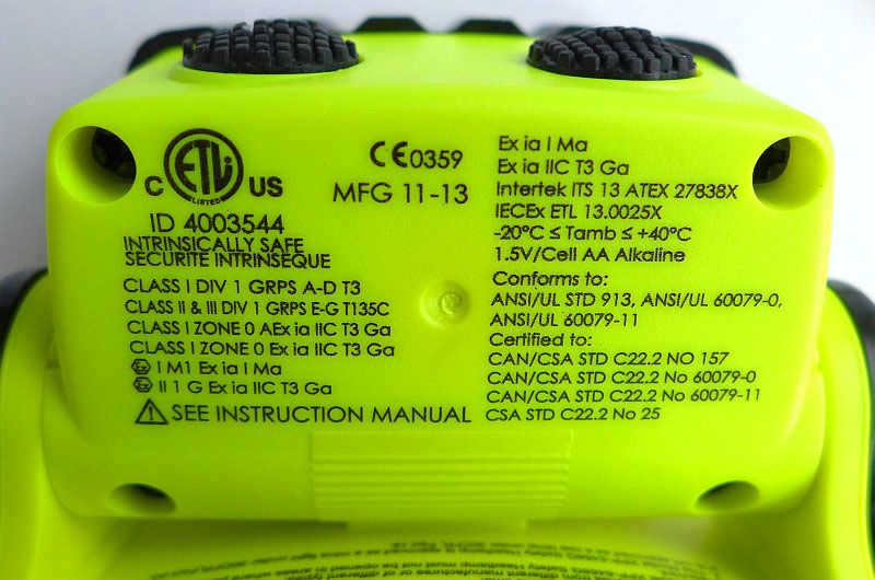

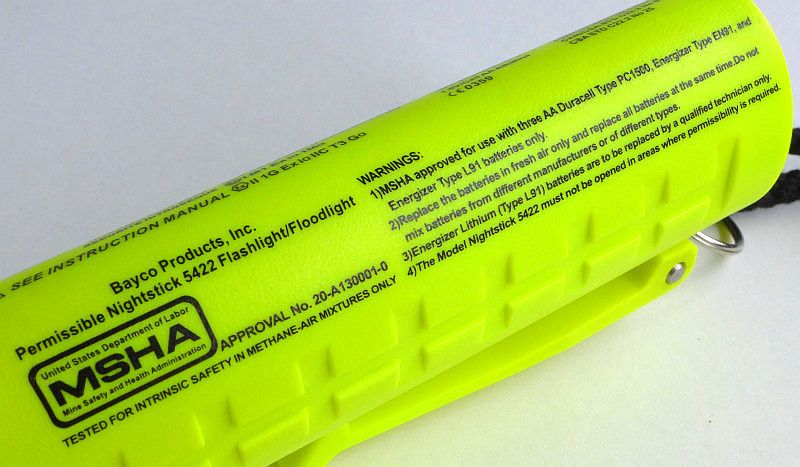

    The comprehensive list of certifications are printed on the light.
    Certifications continued.

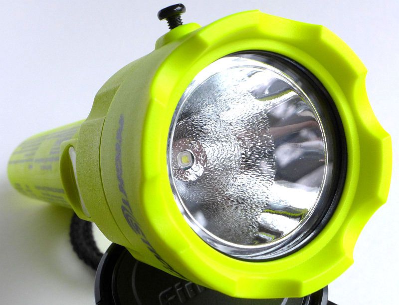

    The main beam uses a XP-E2 LED in a part textured reflector.
    A view of the heavy texturing, lightly textured and smooth parts of the reflector.

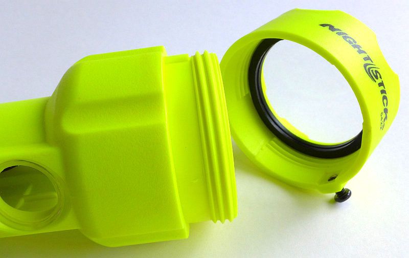

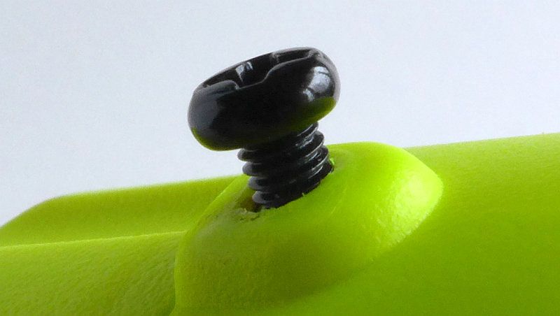

    The security screw for the dual-beam light is not captive, but is fitted in a brass threaded bushing.

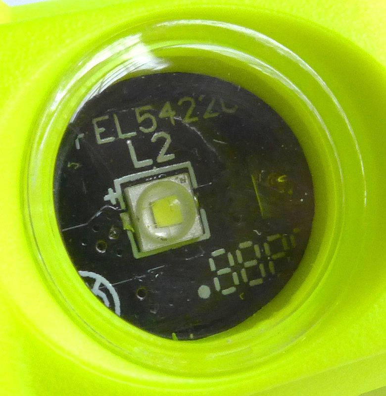

    The second XP-E2 emitter is mounted on the side and is a bare emitter with no reflector behind a window.
    This second emitter is positioned underneath (as held normally) the body behind the head.

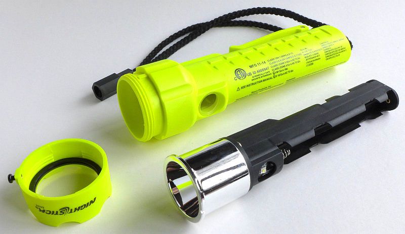

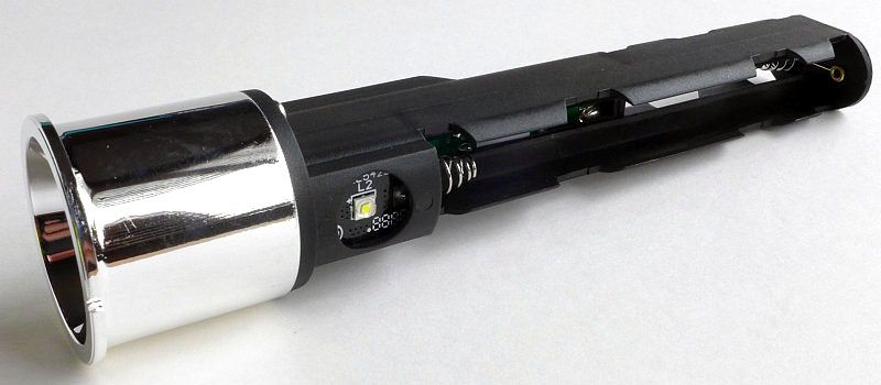

    With the front bezel unscrewed, there is an insert consisting of the reflector, battery holder and switches.
    On the top side of the insert are the two switches to control the two beams, plus a slot for one AA cell.
    The underneath has the flood beam emitter and a longer slot for the two remaining AAs.
    The threads are moulded and on the body at full, but in the bezel as not continuous.

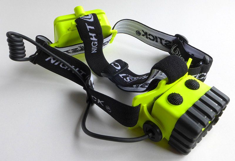

    The last of the group is the triple beam headlamp.

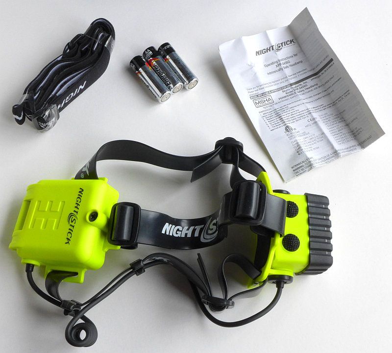

    The IS headlamp comes with a rubber helmet strap fitted, a softer elastic strap, three approved AAs and the instruction leaflet.

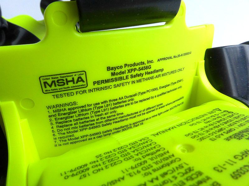

    The certifications are printed on the back of the lamp unit…
    … and onto the mounting bracket otherwise they would not all fit.

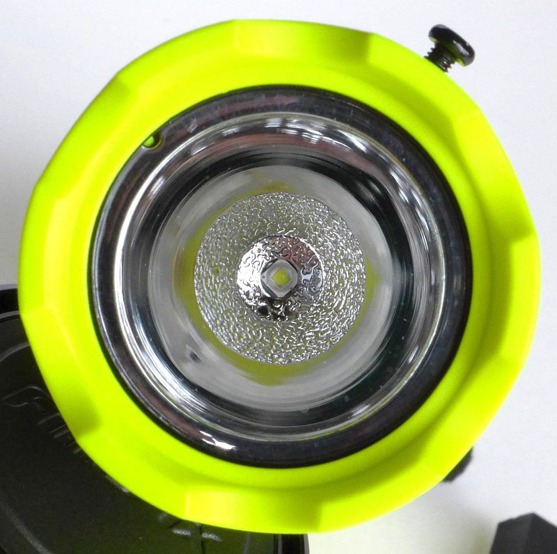

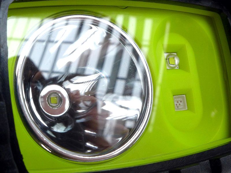

    Looking dead onto the lamp unit you can see the main spot beam reflector with its LED and two bare emitters. The white LED’s are XP-E2 and the red LED is a ML-E.
    The main beam's reflector.
    A closer look at the white XP-E2 and the red ML-E LEDs.

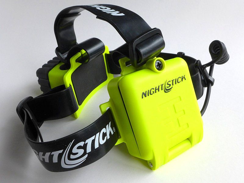

    Fitted at the back, the battery pack has the necessary security screw.
    Slots for the three AAs are next to the potted connection to the wire that goes to the main lamp unit.

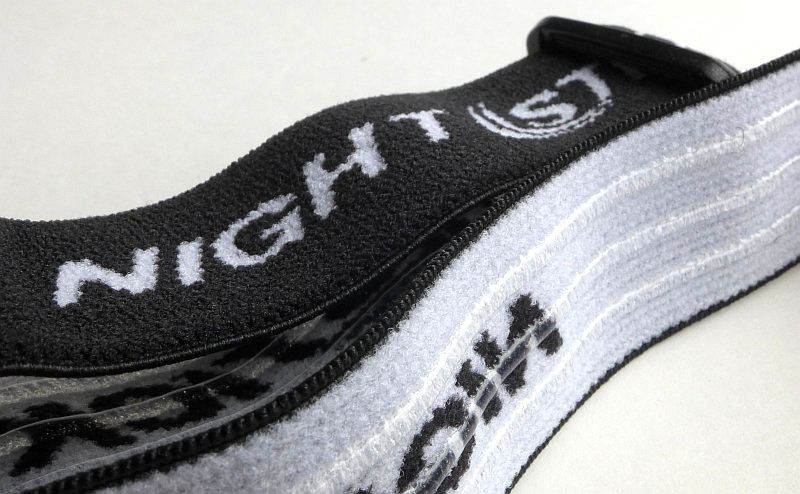

    The side of the elastic strap that contacts the head has three lines of soft rubber to provide extra grip.

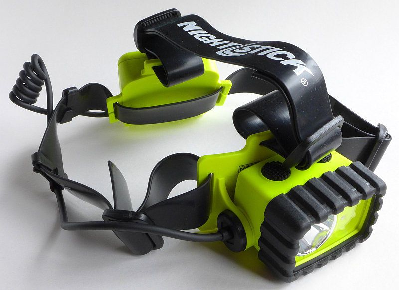

    Fully assembled with the secondary strap. The lamp unit has two switches which independently operate the spot beam, and flood/red beam.

    For the Dual-Beam light, we need to take a few different views. From my normal position, the main beam.
    Staying in the normal position as well as the main beam, the second side beam is now also on.

    The IS certification means that users must pay careful attention to the specified approved cells. Failure to use approved cells means that the IS certifications become void. 'Equivalent' cells don't cut it, it must be cells meeting the specifications precisely.

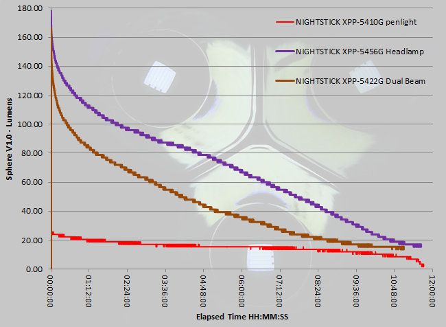

    When looking at the output figures and runtime graph, some readers might think these are less than inspiring results, however this is not the case for a few good reasons.
    Due to the difficulty of passing Intrinsically Safe certification, many similar products still use incandescent bulbs, so the output of Nightstick's lights are much better thanks to the use of LED emitters.
    A limitation of the certification is the use of low energy Alkaline cells, the performance fits the typical profile for unregulated Alkaline cell powered lights. However one crucial aspect here is to not have the light suddenly fail. IS lights need a gradual fade-away in output to warn the user of the state of the cells. You cannot swap out cells while in the hazardous environment, so cannot have the light suddenly go out thanks to regulated output sucking the cells dry.
    Note the 12 hour runtime.
    The Dual Beam light and Headlamp were both run with both main spot and flood outputs running simultaneously.

    It says right on the light that energizer lithiums are OK too.

    Quote Originally Posted by TEEJ View Post
    But why must these be replace by a qualified technician
    Mostly reading.
    Hove, UK
    2,494
    Default Re: Review: Nightstick 'Intrinsically Safe' Dual-Beam Flashlight, Headlamp and Penlig
    Though it is highly likely that a person working in these hazardous environments will be a "qualified technician" (at least I hope they are)
