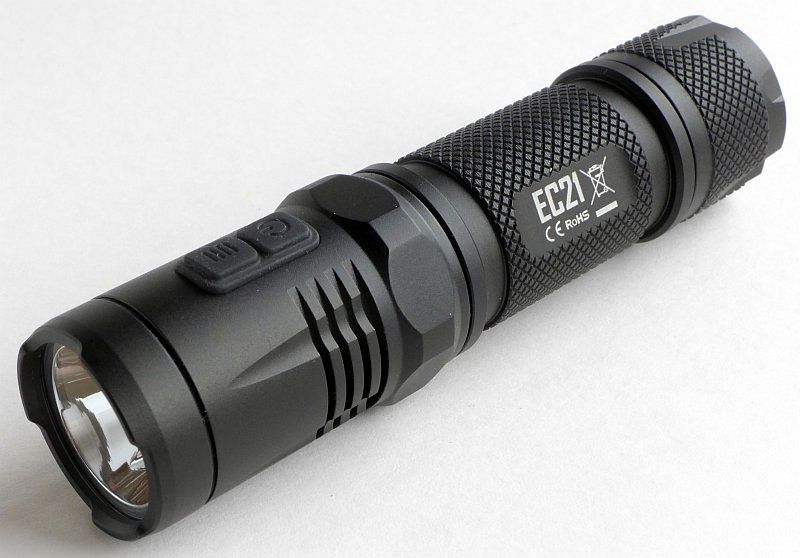

    Part of NITECORE's improved 'Explorer' Series, the EC21 is the real EDC workhorse of the range as it has a combination of using 18650 in a very compact body, but without runtime sapping excessively high output.
    Taking a more detailed look:

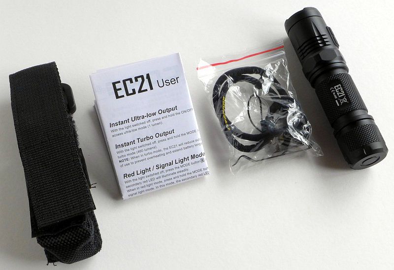

    NITECORE's standard packaging is used for the EC21.

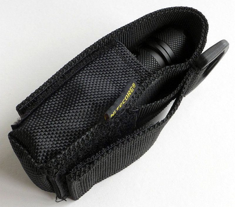

    Included with the EC21 are a holster, instructions, lanyard, spare O-ring, and a deep carry clip which can be fitted either way round.
    The holster has a D-ring, and both fixed and Velcro closed belt loops.

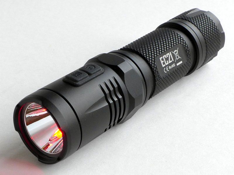

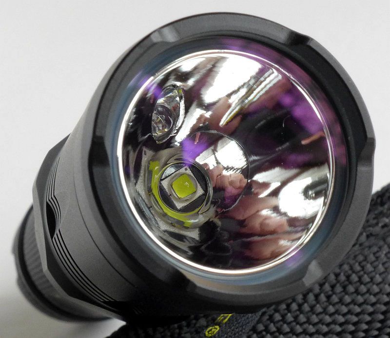

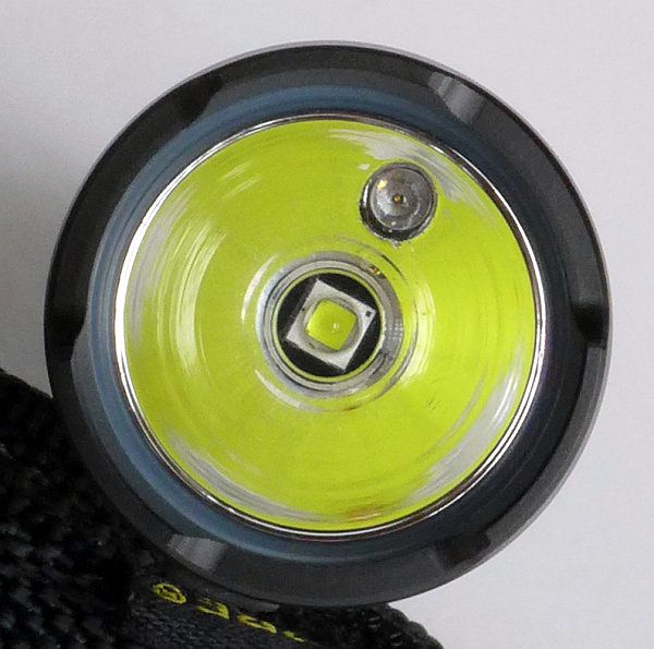

    The main beam LED is an XP-G2, and set to the side in the reflector is a secondary low power 3mm red LED.
    Looking off centre into the reflector, you can see the lens coating, depth of the reflector and how the secondary LED is set into the reflector.

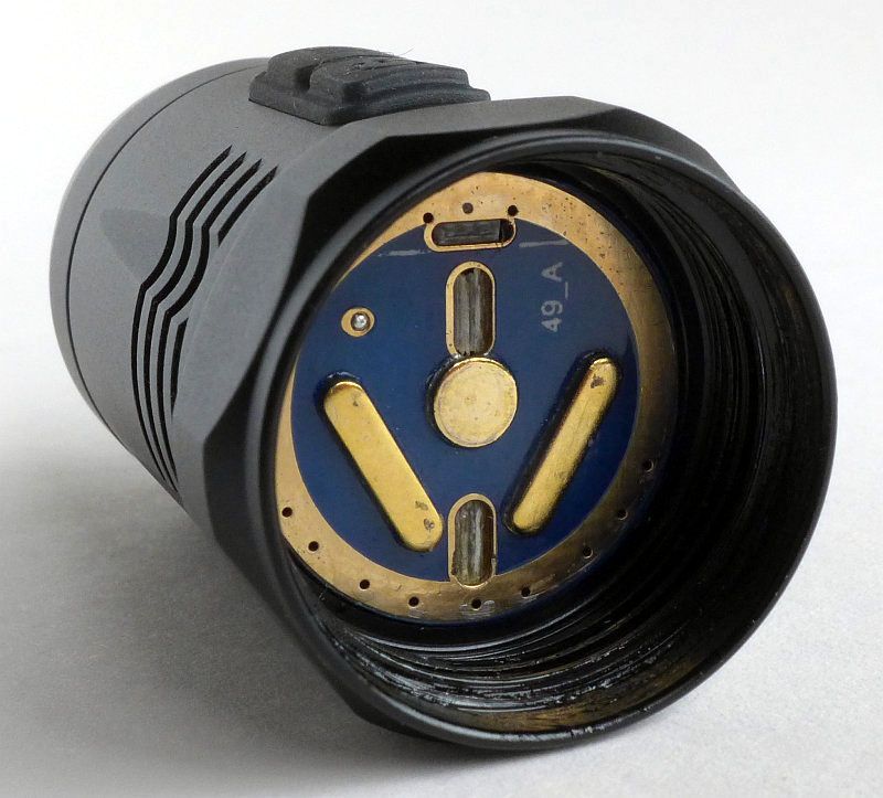

    Removing the head of the EC21 from the battery tube gives a clear view of the contacts. Physical reverse polarity contacts mean the EC21 is for button-top cells only.

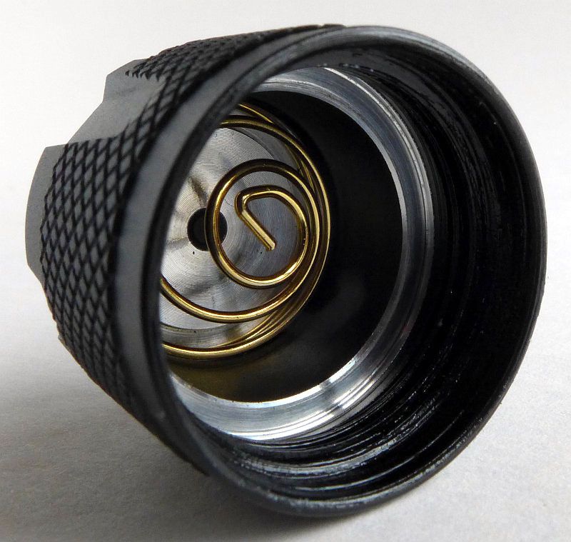

    In the tail-cap the contact is a simple spring which is recessed and allows it to accommodate some of the length of the 18650 cell. In fact when you insert an 18650 it protrudes quite a lot from the battery tube, and it looks as if the tail-cap will not fit on, but it does.

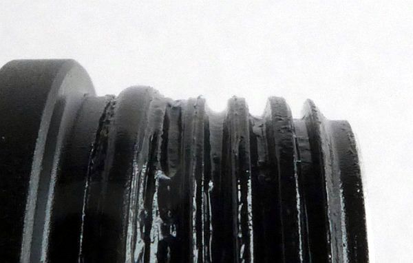

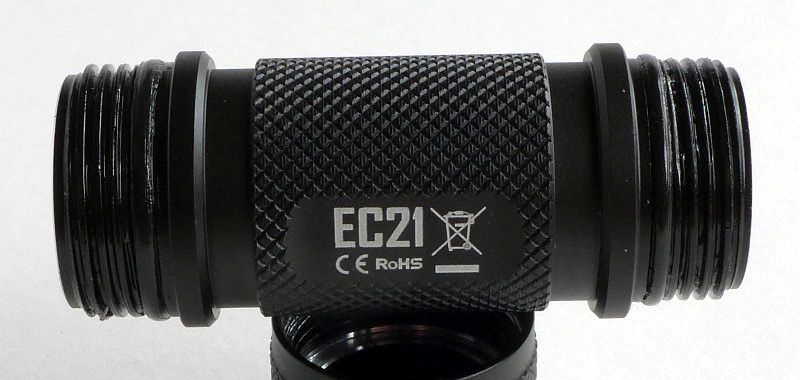

    Looking at both ends of the battery tube, the threads look very similar, but they are not the same. I've tried reversing the tube, and the threads do not fit.
    Fully anodised and semi-square cut threads are used at the front.
    Fully anodised and slightly smaller semi-square cut threads are used at the rear.

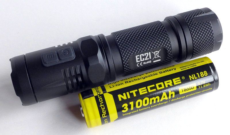

    Next to an 18650 cell, you can see the EC21 is very compact for this class of light. Also note the twin switches used to control the light.

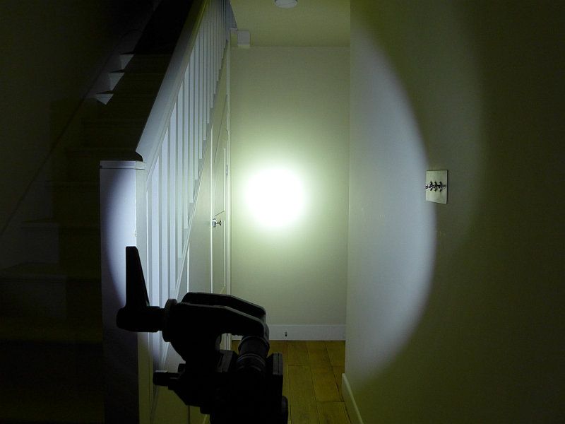

    The beam
    Though there are flaws in the EC21's beam, thanks to the inset 3mm red LED, these are not particularly noticeable unless you rotate the light. A defined hotspot gives the EC21 reasonable range.
    Adjusting the exposure as the red output is at a low level, the red beam is very messy, but relatively normal for these standard 3mm type LEDs.
    Outside, the EC21's beam is perfectly capable.
