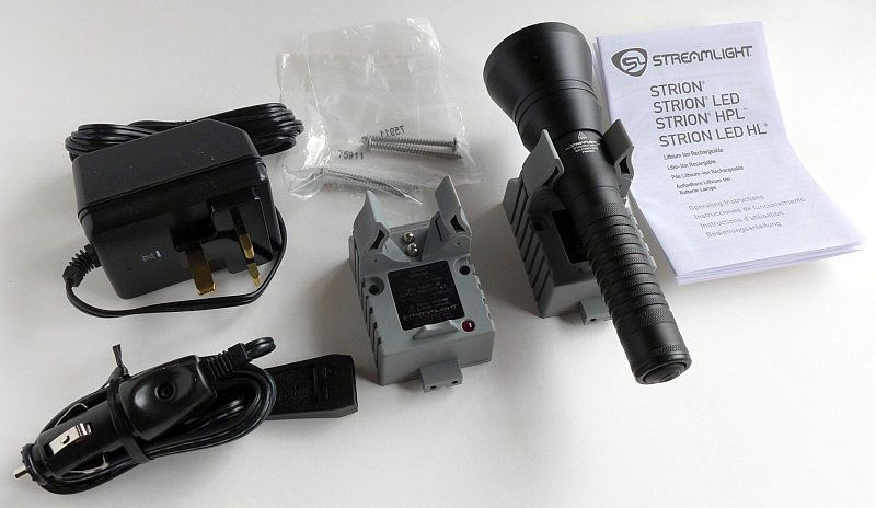

    The Strion HPL kit arrives in a sturdy retail box.

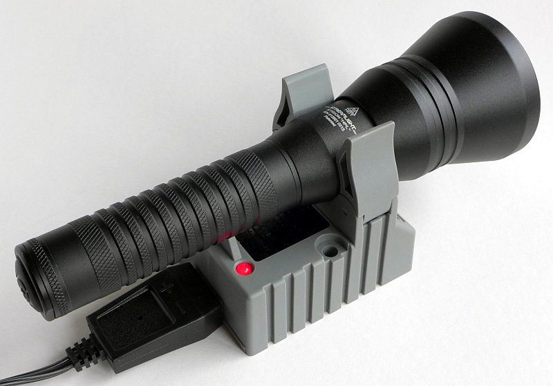

    You can tell this is a 'professional' work light as the kit includes two wall/surface mountable clamp charger bases as standard, along with a mains charger and car charger allowing you to carry the light and charge it indoors or in your vehicle without having to relocate a charger.
    The clamp charger bases are sturdy with hinged and sprung clamp jaws to hold the Strion HPL firmly when charging, yet allow it to be easily pulled out.
    On the side of the Strion HPL there is a location triangle with the two charger contacts set into it.
    In the charger base, there is a corresponding triangular cut out with the two sprung contacts.
    The red charge indicator light which is steady when charging and flashes when fully charged.

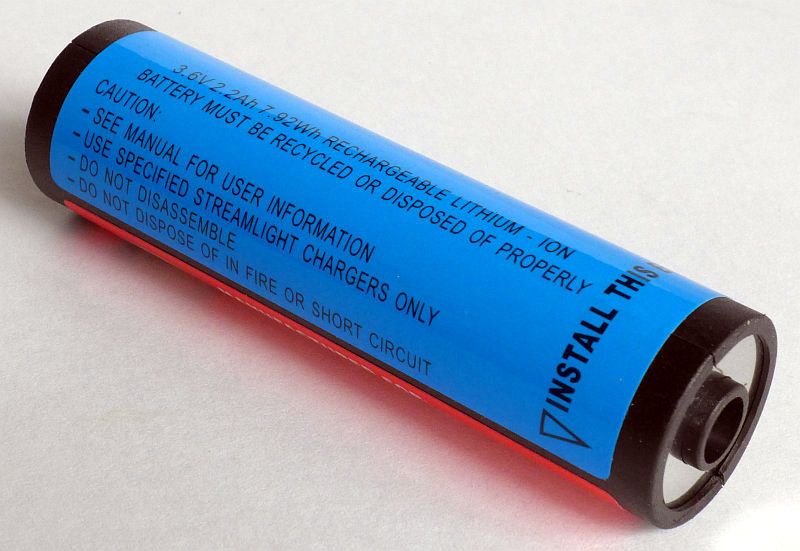

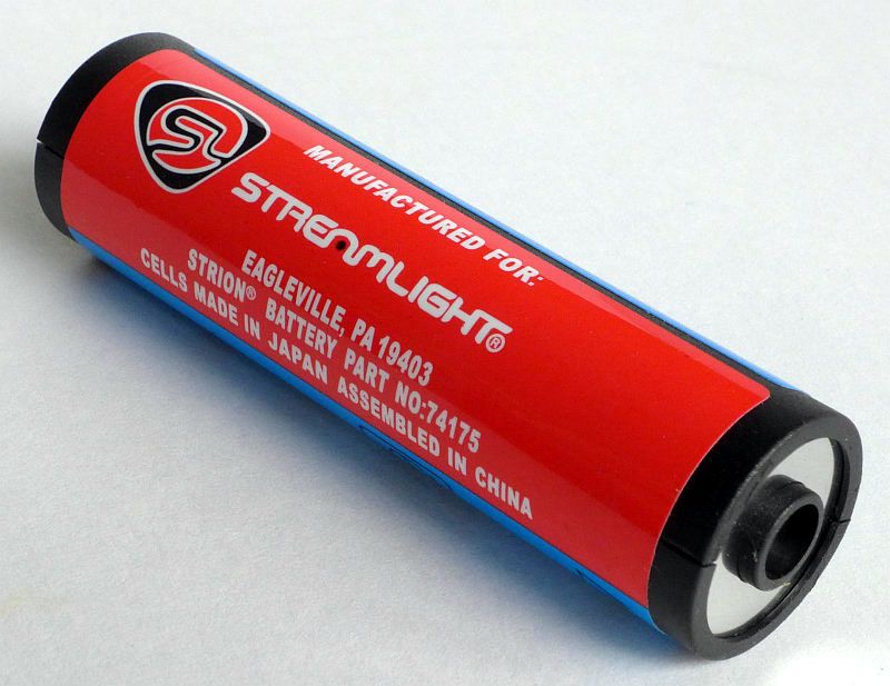

    The Strion HPL uses a proprietary Streamlight Strion cell. This has a double pole contact at one end, and a single contact at the other end.
    With the different ends (one single pole, one double pole) the cell must be inserted the correct way round as shown on the label.

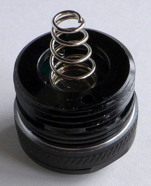

    There is a single sprung contact on the tail-cap.
    Standard threads are used on the tail-cap. These are very smooth and fully anodised.

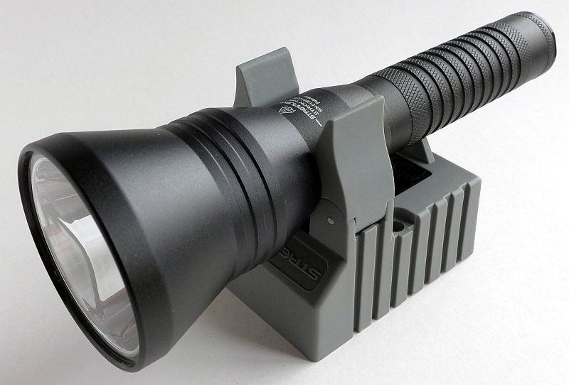

    The large smooth reflector and 'C4' LED. The specifics of the LED are not provided, but it looks like an XP-L.
    The reflector is very deep, and the Strion HPL uses a polycarbonate lens.

    The Strion HPL kit comes with a proprietary 2200mAh li-ion cell. Only Streamlight's dedicated rechargeable batteries can be used in this light.
