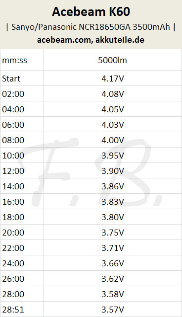

    Default Re: Acebeam K60 (XH-P70 LED, 5000lm/124kcd), Photos, Impressions
    real 5000 lumen mode without step down, restarted every 2 minutes
    28 mins. 51 secs, the low voltage warning activated (flicker three times)
