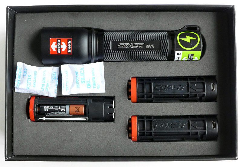

    The complete HP7R kit is presented in a sturdy box.
    With the lid off, you see the HP7R along with its two rechargeable li-ion battery packs, along with a 4x AAA battery carrier already loaded with alkaline cells. But there is more!
    Removing the insert in the box you find the rest of the kit. This includes, the HP7R, two li-ion battery packs, one 4x AAA battery pack, USB mains charger, USB 12V charger, USB to micro USB cable, lanyard, holster, belt clip, wall mount and instructions. That is comprehensive!

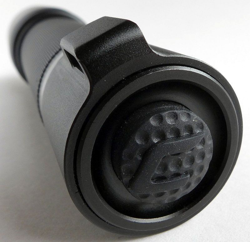

    The switch boot has the Coast 'C' moulded into it.

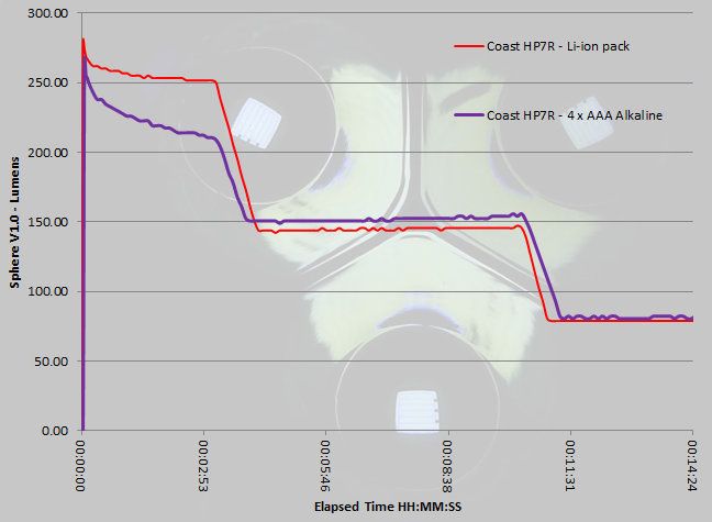

    On both the li-ion pack and the 4xAAA, the output drops quickly to 150lm after three minutes and down to about 80lm after 10 minutes. The li-ion pack manages a significantly longer run.
    Looking in more detail at just the first part of the trace shows more clearly the changes in output.

    I noticed today the on/off switch sticks out past the frame, therefore not allowing it to stand on tabletop shining upward like the non rechargeable HP7 (and my assortment of Lux-Pro lights) do. Eh, no biggy to me, but to some that may matter.
    Nother edit:
    If you open the tail end of this lamp slightly, like you would to charge the battery in the lamp, it'll tail stand. Duh! How'd I miss that.
