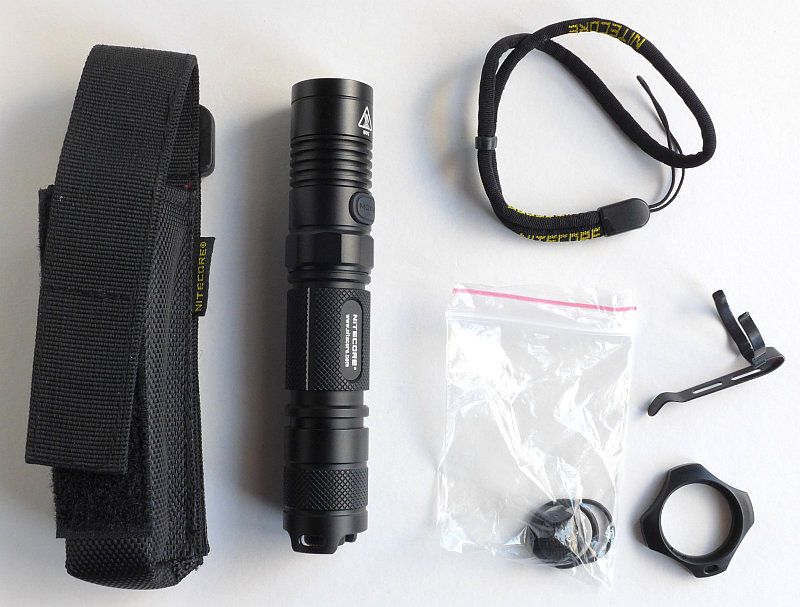

    Using NITECORE's standard packaging the P12 here is the '2015' edition.
    With the P12, you get a spare switch boot, two O-rings, a grip ring, pocket clip, holster and lanyard.

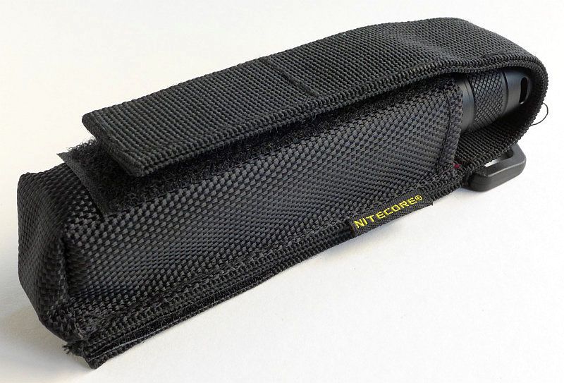

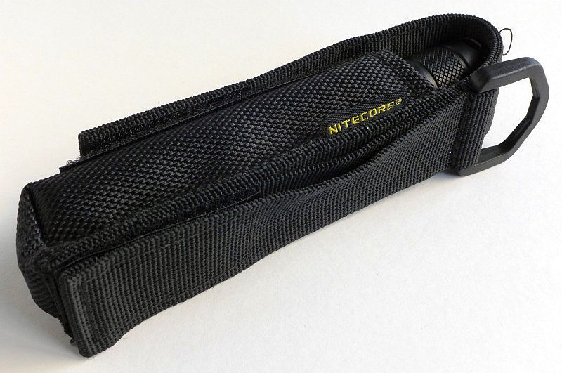

    The P12 in its holster.
    On the back the holster has a D-loop, a fixed belt loop and a Velcro fastened belt loop.

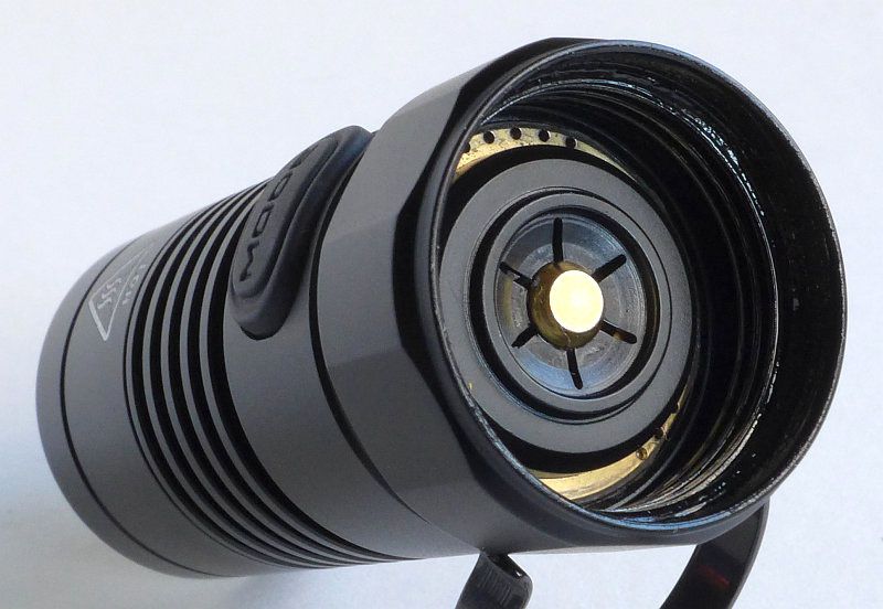

    Taking the head off the battery tube makes it easy to see the contacts. There is physical reverse polarity protection so only button top cells are suitable for the P12.

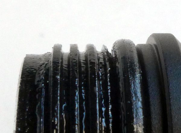

    The threads at the head end are square cut, fully anodised and well lubricated.

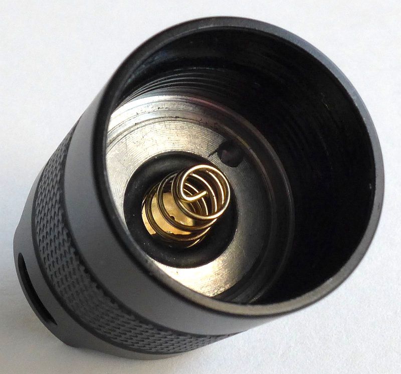

    A spring is used as the negative terminal in the tailcap.

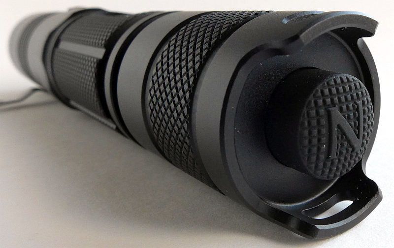

    The switch is semi protected, but with generous enough cut-outs to allow easy access. The raised sections are large enough to allow tail-standing.

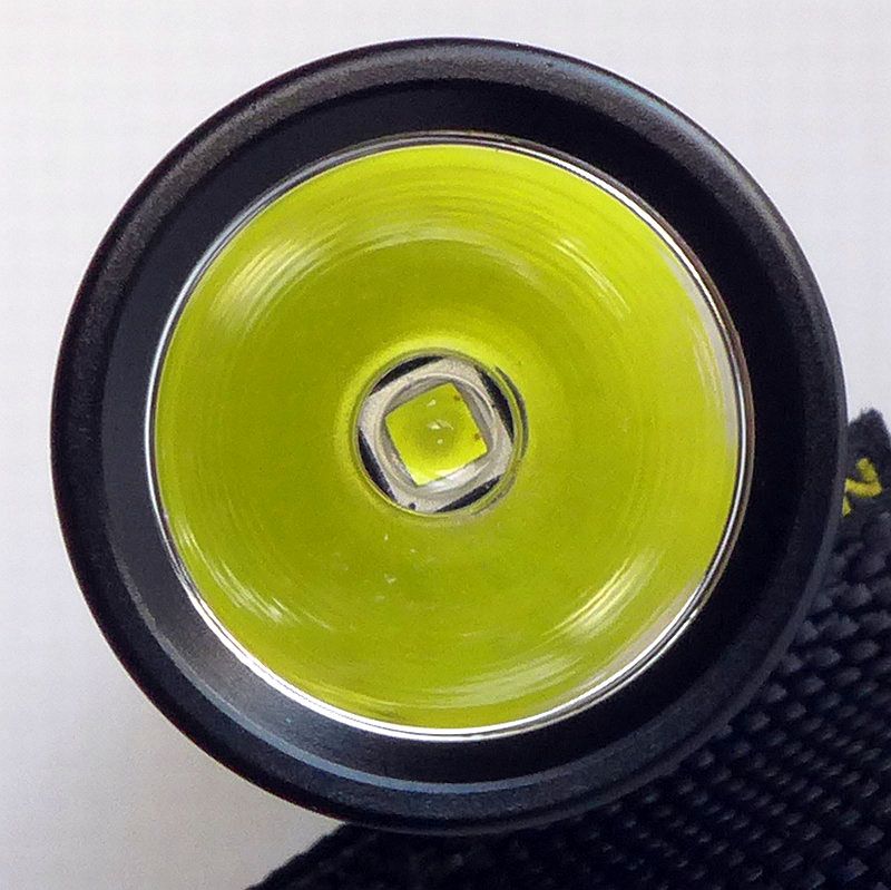

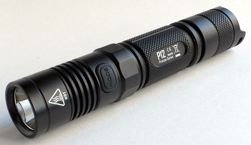

    An XM-L2 LED sits are the centre of a smooth reflector.

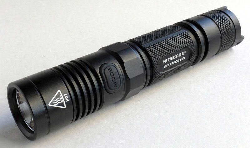

    The P12 with grip ring and pocket clip fitted.

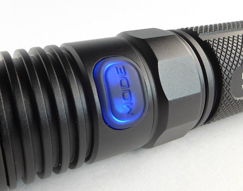

    The mode switch has blue illumination for battery level warnings and displaying the battery voltage.

    As well as the momentary forward clicky switch, there is a mode button on the side of the P12's head.

    Just to confirm the P12 fits in the holster with the grip ring fitted.

    The P12's holster has a flap which can close much looser than shown in my photos, due to the long velcro strip. I suspect this would allow the grip ring to be used and the P12 not going so far into the holster. If I get a chance I'll try this.
