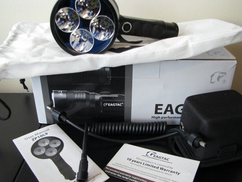

    Note that I have the Battery Pack edition of the ZP10L9 for review, which includes a custom 9x18650 battery pack, extender coil and AC charger. Also note the new Sportac brand label everywhere. Scroll down for details on the light.
    Eagletac ZP10L9 hand-held unit: Weight 719g, Length: 200mm, Width (bezel): 92.7mm
    Eagletac ZP10L9 Battery Pack with coil: Weight 528g, Length: 111mm, Width: 89mm

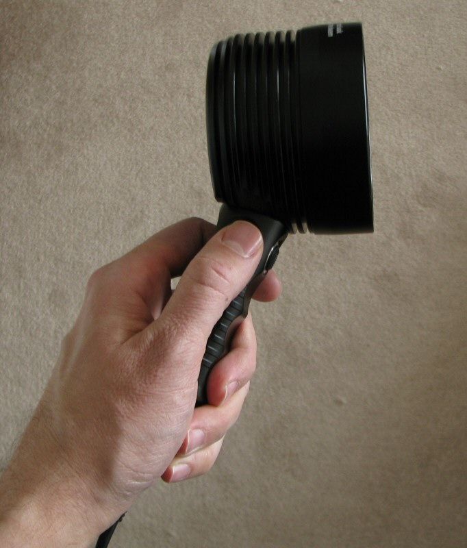

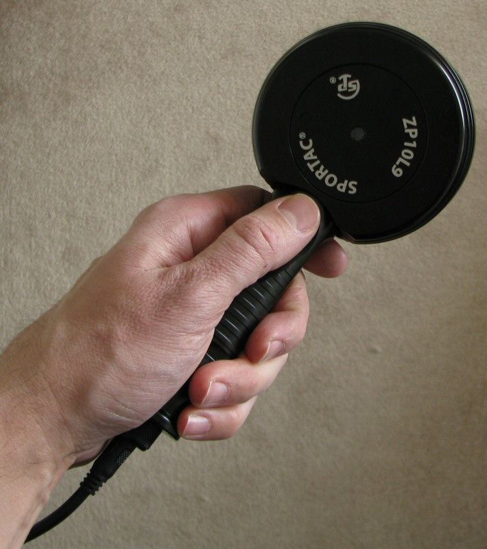

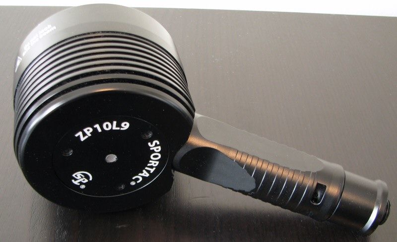

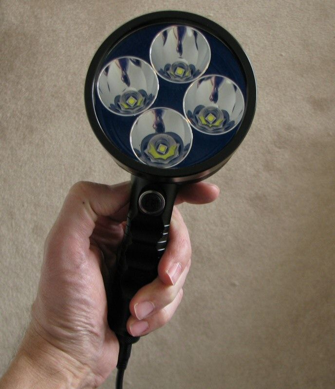

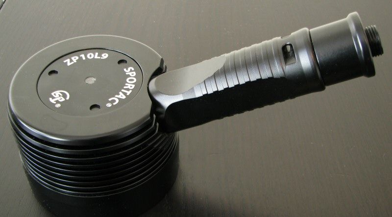

    Ergonomics of the ZP10L9 differs from most lights, given the distinctive hand-grip of the main unit. Light is bit top-heavy, suggesting good heatsinking. The electronic switch on the grip has a raised cover, and is well positioned for index finger use.

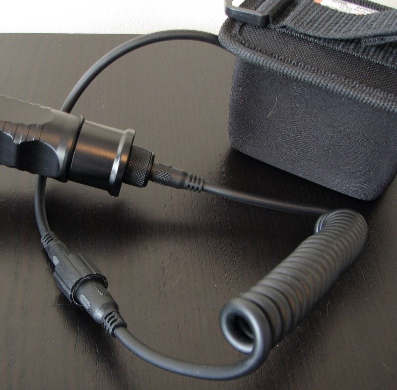

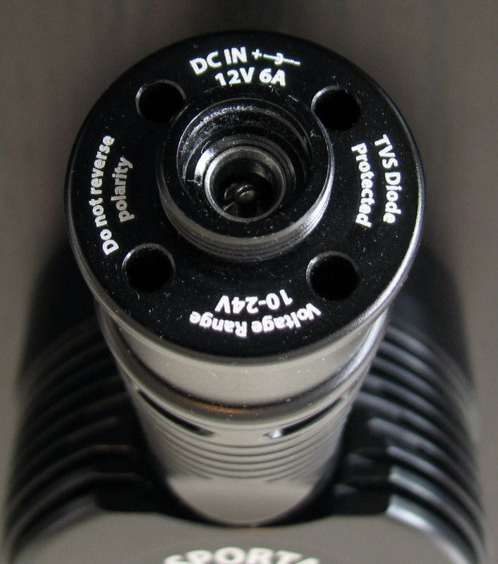

    The battery pack version (tested here) comes with a custom tough fabric-sealed 9x18650 battery pack that you could mount on a belt.

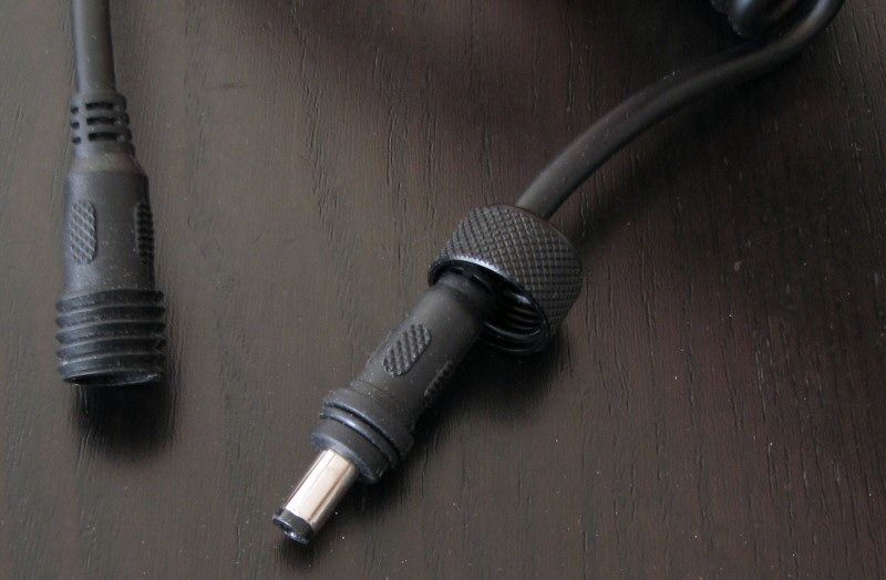

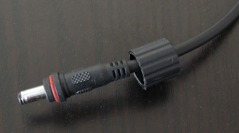

    The coiled extension cord screws into place on both the base of the main unit, and the extending tube from the battery pack. Note the connection points differ on the removable coil, making the orientation and use clear. Also, the head area of the coil uses a metal screw cover, while the battery back end uses a plastic screw cover (consistent with the matting material on the corresponding head unit and battery pack extending tube). This means that while you could plug the battery pack directly into the head without the coil, you will not be able to lock it in place (i.e., the plastic connector does not matter with the threads on the metal head). But you will likely need the extra length of the coil for convenient carry anyway.

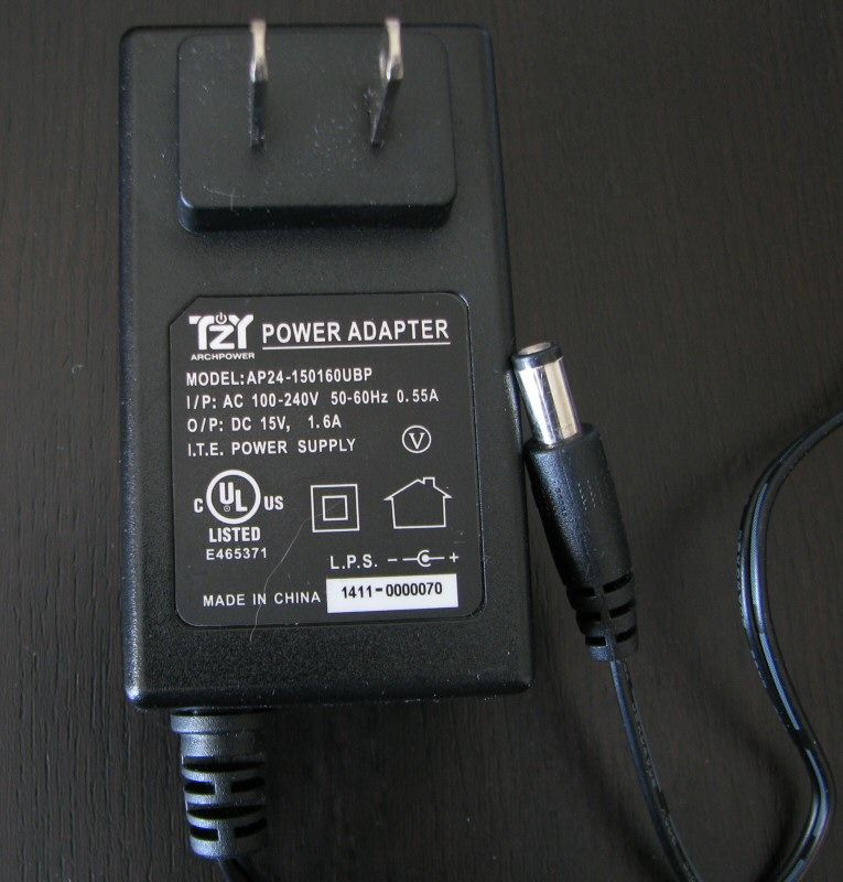

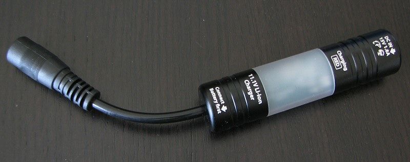

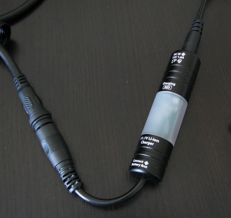

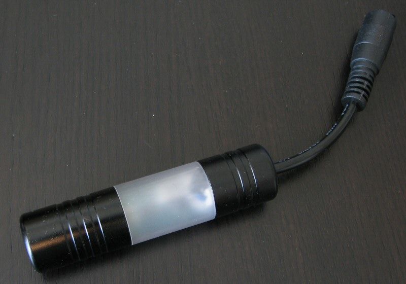

    Charging (battery pack version)
    The charging unit connects to the extending tube that exits the battery pack, and to a AC/DC charger. Pay close attention to the orientation labels, to ensure you don't try to mount the charging unit incorrectly (it won't fit exactly, but I'm sure they wouldn't want you to try to force it the wrong way).
    There are two lights on the circuit board visible in the charger unit, a very bright blue one that indicates AC power is connected, and a dimmer red one that indicates battery charging is occurring (the red LED is more visible in real life than the pics above suggest).
    Judging from the label, the pack appears to use a 3s3p configuration with 2600mAh cells. It took about 5.5 hours to fully charge the battery pack from nearly completely discharged, suggesting a fairly high charge current (i.e., the 1.6A rating on the AC plug seems a bit low). Eagletac reports 6-8 hours typical, which is more as I would expect. Note the charging unit gets quite hot during charging.
    I do not have the car adapter version to test.

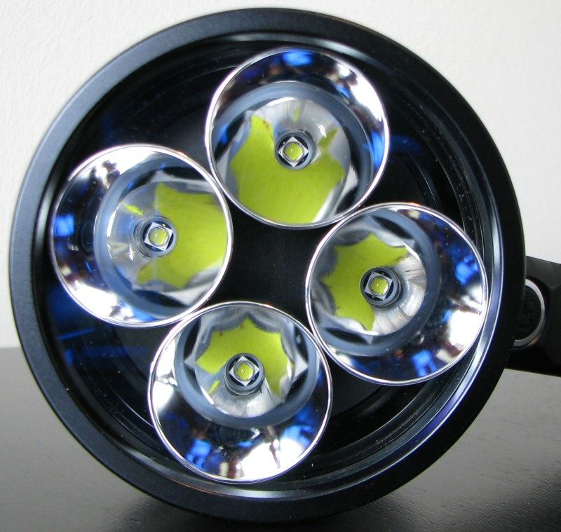

    I note the four reflector wells are quite deep (and smooth), which should translate into very good throw for this class.
    There is a battery LED indicator on the back of the head unit that activates when the light is on. Solid blue means the voltage of the battery pack is >10.8V, red means ~9.8V~10.8V, and flashing red means <9.8V.
    There are five main output levels, and an SOS mode. Turn the light on by the electronic switch in the handle in the head.
    A single click turns the light on in Lo, with constant On. Press-and-hold the switch from On to ramp through the five main output levels in the following repeating sequence: 0.3% > 8% > 27% > 58% > 100%. There is no mode memory, the light always defaults to the lowest level upon a click from Off.
    Alternatively, a press-and-hold of the switch from Off will turn the light on in momentary max (100%). Release the switch to turn off.

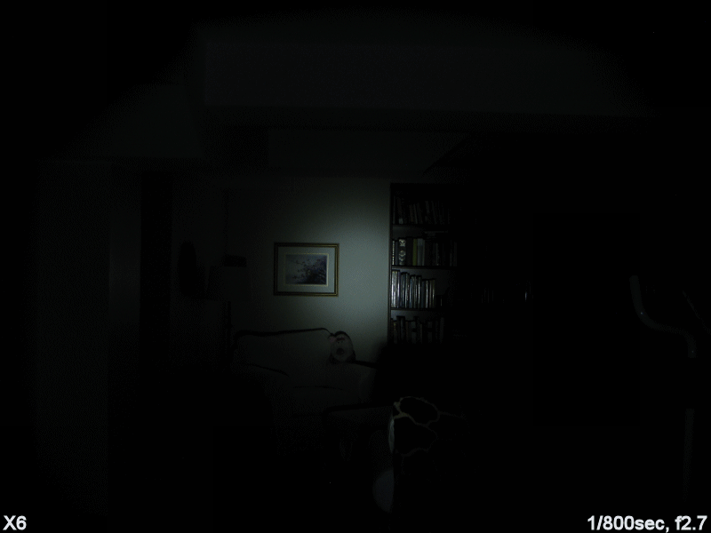

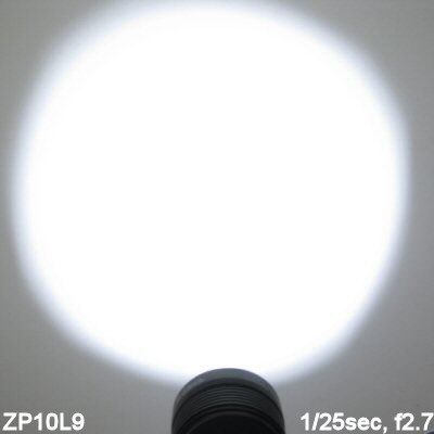

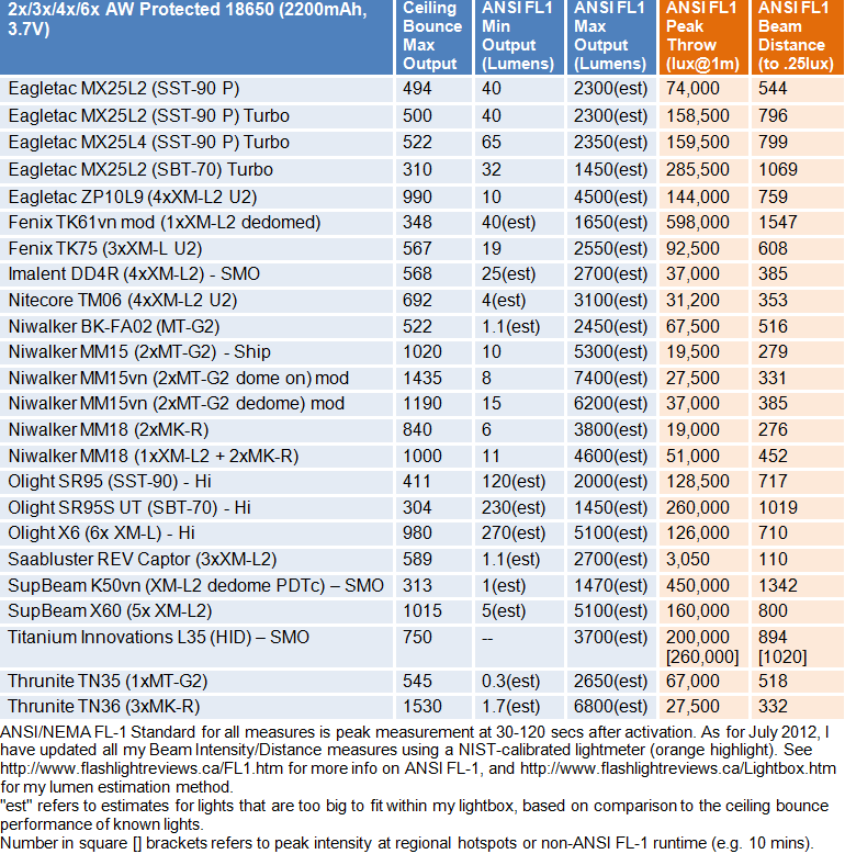

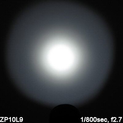

    And now, what you have all been waiting for. All lights are on their custom battery pack, or standard protected 18650 ICR chemistry batteries. Lights are about ~0.75 meter from a white wall (with the camera ~1.25 meters back from the wall). Automatic white balance for cool white lights, Daylight white balance for the neutral white MM15.
    Since you can't really tell too much from these standardized up-close beamshots, so let's move on to my basement. For your reference, the back of the couch is about 7 feet away (~2.3m) from the opening of the light, and the far wall is about 18 feet away (~5.9m). Below I am showing a couple of exposures, to allow you to better compare hotspot and spill. The camera is set to automatic white balance for all lights below.
    I am planning an excursion out to my 100-yard beamshot location in the next couple of weeks, and will update this thread once I have the pics.

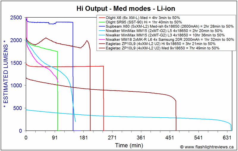

    Output/Runtime Graphs:
    As always, my standard runtimes are done under a cooling fan.
    Note that as with other Eagletac lights, ZP10L9 steps down after 200 secs runtime (by 10% according to the manual).
    Overall efficiency seems reasonable for 9x2600mAh 18650. Not that regulation was not perfectly flat above, but you would not be able to notice the changes in real life – they occur far too gradually for you to pick up on perceptually (i.e., it seems perfectly flat to the eye).

    The coiled extension cord worked well in my testing, and fastens securely. However, I do wonder about the durability of the plastic connecting screw head at the battery connection point.

    Beam pattern was good, with a fairly focused beam (i.e., not as wide spill as the Supbeam X60 or Olight X6). Again, this is really a spot-beam type of high-output light.
