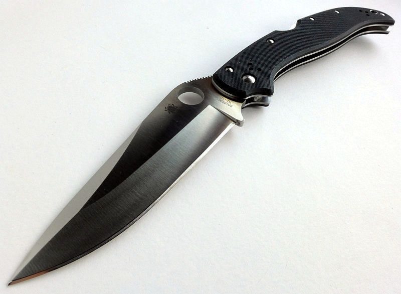

    Following so many requests for Spyderco to make a LARGE folder, Sal Glesser decided now was the right time. With a design ready for a new, strong, lock that would be just right for job (Spyderco's PowerLock), the conditions were ripe for the Tatanka to be created.

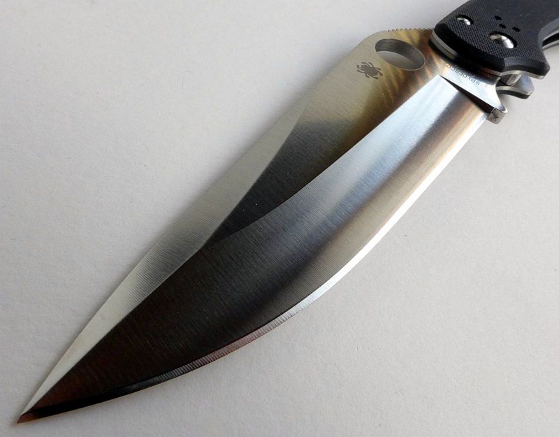

    Sal specifically wanted to run the grind line down the centre of the blade, and to keep the tip as strong as possible the grind line was taken all the way to the tip (with the Tatanka being such a large knife, Sal expected it to be put to heavy use). This left a lot of metal above the grind line, so the long swedge was added, mostly to reduce weight, but also increases it ability to puncture.
    Sal did not expect this knife to be used for skinning, so a hollow grind, which would work best for this as you only cut to about Ό" depth, was not the best choice. With strength being the primary concern a flat grind was chosen.
    If you are going to do whittling or any fine cutting, your ability to get close to the edge is an advantage, but slipping onto the edge is of course a disadvantage. To give the Tatanka greater flexibility it has a finger choil.

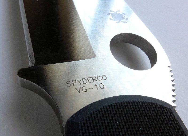

    Just to the front of the finger choil is the 'kick' which keeps the edge away from the spring and spring holder. As the Tatanka is such a long knife, the kick was made larger to decrease the chance of the finger sliding forwards, and also should the blade be snapped shut quickly or squeezed the larger kick provides more protection of the edge.

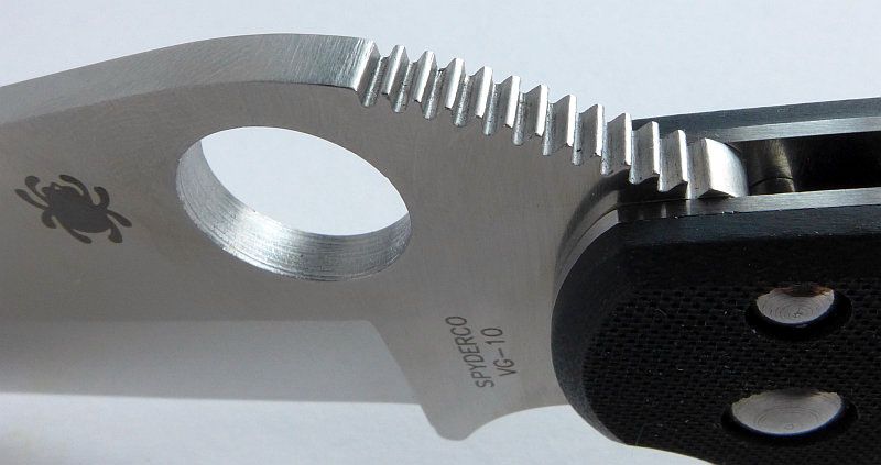

    Finger choils are something that are now frequently seen on Spyderco knives. Though the idea existed earlier, when Sal was asked to design a knife to fit in between the Ladybug and Delica, he designed the Dragonfly. The only way to make a knife that was smaller but still had enough purchase for control (control of the edge is very important to Sal's designs) was to add a finger choil to the Dragonfly.
    For the hole, Spyderco use sizes from 7mm up to 14mm. In a prototype for an Alaskan Iditarod knife a 16mm hole was used due to the thickness of the gloves used, but anything over 14mm when you are not wearing gloves can become difficult as your finger falls into it too much. The 14mm hole used in the Tatanka allows for use with or without gloves.
    With a 14mm opening hole being used, in order to have enough metal between the hole and the grind line, it was necessary to raise the top of the blade a little.
    Spyderco simply call the blade hole the "Opening hole", but as Spyderco created this feature, it is often known as the Spyder-hole.

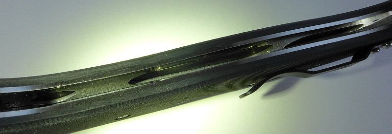

    The liners are also heat treated, paying particular attention not to introduce any brittleness and leave the liner strong enough to hold a clip screw and tough enough so it doesn't easily bend, but not so hard it will crack.

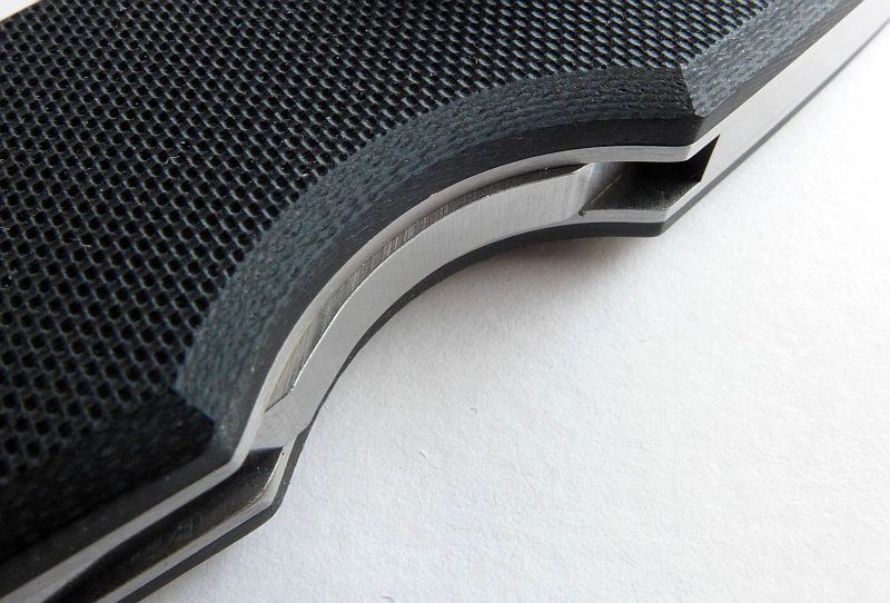

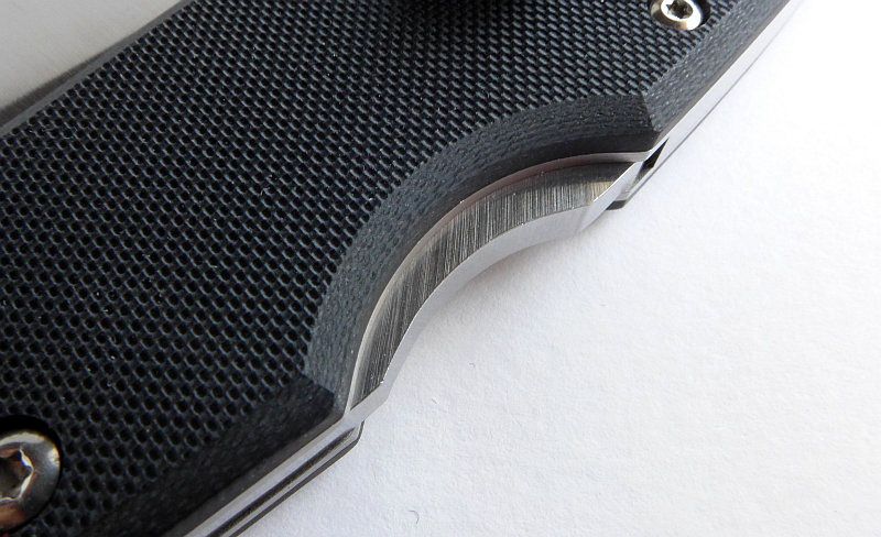

    The dish-out in the lock release arm is referred to by Spyderco as the Boye-dent (designed by David Boye) and was originally used to keep the knife from being accidentally unlocked if you were squeezing the knife very hard. The dent looks like it is off-centre, but this is because the lock release arm moves in an arc.
    When you press the arm in, to unlock the knife, you find the dent becomes parallel to the cut-out in the handle. (If the dent is centred, when pressing the lock release the back end of the dent submerges into the handle before the front end and the lock release doesn't function as well).

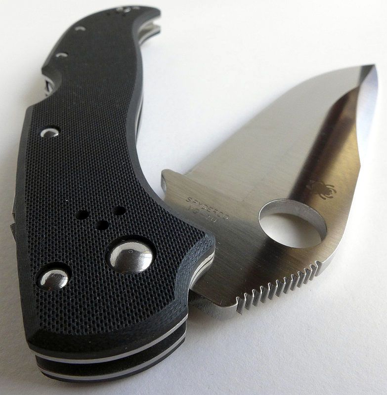

    The scales are made of "Peel Ply" G10 and the texture is built into the material when it is pressed. You peel off the top layer once it is assembled (though sometimes before) leaving the texture you can see here.
    During the design process thicker scales were considered, but it was decided they were not necessary. The G10 used in the Tatanka is made in the US and shipped to Japan. Thicker G10 might have been used if a liner or lock was going to be nested inside it, but as there was no nesting the 3mm provides enough strength and bulk to give the grip required.

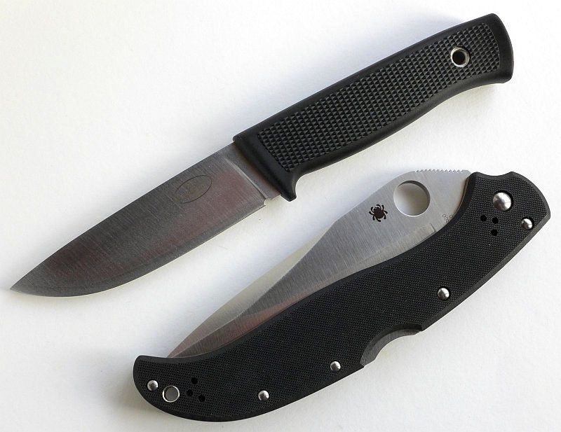

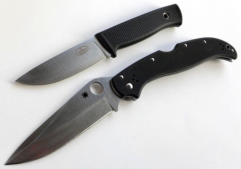

    To get an idea of the size of the Spyderco Tatnaka, it is shown here with the Fallkniven F1 with the blade open.
    And again with the blade closed.

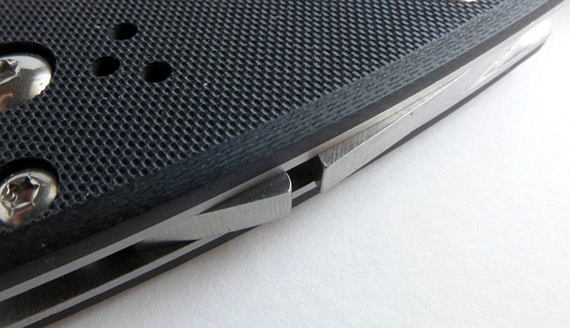

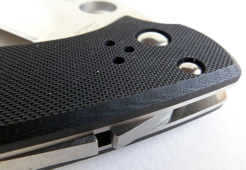

    The PowerLock uses two interacting rocker arms. The lock release arm rotates a cam away from where it normally engages with the blade tang.
    This cam (shown in its rotated position here with the blade half open) when engaged with the notch in the blade tang acts like a compression lock
    With the blade locked open the cam sits flat.

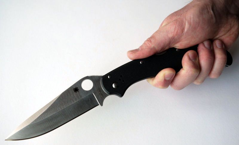

    Ok, well the Tatanka IS a LARGE folding knife, and some will find it too large (though mainly when folded), but actually the overall design and length of handle make it very versatile once opened. However consider that when folded it is still far more compact than the equivalent fixed blade, so is easier to carry despite being large (for a folder).

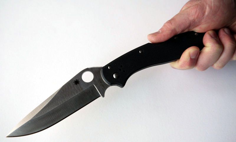

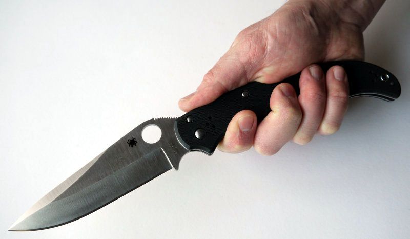

    Looking at the different grips you can take shows the many ways you can use it. (I wear a glove size of XL in case you are wondering).
    Taking up a grip with the finger choil, the handle really seems to 'shrink' and you have a very controllable 5" blade.
    Moving back slightly for less precise cutting tasks, the Tatanka's size gives you good reach and depth of cut.
    Moving back along the handle further extends that reach. Like this it is great for light trail clearing such as brambles or similar overgrowth.

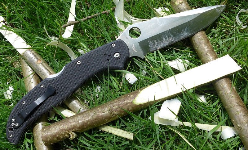

    Remembering that Spyderco specifically say it should NOT be used for chopping, the Tatanka can be securely held with an extreme grip partially off the handle thanks to the hook at the end of the handle. This allows for a great slashing action, and it is up to you to listen to Spyderco's warning and decide what you might cut with this grip.
    The opening and closing action is firm, and the PowerLock holds the blade securely closed (an important consideration with folding knives and especially when this large), so there are no worries about this opening in your pocket.
    Even though held firmly closed, as the opening-hole is well exposed it is easy to get enough leverage for one-handed-opening (OHO). Anyone with small hands might struggle to open the Tatanka one handed purely due to the reach and pressure needed to sweep the blade round (this is only a guess as I don’t' have small hands, but the action is quite firm).
    The texturing of the G10 handle material provides a reasonable grip without being too harsh allowing you to work comfortably for extended periods without abrading your hand or glove.
