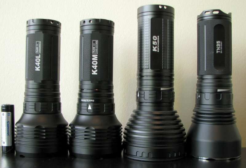

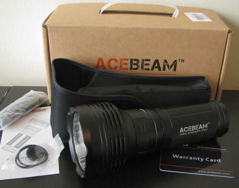

    The K40M comes in a plain cardboard box with packing foam. Along with the light is a holster, extra o-rings, spare boot switch cover, decent quality wrist strap, warranty card, manual.
    From left to right: Keeppower protected 18650 3100mAh; Acebeam K40Lvn, K40M; SupBeam K50; Thrunite TN35.
    All dimensions are directly measured, and given with no batteries installed:
    AceBeam K40M: Weight: 498.4g, Length: 188mm, Width (bezel): 76.2mm
    SupBeam K50: Weight: 645.0g, Length: 230mm, Width (bezel): 90.1mm
    Crelant 7G10: Weight 643.4g (827g with 4x18650), Length: 198mm, Width (bezel): 79.0mm
    Eagletac MX25L3C 3x18650: Weight: 345.9g, 352.0g with kit tailcap (485-491g with 4x18650), Length: 141.9mm, 143.6mm with kit tailcap, Width (bezel): 61.9mm
    Fenix TK61: Weight: 605.7g (790g with 4x18650), Length: 218mm, Width (bezel): 96.0mm
    Niwalker BK-FA02: Weight: 687.6g (870g with 4x18650), Length: 209mm, Width (bezel): 80.0mm, Width (tailcap): 50.3mm
    Olight SR52: Weight: 396.7g (497g with 6xCR123A), Length: 162mm, Width (bezel): 63.1mm
    Thrunite TN35 (MT-G2): Weight: 571.4g (723g with 3x18650), Length: 201mm, Width (bezel): 78.9mm

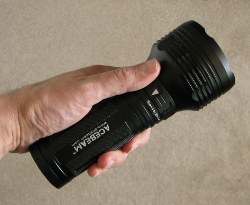

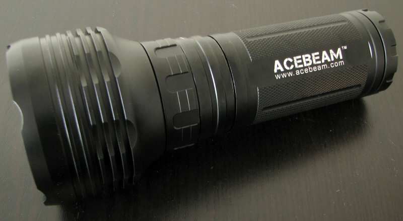

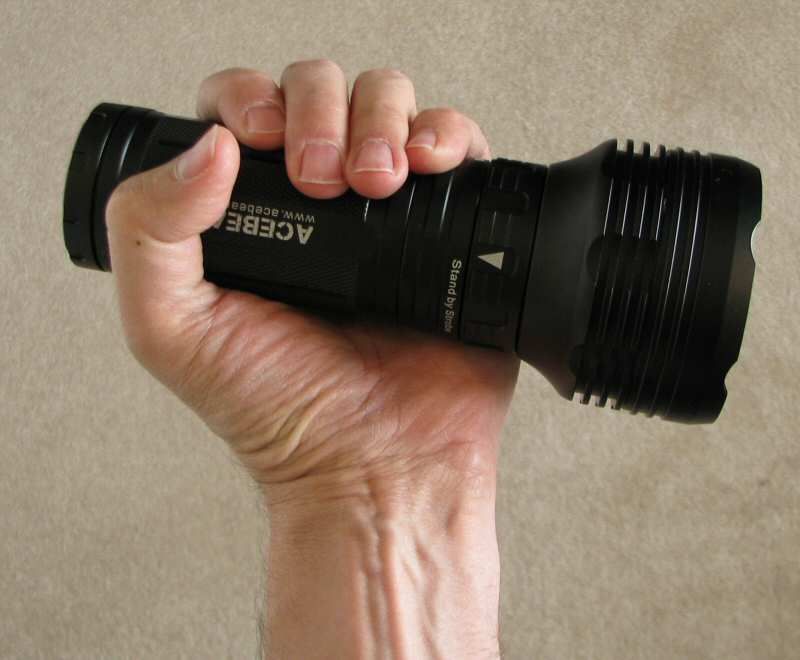

    The K40M build is similar to the K50 reviewed previously, minus the magnetic charging dock and in-light charger. As before, overall build is reminiscent of the Thrunite TN3x-series lights. Anodizing is a flat black, and seems to be in very good shape on my sample. Labels are sharp and clear, and include a serial number.
    Rather than traditional knurling, the handle has a checkered pattern. Combined with the ridge detail on the control ring and head, overall grip is pretty good. The light can roll easily however.

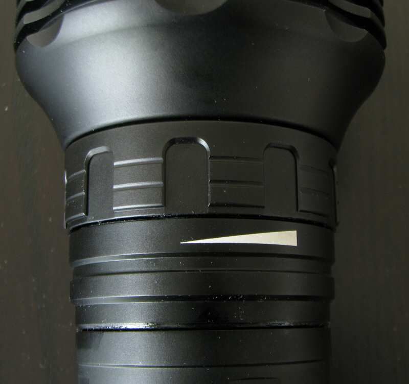

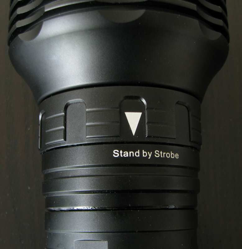

    The control ring feels and looks like K50. All black, there are slight indents (and raised checkered regions) on the control ring to help with feel. There is a label mark on the control ring that lines up with the labels on the head. The six constant output modes are not individually labeled, but there is a graded output bar pictogram over the first four levels (i.e., shows the direction to turn to raise or lower the output). There are firm detents at each level, with a slight click as you enter into each one.

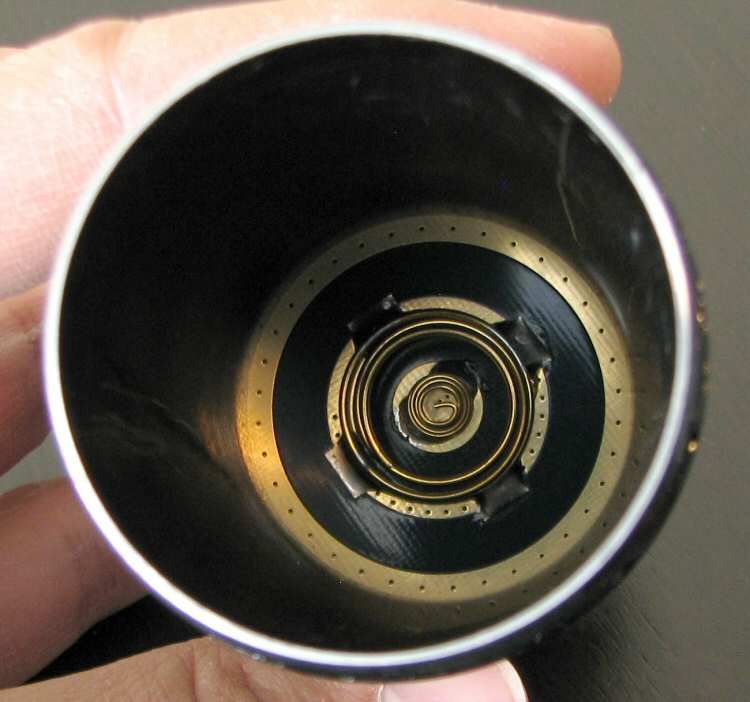

    Screw threads are traditional triangular cut, but seem of good quality. They are anodized, but it is the tension on the spring in the head than determines if you cam lock out the light by a twist. On my sample, a quick turn is enough to lock out the light.
    The lights can tailstand. Tailcap has cut-outs to facilitate access to the switch. Switch is a forward clicky switch (i.e., press for momentary, click for locked-on).

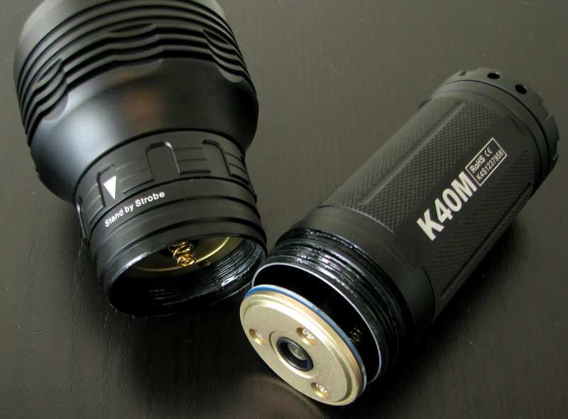

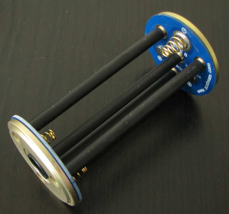

    Let's take a closer look at the battery carrier:
    The positive contact points inside the carrier are slightly raised, so all types of 18650 cells should work fine (i.e., true flat-tops, wide and small button-tops). There seems to be plenty of room in the carrier for length, so longer cells should fit fine. All the cells point the same way here (i.e., negative terminals at the base, positive terminals toward the head).

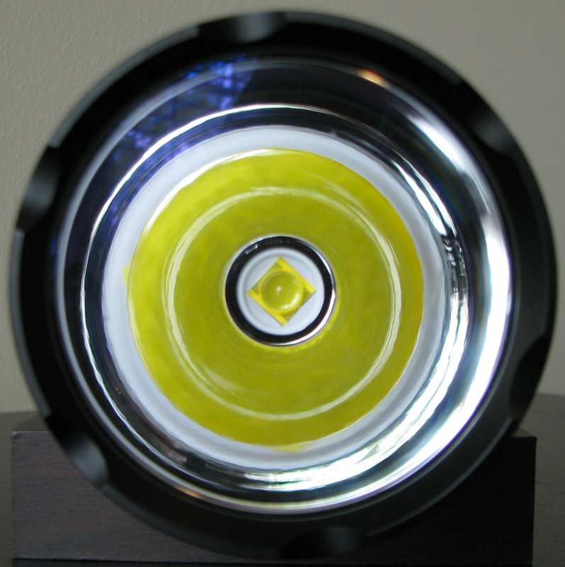

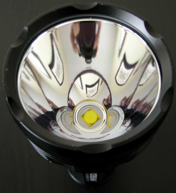

    MT-G2 emitter was well centered on my sample. Scroll down for beamshots.

    Change output modes by turning the control ring in the head. Arranged from left-to-right (looking down at the light, held in traditional flashlight carry), the modes are level 1 > level 2 > level 3 > level 4 > level 5 > level 6 (max) > standby > tactical strobe.

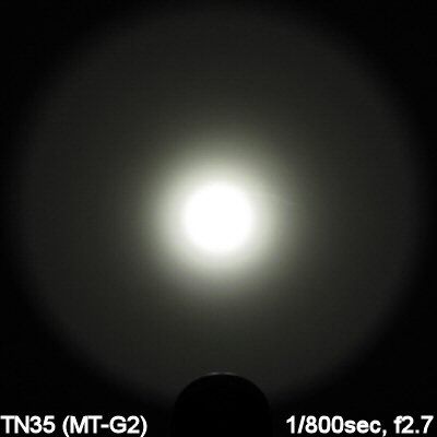

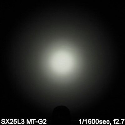

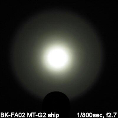

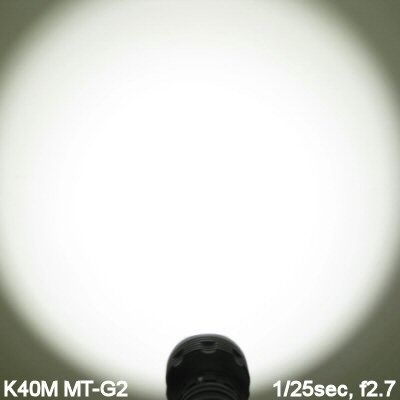

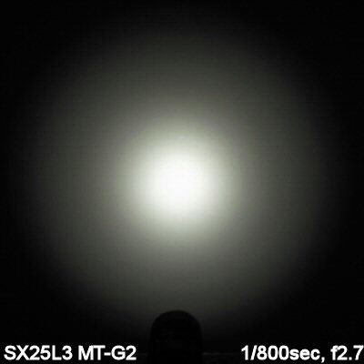

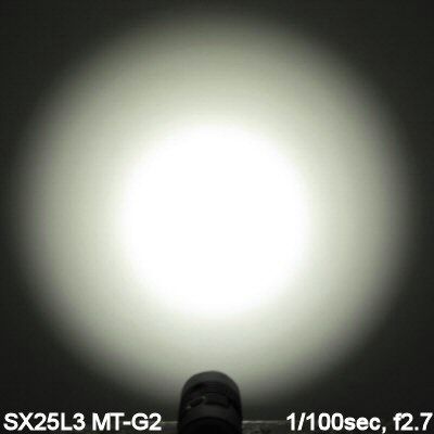

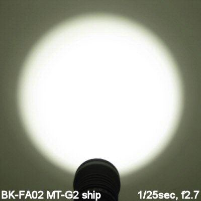

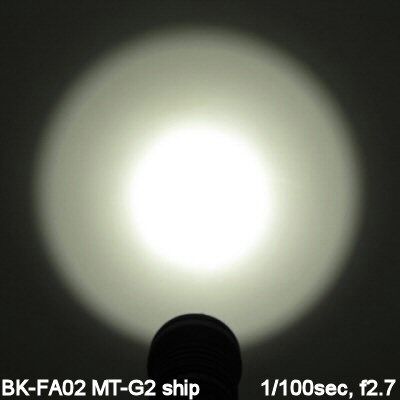

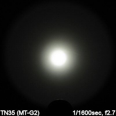

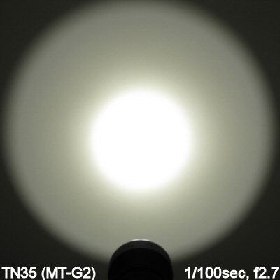

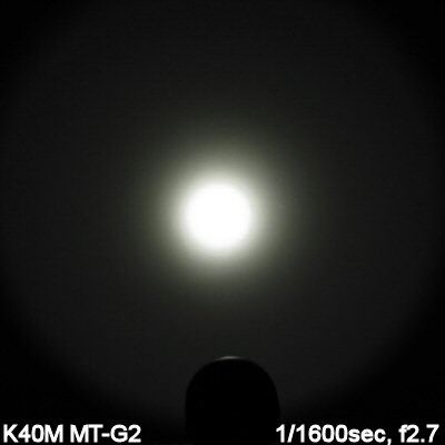

    And now, what you have all been waiting for. All lights are on their respective 18650 battery sources, about ~0.75 meter from a white wall (with the camera ~1.25 meters back from the wall). Daylight white balance used on the V54 modded lights.
    Spillbeam width is slightly wider than the Thrunite TN35 - but otherwise, the two lights share a very similar beam profile. Although you can't see it in the beamshots above, my sample of the K40M seems a bit cooler than typical for a Neutral White emitter.

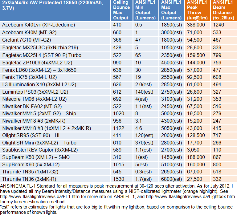

    The K40M is the highest output 1xMT-G2 light I've tested yet, marginally exceeding the Thrunite TN35 for output and throw. However, for all practical purposes, you could consider these two lights equivalent.

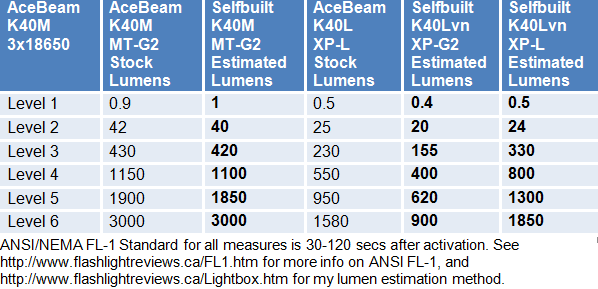

    Here is how the K40M compares to the Vinh Nguyen K40Lvn lights I've been testing at the same time.

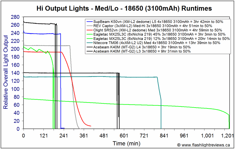

    Output/Runtime Comparison:
    As with all lights that share this design, there is a stand-by current when in the "Stand By" mode of the control ring. But this current is very low (60uA), and will not be problem for regular use. And you can easily break this current by clicking the tailswitch off, or loosening the head a quarter turn.
