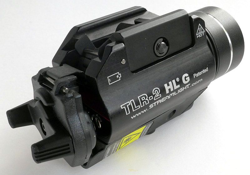

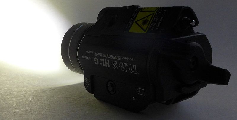

    Part of the Streamlight’s well regarded rail-mounted gun light range, the TLR-2 HL G features high lumen (HL) output, and a green laser sight (G) which can be operated independently or together. It uses Streamlight’s quick detach rail-mount system which allows for quick and easy, yet secure, mounting and dismounting without any tools.
    Taking a more detailed look:
    The TLR-2 HL G is delivered in a well-presented box.
    Straight out of the box the TLR-2 HL G comes with two CR123s and a bag containing the alternative recoil blocks (rail keys).
    Laying them all out you have the rail keys (Glock-style is already fitted) for Picatinny (1913), Beretta 90two, S&W 99 / S&W TSW, the Allen key for changing the rail keys with spare bolt and nuts, plus a smaller laser-sight adjustment Allen key.
    Here you can see the GL standard key already fitted.

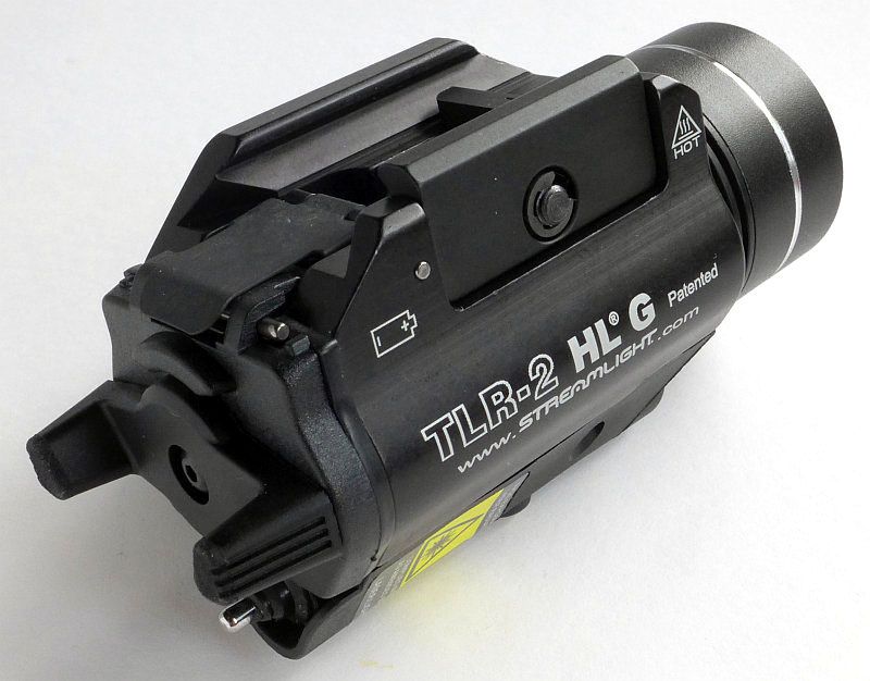

    On the underside of the TLR-2 HL G is the laser module. As delivered this has a high visibility warning sticker which you might want to remove for live use.
    Looking straight down onto the laser unit the vertical sight adjuster can be seen clearly with the label also indicating the modes available via the small toggle switch (Laser/Light, Light, Laser)
    From this view you can see both the vertical and horizontal laser sight adjusters.

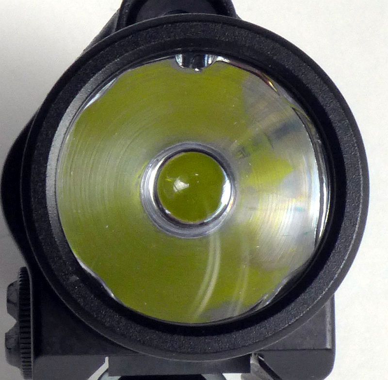

    Looking straight into the lens, you cannot see the LED as it is behind a full TIR optic.
    The bezel can be unscrewed and the optic dropped out to give a clear view of the XM-L2 LED. There is a glass lens in front of the optic which is more scratch resistant that the bare optic would be.

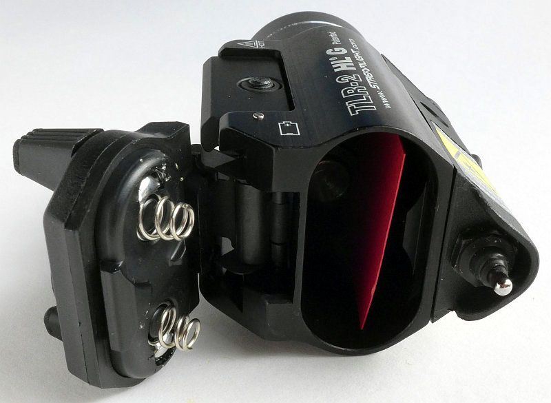

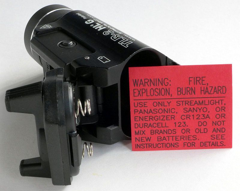

    In this next sequence, we look at the battery door opening process. The battery door is kept closed by a lever which cannot open when the light is rail mounted. You have to remove the light to be able to change out the cells.
    Just above the batter door / switches you can see a flat lever.
    This lever starts to lift, initially sticking out perpendicular to the rail-mount.
    Then flips over fully, cracking open the battery door.
    The door has a lug which engages into the door opening on the opposite side to the lever/hinge, and this can then be popped out freeing the edge of the door.
    The battery door hinged open.
    Out of the box you find a warning card in the battery compartment.

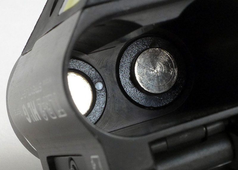

    Looking inside you can see the physical reverse polarity protection provided by the contact design.
    Cells loaded ready to close the battery door.

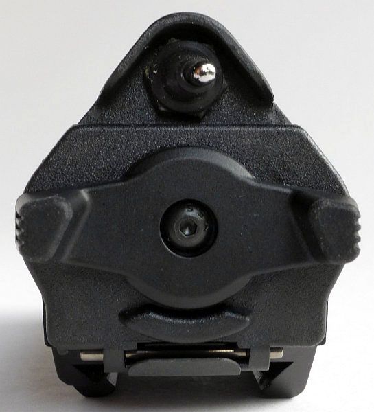

    More on this later, but these are the control switches on the back of the TLR-2 HL G.
    With the selector switch in ‘Laser’ the paddle switch rotated the latching direction we have our first glimpse of the Laser sight.
    Moving the selector switch to its central position the output is latched onto the main beam.

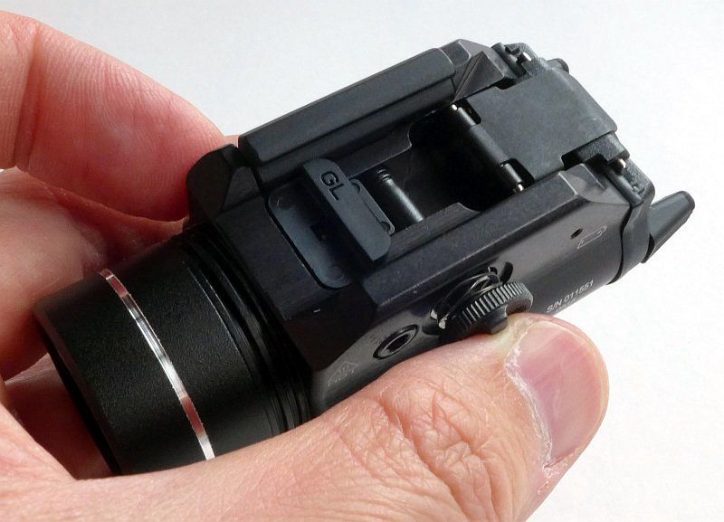

    The mount is an integral part of the TLR-2 and is the same used on the other Streamlight rail mount gun lights. It is a tool-less design making fitting and removal simple yet secure.
    The first step is to unscrew the rail clamp tension bolt so it stands out as shown.
    The bolt is then pushed in with hand pressure.
    Opening the rail clamp on one side enough to snap it onto the rail.
    And it is on (after lining up the rail key). The rail clamp tension bolt is then tightened to secure it.
    The switches fall nicely to the front of the trigger guard making them easy to access.

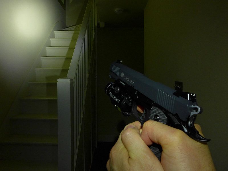

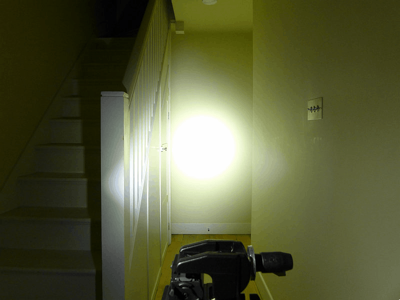

    Starting indoors, the TLR-2 HL G is very bright.
    In this animation, the main beam and laser are both on, and then the laser only, at the same exposure. As you can see the main beam at this range washes out the laser.
    The optic produces a hotspot with visible square around it that is actually from the square shape of the LED emitter surface. It is obvious, but does not interfere with its use.
    A gratuitous shot of the laser on its own (the exposure has been adjusted to make this more dramatic).

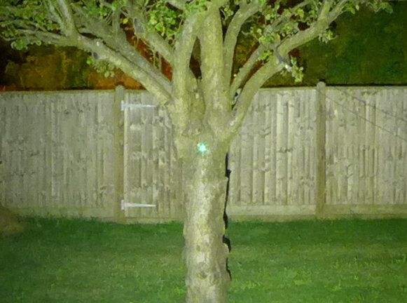

    Moving outdoors to a more normal range there is plenty of light from the ‘HL’ beam. As before, in the animation, the main beam and laser are both on, and then the laser only at the same exposure. As you can see, the main beam at this range still mostly washes out the laser.

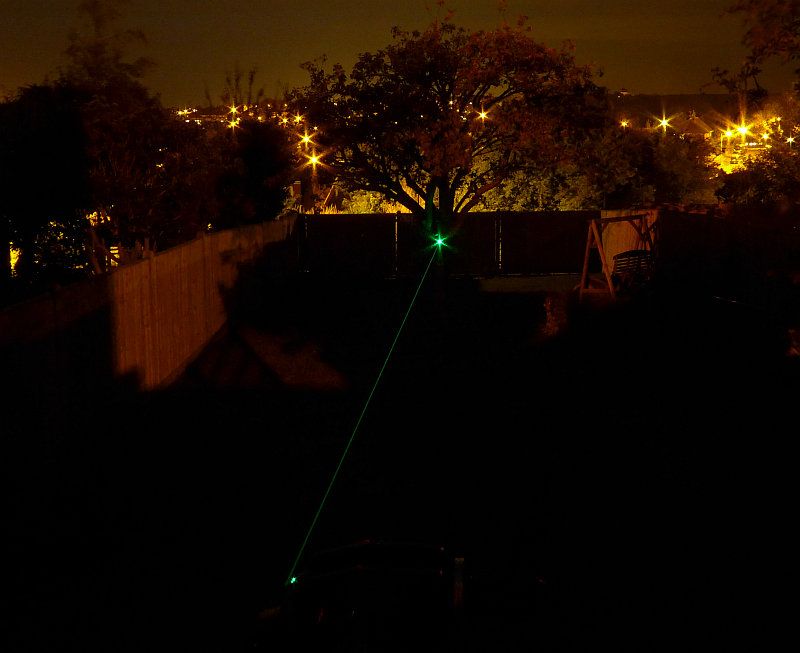

    However, the laser is more visible than at closer ranges due to a laser’s very low beam divergence.
    Another gratuitous laser beam shot …….. just because… (the exposure has been adjusted to make this more dramatic).

    With mode selected, the control is via a two-direction paddle switch. The paddle switch has a double ended lever to provide access for left or right handed shooters. When gun mounted (here it is upside-down) Lift the Left-hand paddle fully to latch on the selected mode. Push the Left-Hand paddle down for momentary operation.
    Strobe is accessed by double-tapping the Main beam. This can either be on momentary or latching paddle operation.
    Much like Streamlight's other Ten Tap programming, the strobe can be disabled or enabled by tapping the momentary paddle rapidly ten times, but holding it on the tenth time, then holding it until the light goes off after about 1s (indicating successful programming).
    The paddle switch is perfectly placed for easy operation by the supporting hand. It is possible (if your fingers are long enough) to use the trigger finger to latch the TLR-2 ON, however this is not something you would want to do in the heat of the moment as it occupies your trigger finger and might delay a response.

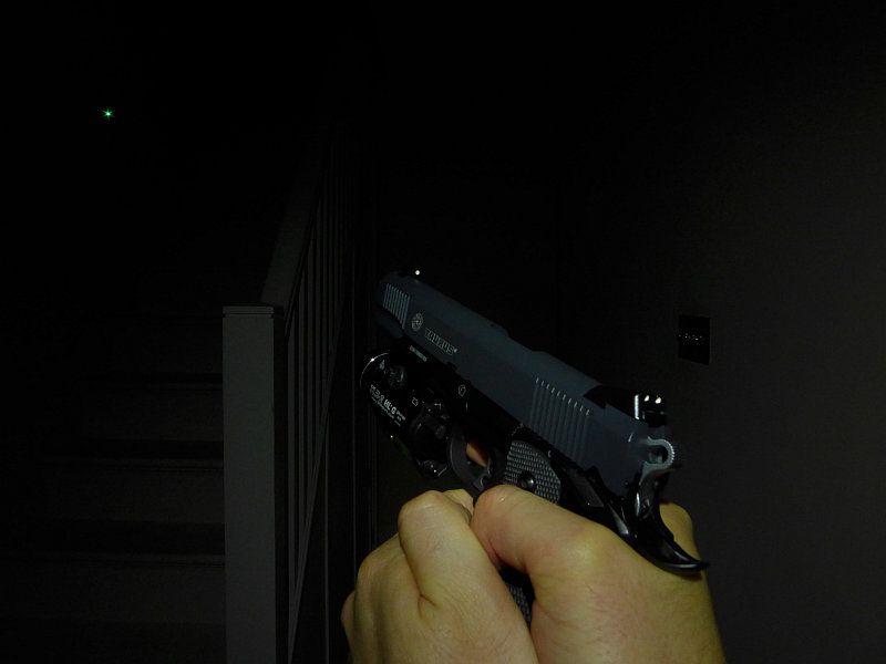

    When looking at how the TLR-2 HL G is in use, first things first, mounting and sighting in. The rail clamp is something I really like about the Streamlight gun lights. Quick, easy and secure. For complete security you can use a coin to tighten the clamp bolt fully, but otherwise no tools are needed.
    Firmly mounted, the next step is the sighting in. This is super easy if your open sights are already sighted in at your chosen range. With the laser being further from the centre of the bore than the open sights are you will notice an increased sensitivity to range variations, so you need to pick your range to suit. Having decided on the range, simply stand that distance from a suitable surface to shine the laser on. You can then see where it is in relation to the open sights. Using the small Allen key, one axis at a time make adjustments to bring the dot in line with the open sights. This took me a couple of minutes to get it precisely where I wanted it.
    And here we are with the dot appearing just above the sights.
    Swapping over to the main beam, you get a very clear sight picture making target acquisition quick and easy.
    If your eyes are adjusted to allow reliable target identification, the laser gives you the instant ‘pointability’ of this type of sighting.
    But for absolute certainty a blast of the main beam makes it all perfectly clear. Here (for the sharp eyed among you) the TLR-2 it latched on, with my trigger finger sitting ‘safely’ on the side of trigger guard.
    The TIR optic does give you the visible square in the beam. When looking through the sights I did not find this any distraction. Instead I could take confidence in knowing how robust the TIR optic is and even if the glass lens were to break, the optic will not be affected.
    Activating strobe is easiest using the momentary switching. To get strobe to come on with the latching switch means you have to stop before the point the latch holds the switch on, then release and press again. When done in a hurry this can just result in the beam ending up as the steady output rather than strobe.

    Is the green laser daylight visible? Debating between this guy and the TLR1
    Thanks!
    Hove, UK
    2,468
    Default Re: Review: Streamlight TLR-2 HL G Gun light with Laser sight (2x CR123)
    Quote Originally Posted by V8TOYTRUCK View Post
    Thanks!
    Great question. I'll have to check. I would expect it to be, but daylight conditions are very varied, as is the reflectivity of the target. As soon as I get a bit of time I'll get this light out in the daytime to check.
