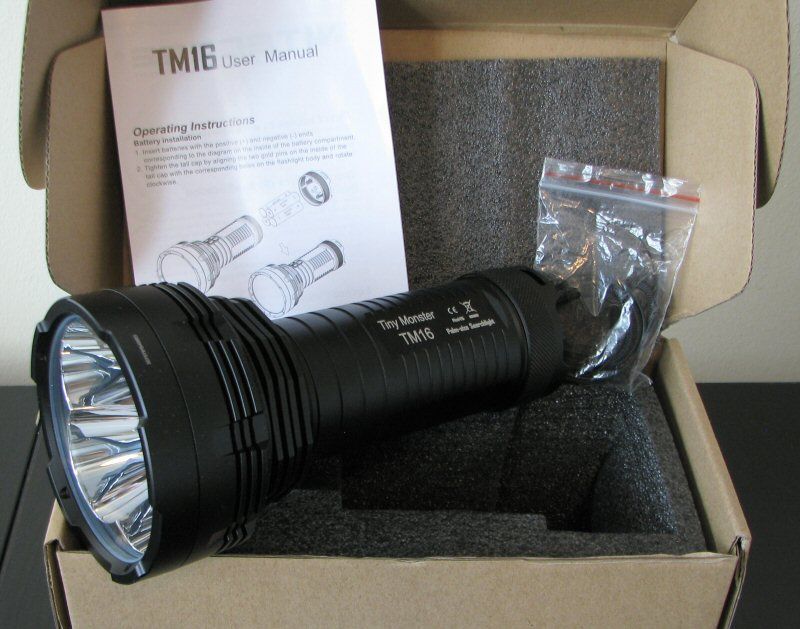

    Packaging is the standard cardboard box with built-in packaging foam from Nitecore. Inside you will find the light, extra o-ring, simple wrist lanyard (with threading wire), and manual. Note that there is no holster.
    From left to right: Keeppower protected 18650 3100mAh; Nitecore TM16, TM15, TM06; Fenix TK75, Eagletac MX25L4.

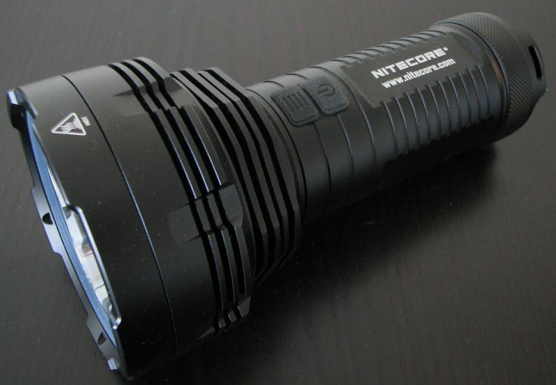

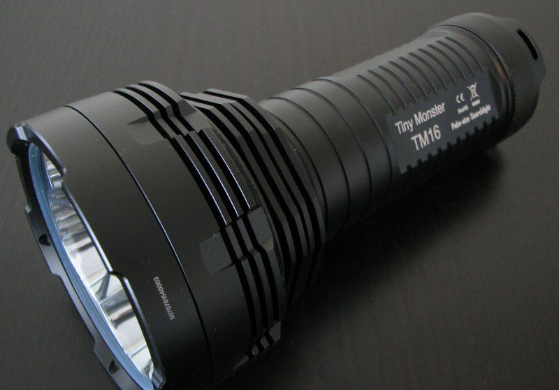

    Definitely a departure for the TM-series. Think of the TM16 as a very big brother to the TM06.

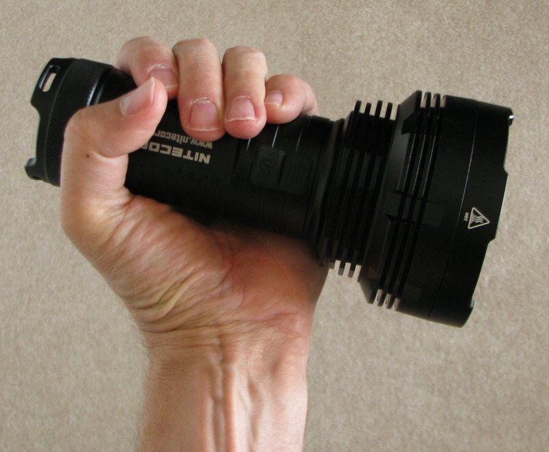

    This is a much larger light than any of the earlier Tiny Monster series, due to the greatly enlarged head. The physical interface has also changed, eschewing the two-stage "camera-button" style light on the earlier TM11/TM15, in favor of a two-button option as seen on the EA41, for example. Overall feature set and functionality remains similar across the TM-series, however.

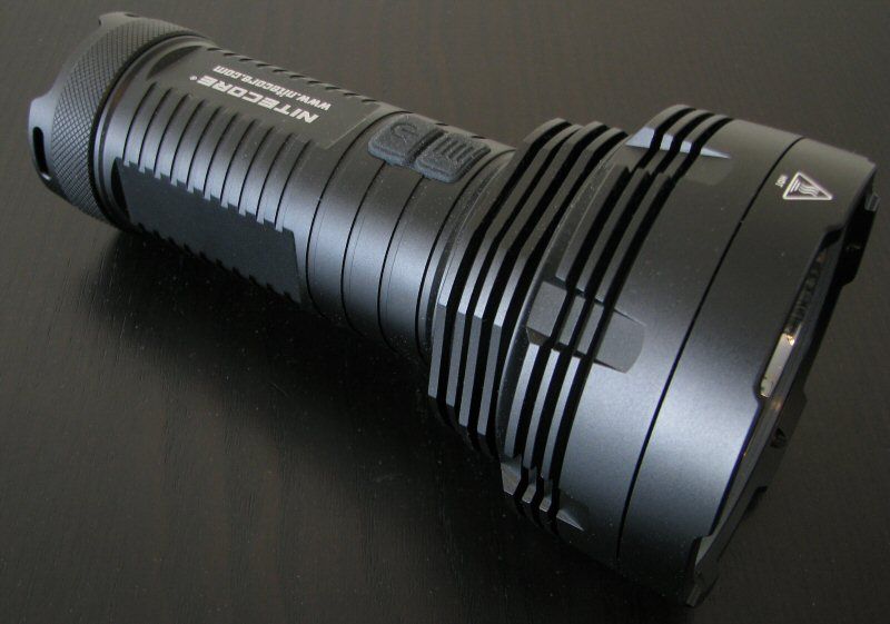

    As with other TM-series lights, there are cylindrical ridges along the body to help with grip – and extra heat-sinking fins on the head of the TM16. There is no knurling per se, except on the tailcap (but is fairly mild here), but overall grip is good. Light can roll, but cut-outs in the head help limit this.
    Anodizing is matte finish (flat black). Body labels are fairly extensive, but not as bad as some of the earlier models. Labels remain very legible and clear.
    The TM16 uses two rubberized square buttons, located one above the other, as on the EA41. The lower button is the power button, and the upper is the mode changing button (see my User Interface section for more info). Button feel is fairly "grippy", and they are slightly raised. Like the EA41, there a single blue LED located underneath the switch area. This is used to signal the state of the light (i.e., battery status, standby). Scroll down for an explanation of the interface.

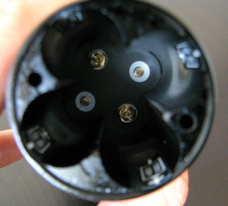

    Battery handle more like the multi-cell EA-series design than the earlier TM-series, with the batteries arrange in series, not parallel. The TM16 uses a similar tailcap design to the multi-cell EA-series lights. Screw threads are square-cut and anodized, but it doesn't really matter, because the connection is carried by the contacts in the tailcap and not the body. You would need to loosen the tailcap more than half-way off to break this contact and lock out the light.
    The light can tailstand. There are cut-outs on the base to allow you thread a wrist-lanyard through. There is also a tripod screw mounting area on the base (which seems like a bit of an odd location for one).

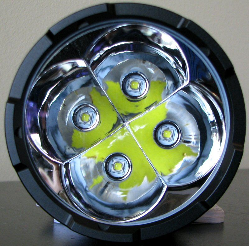

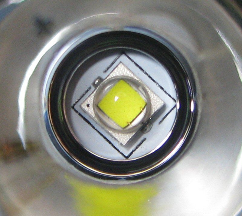

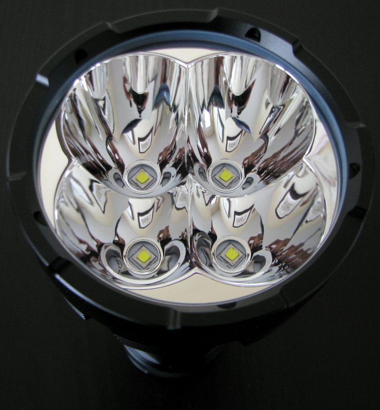

    The TM16 uses 4xXM-L2, each at the base of a fairly deep smooth reflector well within the larger reflector. As with most lights of this type, there is a lot of overlap between the wells. This should translate into good throw for the size and output, but with overlapping spillbeam artifacts. Scroll down for beamshots.

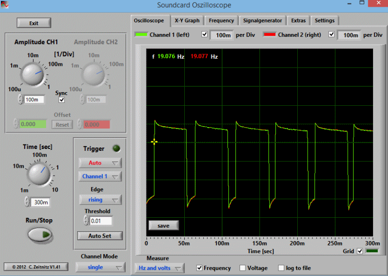

    There is no sign of PWM on any level – the light is current-controlled.
    Strobe is a fast tactical 19 Hz strobe.

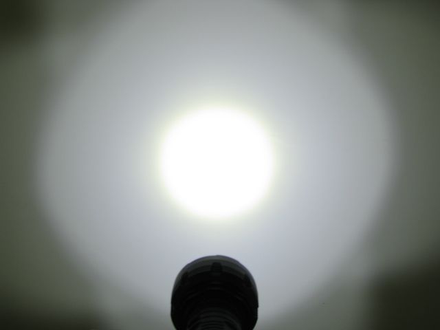

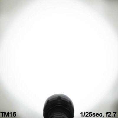

    And now, what you have all been waiting for. All lights are on their respective 18650 battery sources, about ~0.75 meter from a white wall (with the camera ~1.25 meters back from the wall).
    The TM16 is an excellent thrower for the multi-emitter class. It's a bit hard to see above, but the four overlapping beam wells do produce significant artifacts in the periphery of the spillbeam. You can see this a bit better here:

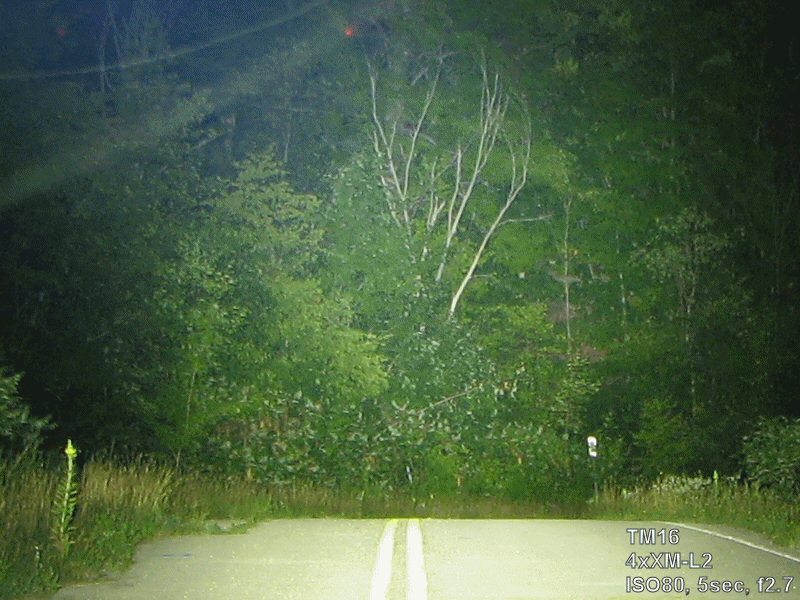

    For outdoor shots, these are done in the style of my earlier 100-yard round-up review. Please see that thread for a discussion of the topography (i.e. the road dips in the distance, to better show you the corona in the mid-ground). Note there are a lot of bugs out at this time of year, so expect to see some flight trails.
    Sorry about any tint effects – I accidentally left the camera on Automatic color balance for these shots. Please see my review catalog at flashlightreviews.ca for the AceBeam K40M, Eagletac ZP10L9, and Lumintop SD75 reviews.

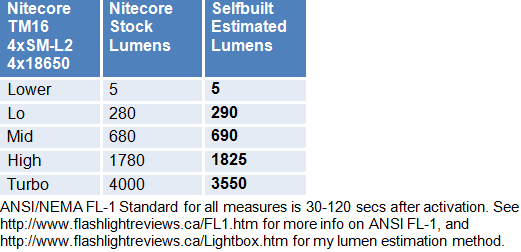

    The TM16 is the highest output TM-series light yet, exceeding most other 4xXM-L2 lights or MT-G2 lights (although the higher-power Eagletac ZP10L9 is still a champ here). Throw is very good for this style of light.
    Stated output specs seem reasonable, based on my testing.

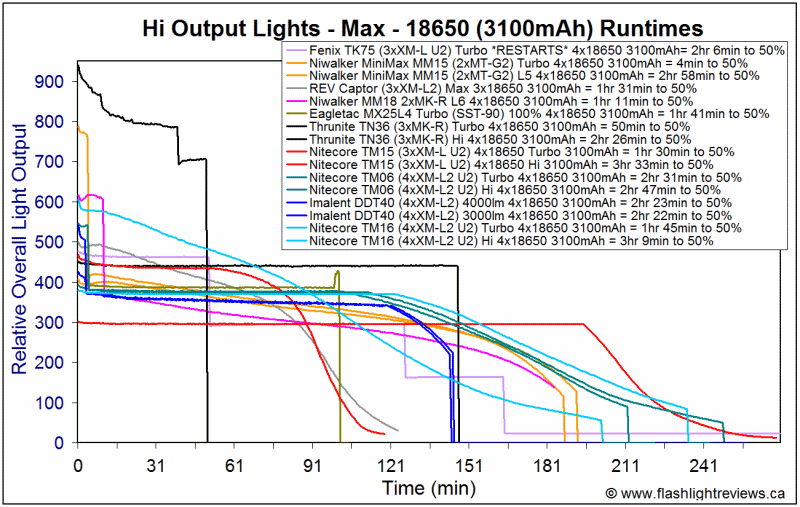

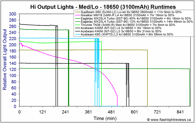

    Output/Runtime Comparison:

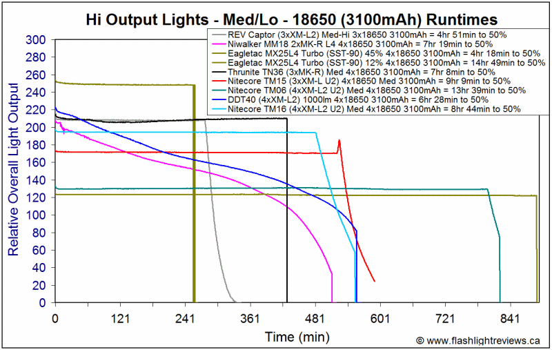

    I currently do all my runtime testing on Panasonic NCR18650A (3100mAh) based protected ICR cells.
    Max output is definitely higher on the TM16 than the earlier TM-series lights – although overall efficiency seems pretty much identical to the recent TM06 at the lower levels, as you would expect.

    Due to the large overlapping reflector wells, there are significant spillbeam artifacts on the periphery of the beam.

    Overall output/runtime efficiency remains very good as before - consistent with a good current-controlled circuit. Basically, this is the TM06 with a large head grafted onto it. This allows for an increased max output level (likely due to the extra heatsinking the large head provides).

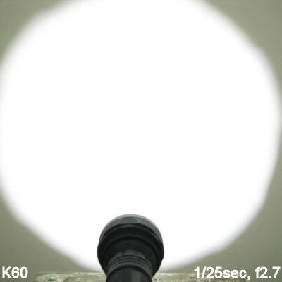

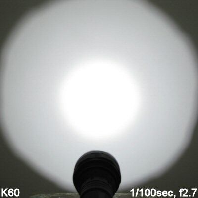

    Thanks for the great reviews as always. I wish you would have included the K60 in the pics and graphs as I think these two are direct competitors. I've been debating between buying the two. They are similarly priced, similarly sized, and have similar advertised output. This light is slightly smaller than the K60, but K60 has superior output.
    Also, it's worth noting that it uses a plastic reflector.
    +1 for some comparison k60 shots if possible..

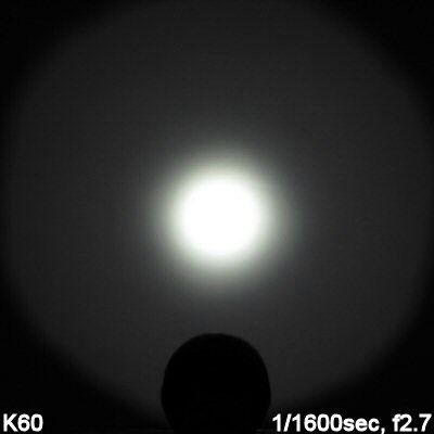

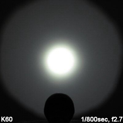

    Sure, easy enough to do for the beams. Just added to the review the white wall shots and the outdoor comparisons with the K60.
    A little more work to add in the K60 to the runtimes (i.e., have to regenerate everything). So here's a copy of those runtimes from the K60, to help you compare:

    BTW, did anyone ever figure out why the TM16 takes so long to turn its LEDs off? 1 of the 4 LEDs in mine takes noticeably longer than others, but they all basically dim out instead of just turning off.
    Here's a gif of the LEDs turning off:
    Default Re: Nitecore TM16 (4xXM-L2, 4x18650) Review: RUNTIMES, BEAMSHOTS and more!
    Quote Originally Posted by 100eyes View Post
    After some use I can confirm the moonlight mode on the TM16 is not very useful.
    That's odd. All 4 of my LEDs dim equally and fairly quickly, but I do notice the delay. I would say about 1 second after turning off.
    Don't forget - the visible light we see is actually being produced by phosphors being stimulated by the actual LED emitter. I would guess that, due to variances in the phosphor makeup, some of the phosphors are slower in giving up all their energy than others after being hit for a while with 1,000 lumens. I have noticed the same phenomenon on my TM16. It is obvious the LED is off, but there is a dimming glow for about a short second.

    Selfbuilt, in your testing did you happen to measure the current draw on Turbo? Some have raised the question of ICR 18650 cells ability to keep up when the light is in Turbo mode.
    As always, thanks for your efforts on our behalf. I don't know what we would do without you and our other review gurus to give us the straight story.

    Quote Originally Posted by Timothybil View Post
    That was recorded turning off from moonlight mode. I also just received the TK75 2015 since I wanted to compare it against the TM16; all LEDs turn off instantly in all modes.
    No, as that is not so easy to do - the cell setup is not simple, and a regular DMM and leads will not give you an accurate current reading (even if you wired it all up). I know from experience that output is generally affected by the resistance of the DMM and/or leads, rendering the results invalid.
    Just going from the runtimes, it seems like ICR cells should be alright.
    I did a quick test with my TM16 at about 2.5m from a white wall at Turbo. I compared the Olight 18650 3400mAh and Acebeam ARC18650H-250A using LG 18650HE2 20A 2500mAh cells.
    Battery | Incident | Reflected
    Olight | 13000lux | 3300 cd/m^2 (lux)
    Acebeam | 14000lux | 3600 cd/m^2 (lux)
    Measurements were taken with a Sekonic L-758C light meter. The TM16 was positioned on a tripod.
    The TM16 voltmeter showed 4.1V for both sets of batteries after testing. I'll see if I have time to repeat the test with both sets of batteries freshly charged. I did not bother to cool down the light and I tested the Olight before the Acebeam batteries.
    The results show a clear increase in light output for the Acebeam IMRs compared to the protected Olight cells.
    6,936
    Yes, I have just done an output test on Acebeam 2500mAh IMR cells (20A rated), and get a ~6% increase in ANSI FL-1 max output, over NCR18650A 3100mAh ICR. So, that would be ~3750 estimated lumens.
    I will do runtimes when I get a chance, and update this review in a couple of weeks (currently away).
    I am a little upset at the apparent lack of regulation on Turbo mode. The curve actually looks like a direct drive curve. It looks like after a time I can actually get more light from High than Turbo as the cells run down. Other Nitecore lights easily make 1k lumens with regulation, so why not use it in this one? Any of our driver gurus have an idea?
