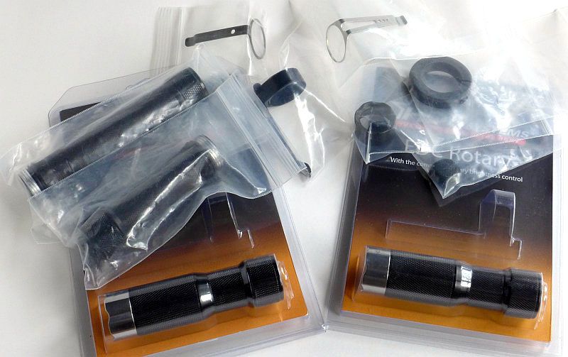

    Both Rotary and Executive models are packaged in the HDS standard plastic clamshell blister pack.
    On the back of each pack are the specifications of each custom built light (customers can choose the emitter/output, bezel, clips etc).

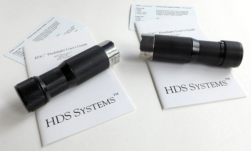

    As well as the two lights, most of the HDS optional accessories were included (more on those later).
    Each light comes with only a printed instruction book and quick reference card.

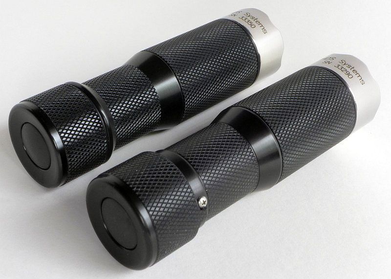

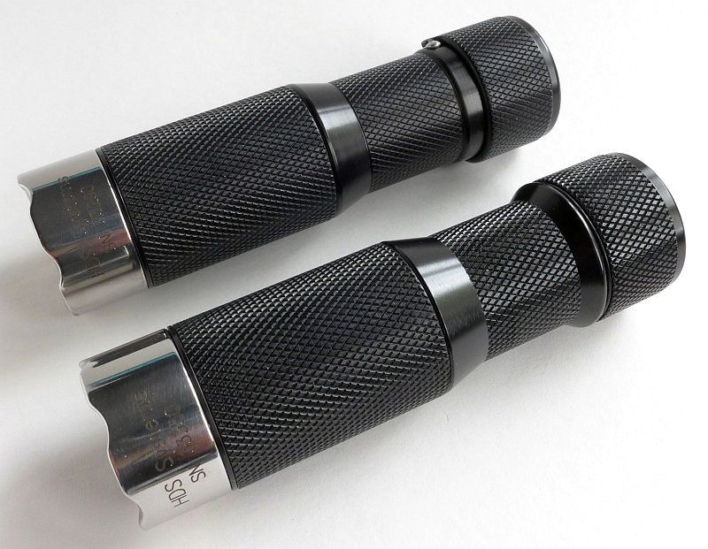

    Side by side with the standard CR123 battery tube, the rotary is slightly longer than the Executive.
    The Executive and Rotary Looking super sharp with a flawless finish.

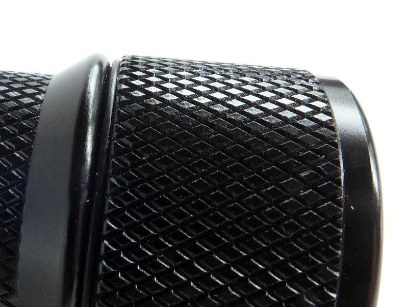

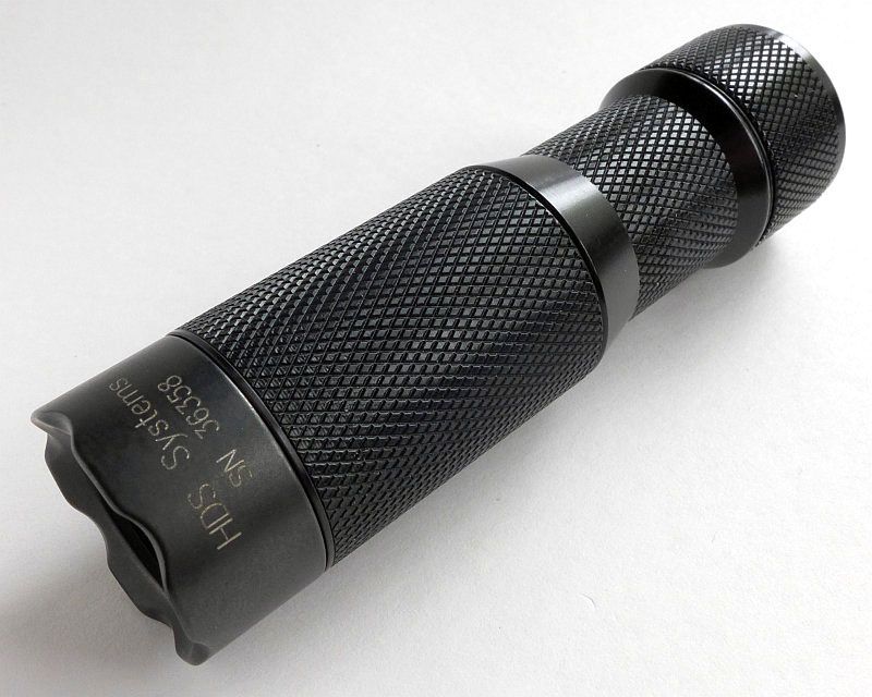

    Not to miss out on any details, first we look round the Executive. Deep rich anodising and an excellent finish leave you in no doubt this is a special light.
    This Executive CR123 tube has the low profile switch boot fitted.
    Quality machining is evident all over this light. Here you can also see the thin ‘filler’ o-ring at the base of the switch cap, which simply fills the groove where the pocket clip would be. As its function is purely aesthetic, it is removed if a pocket clip is fitted.
    The side profile of the Executive shows the waisted battery tube, which allows for a more secure grip for a normal or cigar grip.

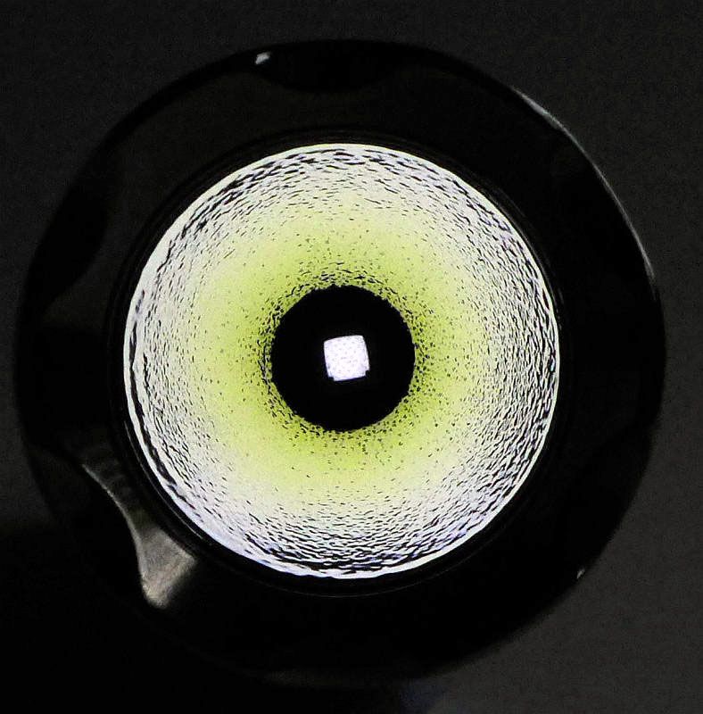

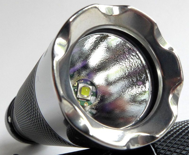

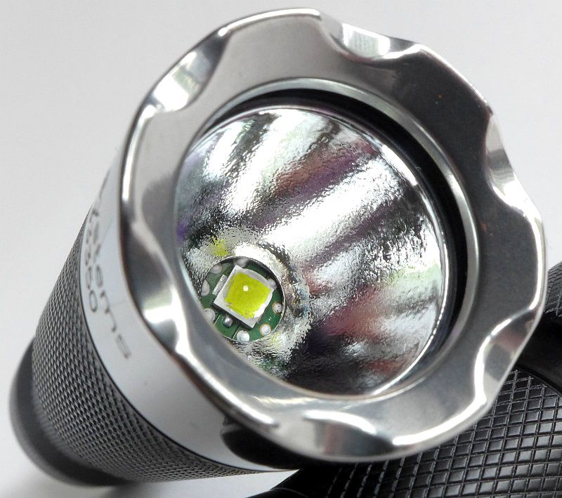

    The reflector is lightly textured.

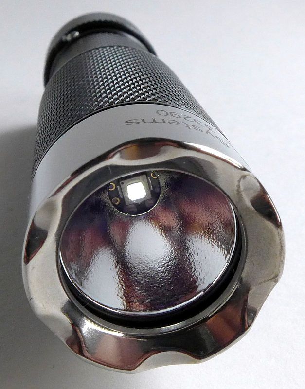

    This Executive is fitted with a 325lm XP-L LED.

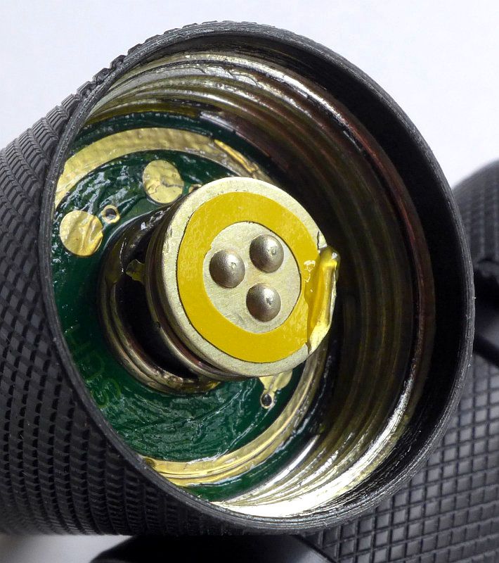

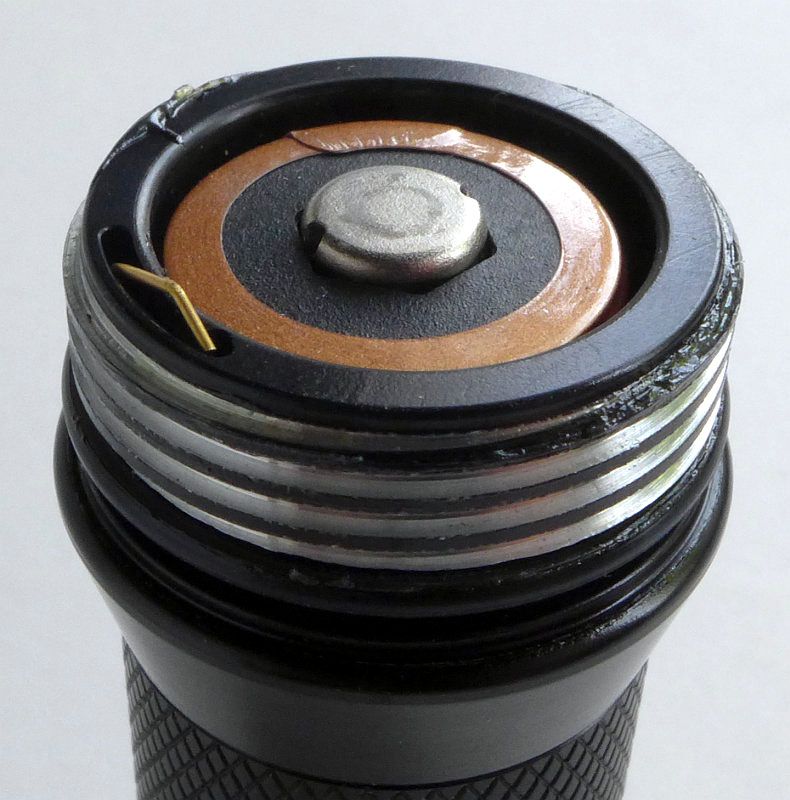

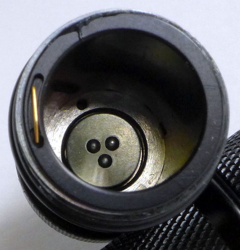

    The central positive contact in the head consists of a spring with capping plate. The threads form the other main contact as the circular contact ring on the driver board is for the signal wire connection.

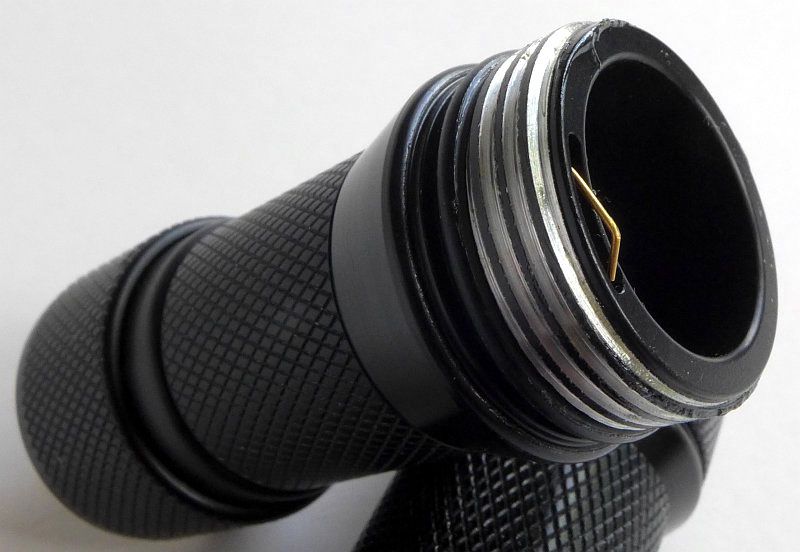

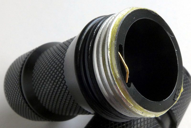

    Looking into the battery tube there is a similar capped spring for the negative contact. Inset into the edge of the battery tube is the signal wire used to communicate the switch clicks to the driver board.
    The signal wire protrudes slightly.
    Square cut ACME threads are used.

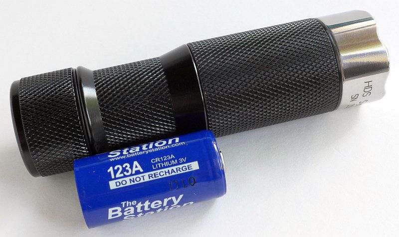

    The Executive next to a CR123 cell to get an idea of its size.
    A CR123 loaded and ready to go.

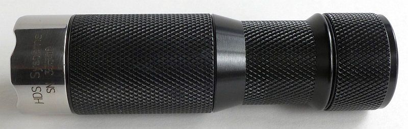

    Switching over to the Rotary.

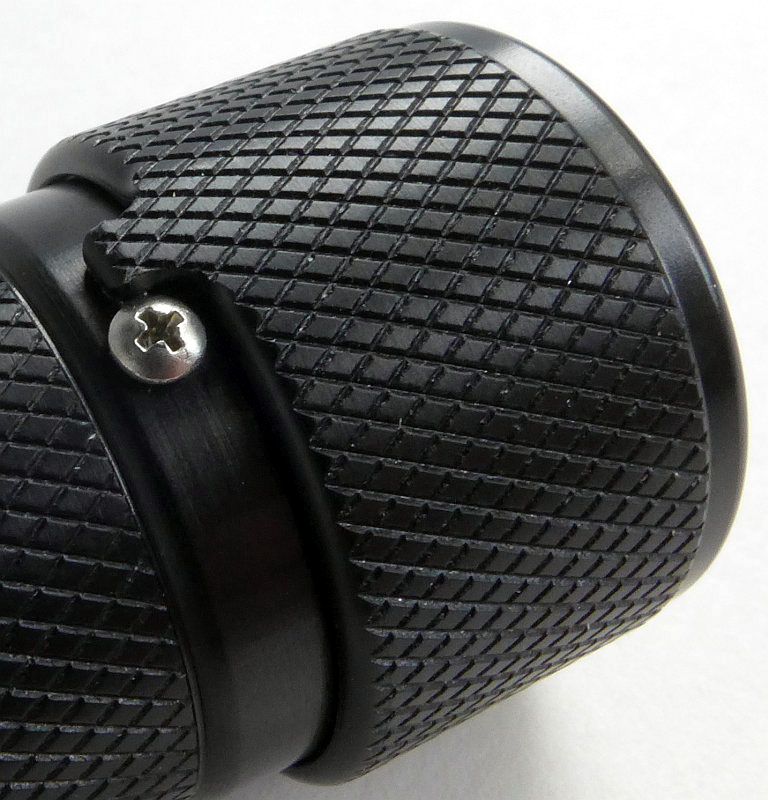

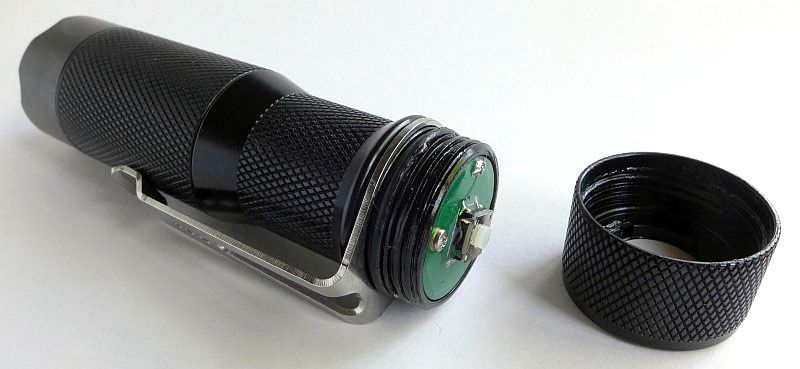

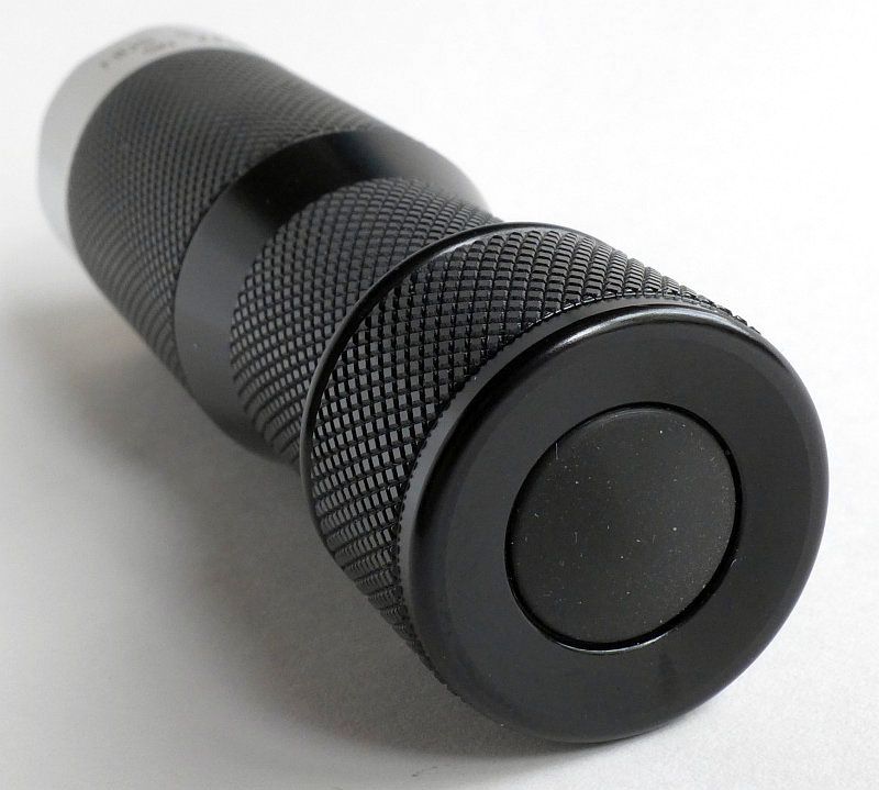

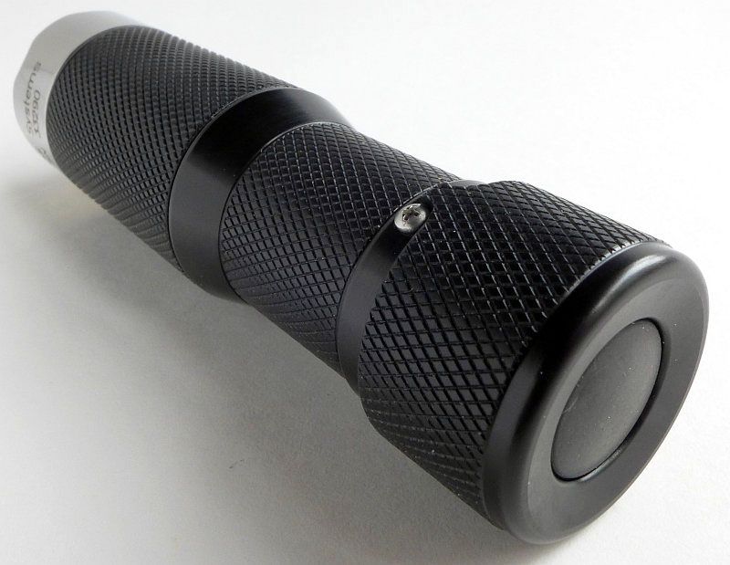

    The Rotary’s tailcap has a stop-screw to provide a reference for the position of the rotating tailcap. In the position shown its output is the minimum.
    As with the Executive, the Rotary was supplied with the low-profile button.

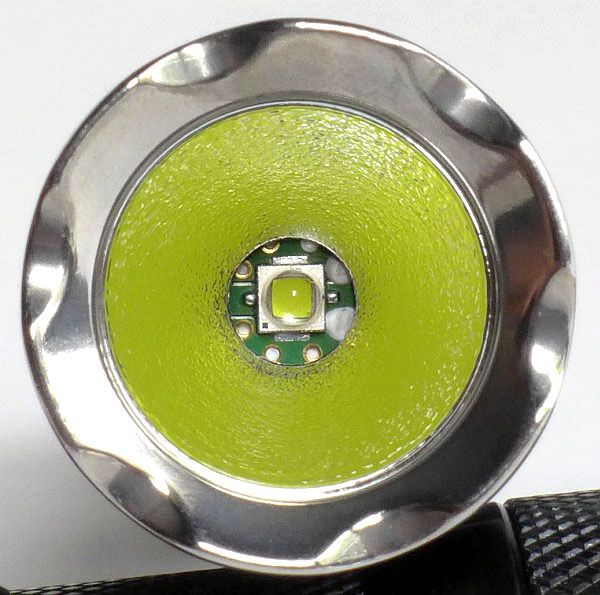

    This Rotary has the XP-G2 LED.
    Using the same textured reflector used in the Executive.

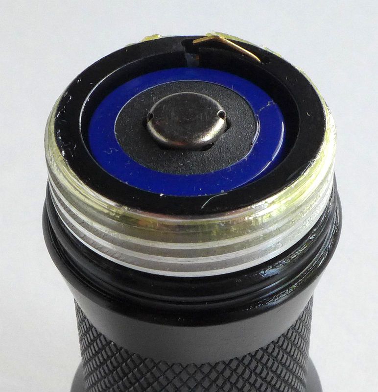

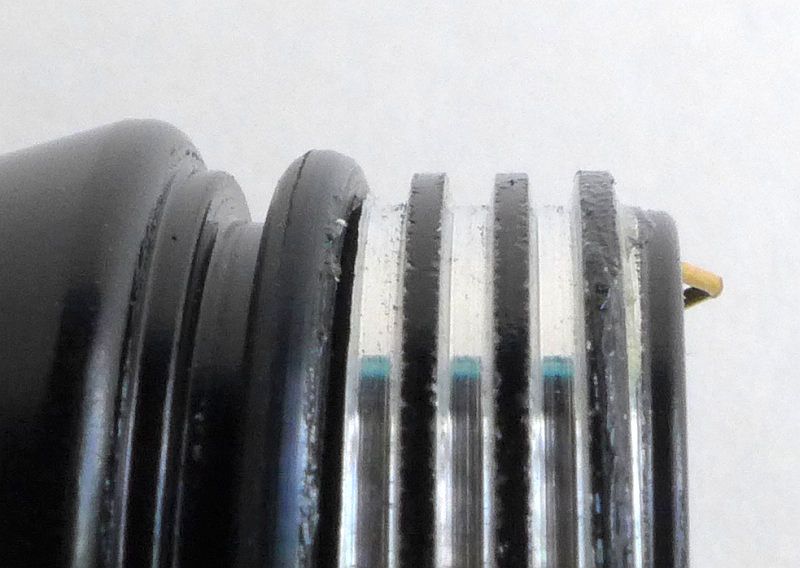

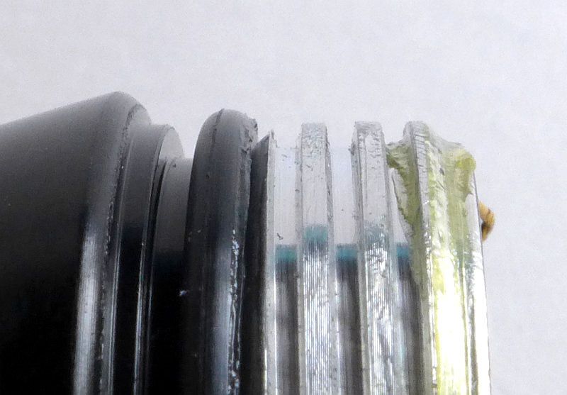

    This particular Rotary battery tube has anodising still on the top of the square threads. This makes no difference to function and only indicates a slightly different manufacturing process.

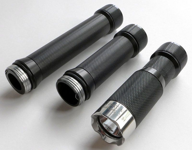

    In this photo the tubes are shown next to the cells they hold.

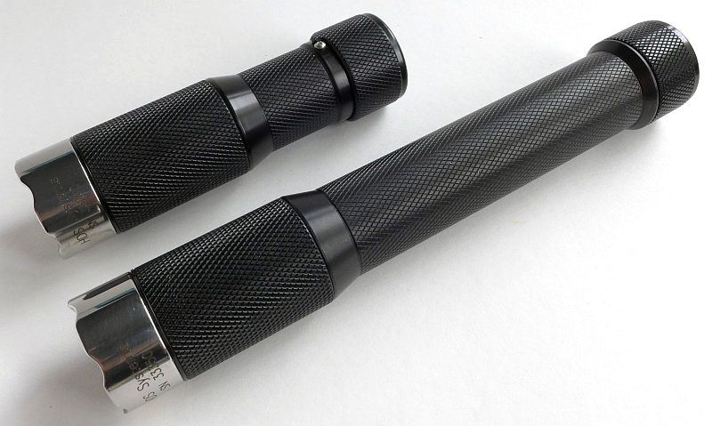

    With the Rotary shown for a constant scale reference, first the Executive is shown with its CR123 battery tube.
    Then the 18650 tube.
    And the 2xAA tube.

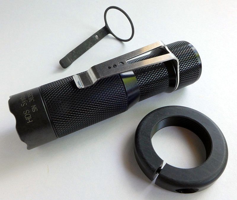

    This photo is packed with accessories:
    Black Stainless steel bezel with black nitride finish.
    Universal pocket clip, black.
    Tactical ring.
    Raised button.
    Decorative pocket clip.
    Pocket clip, black.
    Here the bezel has been swapped over on the Executive.
    The black bezel certainly gives the Executive a different look.
    For the Rotary you need to choose the universal pocket clip as you can’t remove the switch cap. The finish is as precise and flawless as the light it goes on to.

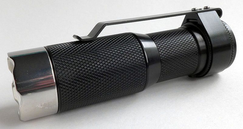

    To fit a pocket clip to the Executive, first unscrew the switch cap. Then you need to remove the o-ring to avoid pinching and damaging it, and slide the clip into place.
    Here the Executive is sporting the silver decorative pocket clip.
    Profile view of the decorative pocket clip.
    Next to the Executive is the black pocket clip and tactical ring.

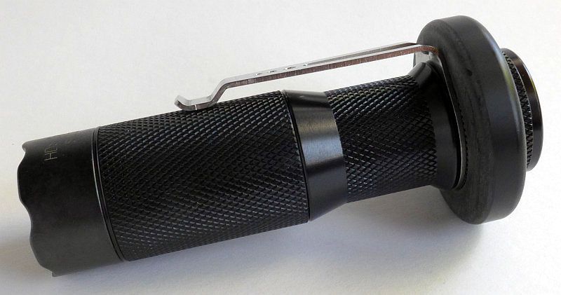

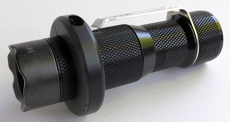

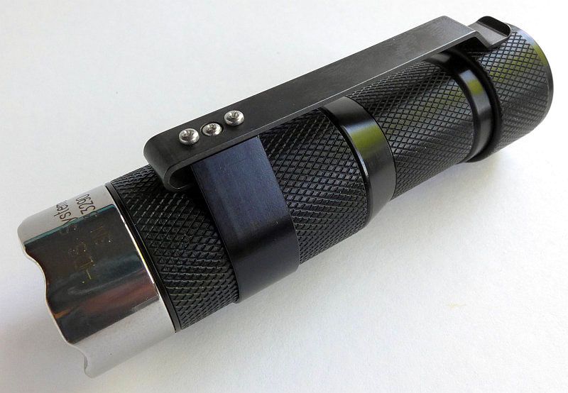

    The grip ring can be fitted on the switch cap. (You should also fit the raised button if using the grip ring – the reason this was not done during the photography stage of this review was due to time constraints)
    Or alternatively towards to front, depending on how you want to improve the grip. (If fitted to the front the pocket clip should be removed)
    This photo shows why, when fitting the tactical ring, you should not have the pocket clip fitted, as the grip ring interferes with the pocket clip function. (Remember you should also have the raised button fitted).

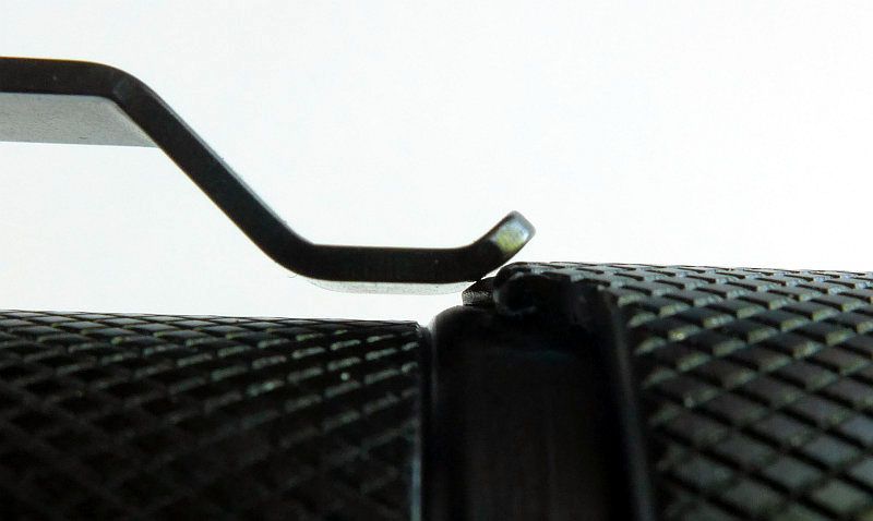

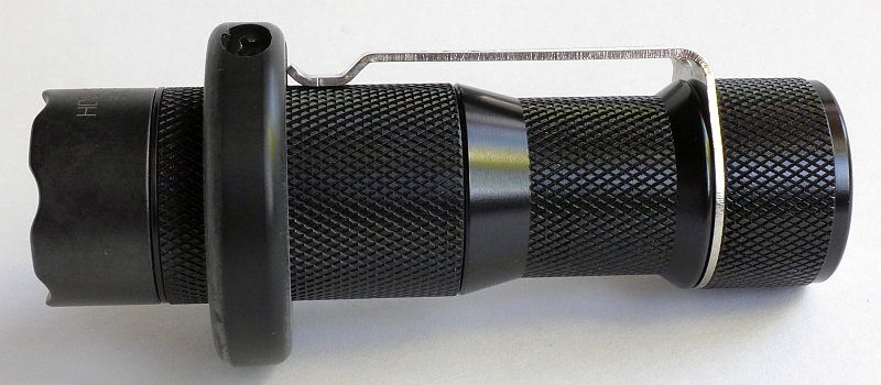

    Due to its rotating tailcap, if you fit the pocket clip to the Rotary’s tailcap, the clip will rub on the head of the light as you adjust the output.
    The universal clip is more versatile as you can fit it the other way round for a bezel-up hold. But, as shown, you still have rubbing while adjusting the light level, this time on the tailcap itself.
    However if you bring the mount just over the bezel, you can position the clip in to just sit on the stop screw.
    In this position there is no rubbing when adjusting the output.

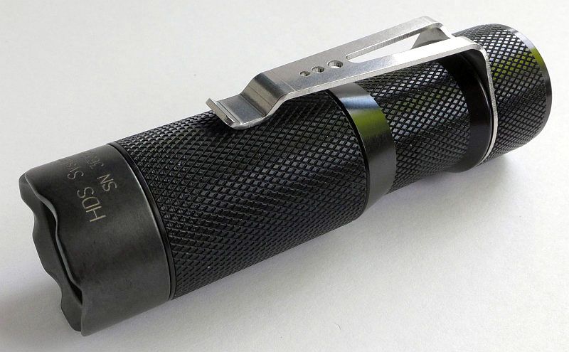

    The 18650 tube has had the black pocket clip fitted.

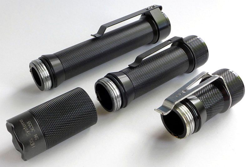

    The Executive is shown with all its options of pocket clips, battery tubes and the black bezel.
    As before but with the Rotary included for reference.

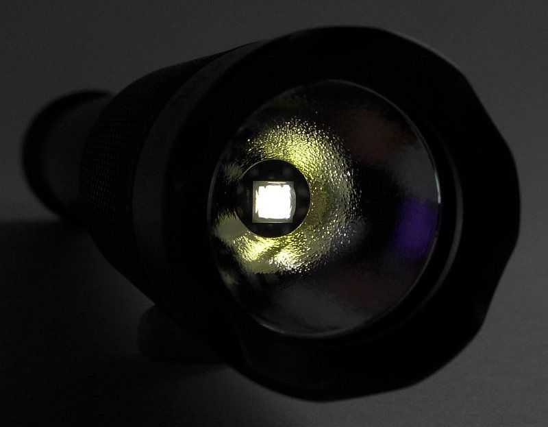

    The beam
    Starting indoors with the Rotary. Its XP-G2 LED gives a coolish tint and strong hotspot.
    The Executive’s XP-L LED has a more neutral tint and wider hotspot and spill (as you would expect of the larger emitter).
    The characteristics seen indoors become even more obvious outdoors. The Rotary, despite lower output has better throw, but a narrower beam.
    With its broader beam, neutral tint and higher output, the Executive is very capable and is a very pleasant Every Day Beam.

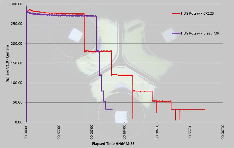

    For the runtime traces, the default ‘burst’ mode was disabled to maintain maximum output.
    At the time of the review the Rotary 18650 and 2xAA battery tubes were not available, so only CR123 and RCR123 traces were measured.
    Using RCR123 does provide a longer run at maximum output, but once the cell is depleted, the output drops quickly through the levels. On CR123 total runtime is much longer but with more time spent on lower levels.
    For the Executive, the relative output of CR123 and RCR123 are much like they are with the Rotary. The use of 2xAA gives approximately twice the runtime of RCR123, with considerable more runtime at maximum output, but shorter overall runtime compared to CR123.
    It is with 18650 that runtime is significantly boosted for maximum output and total runtime. The graph speaks for itself.

    Just wanted to add a comment that in the runtime graphs where a trace looks like it is dripping down, this is where the output logging has captured low battery warning flashes. Only a some flashes get captured when the coincide with a measurement.

    Do new HDS lights have a high polish bezel now?
    Also, great review.

    Nice review. I especially enjoyed the runtime charts. The runtime on the 18650 2600 mAh is impressive. I assume that it didn't get too hot as the emitter is not over driven.
    Yes, I've read the new ones come with a high polish bezel.

    Great review subwoofer! Is it just me or the emitters look off center in all models?

    No xoubt, epic review! Love the macro pics, especially the up-close of the knurling.
    As I disabled Burst mode, the head of the lights did warm up a bit, but not a lot. As I need to ensure safety during my testing, I always run cooling fans (unless stated otherwise) to keep temperatures down. If you hand hold a light, you know if it is getting too hot and can take action if needed, but the run time traces have the light in a clamp.
    Of course the HDS lights are safe to run constantly on maximum as they have temperature control, but I always prefer to keep things cool if I can.
    Quote Originally Posted by ganymede View Post
    In both samples, the emitters are off-centre. However, in my experience, emitter centring is not as crucial as many people seem to think. The beams are both well formed as seen in the beam shots. With highly focussed reflectors used in specialised throwers, the emitter centring is more important, but on most general purpose lights it does not matter.
    The emitter on my HDS Clicky Nichia 219B is off center as well, not a biggy but could be better.

    I like the new shiny bezel rings. I hope my next HDS comes with one.
    One last question. I like how you lined up the universal clip end with rotary head screw but does that interfere with sliding it in your pocket? In other words does the screw snag?

    And for the clip question, as the stop screw is smooth and burr free, it did not interfere with clipping it to a pocket when I tired. I tend to slightly lift pocket clips when clipping them into place without even thinking about it.
