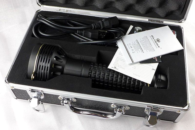

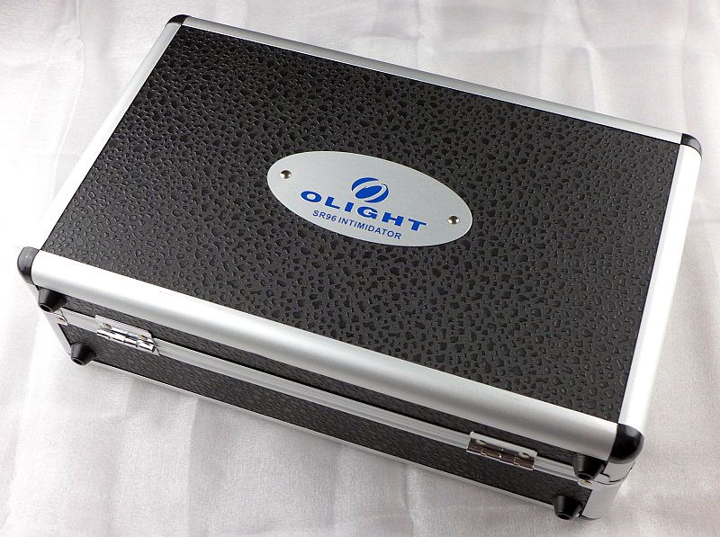

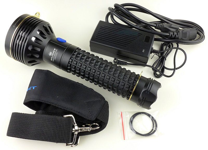

    The SR96 arrives in a presentation carry case.
    It comes assembled, but there is an insulator cutting off the battery so it won’t have turned itself on during transit.
    The full contents of the carry case include the SR96, carry strap, spare O-rings and a mains charger.

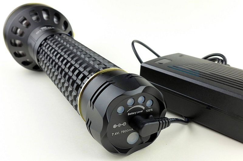

    The tail-cap (which does unscrew) has a button which you press to see the battery level. The level is indicated by four lights. In the centre is a rubber cover that protects the charging socket.
    The charger is shown connected here.

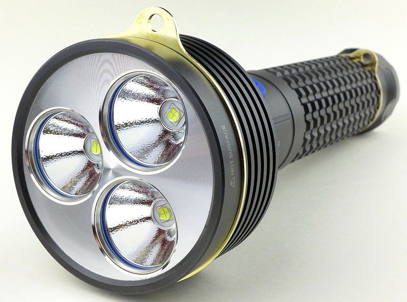

    The SR96 uses three distinct reflectors within the head. Each has a textured reflector round the MK-R LED.
    The MK-R is a large Quad Die LED.
    The three medium sized reflectors are not very deep and are textured (exactly as needed for a floody light).

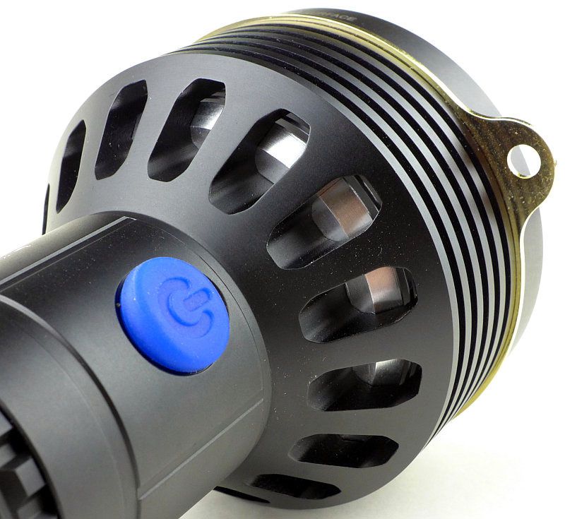

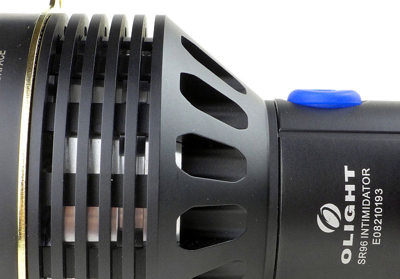

    There are deep fins in the main head with plenty of room for air to circulate and cool the head. If you look carefully inside the head (behind the black fins) is the bare aluminium pill. This receives all three reflectors and mounts for the LEDs, and is itself finned.
    Another view of the fins and large bare aluminium pill.

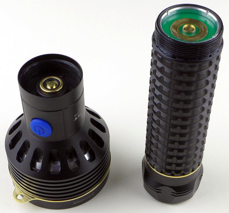

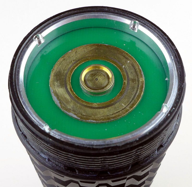

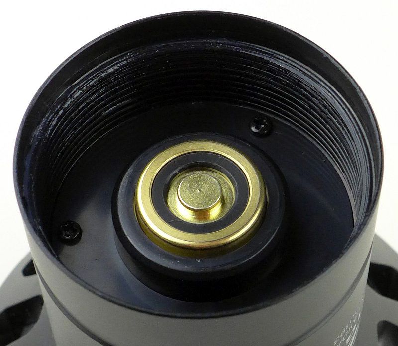

    The battery pack unscrews from the head. It was inside this join that the SR96 came with a plastic insulator that needs to be removed before using it.
    Looking at the contacts on the battery, there is the central positive contact, and a negative contact ring.
    And the corresponding contacts in the head.

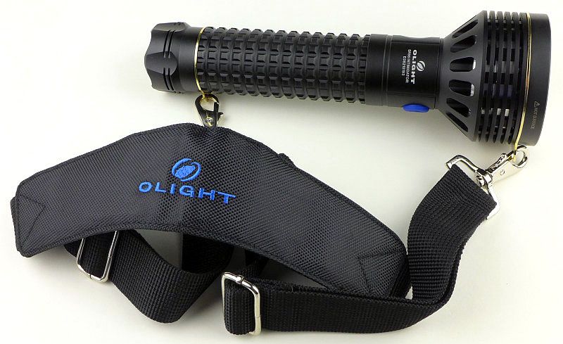

    There are two gold coloured rings with holes to attach the carry strap. They freely rotate about the SR96.
    The strap is nice and wide and very comfortable. You will welcome this if carrying the SR96 all night.

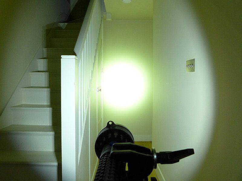

    Starting indoors, despite the mainly flood orientated beam, there is still a defined hotspot. The spill is nice and wide and great for area lighting.

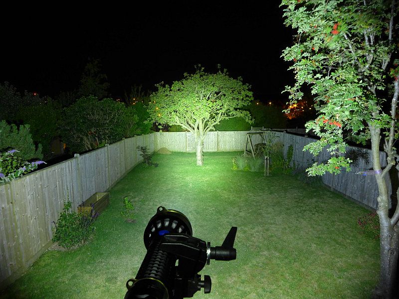

    Before seeing the SR96 outdoors, I need to show you the TK41 I regularly use a reference. This is a good strong 800lm beam with good throw.
    And now the SR96, and yes the exposure is exactly the same in both the TK41 and SR96 photo. An almost biblical ‘let there be light’.

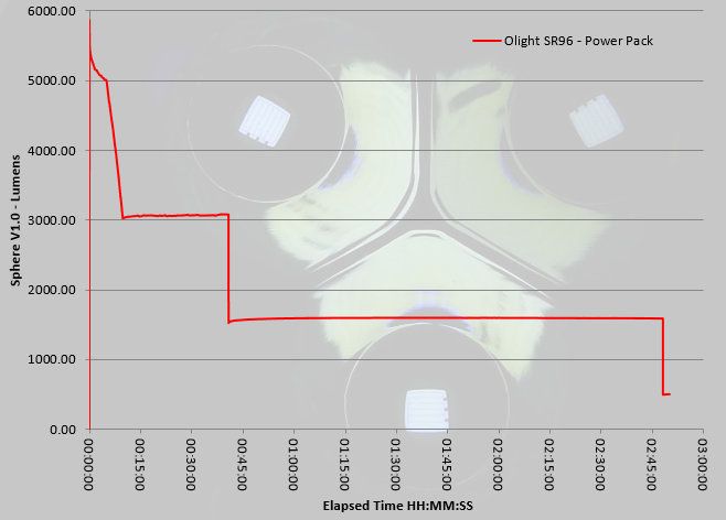

    The SR96 uses its own built in 7.4V 7800mAh battery pack.
    The SR96 has taken my integrating sphere to its limits and has shown heat effects on some measurements meaning I had to rethink how I worked with the SR96. Sphere V2 is being planned right now.
    Olight SR96 using integrated battery I.S. measured ANSI output Lumens PWM frequency or Strobe frequency (Hz)
    High 5299 0
    Medium 1644 0
    Low 555
    Strobe 2842 9.8
    Peak Beam intensity measured 41200lx @1m giving a beam range of 406m.
    Parasitic drain at the head of the light is 10.5uA meaning the battery pack would be depleted in 82.57years. This of course is negligible.
    However this may not be the only source of drain as the tailcap with battery level indicator and charging socket is also a circuit connected to the battery that could draw power. Due to the contact design, I was not able to confirm the parasitic drain.
    The SR96’s output is impressive. From turn on it is easily over 5000lm and after 5 minutes makes a controlled reduction in output down to 3000lm. This 3000lm output is then maintained up to 40 minutes from turn on. After this it drops to a ‘mere’ 1600lm for a further 2 hours (that ‘mere’ was written sarcastically)!!! This is no slouch even when running short on power.

    Taking a look at the beam over a longer range than my standard garden shots, here you can see the tree is well lit, as is the entire area in front of it. The hotspot does give it some reach, though it achieves this by pure output power.
    What becomes clearer however, is that this is not a long range search light. Aiming towards a more distant tree, there is very little useful illumination cast onto the tree. Instead the close range flood takes over and limits your vision to the well-lit mid-range distance. (this is a kind of lantern effect where the nearby brightness prevents you seeing further into the distance). This aspect of the beam, its wide bright spill, makes it work very well for use when walking, as it lights up the ground near your feet as well as further ahead of you.
    If you want a workhorse super-bright area light, then the SR96 is definitely for you. If you always want MORE light then the SR96 should satisfy that craving (for now at least).

    Great photos.
    My concern is how much light is thrown at your feet, even with the flashlight held high above the head.
    Wish: 1) Super low beacon; easy find flashlight. 2) Low voltage indicator, so not stranded without light. 3) Simple, one handed control ring mode changer (magnetic control ring). 4) Flood beam for walking/tasks. 5) Pocket carry. 6) LiFePO4.
    The effect looks worse in the photos than it is. Being such a floody light, you have a really wide spill which does give you a really wide field of view. This light is to fill a large area with light, and it does this fantastically well. Unavoidably having the nearer area so well lit does reduce apparent maximum range.
    If you were at all elevated and therefore not lighting up the ground near you, the beam of this light is like a stadium floodlight.
    You really notice the difference if you use a light with tighter beam and then turn on the SR96. No scanning required, everywhere in front of you is lit up.

    Quote Originally Posted by Swedpat View Post
    I am very satisfied with my Thrunite TN35. ~2400 lumens for about an hour. If I had bought SR96 and then became aware about the performance I had been dissatisfied: 5000lm for about 5 minutes and then ~3000lm for 40 minutes. That's really misleading information to claim this light as a 5299lm flashlight. More correct is to say it's a ~3000lm light with a 5000lm burst. And the size and weight is much bigger than Thrunite TN35.
    That's ANSI ratings for you...
    ...but also we have a couple of considerations.
    Firstly The TN35 is a great example of its class and size for regulation, but 2400lm compared to 5299lm is quite a difference.
    Secondly I think when you have a battery pack (rather than replaceable cells) you have to bear in mind the user will not be able to change the cells once flat, so what you need to avoid is very limited runtime and the need to change the battery. Although you might argue that the user should have control and can decide for themselves, the reality is that most people do need help to avoid leaving themselves in the dark. To your eyes, the solid 3000lm is still really good, and if needed you can always switch it off and on again to get back to the 5000lm+ output.
    On balance I think Olight have got it right for the majority of users of this light considering it uses a built in battery pack.
