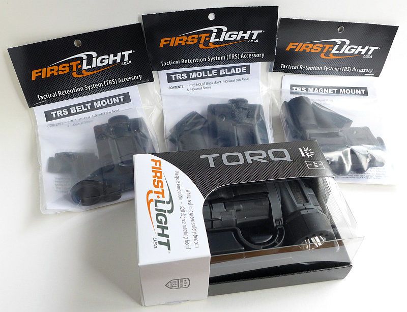

    The TORQ’s box with window that clearly shows off the TORQ (if you are looking from the other side).
    A simple set of contents, the TORQ, a set of Alkaline AAs to get you going and the instruction book.

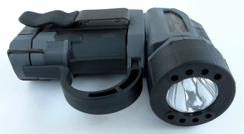

    Immediately it must be noted that the head on the TORQ is articulated and swings from side to side.
    Here the head is only rotated about 1/3 of the total movement possible in that direction. The head actually rotates 320 degrees in all.

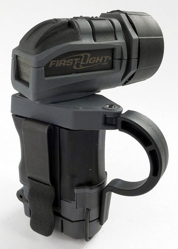

    Another distinctive First-Light feature is the finger loop to give the user a more secure grip and help locate the light in the hand.

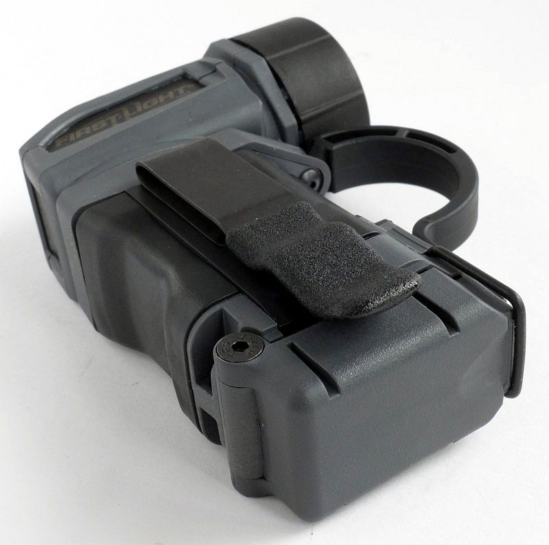

    Out of the box, the TORQ has a steel spring clip. The clip is removable and reversible (see later in the mounting system section).
    The TORQ will comfortably tailstand.

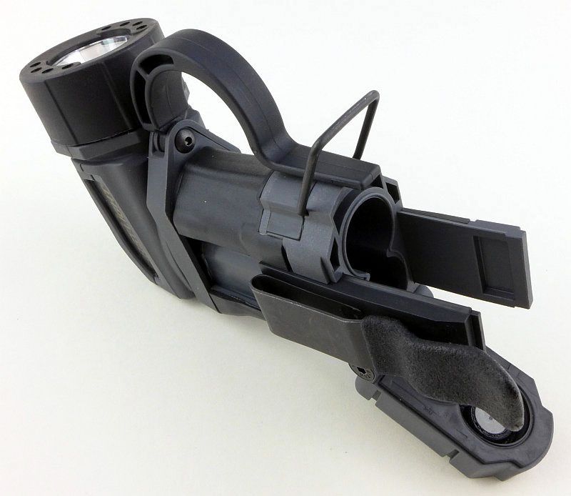

    As well as the head being articulated, so is the finger loop. This can be moved to either side to suit the user and their preferred grip.
    The main body of the TORQ is rectangular (with rounded corners) which is a function of the body holding 2xAA cells side by side.

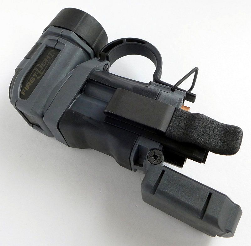

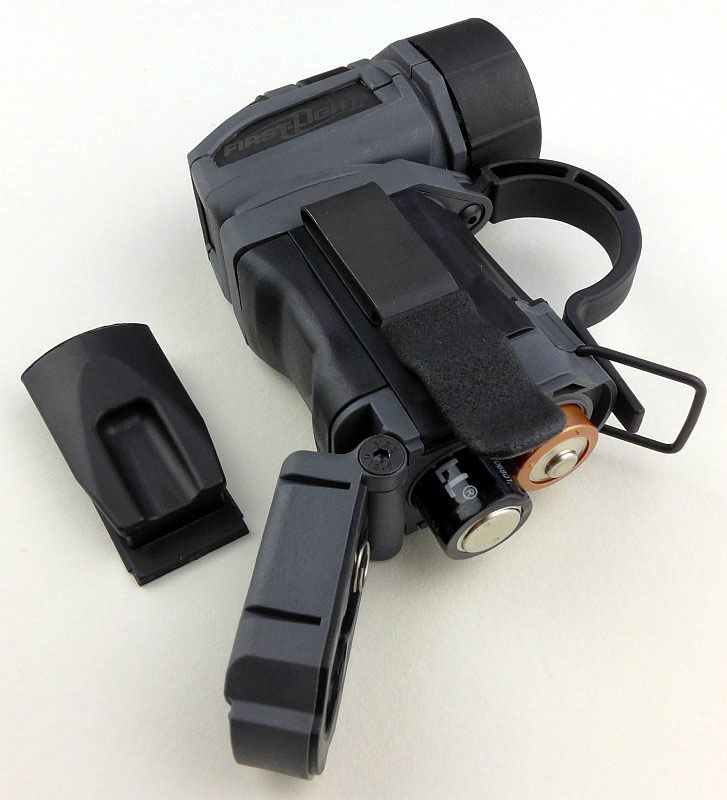

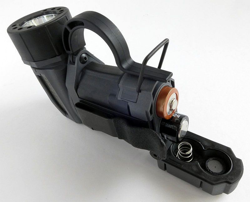

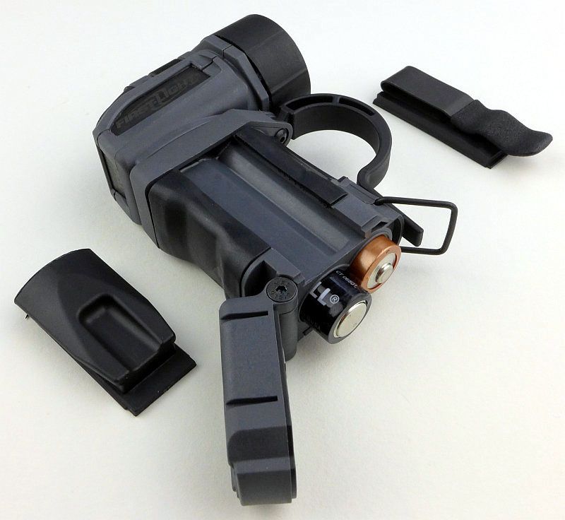

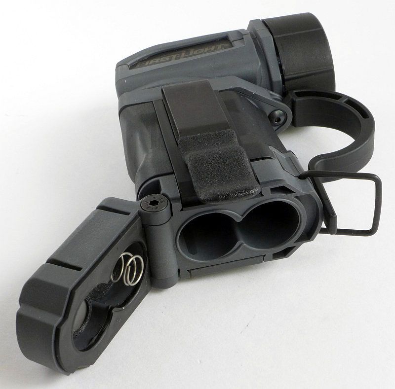

    After releasing the battery door retainer (the steel wire loop) the door swings open towards the rear. You can see the negative contact spring protruding.

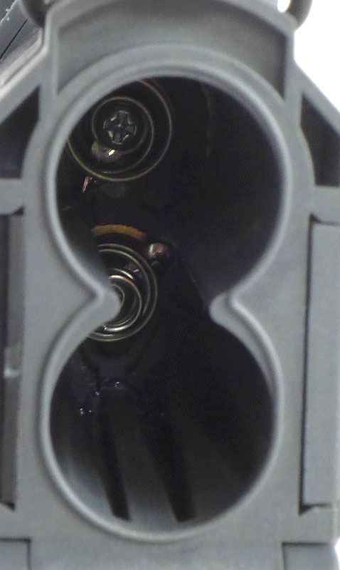

    Looking inside both the positive and negative terminals are springs.
    Loaded with two alkaline cells. The fit is snug with alkaline and even more so with NIMh (more on that later).

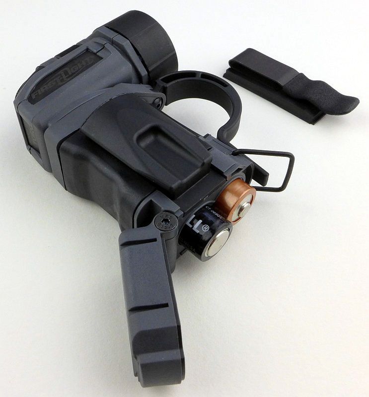

    While we have the battery door open, you can see how the clip slides out (in a dovetailed groove).
    The clip can be removed and left off, reversed, fitted to the other side (which has a blanking plate in the dovetail groove) and/or substituted for the mounting adapter.

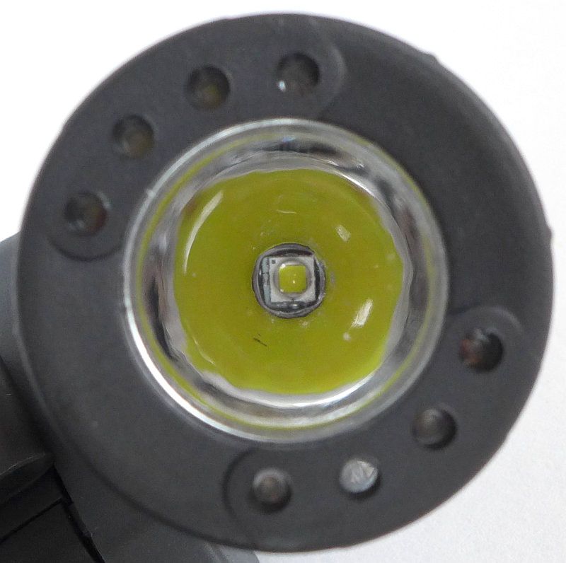

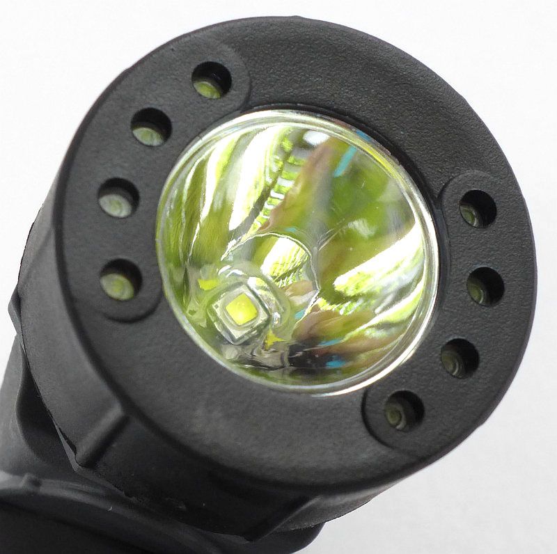

    Looking straight into the reflector, there is an XP-G2 LED in a smooth reflector.
    Either side of the main white LED are a set of four Red LEDS, and two Blue and two Green LEDs all from SunLED.
    The four Red LEDs lit.
    The TORQ next to the different types of cell used in testing (Eneloop, Evolta, and Alkaline)
    Cycling through the beams, Red, Green, Blue and White

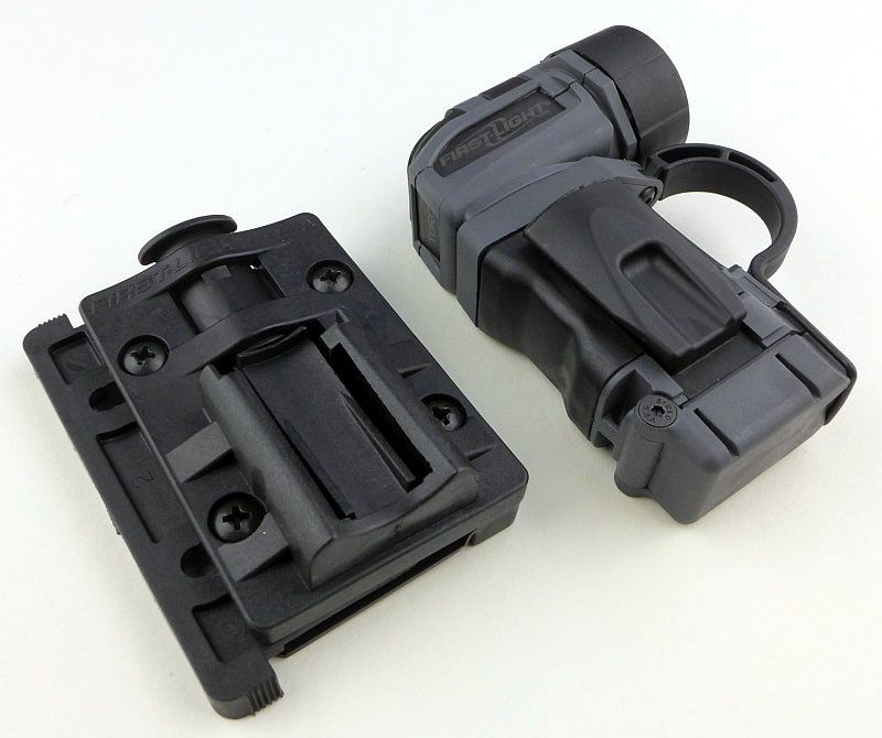

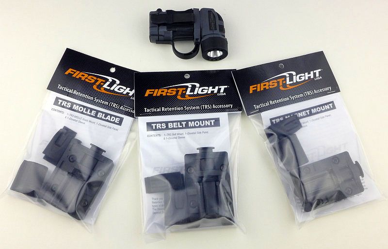

    Taking a more detailed look at the Mounts:
    A lot of the functionality of the First-Light products comes from the excellent mounting system. The TORQ has the choice of MOLLE Blade, Belt mount, and/or Magnetic mount

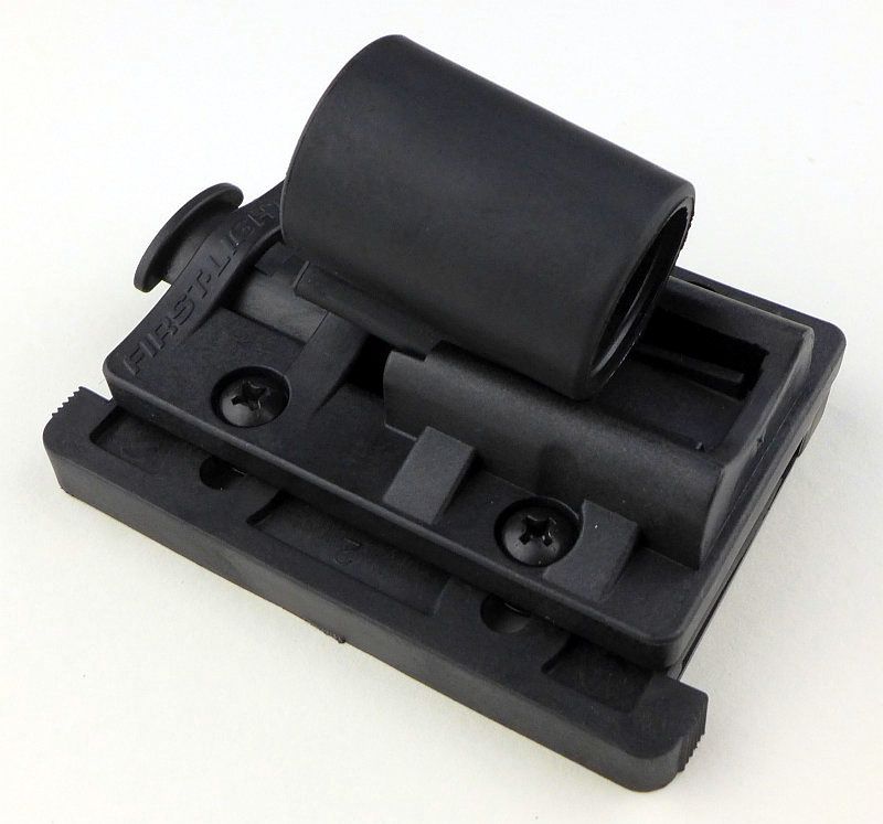

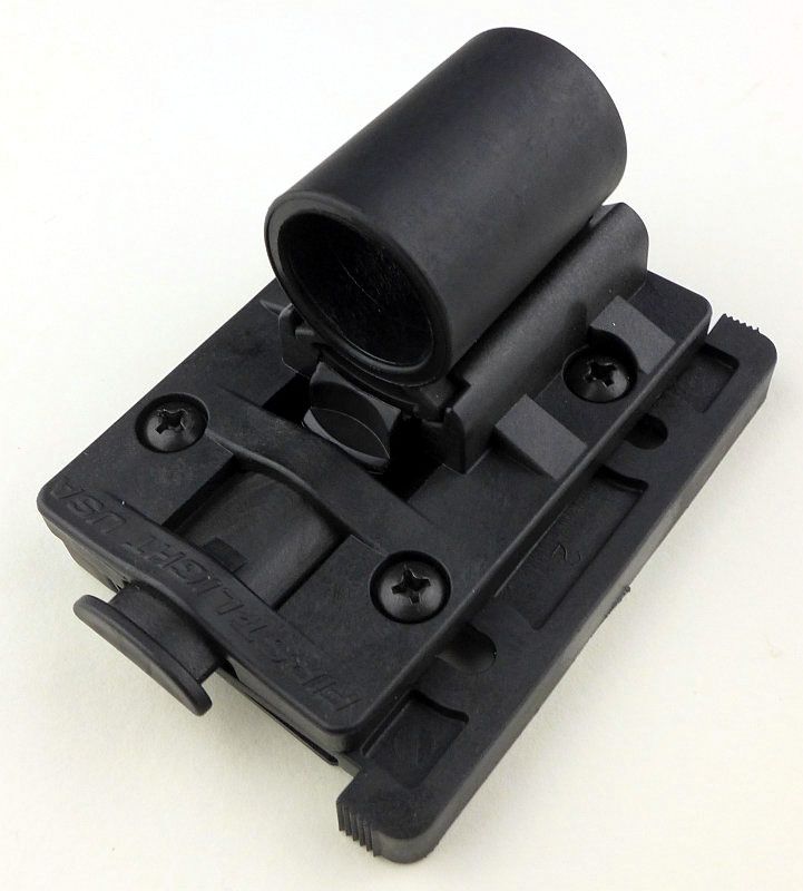

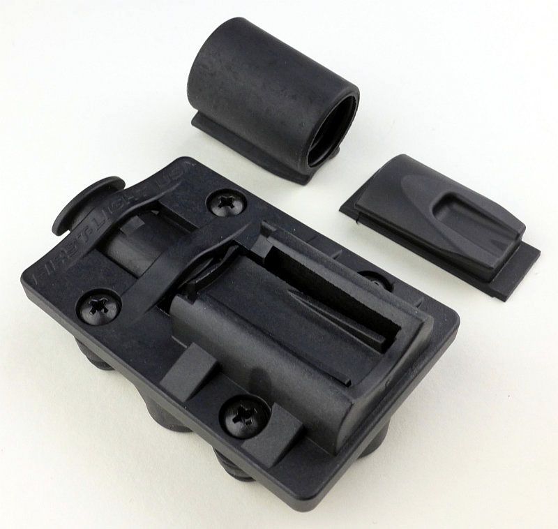

    Starting with the MOLLE Blade, the mount comes with the main mount and the adaptors for the TORQ and Tomahawk/T-Max.
    The next sequence shows how the dovetail adaptor fits into the mount.
    Starting to slide in.
    Fully clipped in.
    The release button sits proud above the mount.
    The retaining clip is pushed out of the way when the button is pressed (see next photo)
    It requires a firm press to release the light. It is not going to pop off unintentionally.

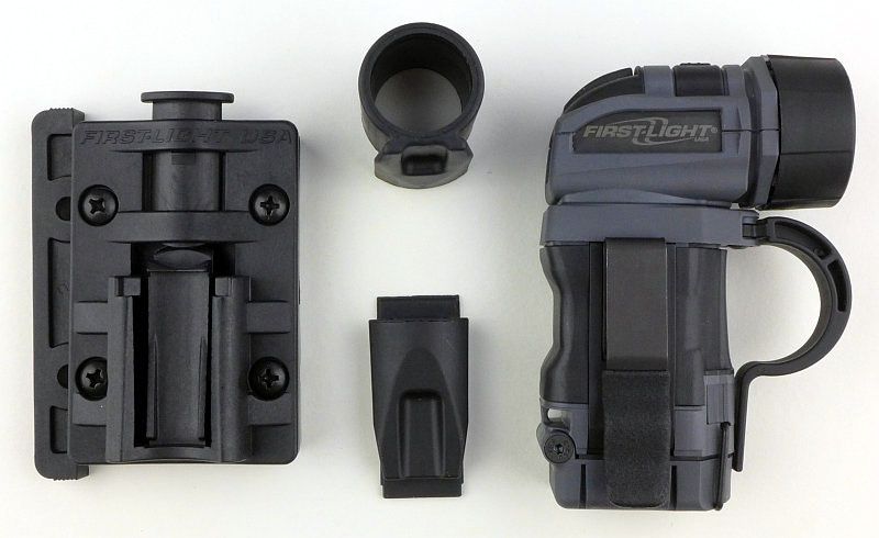

    In this sequence the steel clip is replaced by the mount’s dovetail adaptor. First open the battery door.
    Slide out the steel clip.
    And slide the adaptor in its place.
    Close the battery door to secure the adaptor.

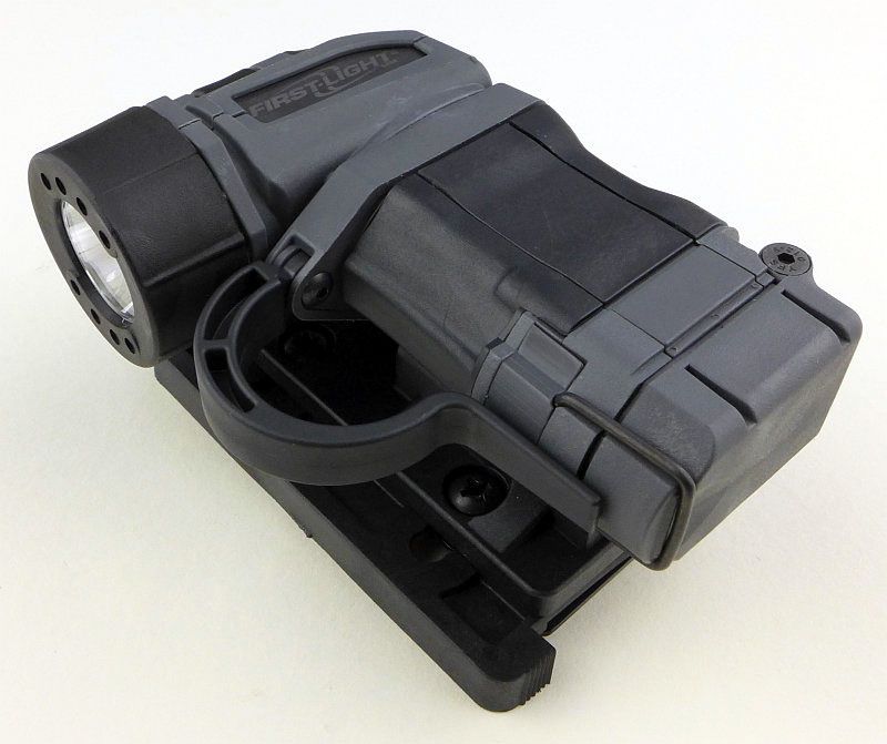

    The TORQ ready to get mounted.
    When on the mount, the TORQ’s profile is neat and low.

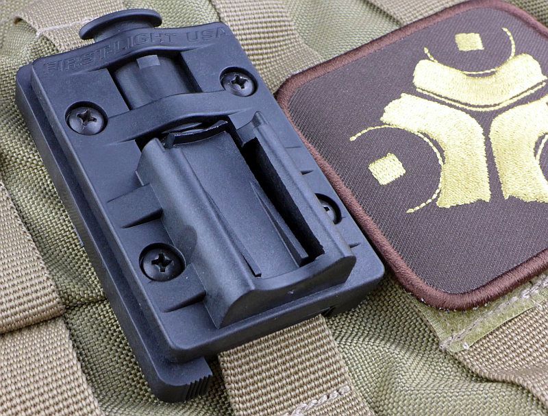

    This first mount is the MOLLE blade. Let’s have a look at how it fits onto webbing. On the underside of the mount is the blade itself. This consists of three plastic flaps, one central wider one with smaller flaps either side. The two gaps are for the webbing stitching to go into.
    The flaps slide into the webbing and then are secured by a bar on the side which locks into place.
    Quick, easy and secure mounting on PALS webbing.
    Once mounted the head can be rotated freely to give you light where you need it.

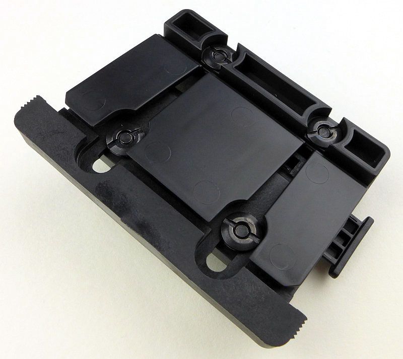

    Looking again at the ‘blade’ with the locking bar open.
    And here with the locking bar closed over the ‘blade’ fingers.

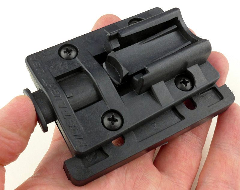

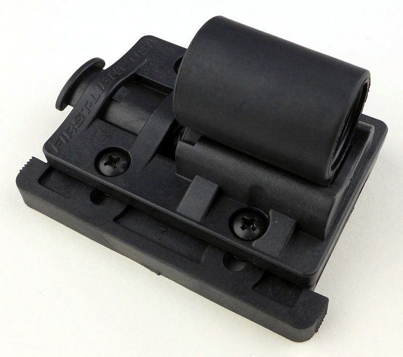

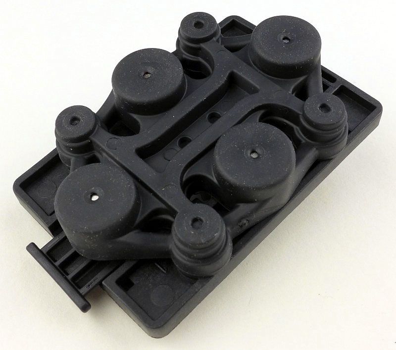

    Onto the Magnetic mount. Again supplied with both TORQ and Tomahawk/T-Max adaptors.
    This mount has four powerful magnets encased in a soft rubber cover. It means you can freely attach this to any surface without worrying about scratches. Also consider that even if you don’t care about the surface, the rubber also makes attaching and removing very quiet.

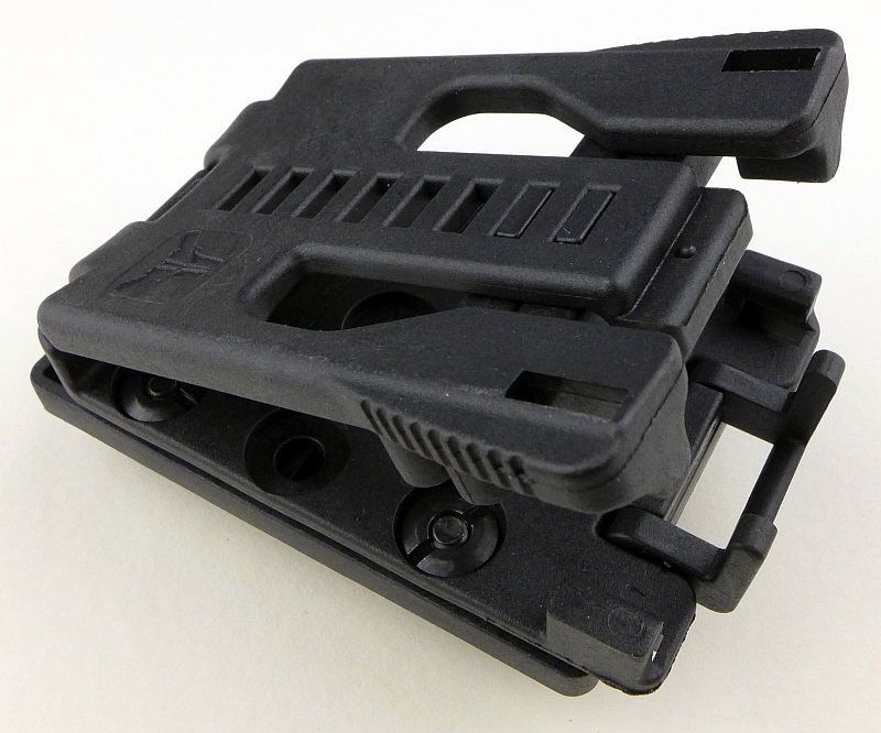

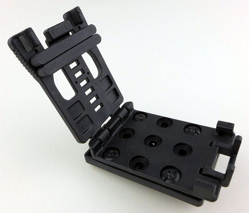

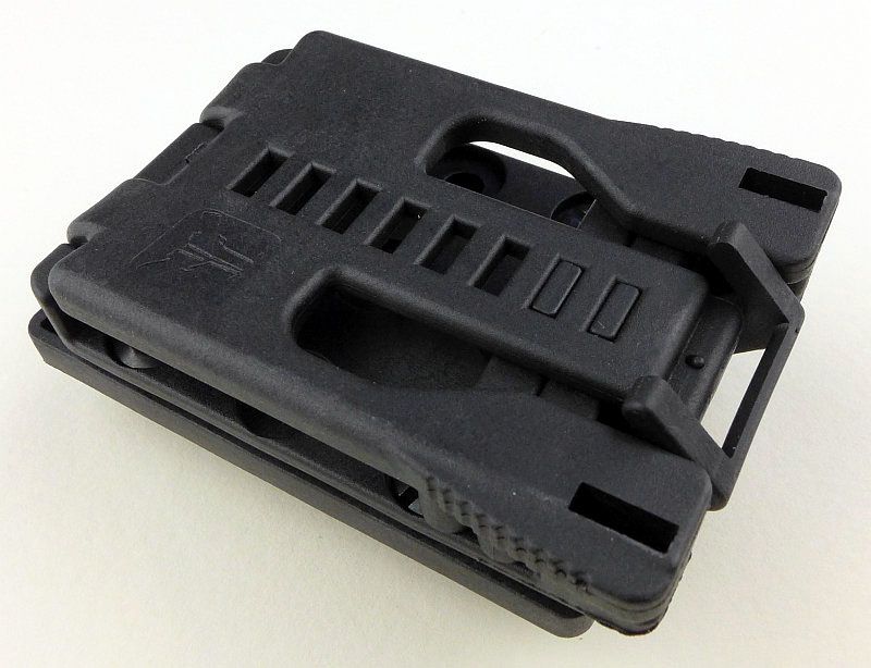

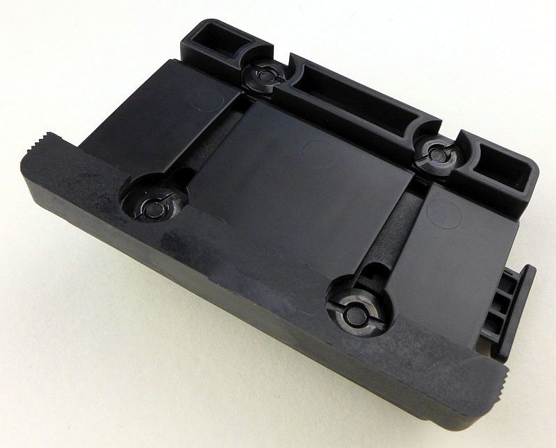

    The belt mount again with both adaptors.
    The back of the belt mount shows all the thought that goes into every detail in First-Light products. The main release levers are locked in place preventing accidental opening of the mount.
    To open the belt mount, first flip over the lock.
    Once the lock is fully pushed over, you will be able to squeeze the main release levers in to open the loop.
    Now released, the belt loop can be opened up.
    Fully open, you can access the belt width adjusters.

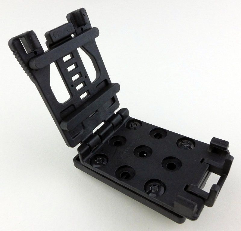

    The belt width adjusters can be removed entirely or positioned within the mount to make the fit to the belt snug.
    The belt width adjusters have been positioned to fit my belt.
    The fit is now nice and secure.
    The belt mount is now locked down and fitted to the belt width.
    The mounts provide excellent additional functionality and ease of use for owners.

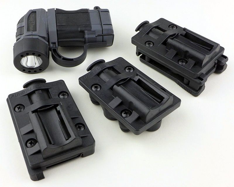

    MOLLE Blade, Magnetic mount and Belt mount
    With both sides of the TORQ being removable, it allows the user to choose the combination that suits their needs and handedness.
    I’ve chosen to keep the steel clip on the opposite side to the mount adaptor ‘just in case’.

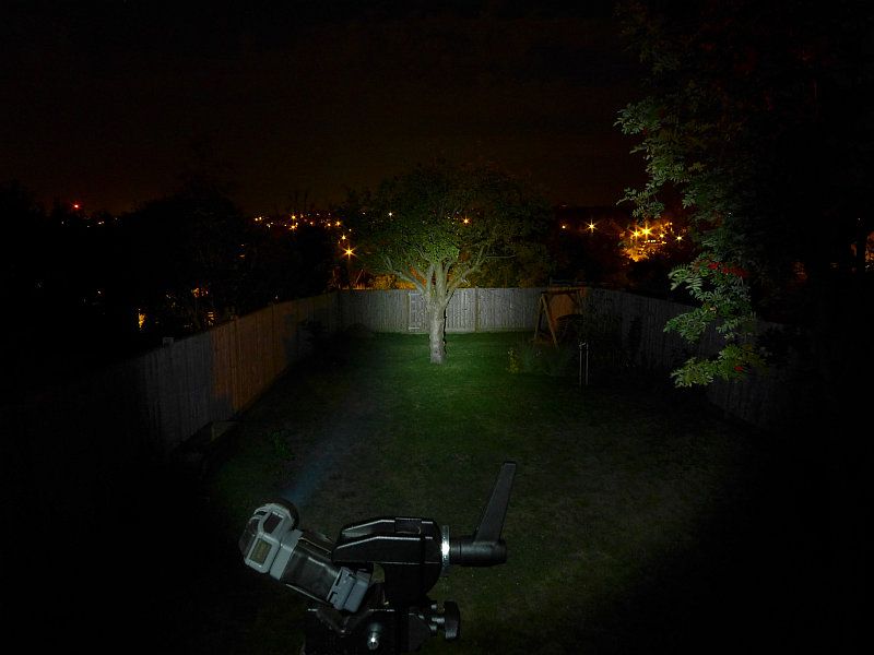

    The beam

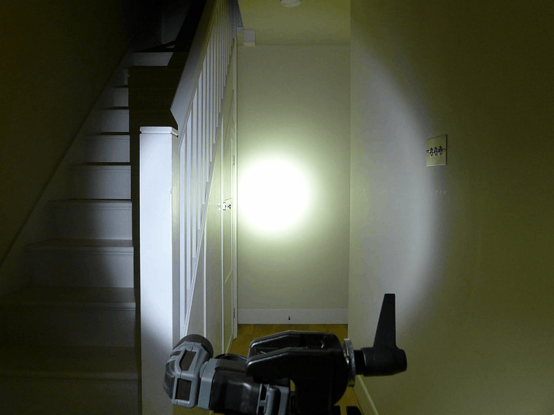

    Starting indoors, and here we have the white beam, then the colour beams in sequence. There is some additional light shone onto the TORQ itself to aid identification, so ignore the white light on the right for the blue beamshot. The colour beams are relatively dim compared to the white and are excellent for use in very dark areas.
    Though only 169lm, the main beam is perfectly useful thanks to the focussed hotspot has reasonable reach.
    Where the limitation of the 169lm output starts to become clear is when moving to larger ranges. The weak spill largely fades away and the view at longer distances becomes limited to the hotspot.

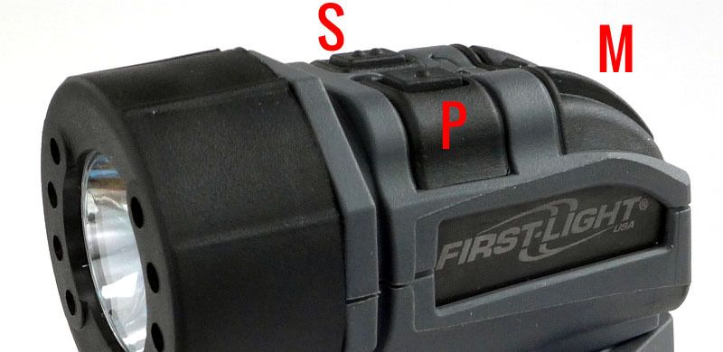

    In common with its other siblings, the TORQ uses First-Light’s three button interface.
    This has the Momentary button (M), Primary Control Button (P) and Secondary Control Button (S).
    This interface controls momentary output, constant white light output using the Primary button, and constant Red, Green and Blue using the Secondary button.

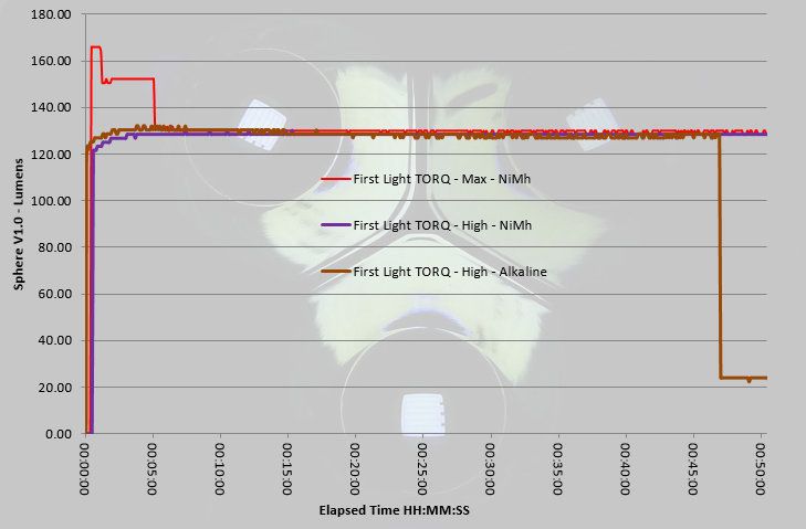

    In the runtime trace, there are three versions included. One where the Momentary button was clamped and held for the entire run using NiMh, and then for both NiMh and Alkaline the TORQ was turned onto High with the Primary control.
    The first most obvious trait is that when running on NiMh you get much more run at maximum output, with just under three hours at this level. If using Alkaline the output drops to Medium in less than one hour, but then continues on at Medium for an overall runtime of 10 hours.
    To see what happens when the momentary button is held down, here is just the first fifty minutes of the trace. You can see that after five minutes, the Momentary output has dropped to the same as the High output level and then remains at the output.
    This detail also shows where the Alkaline output drops to Medium.

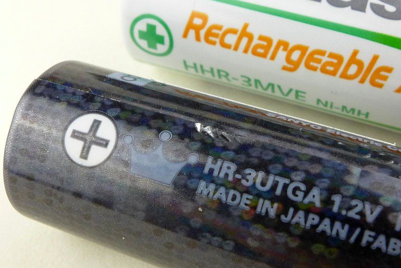

    Before moving onto the main aspects of the TORQ, I must just mention something about the use of NiMh cells. This is in regard to fitting them into the TORQ, not once fitted.
    NiMh tend to be slightly larger than Alakline cells, and the TORQ’s cell holder has been designed for a perfect fit for Alkalines. This means NiMh cells are tight.
    Here I slightly damaged the wrap on an Eneloop. It is possible to align the join in the wrap with the gap between the two cell tubes, and like this it is much better, but just beware and be careful if using NiMh not to damage the wrap.

    The included steel clip is strong, so most of the time I’ve needed to open it a bit by hand to get it started on the belt/pocket etc. It is not going to easily fall off.
