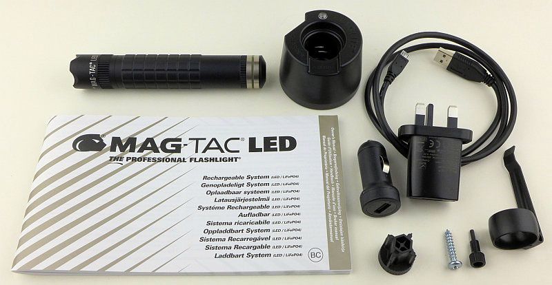

    The MAG-TAC/R’s cardboard packaging.
    The contents are neatly organised in a foam insert in the tray.
    Included are the MAG-TAC/R, charging base, USB mains charger and cable, USB car charger, pocket clip, screw for fixing the charging base to a surface, pocket clip tool and battery removal tool plus the instruction book.

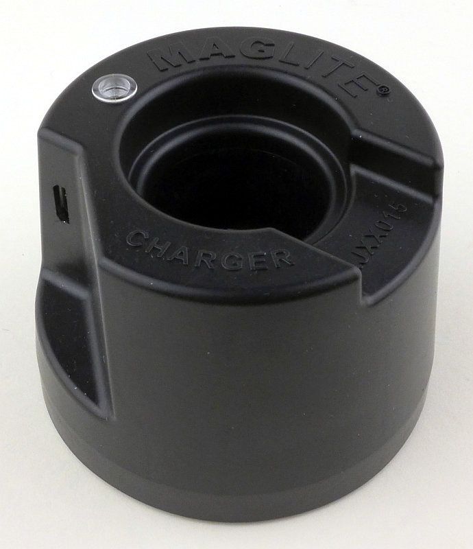

    The charging base is sturdy and has a micro USB input.

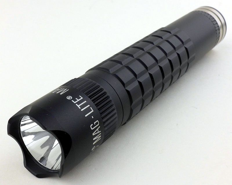

    The MAG-TAC/R without the pocket clip fitted.

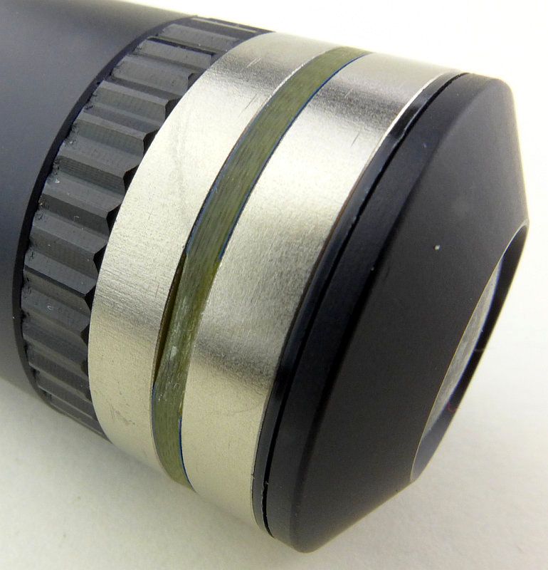

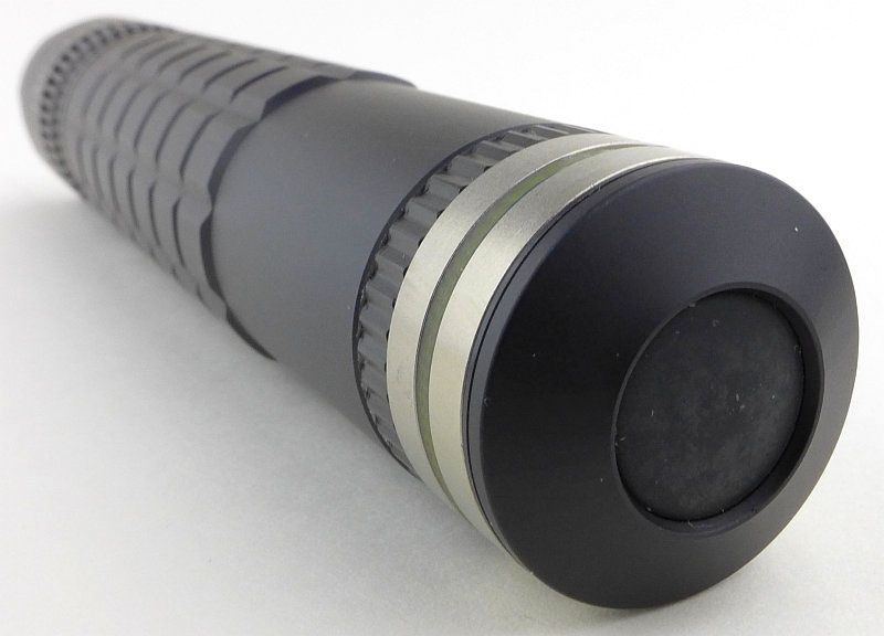

    On the tail-cap are the two charging contacts. Being circular there is no need to align them for charging (except when the pocket clip is fitted).
    I’m including this second photo of the charging contacts to show the minor flaw in the separator between the two contacts. The material appears to be PCB type board and both sides of the light there are these minor flaws. Function is not at all affected, but it is likely yours will be the same.

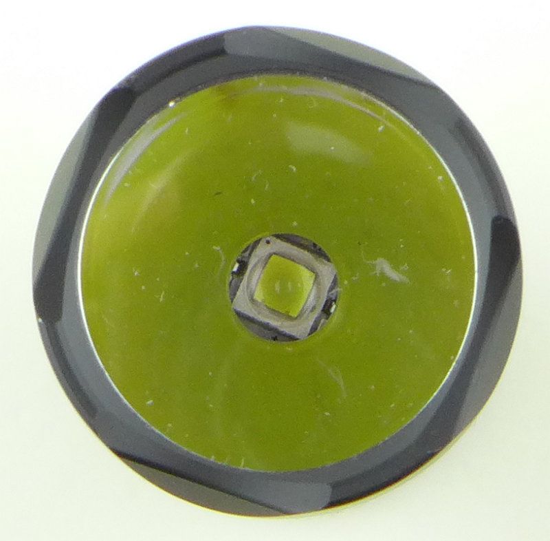

    For the diameter of the body, the reflector is relatively deep.
    A XM-L2 LED is used.
    Though not specified as a feature, the head of the MAG-TAC/R has adjustable focus (well, it unscrews and changes the beam). It was easy to take the head off quickly for a clearer look at the XM-L2 LED.

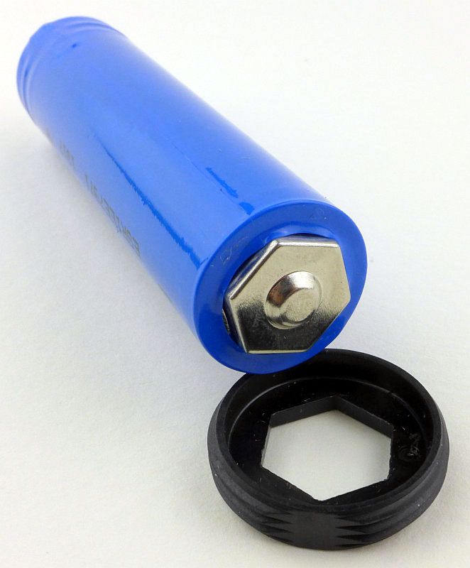

    The LiFePO4 cell is retained by a screw-in ring. To remove the ring and cell, there is a special plastic tool.

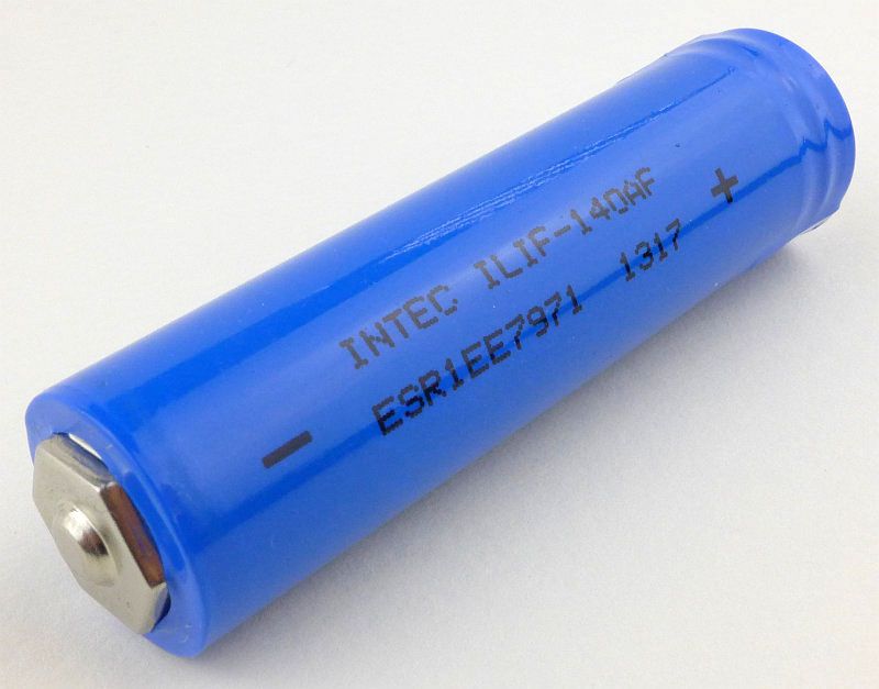

    The proprietary 18650 LiFePO4 cell has an unusual hexagonal raised contact at one end. Also notice it is actually the negative contact which goes towards the head.

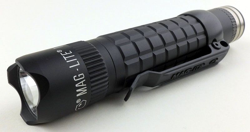

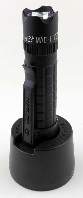

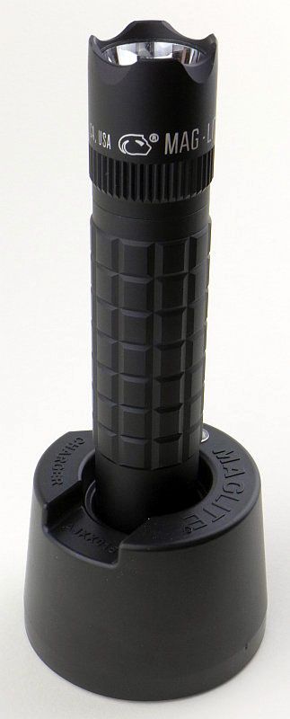

    When the pocket clip is not fitted you can place the light in the changing base at any rotational position. But notice there is a cut out (more on this later).

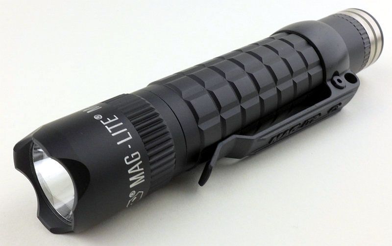

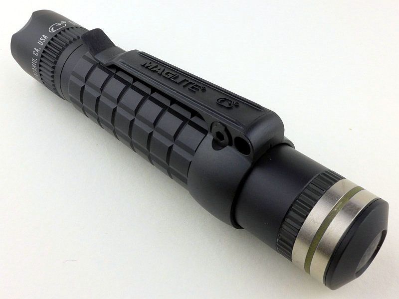

    To fit the clip, remove the tail-cap and slide the clip over the body. The tool provided allows you to tighten the cam-lock, securing the clip.
    The clip in place and tail-cap re-fitted.
    The clip is a generous size.

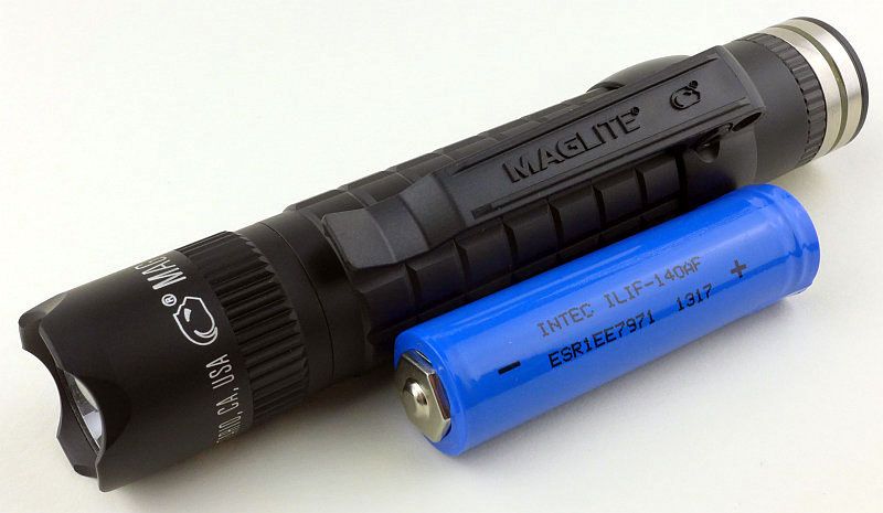

    For scale here is the MAG-TAC/R next to its 18650 cell.
    Now you can see how once the pocket clip is fitted, the clip must be lined up with the cut-out in the charger base to allow it to fit fully into place.
    The charger base can be screwed onto a suitable surface using the supplied screw fitted though the hole in the base.
    Here is the charger base with Micro USB cable fitted.

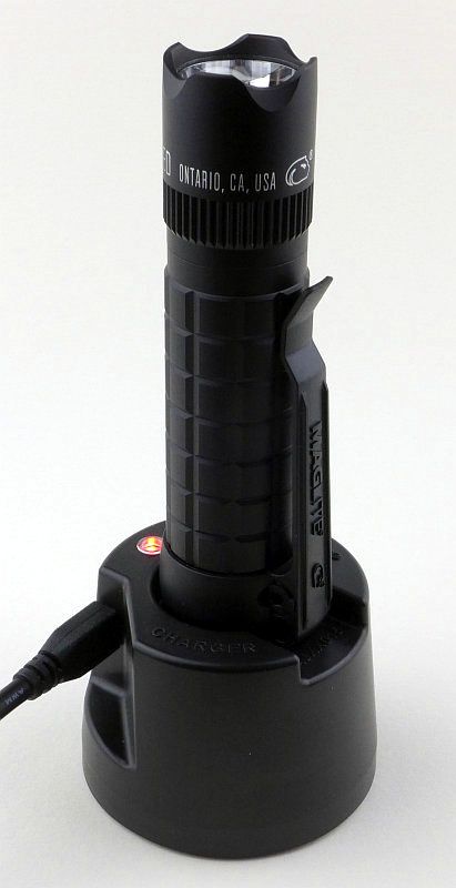

    And the MAG-TAC/R on charge.

    The MAG-TAC/R runs on a proprietary LiFePO4 18650 cell.

    Thank you for the review! Too bad about the proprietary battery though.
    About the charging contacts, is there a risk of a short circuit of some kind?

    Hot off the charger, there is a measurable voltage between the contacts (~3.5V), but if you short this with a resistor, it drops to 0V and does not go up again. My suspicion is that there is only a residual voltage in the charging circuit, and that once shorted the contacts show 0V as they are isolated from the cell with diodes.

    Thanks for the review. Would be even better if Mag used an ordinary 18650 battery, instead of a proprietary.
    Hove, UK
    2,468
    Default Re: Review: MAG-LITE MAG-TAC Rechargeable (Proprietary LiFePO4 18650)
    They might well have done this with consideration of the main target market as it forces the use of LiFePO4.
    I too would prefer a standard cell, but if it makes the product safer for most users, this is probably a good idea. Think about you friendly neighbourhood LEO thinking it was OK to fit an XXXXFire instead of a quality cell, and said cell having a melt down at a critical moment.

    What is up with that hexagonal contact? Merely trying to break compatibility with aftermarket batteries?
    Yeah, don't want to see that happen. Battery type may be safer, but as more_vampires says, why the hexagonal contact. Probably some sort of reverse polarity protection.
    Mag made the Magcharger pack funky to frustrate using aftermarket batteries. Probably the same thing.

    I take a very close look at everything I review. The flaw I showed in the tailcap PCB material is small and the photographs are very close up. Even if you can't forgive, one day you might forget

    So, no real way of modifying a LiFePO4 18650 to work in this light?
    What caught my eye was the clip, which I think would look good on my 6P.
    You probably could carefully transfer the circuit off the proprietary cell once it reaches the end of its life, but it would be very difficult to make your own and get the contacts right.
    It is a good clip.

    what is the clip material?
    SLPP 4 AA LUX; AT-100 10 LED; ARC AAA P; photon 1;Pewter 2C M@G with LED drop in; NEXTORCH Saint HID; SF E1B; RR 2AAA headlight; Vector 1 MIL CP spotlight: Q-Beam 2 Mil CP spotlight ;Sams HID; L2D RB 100; 6P
    Hove, UK
    2,468
    Quote Originally Posted by 2000xlt View Post
    I've asked my contact at Mag-Lite and will let you know the reply.
    Tactical Reviews by Subwoofer
    Hove, UK
    2,468
    and the official answer is:
    “Engineering Grade Plastic”
