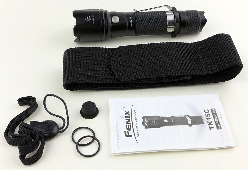

    Fenixís standard packaging.

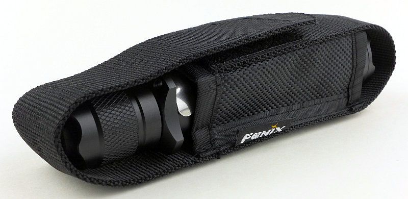

    Included with the TK15C are a holster, lanyard, spare switch boot, two O-rings and the instructions.

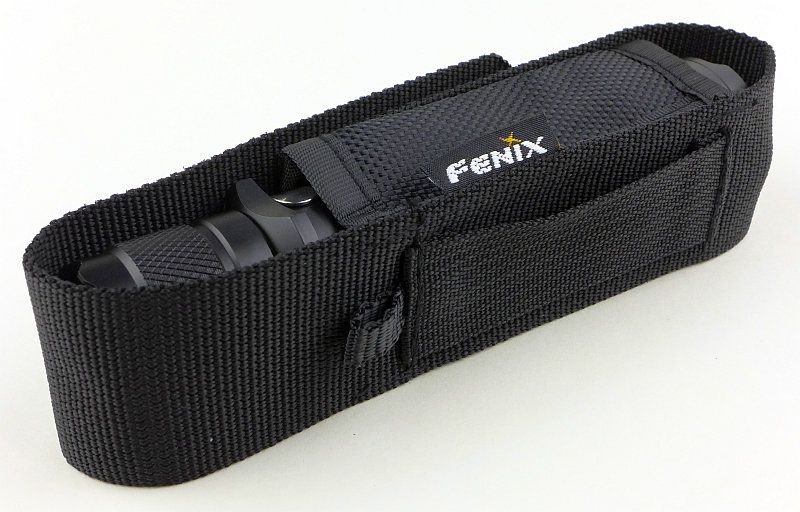

    The TK15C fits into the holster bezel down.
    On the holster are a fixed belt loop and small clip loop.

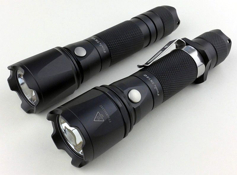

    To get an idea of its size, the TK15C is next to a Fenix 18650, the ARB-L2S.

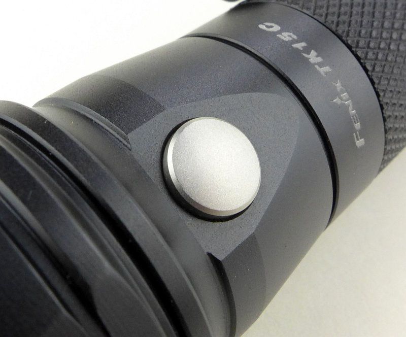

    The switch is semi-protected, but also easily accessible, as the button does protrude but has some raised points round it to help prevent accidental activation.

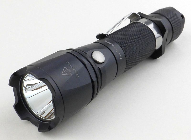

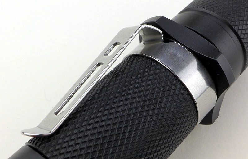

    The TK15C comes with a stainless steel clip fitted. The clip has been tumbled to remove any sharp edges.
    There is a side mounted mode button.

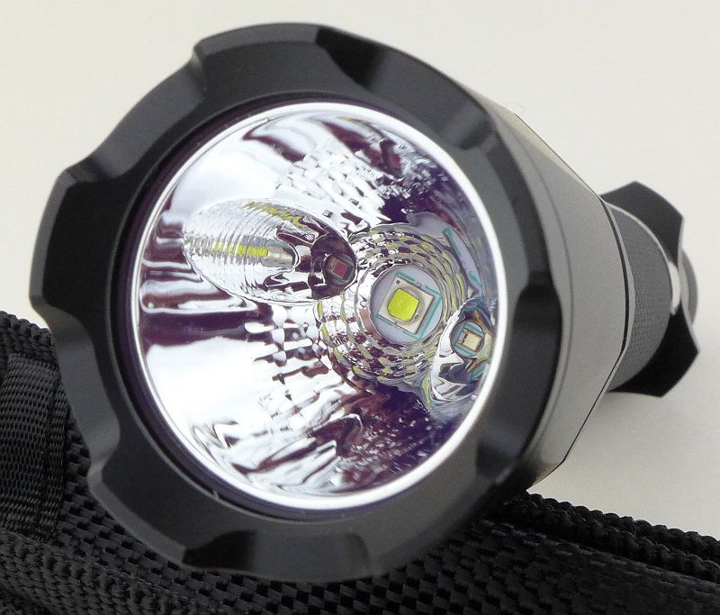

    A first view of the reflector assembly and three emitters.
    The main white LED is an XP-G2 and the two coloured LEDs are Philips LUXEON Z LEDs.

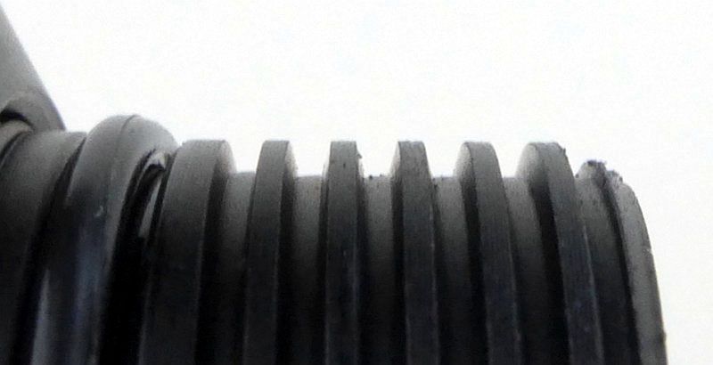

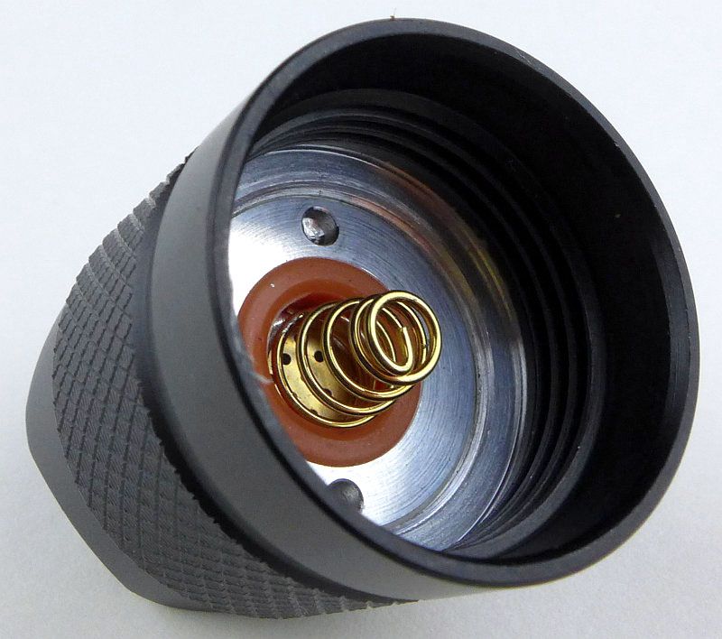

    The tail-cap has a spring for the negative terminal.
    The tail-cap threads are fully anodised cleanly cut square threads.

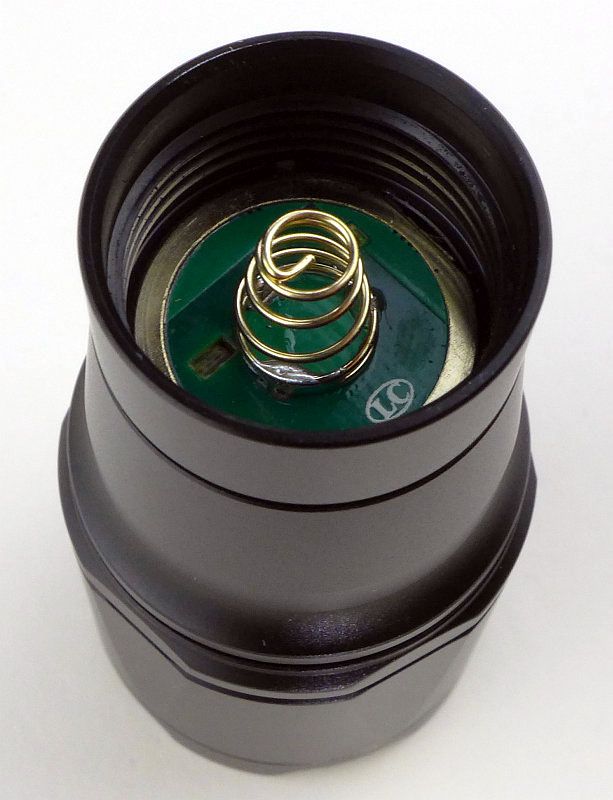

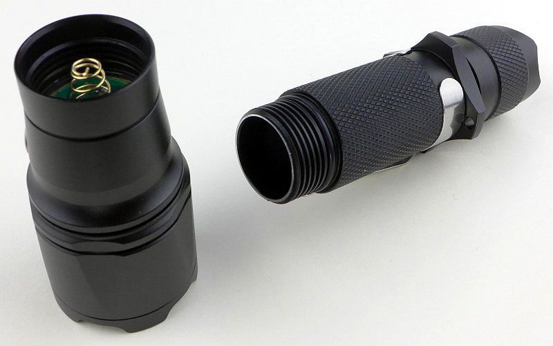

    It is possible to unscrew the head.

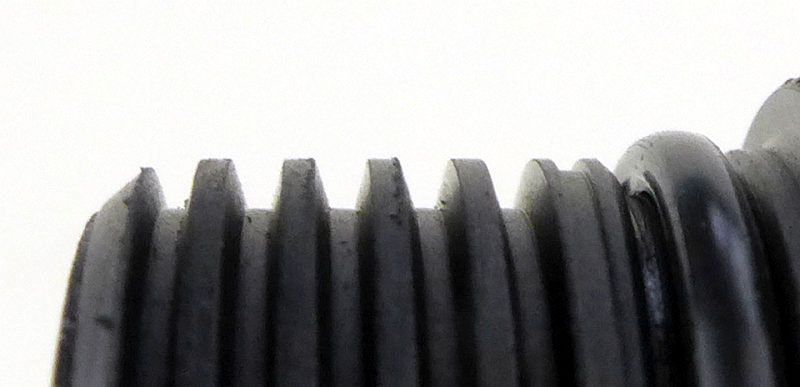

    This gives a clear view of the positive contact spring and circular battery tube contact.
    The head threads are different to the tail-cap threads, being more trapezoid. Again fully anodised and cleanly cut.
    Just for reference here is the TK15C with the TK15 S2.

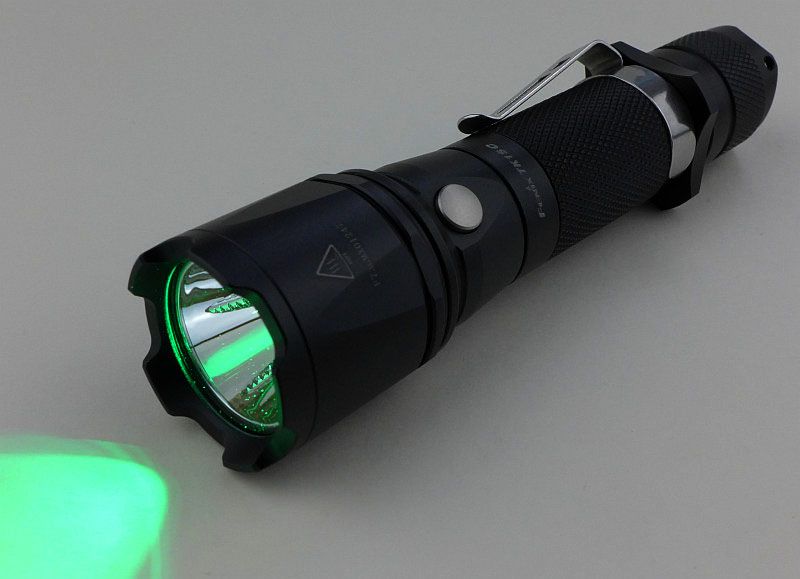

    The beam

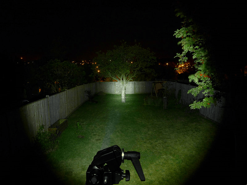

    To better show the appearance of the three beam colours, both the indoor and outdoor beam-shots are put into an animation with the same exposure and with the TK15C clamped into a fixed position.
    As expected you will see the bias of the coloured beams to opposite sides of the white beamís position. This is due to the LEDís position in the reflector.
    Outdoors the coloured beamís bias to each side is even more visible. As it the difference in brightness of the red and green LEDs.

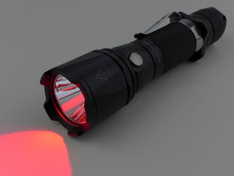

    The theory of the TK15C is to have access to strong coloured beams without using filters. Though this works well enough, with the coloured outputs being of respectable brightness, the issue with the coloured beams is that they are created by a compromised reflector. The resulting beams are full of artefacts and are not well focussed. At close ranges this is not really an issue, but starts to loose impact as the range extends.
    The coloured beams do work well enough in a hunting environment over shorter ranges for lighting up the eyes of your quarry, however due to the artefacts in the beam it is not good for target identification, nor well suited to the view through a scope. For these you are better served with a dedicated coloured beam.
    Instead the TK15C is more of a Swiss Army knife of a light as the white beam is perfectly good for gun mounting and illuminating the scope view, and you have the benefit of pretty reasonable coloured beams built in. This is where I see the TK15Cís strength. Donít assume you are getting coloured beams anywhere near as good as a single colour light, but instead you are getting very capable secondary coloured beams, far better than other multi-colour lights.
    I often move round my hunting land with a Red beam on as the quarry I hunt seem completely blind to Red. Once in position and ready for final shot preparations, I can switch to White, confirm the target and take the shot. No fiddling with filters or swapping lights.

    Default Re: Review: Fenix TK15C White/Red/Green (1x18650, 2x CR123)
    The beam pattern of the red & green seems to be brighter in the corona than in the center. Is that what it really does, or is it a photographic artifact?
    I have a red lens for my TK20 and its all central hotspot. Wish it was more uniformly floody.
    Hove, UK
    2,468
    Quote Originally Posted by lumen aeternum View Post
    There is a hotspot, and this is the brightest part of the beam, but the artefacts do create bright areas in the spill. In the outdoor beam shots, the artefacts hitting the grass make it look like they are brighter than the hotspot, but of course, the hotspot is going further.
