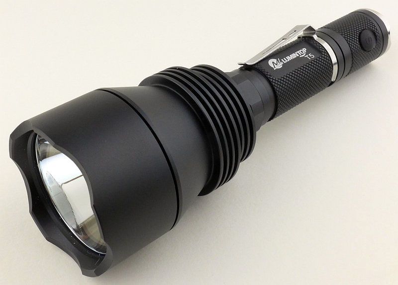

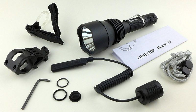

    The Hunter T5 is a special package of the T5 for hunting.

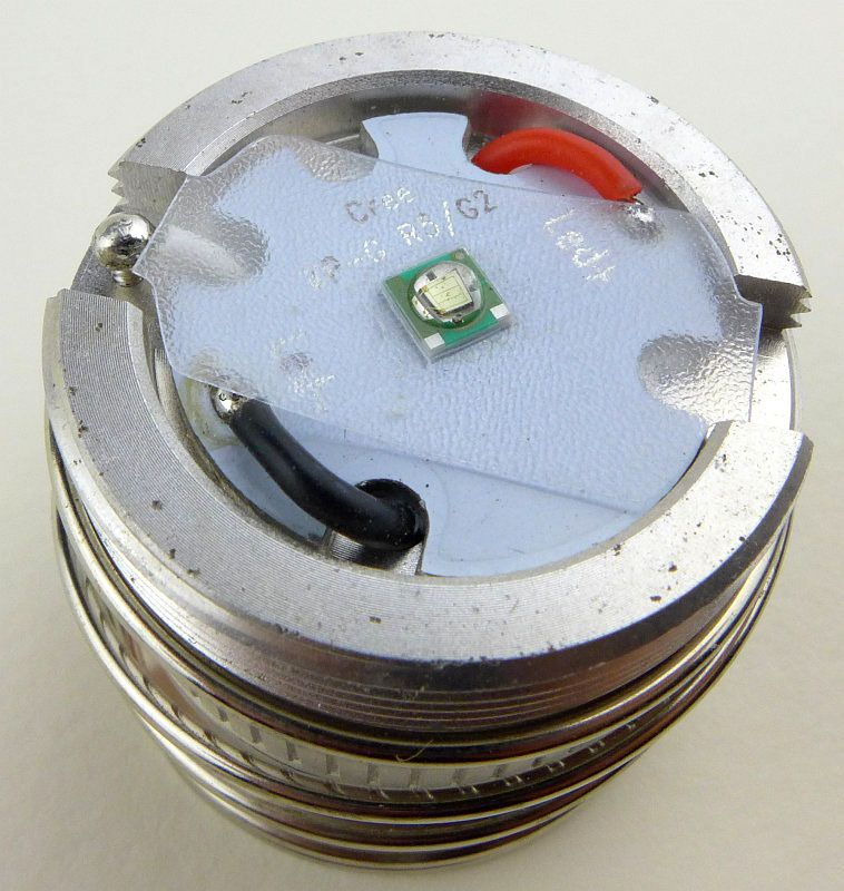

    The Hunter T5 comes with a white LED, but you can get the optional Red and Green LED modules (which I would recommend).
    The T5 has had its white emitter updated to an XP-G2 R5 LED.
    The Hunter edition kit includes everything you need to rail mount the T5. There is an offset Picatinny rail mount with Allen key, two-spare O-rings, a spare switch boot, remote pressure switch tail-cap, lanyard and ring holster.
    The T5 arrives with a pocket clip fitted.
    For gun mounting that clip has to come off. Also note the tail-cap has a removable bezel which doesn’t affect any seals if removed. For stealth this reflective bezel should be removed as it is polished stainless steel.

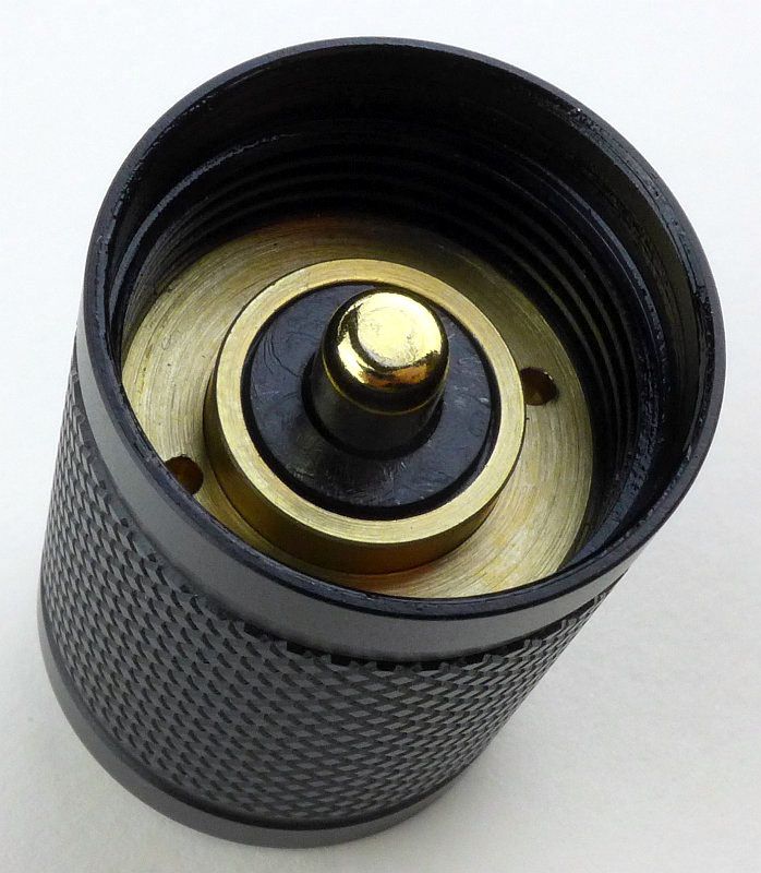

    The head has a spring contact for the positive terminal and a though there is a gold ring contact on the PCB, this is not used, instead the threads complete the circuit.

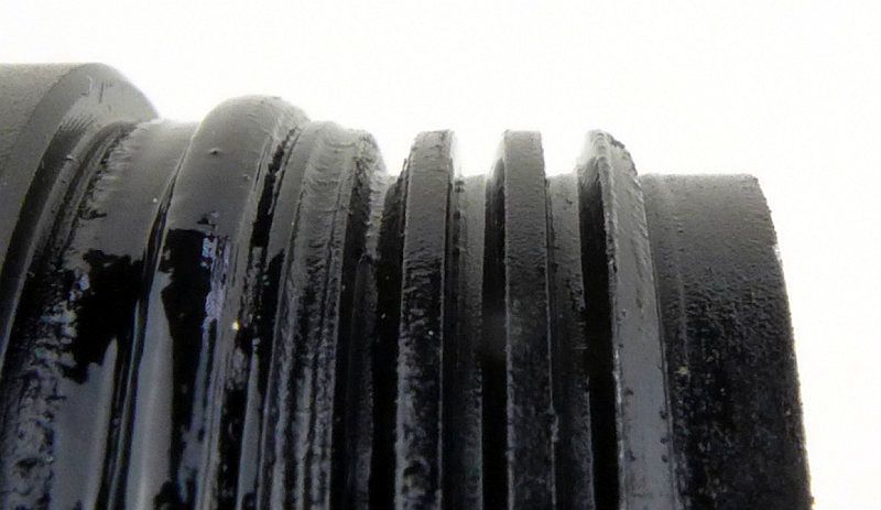

    The head end of the battery tube has bare aluminium square cut threads.

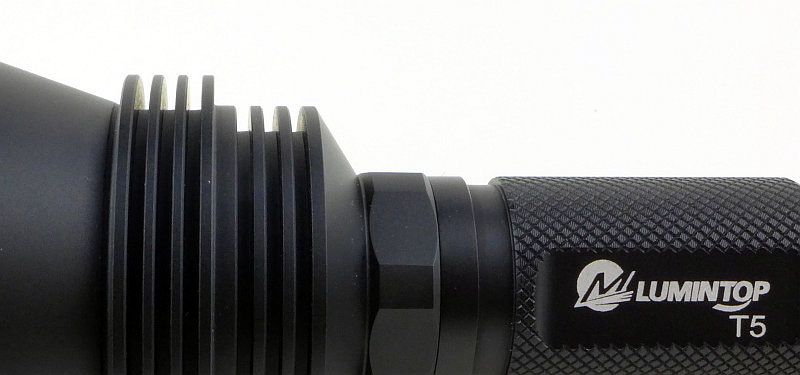

    At the base of the head are two banks of cooling fins.

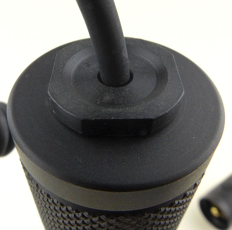

    Fitting the remote tail-cap switch involves a complete swap of the tail-cap.
    A detail of the remote switch cable entering the tail-cap.

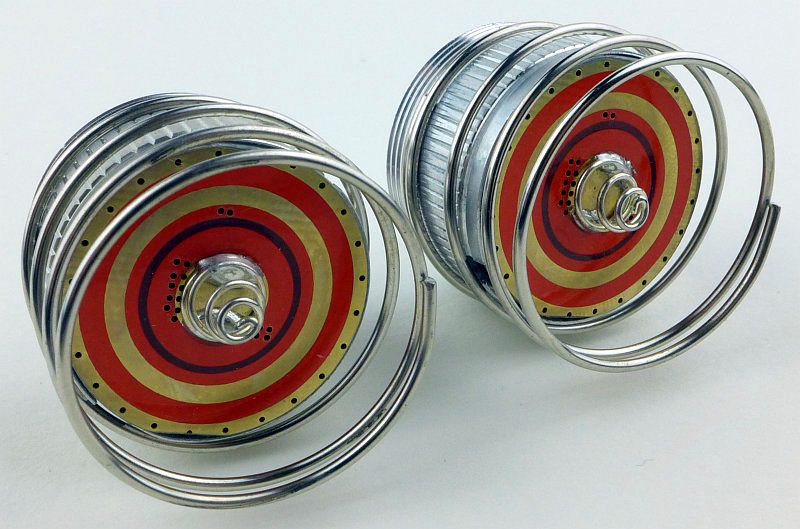

    Ready for a change, here are the Red and Green modules.
    A closer look at the Red module.
    And the Green module.
    Of course, both have identical contacts.

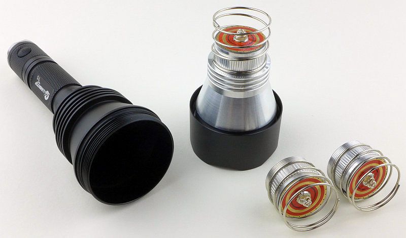

    Swapping modules is simple and does not require any tools. First unscrew the front of the T5’s head. The reflector will come out attached to the bezel.
    Then unscrew the modules from the base of the reflector. Try to avoid dirty/dusty environments as at this point dirt can get into the reflector.
    An opportunity for a close look at the white module that we have just removed.
    The Red LED is now fitted.

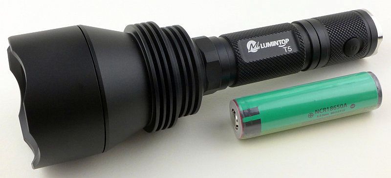

    For scale, the T5 is next to a protected 18650 cell.

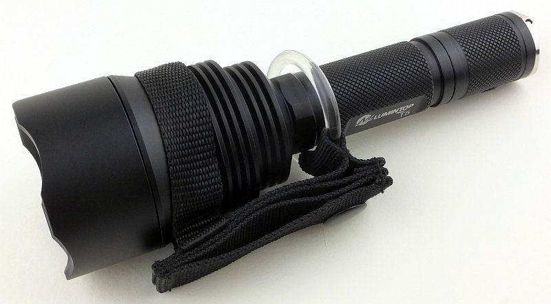

    The supplied holster has a double ring, and the T5 fits into it like this.

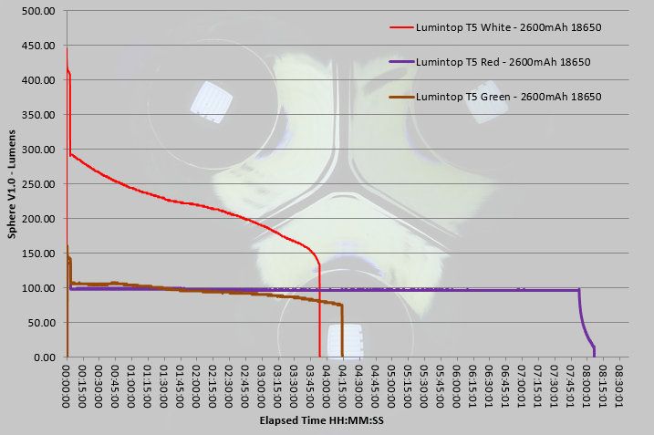

    All modules are shown here, all run with a 2600mAh 18650. The white is much brighter but does not appear to be regulated. The Green module also appears not to be regulated and does not have much more runtime than the white, showing a much lower efficiency. The Red module however does seem to run at a well regulated output and appears to be a similar efficiency to the White LED as the total runtime is doubled.
    To better see what happens at the start of the trace here is the first 5 minutes. All modules have an initially higher output which is stepped down at just over the three minute mark.
