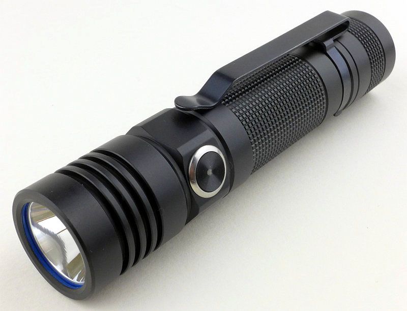

    I’ve previously reviewed the SxxR rechargeable batons from Olight. This is the simpler non-rechargeable S30.
    Taking a more detailed look:

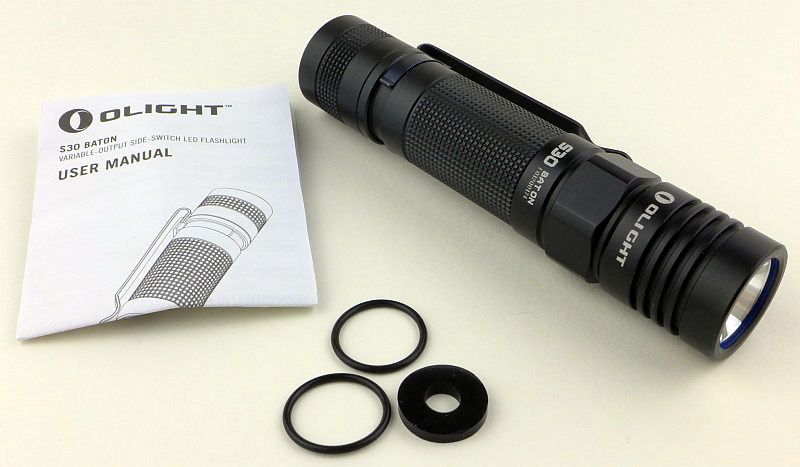

    Like the other batons, the S30 comes in a plastic box.
    Included are an instruction leaflet, spare O-rings and a spare insulator.
    Already fitted is a steel pocket clip.

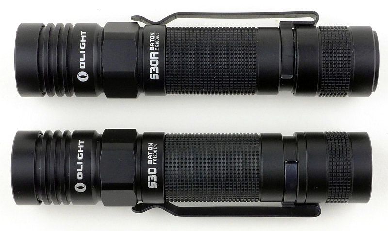

    The S30 next to the original S30R (not the S30R II).

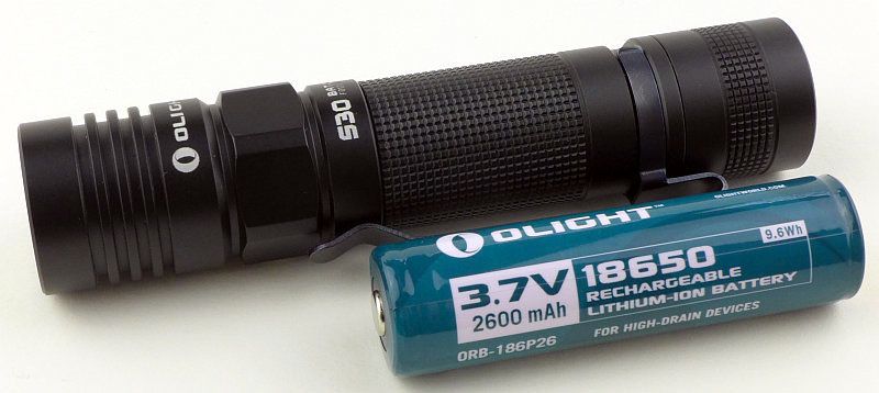

    For scale, the S30 is next to an 18650 cell.

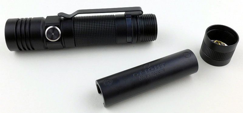

    Also supplied with the S30 is a 2x CR123 holder to reduce cell rattle when using these smaller cells.

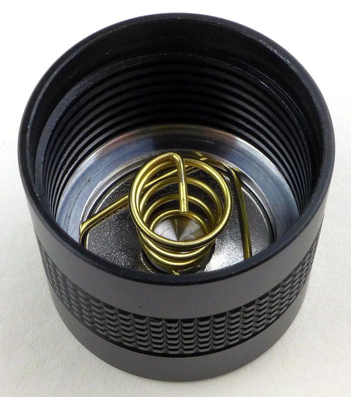

    Inside the tail-cap the negative terminal is a spring. The same spring is used to hold the tail-cap magnet in place.
    The threads are square cut.
    Inside the battery tube you can see the positive terminal spring.

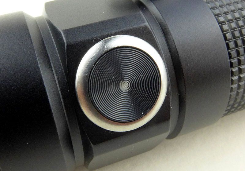

    The side switch has illumination to indicate low power or that the light is locked.
    A closer view of the switch.

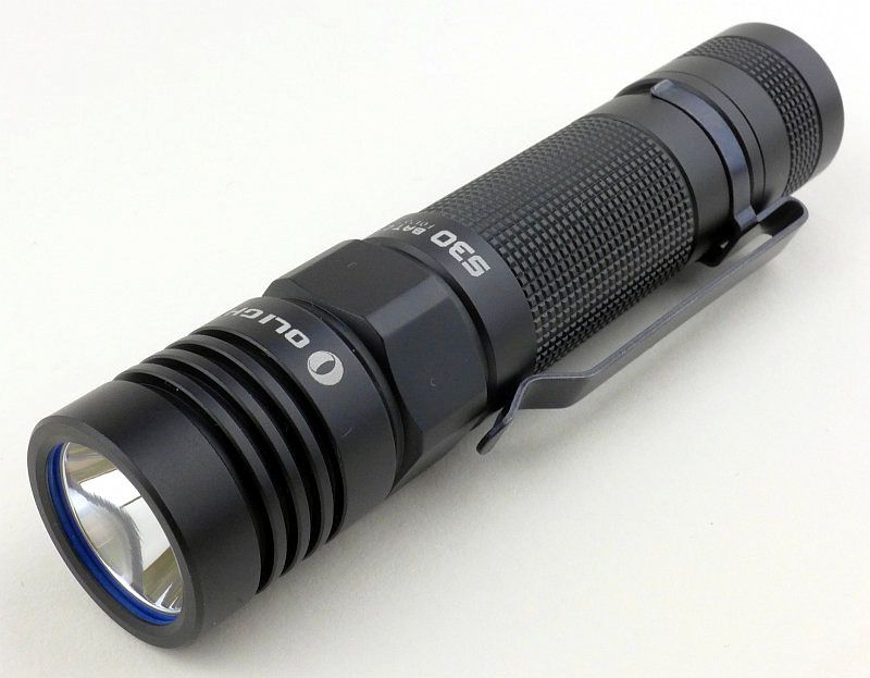

    The tail-cap is sleek and simple.

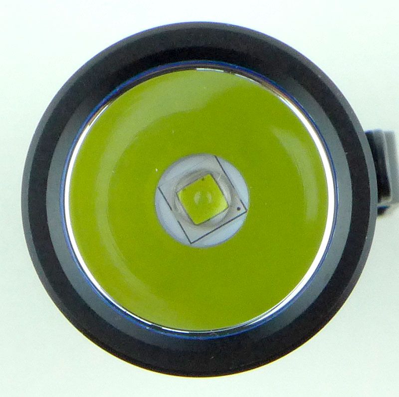

    The S30 uses a XM-L2 LED.

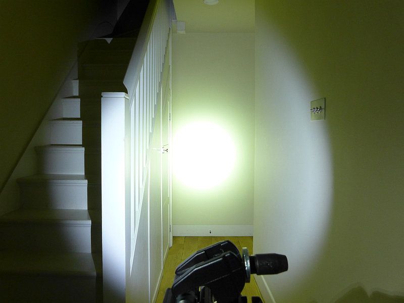

    The beam
    Starting indoors, the S30 has a broad hotspot and wide spill.
    In close to medium ranges the S30 gives you a nice spread of light.

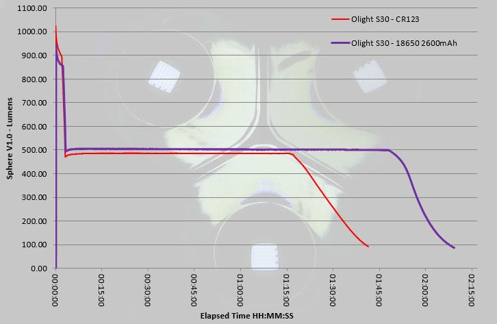

    Strobe 248 9.8
    Peak Beam intensity measured 9400lx @1m giving a beam range of 194m.
    There is parasitic drain at 15uA which would take 23.58 years to drain a 3100mAh cell.
    Performance on 18650 or CR123 is very similar except that runtime is longer on 18650. After an initial Turbo phase, the output drops to High for the majority of the run, and is well regulated at this output level.

    On your runtime charts, I see that turbo mode (938 lumens) steps down to high (510 lumens) in about 3 minutes. Is this a timed step-down? Perhaps a high current draw for only a few minutes does not constitute a “continuous discharge.” I don’t know.
    Hi KeepingItLight.
    Similar to my reply on this subject in the EC4 review thread, as the S30 also runs on 2xCR123, its lowest operating voltage is going to be pretty low (probably 2V), but I have not measured this. If the S30 was designed for 18650 only, it would be better able to work with li-ion's particular requirements.
    What I have done is check my runtime logs, as in the graph I use the ANSI cut-off as the end of the trace. Sometimes a light cuts out (with the protection kicking in) and sometimes it fades away. In the case of the S30 it fades away. So the S30's output drops significantly BEFORE the cell protection might operate (it did not in any of my runs), and at the same time the switch illumination is flashing to warn of low power.
    Do you count this as li-ion over-discharge protection?
    I haven't run the S30 at full output with an ammeter in the circuit. As I have to hand hold the connection I don't tend to do this measurement, so can't answer the question of current draw using 2xCR123 and Turbo.
    The turbo step down to high is a timed step down. I wouldn't consider a few minutes to be continuous. I would consider continuous to be 5-10 minutes and over, as at this point the device is reaching thermal equilibrium so the cells are not being cooled as well.
    “Protection,” yes. “Low-voltage cutoff,” no.
    I have a post entitled Over-discharge of Li-ion – A Request for Flashlight Reviewers that explains my concerns about low voltage. I am not arguing that a flashlight should or should not have a low-voltage cutoff. I am only asking that a flashlight review detail how a flashlight behaves when driven to over-discharge. That way, prospective buyers will know what they have to do to prevent an accidental over-discharge.
    One of the things I would like to see in every review of a Li-ion flashlight is a simple yes-or-no statement saying whether a flashlight has a low-voltage cutoff. We usually get a direct yes-or-no for things like tail-standing. Let’s put one in for low-voltage cutoff.
    The other thing I would like to see is a detailed explanation of what happens when a flashlight is driven to over-discharge.
    For some flashlights, the answer will be “nothing!” Those flashlights keep chugging along until their batteries are unable to power the emitter. If that is how a flashlight works, I would like to see an explicit statement of that in a review.
    Other times, a flashlight gives some sort of a signal. That could mean an LED flashes somewhere on a flashlight, or perhaps the main beam blinks. When voltage gets low on the Olight S30 Baton, a blue LED in the switch begins to flash. Your review explains that perfectly.
    Some flashlights, such as the Zebralight SC62w and the BLF A6 Special Edition, force step-downs to lower levels when battery voltage gets low.
    All of these things are part of how a flashlight responds to a low-voltage condition. All of them should be explained together, in a systematic way. They should appear in the same place, and in the same form, in every review of a Li-ion flashlight. At least, I think they should.
    I haven’t run the S30 at full output with an ammeter in the circuit. As I have to hand hold the connection I don't tend to do this measurement, so can't answer the question of current draw using 2xCR123 and Turbo.
    The turbo step down to high is a timed step down. I wouldn’t consider a few minutes to be continuous. I would consider continuous to be 5-10 minutes and over, as at this point the device is reaching thermal equilibrium so the cells are not being cooled as well.
    Thanks for this explanation. I have only recently become aware that most manufacturers of CR123A batteries rate them for maximum continuous discharges of 1.5A. My guess is that most 1000-lumen flashlights running on 2xCR123A pull significantly more than that.
    If we can classify 3-minutes of turbo as a “pulse” discharge, then perhaps we can say that the S30 keeps current draw within the tolerances published by most manufacturers of CR123A batteries. A typical CR123A is rated for a maximum pulse discharge of 3.5A. According to the Sanyo datasheet I found, 15 seconds at 3.5A causes the battery to sag to 1.0 volts! I am not sure what 3 minutes will do.
    My guess—and it is only a guess—is that 1000 lumens will pull a bit less than 3 amps in most 2xCR123A flashlights that have an XM-L2 emitter. For all I know, however, it could be less. I have never measured. Whatever it is, I believe it to be higher than 1.5A.
    When I posed these same questions to Selfbuilt, he expressed concern over the behavior of CR123A batteries he has seen in some of his runtime tests. In his runtime tests of the Nitecore MH20, he found that current draw was enough to activate the PTC protection in his CR123A batteries.
    Yes, I find it a source of concern to see PTC features kick-in on CR123A cells. I have certainly see a lot of this over the years in testing (especially common on 4xCR123A lights). Examining the cells, you can sometimes see clear evidence of damage in the wrappers around the PTC. Invariably, the worse-affected cell is the one closest to the head (where most of the heat is concentrated).
    It's fundamentally a problem of how heavily-driven lights are now on max, in general (i.e., not specific to Nitecore - or Olight, or Thunite, etc, etc.). Multi-cell CR123A setups often don't seem suitable for sustained runtimes at max levels - even in lights with thermal regulation (which is designed to protect the circuit, not the battery). But of course, that's based again on made-in-the-USA CR123A calibration levels for PTCs. With made-in-China cells, you would probably almost never see that runtime pattern.
    [Emphasis added.]
    My exchange with Selfbuilt begins with my post here.
    When a reviewer reports that PTC is kicking in and that battery wrappers are being damaged, I get interested to know what the current levels are. I am suspicious that they are higher than the batteries are spec’ed for. That’s why I think it would be useful to publish current measurements for these CR123A batteries in a review. If a flashlight is designed to pull more current from a battery than the battery is rated to supply, I would like to see that explained in a review.
    As you can tell, I am still struggling to learn how to best use CR123A batteries. Thank you for taking the time to give such a detailed response.
