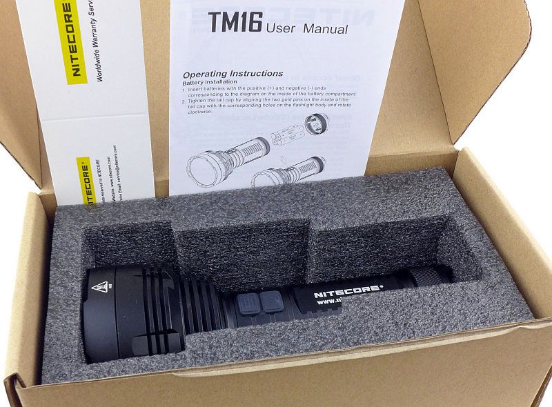

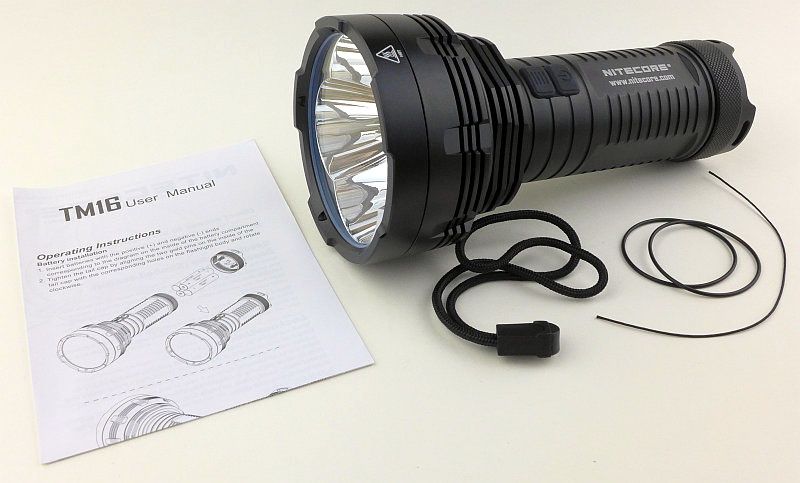

    Standard NITECORE TM series packaging is used.
    A closed-cell foam liner is used.
    The TM16 comes with spare O-rings, instructions, a lanyard and a thin cord (which I believe is used to assist in fitting the lanyard through a hole in the tail-cap).

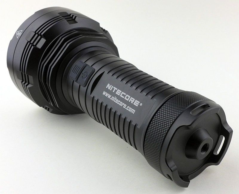

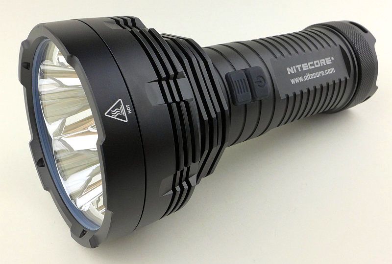

    The TM16.

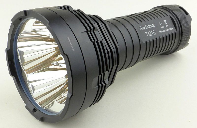

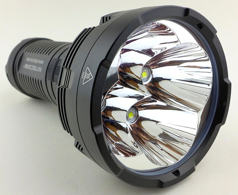

    Taking our first look into that compound reflector.
    There are a set of cooling fins machined into the base of the TM16’s head.
    Looking from the rear of theTM16.

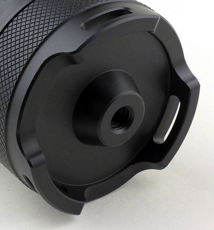

    In the tail-cap there is a threaded socket for a standard tripod screw.
    For a multi-emitter light the individual reflectors are relatively deep.

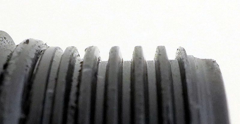

    Tapezoid threads are used.

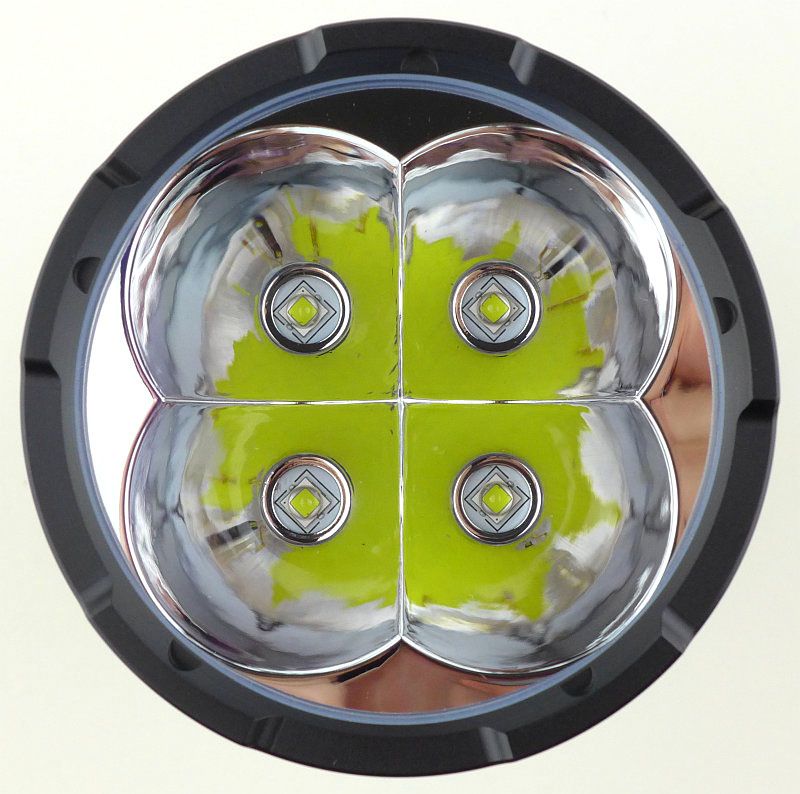

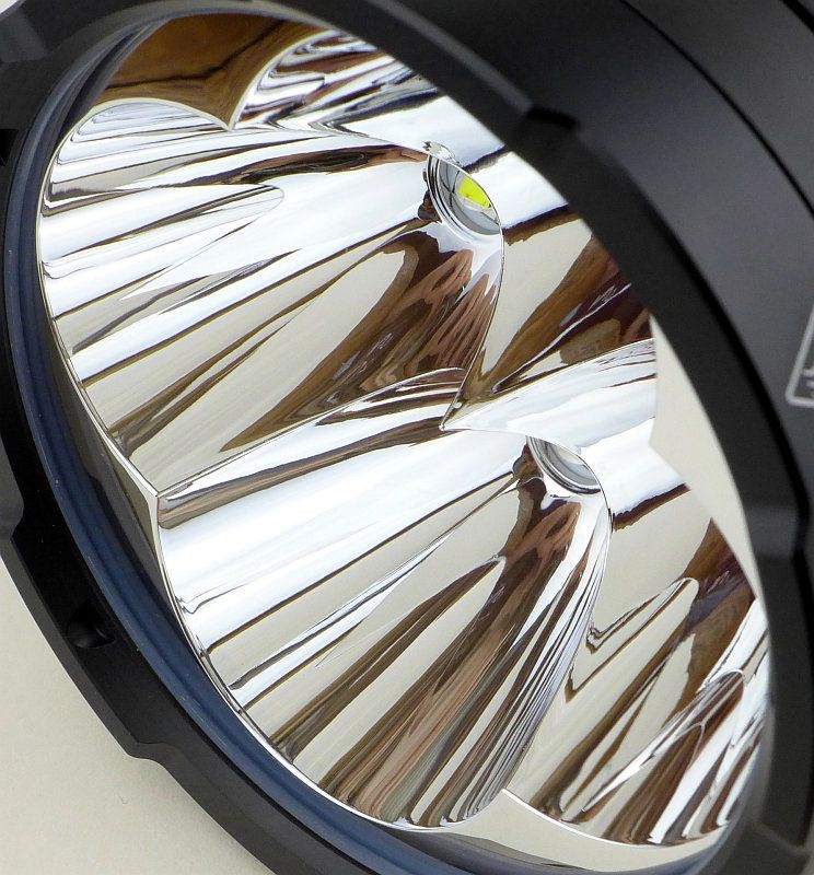

    Looking straight into the compound reflector at the four XM-L2 LEDs.
    Another view of the reflector.

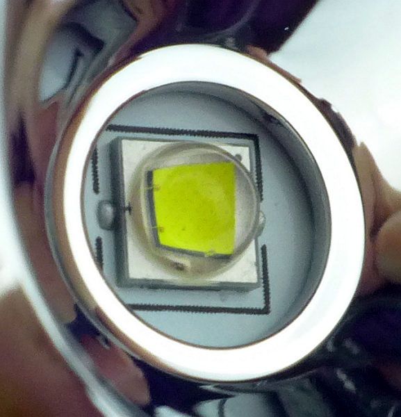

    And a closer look at one LED.

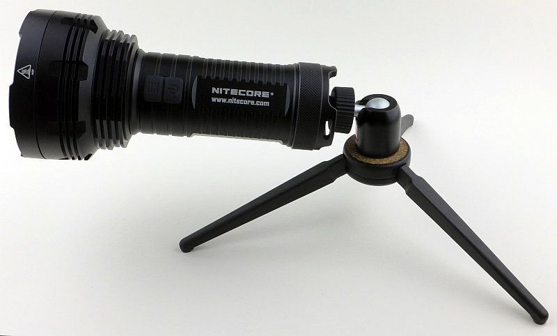

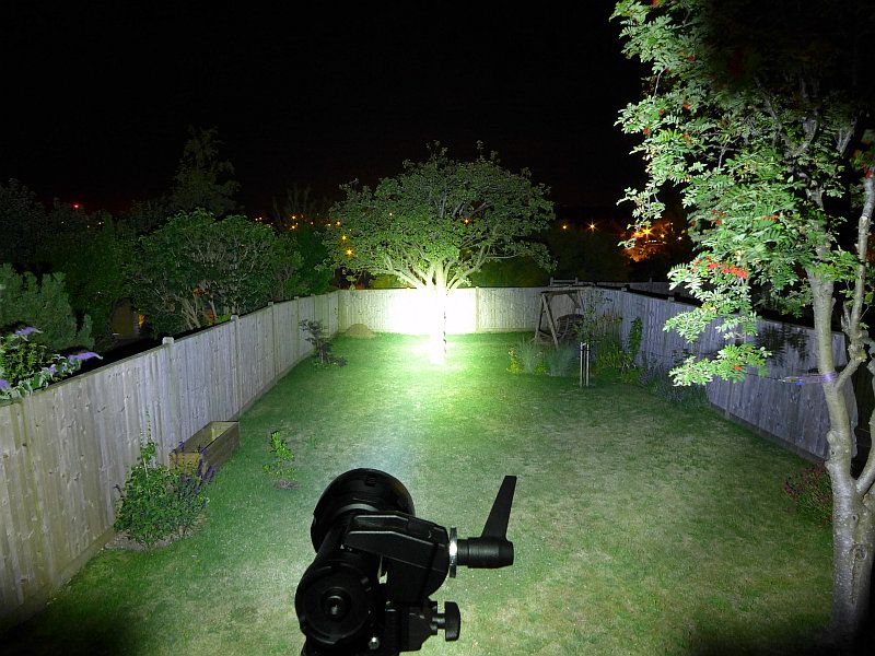

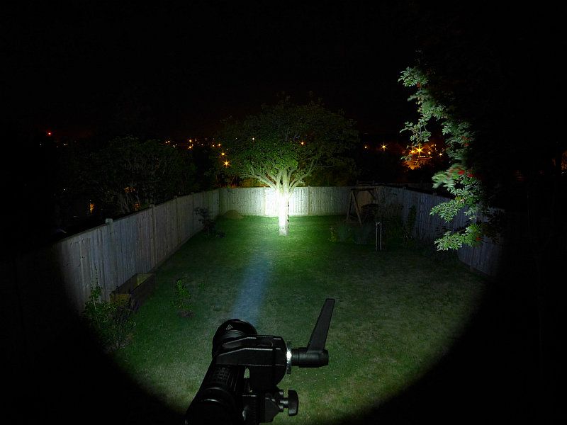

    Connecting the TM16 to a tripod using the threaded hole in the tail-cap.

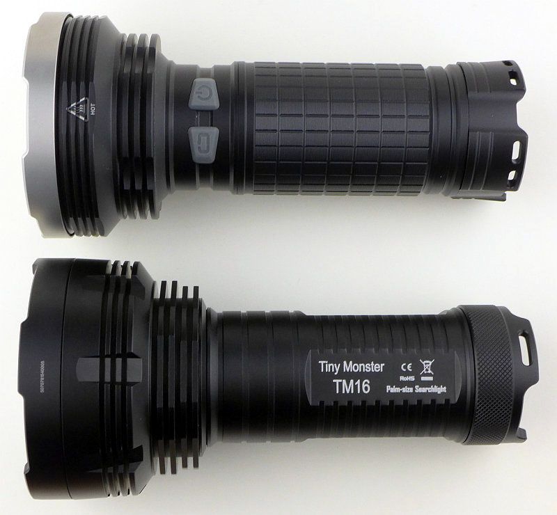

    Putting the TM16 next to the Fenix TK75, you can see how the TM16’s body is smaller thanks to not having a battery carrier.
    The TM16’s head is slightly bigger to better house the fourth LED, but still remains a very manageable size.

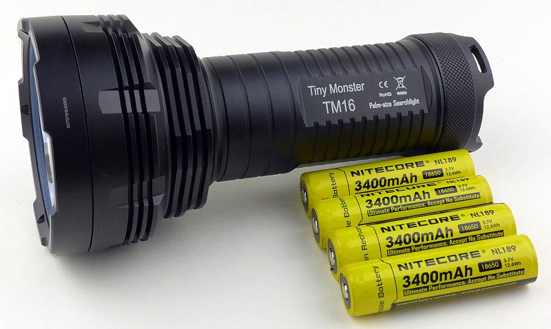

    The TM16 with the four cells it uses.
    Cells loaded and ready to go.

    The beam

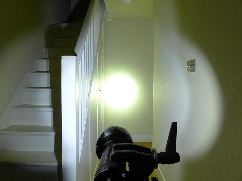

    Starting indoors, as expected with a compound reflector, the spill is flower shaped, but the hotspot is well formed.
    To properly show the power of the TM16’s beam first we look at my reference Fenix TK41.
    And then the TM16!

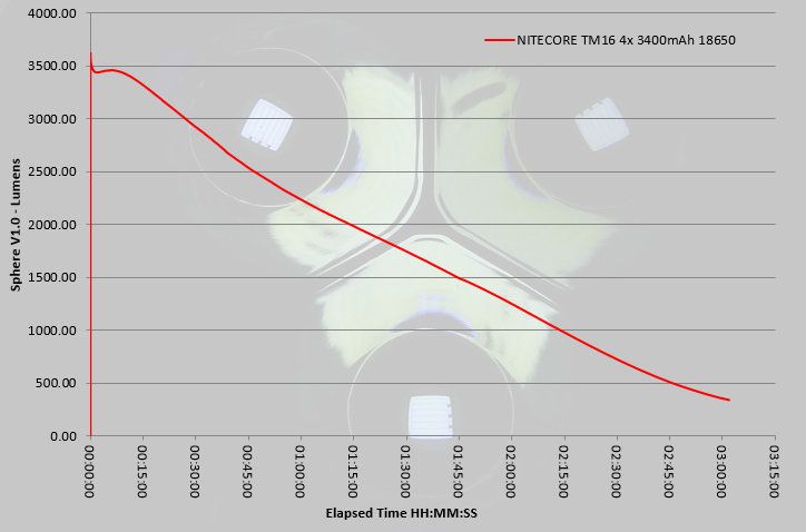

    NITECORE TM16 using NL189 3400mAh cells I.S. measured ANSI output Lumens PWM frequency or Strobe frequency (Hz)
    Turbo 3645 0
    High 1869 0
    Medium 666 0
    Low 253 0
    Lower 5 0
    Strobe 907 18.5
    Beacon Not measured 0.5
    Peak Beam intensity measured 114000lx @1m giving a beam range of 675m.
    There is parasitic drain. As with some other NITECORE 4x18650 lights, the drain is not the same for both pairs.
    Drain for Pair A (closest to the switch) is 131uA. This drain would fully deplete the cells in 2.96 years.
    Drain for Pair B is 70uA. This drain would fully deplete the cells in 5.54 years.
    To completely stop the drain the tail-cap must be almost fully removed, so it would be better to remove the cells if the TM16 is used as a standby light for more than a few months.
    There was no timed step down during the output test and there was also no drop to a lower level with the TM16 instead taking as much as it could from the cells.

    Though I’ve yet to use it practically, I’m glad to have the ability to tripod mount the TM16, as it allows you to use the TM16 as a fixed task light.

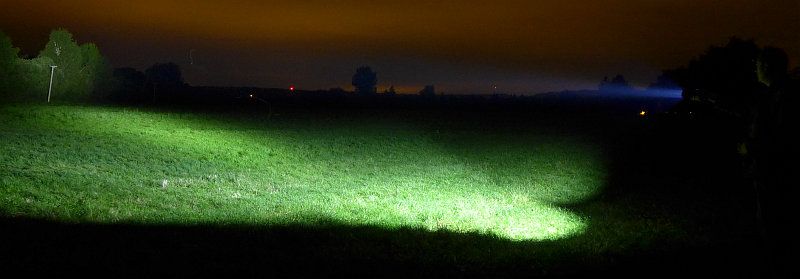

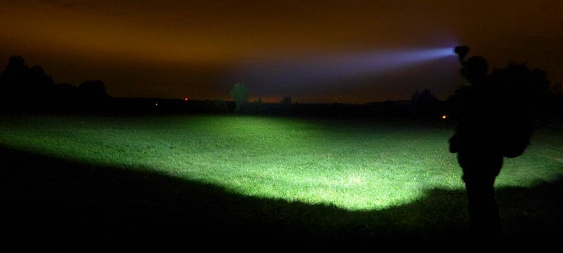

    And the TM16 where it counts, outside at longer ranges. Despite its compound reflector, the TM16 manages to push some serious lux out. Though not brilliantly shown in this photo, the distant tree (approx. 300m) is lit up in the TM16’s hotspot.
    In this photo a closer tree (approx. 100m) is lit up and the telegraph pole in front of it shines brightly.

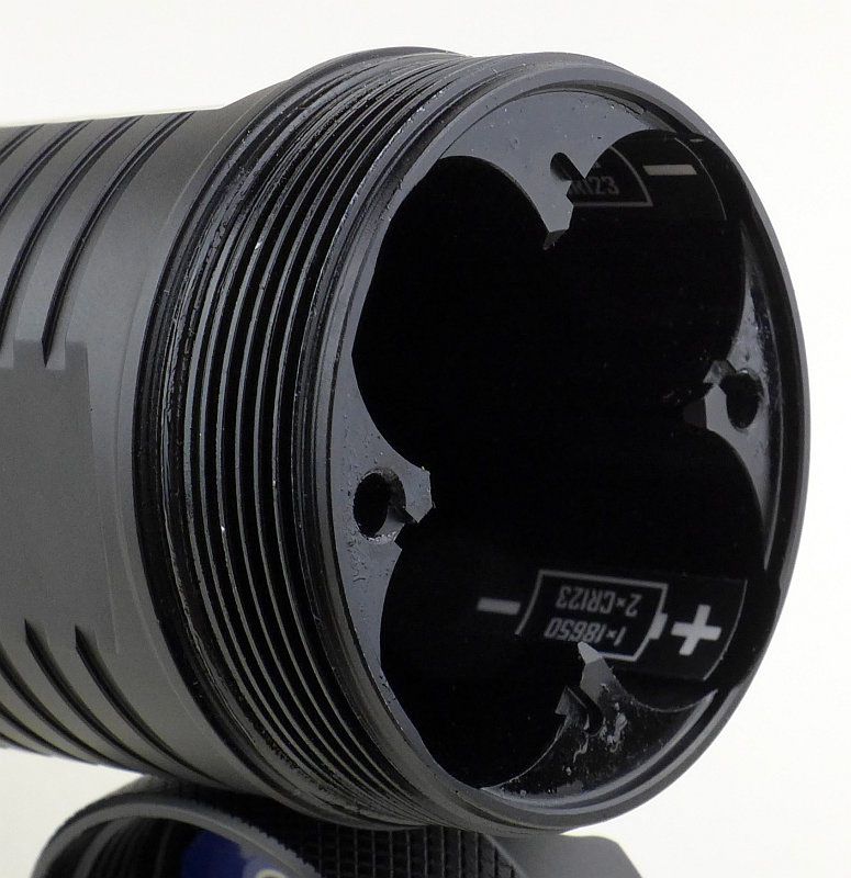

    Subwoofer,
    What is the debris on the rear of the light as shown in this picture?
    The picture before, I thought that you may have had the light outside in a slight rain, but after seeing the second image, I decided to ask.

    The debris is a combination of lubricant and dust. Unless otherwise stated all detailed photographs are fresh-out-of-the-box so exactly as you would have found it if you had bought this particular light.
