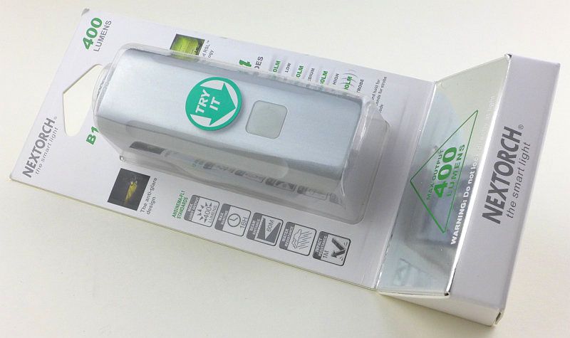

    The B10 comes in a ‘Try It’ type of cardboard blister pack. These always slightly concern me as it means the light is ‘powered up’ while on the shelf and you don’t know what state the batteries will be in.

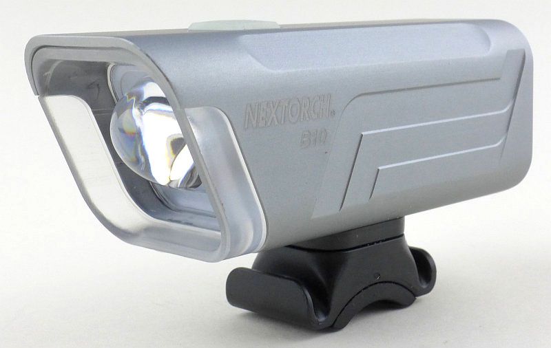

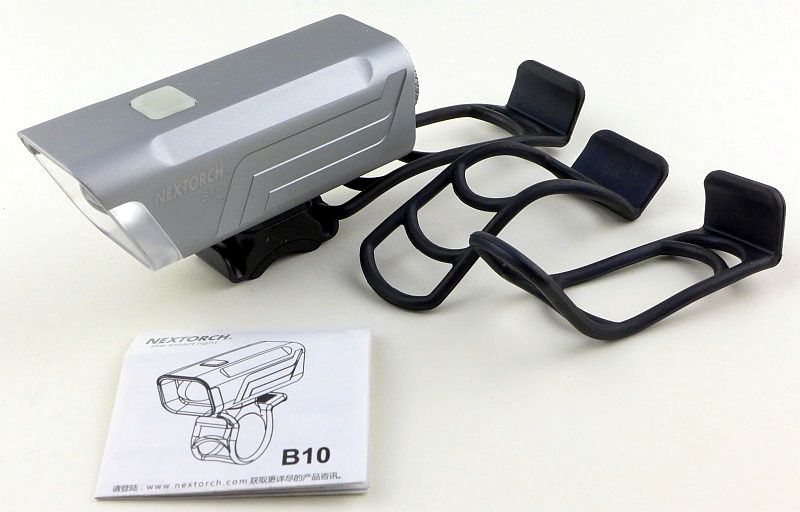

    First to emerge is the B10 itself with its rubber handlebar strap.
    Opening up the compartment in the box (which has the reflective surface for the ‘Try It’ effect), you find two spare rubber handlebar straps and the instructions.

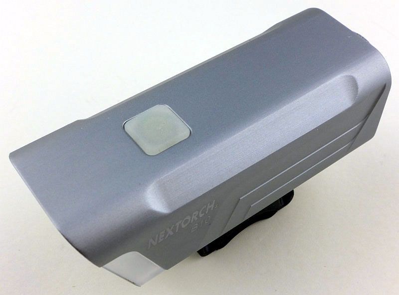

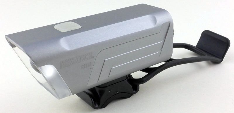

    On top of the sleek aluminium body is a single button.

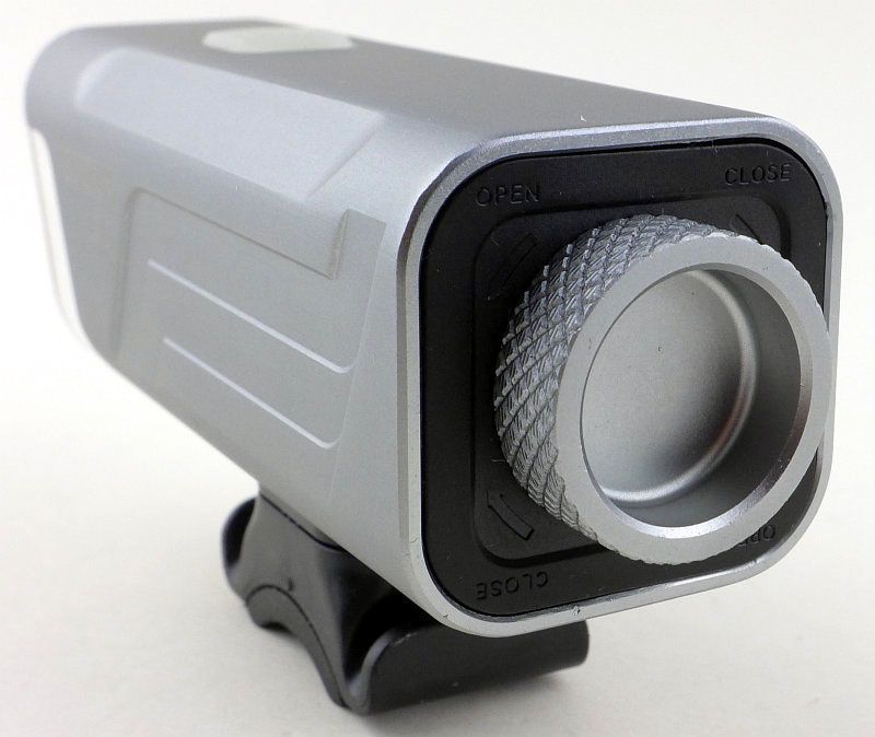

    A thumbscrew secures the back plate battery cover in place.

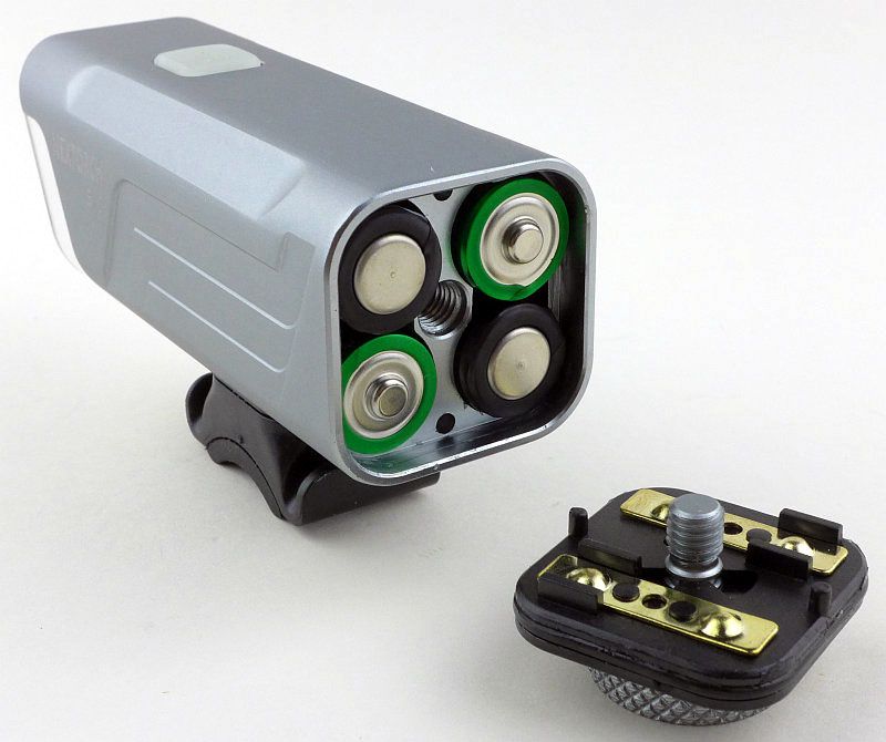

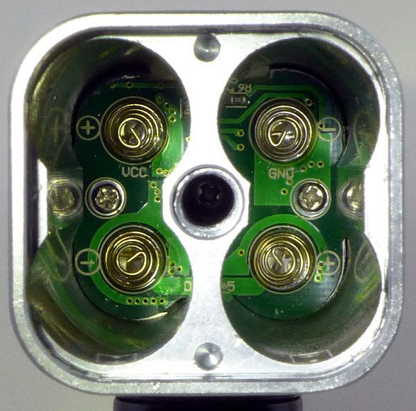

    With the battery cover removed you can see the locator pins in the battery cover and the gold plated connection strips. Also visible is the physical reverse polarity protection provided by plastic tabs preventing a negative cell terminal touching some of the contacts.
    Cell polarity is marked inside each of the four battery slots.
    The B10’s body is divided into two sections each holding 2xAA. The contacts are springs.

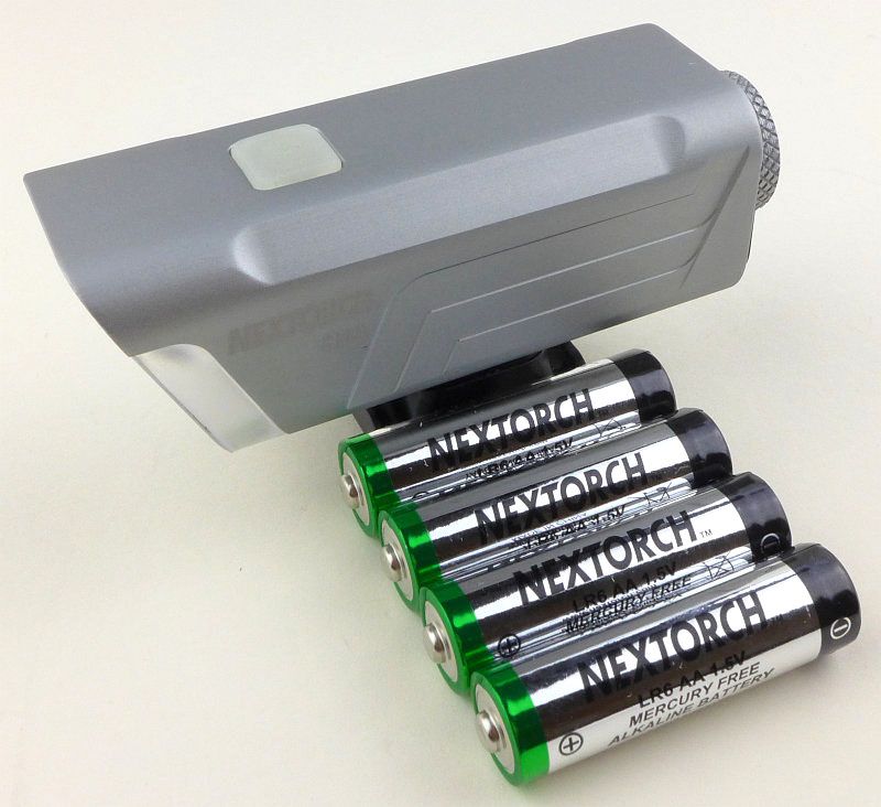

    The B10 is not a great deal bigger than the 4xAA it houses.

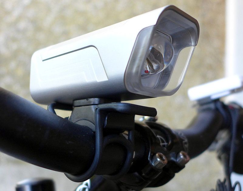

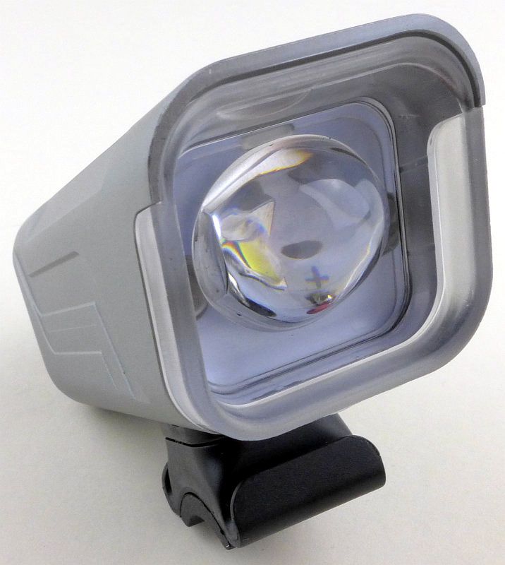

    A first look at the B10’s optic. From this angle you can just make out the XP-G2 LED behind the lens.

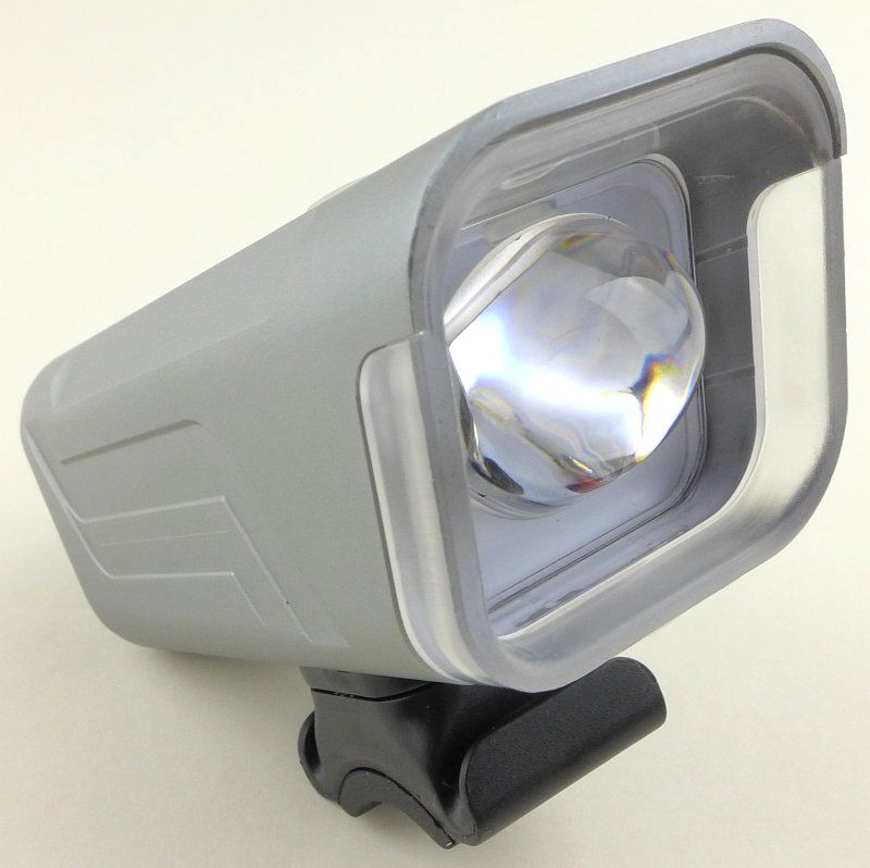

    A different angle showing how curved the lens is.

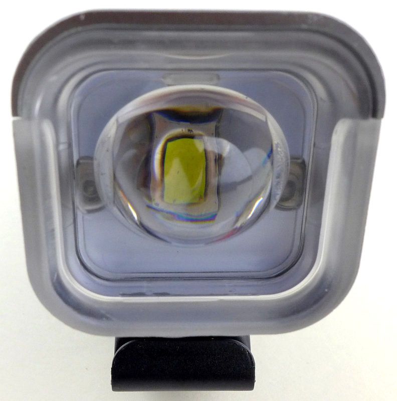

    Looking right into the optic, the XP-G2 LED is a bit clearer. The optic is an asymmetric ellipse shape.

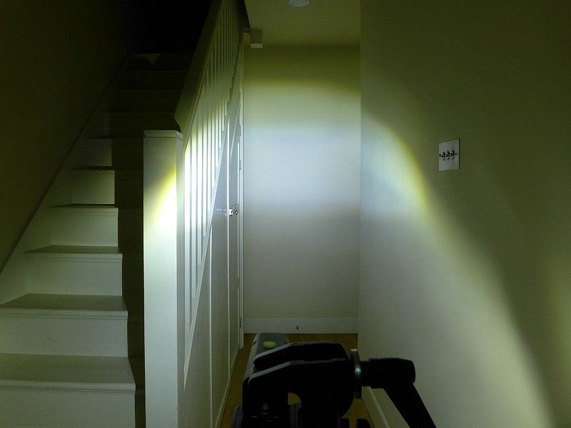

    Starting indoors, the highly shaped beam is obvious. The bright band does project upwards compared to the body of the light, so when mounted will need to be angled down somewhat on the handlebars.
    This beam shape gives a lower spill to light the ground and very little light above the bright band. This will be excellent for reduced glare for other road users.

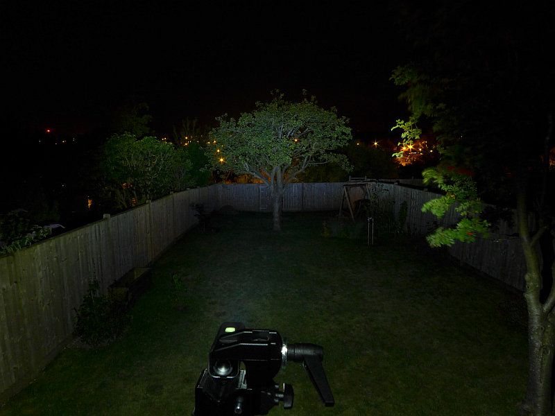

    Outdoors, the beam is limited in range due to the extreme shaping and limited output. Please bear in mind that this position is elevated so the ground effect is not showing.

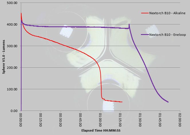

    Batteries and output:
    The B10 runs on 4x AA, Alkaline or NiMh.
    Nextorch B10 using Alkaline AAs I.S. measured ANSI output Lumens PWM frequency or Strobe frequency (Hz)
    High 428 0
    Medium 241 0
    Low 86 0
    Flashing 425 0.85
    Peak Beam intensity measured 1500lx @1m giving a beam range of 77m.
    There is parasitic drain at 2uA meaning typical Alkaline AAs will be fully depleted by this drain in 108 years (not to worry then).
    When running on Alkaline cells the B10 is nothing to write home about, but that is the cells, not the light.
    Load it up with Eneloops and the B10 can do what it was meant for. A well-regulated 400lm output for nearly 1h30m with 15 minutes of trailing off is very useful.

    Mounting the B10 is simple but can be a little fiddly due to limited space between the mount’s ‘hook’ and the light body. This is helped a lot by the tab moulded into the end of the strap that gives you something to get hold of.
    The strap is ladder-like and has four ‘rungs’ that allow you to adjust it to four different lengths to suit different handlebars.
    The mount is articulated allowing you to turn it from side to side to suit.
