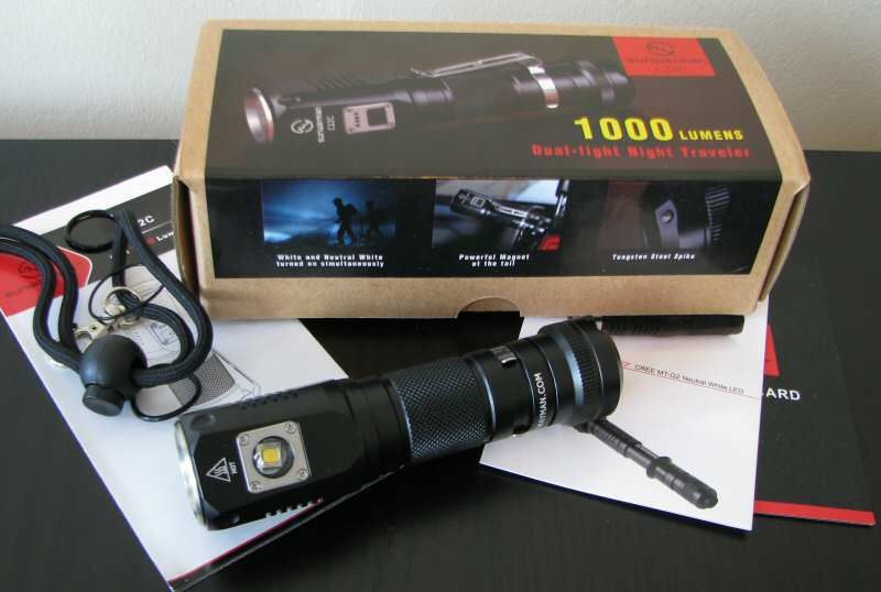

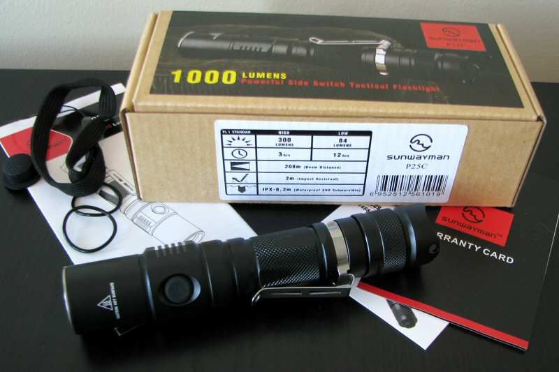

    Packaging across the models is the same - Sunwayman's standard cardboard display box, with specs and information printed right on the box. Included with each of the lights are a pocket clip, wrist lanyard, spare O-rings, and manual.
    C22C:
    P25C:

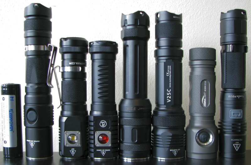

    From left to right: Keeppower Protected 18650 3100mAh; Sunwayman P25C, C22C, C21C, F40C, V25C; Zebralight SC600-II, Fenix PD35.
    Sunwayman C22C: Weight 88.2g, Length: 110.5mm, Width (bezel side) 26.9mm (bezel diagonal) 31.8mm
    Sunwayman P25C: Weight 89.7g, Length: 141.0mm, Width (bezel) 25.5mm
    Sunwayman C21C: Weight 78.6g, Length: 102.0mm, Width (bezel side) 26.9mm (bezel diagonal) 31.2mm
    Eagletac D25LC2: Weight: 50.0g, Length: 116.3mm, Width (bezel): 22.5mm
    Fenix PD35: Weight: 82.7g, Length: 138.1mm, Width (bezel): 25.4mm
    Nitecore EC20: Weight: 77.1g, Length: 129.2mm, Width (bezel): 25.4mm
    Nitecore MH20: Weight: 85.4g, Length: 105.5mm, Width (bezel): 31.8mm
    Nitecore P10: Weight 82.0g, Length: 135.1mm, Width (bezel): 25.5mm
    Nitecore P12: Weight: 89.7g, Length: 139.4mm, Width (bezel): 25.4mm
    Olight S20 (2013, XM-L2): Weight: 52.4g, Length: 106.5mm, Width (bezel): 23.1mm
    Skilhunt DS20: Weight: 53.8g, Length: 110.0mm, Width (bezel): 24.0mm
    Thrunite TN12-2014: Weight: 80.0g, Length: 140.5mm, Width (bezel): 25.4mm
    Zebralight SC600 II: Weight 79.3g, Length: 101.8mm, Width (bezel) 29.7mm

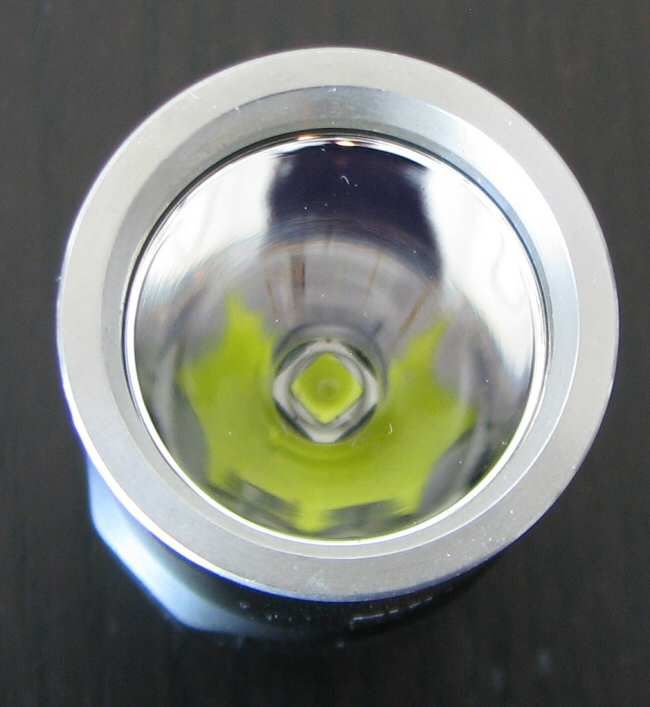

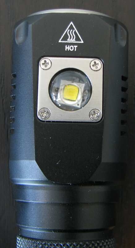

    The C22C is very similar in general design to the earlier C21C, but with a neutral white XP-G2 side emitter (flood). Body styling has been updated, but otherwise you can see my comments in that earlier review for build details. A couple of new features - there is a now a magnet in the tailcap (to allow horizontal standing off a metal surface). There is also a small, sharp protruding stainless steel point (which I presume is to break glass, if necessary).
    Scroll down for more information on the user interface.

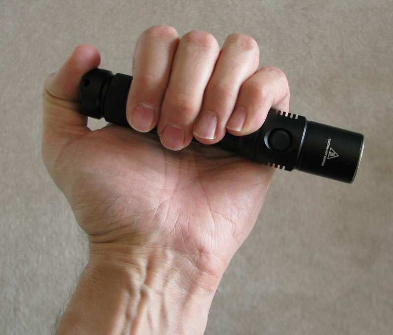

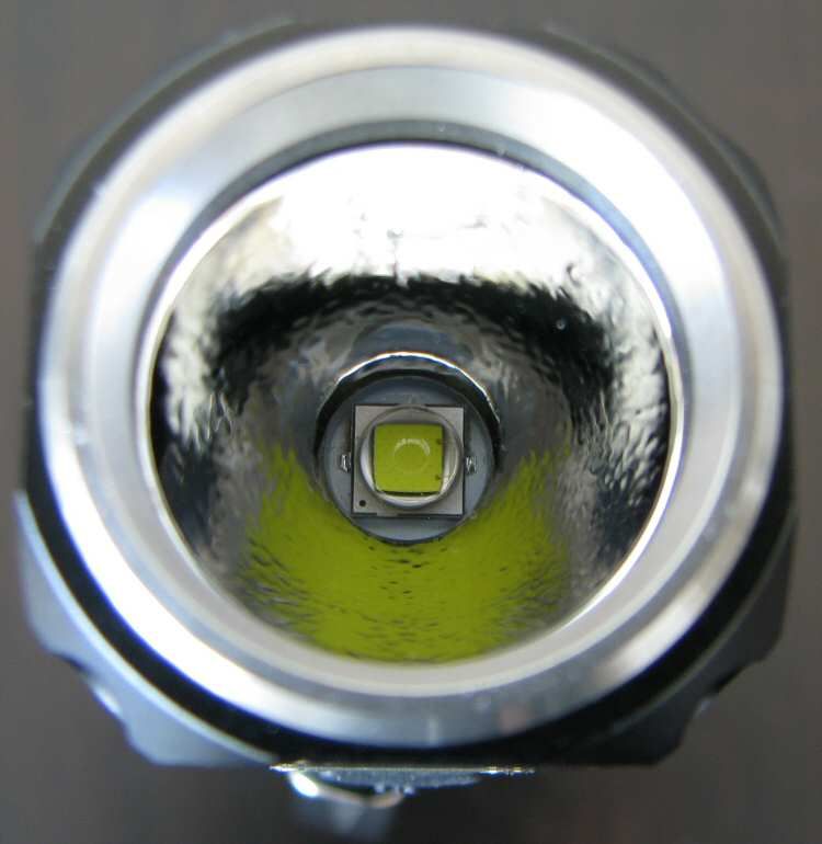

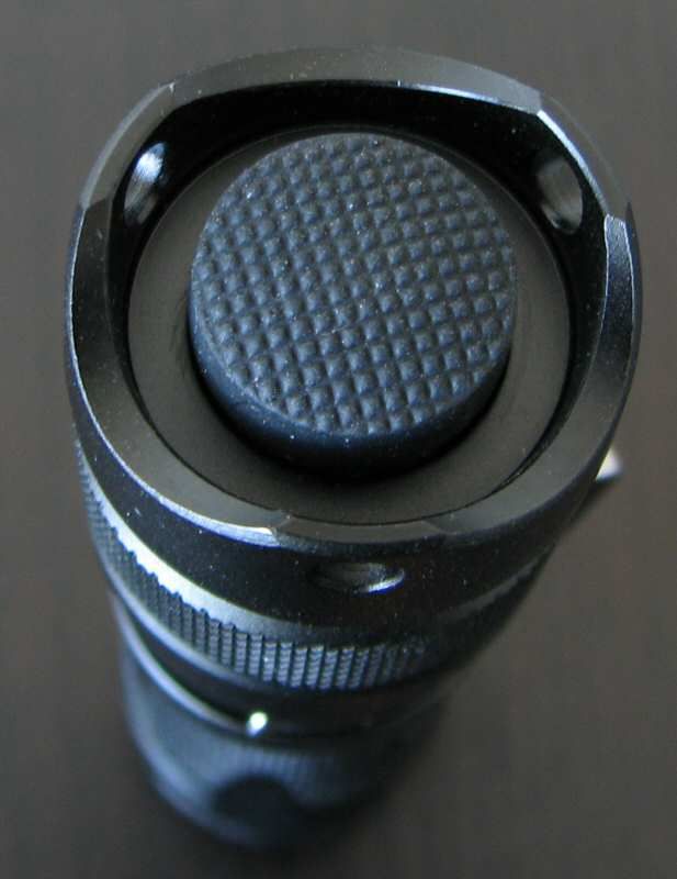

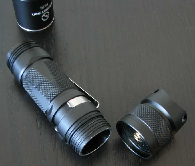

    The P25C is similar in general style to a number dual-switch design lights in this class (e.g., Thrunite TN12, Nitecore P12, Fenix PD35, etc.). You have a physical clicky switch for on/off, and side electronic switch (in the head) for mode control.

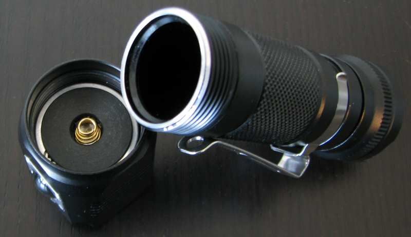

    Both models come with black anodizing – which no imperfections or chips on my samples. The P25C seems a touch less black than the C22C (i.e., more of a really dark natural finish). Lettering is fine and bright white on both models. Knurling is of moderate aggressiveness.
    Screw threads are anodized on both models for lock-out (square cut on the P25C, triangular cut on the C22C). Both lights can tailstand.
    For more information on the builds, please see my video overview below.

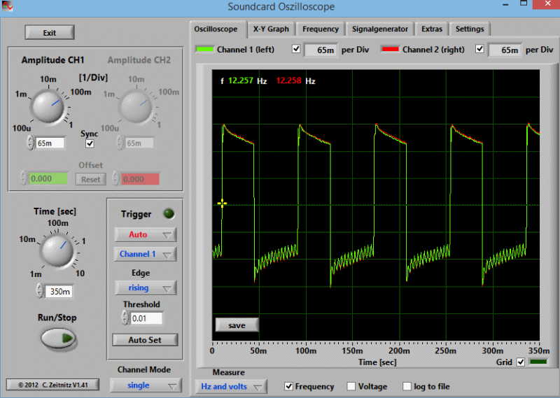

    PWM/Strobe
    Most Sunwayman lights don't use pulse width modulation (PWM) to control the lower output modes. However, I did previously detect measurable circuit noise on my C21C – although not visible to the eye. A similar pattern was noted on the C22C, but only on the side neutral white emitter
    C22C NW Med
    C22C NW Lo
    Again, these signals are extremely high-frequency, and cannot be seen in practice. Rest assured the C22C is fully "flicker-free" in all modes. As per my standard review policy, I simply report on anything I can measure (whether it is visually detectable or not).

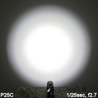

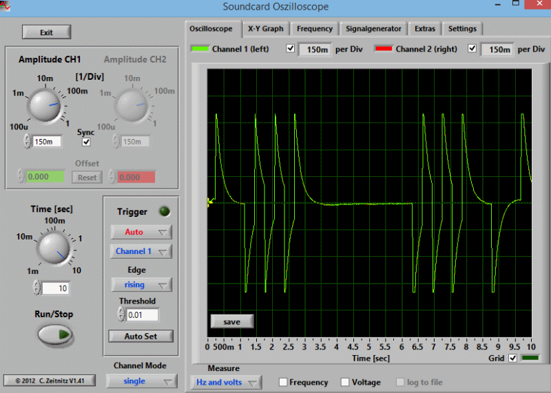

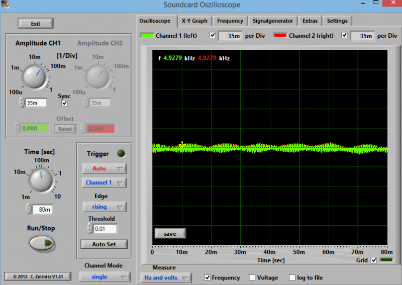

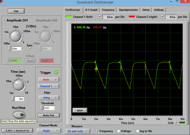

    The P25C is a different case, where there does seem to be visible PWM-like effects on the sub-max modes.
    P25C Turbo
    P25C Hi
    P25C Med
    P25C Lo
    This pattern is a little unusual, and doesn't have the typical PWM square pulse-wave. Nonetheless, the pulse width is modulated with perceived output level, suggesting this is indeed PWM control. It is also visible by eye, given the ~500 Hz frequency. Personally, I only found it noticeable in practice on Lo and Med, but would have preferred not to have seen it all.
    EDIT: Sunwayman confirms that smoothing is applied to the PWM signal - presumably to make it less visually detectable. It seems to be working, as I didn't find the PWM to be as noticeable as typical 500 Hz PWM - but I can indeed still detect it visually.
    C22C CW Strobe
    C22C NW Strobe

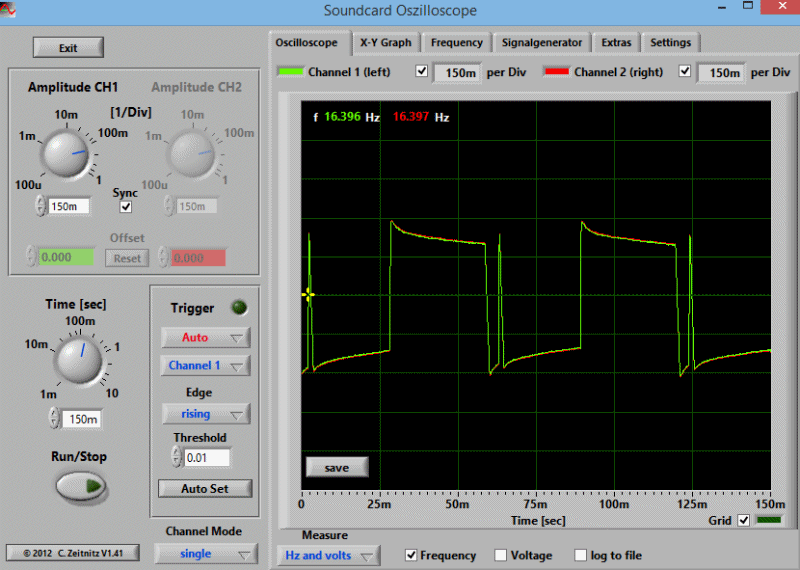

    Both the main cool white and side neutral white emitters strobe at a frequency of ~12.3 Hz.
    P25C Strobe
    The P25C has a fairly high frequency strobe, at 16.4 Hz.

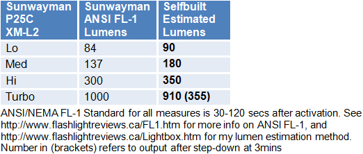

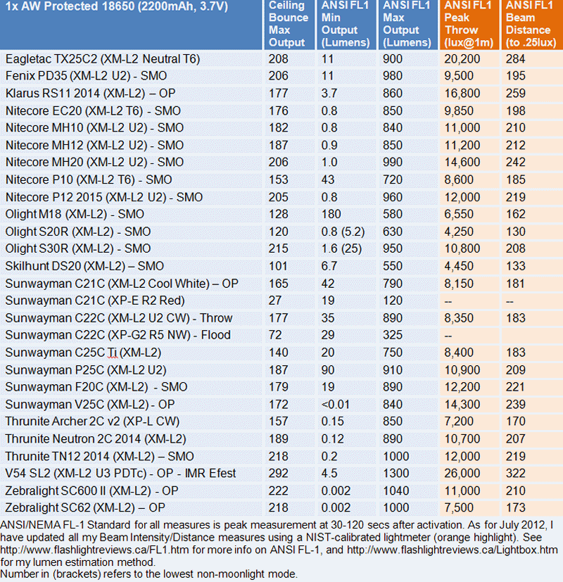

    Max output is reasonable on both the C22C and P25C, but I would have liked to have seen lower Lo modes included on both models.
    Note that while 2xRCR are not official supported, I did test them in both lights. I will not be doing runtimes, however.

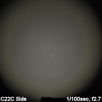

    Let's see how all the levels compare across the lights on 1x18650, in my lightbox:

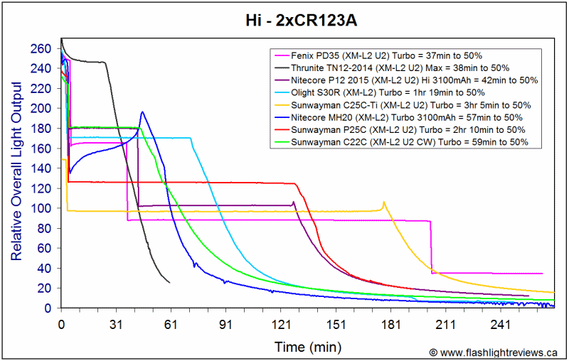

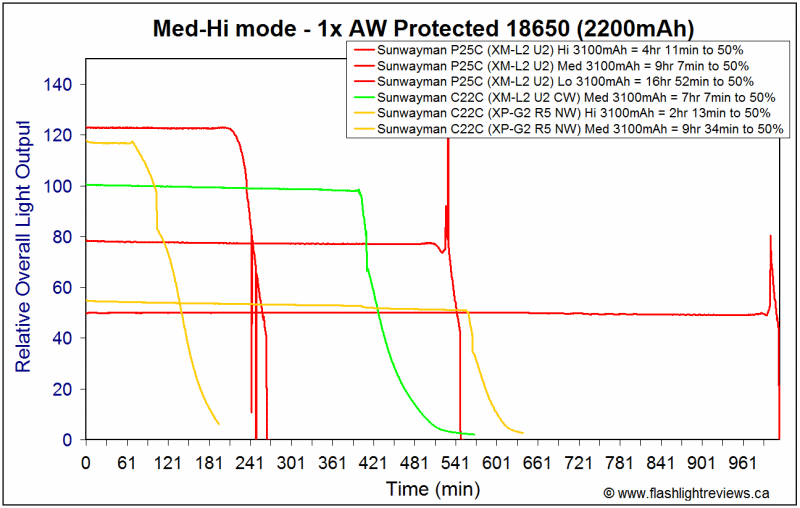

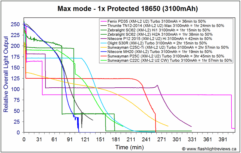

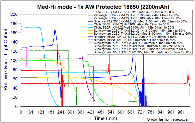

    Output/Runtime Graphs:
    All my current runtimes are done with protected NCR18650A (3100mAh capacity) batteries. First, a comparison between these two lights:
    Basically, both lights step down from their max level to Hi after 3 mins of runtime – but the P25C Hi level is much lower than the C22C.
    The combined emitter output mode of the C2CC is intermediate in overall output to the individual max modes of the emitters singly (as you might expect).
    And now how they compare to other lights on 1x18650:

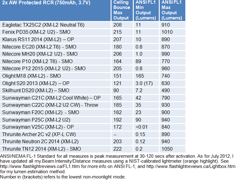

    And now runtimes on 2xCR123A
    Overall output/runtime efficiency is in keeping with other lights in this class.

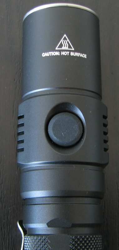

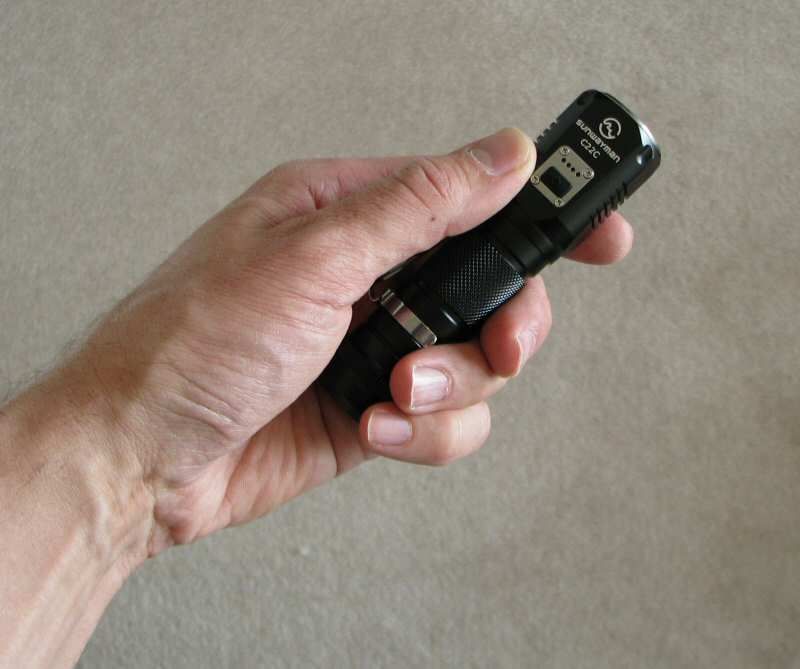

    The electronic switch on the C22C is smaller than typical, and may be hard to access with gloves on. User interface may take a little getting used as well. Mode memory is not independently maintained for the two emitters modes (i.e., only one common memory store for last mode/output level used).

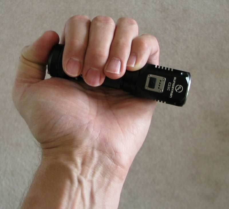

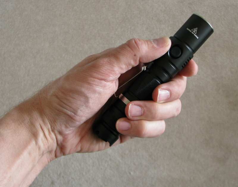

    Physically, ergonomics and hand feel on the C22C remain decent - although you might find both the light and electronic switch to be a bit small (especially if you have large hands). As before, I find the user interface not entirely intuitive given that all features that need to be controlled by a single switch. Beam patterns are good. Output/runtime performance is very good, consistent with a current-controlled circuit – no surprises here.

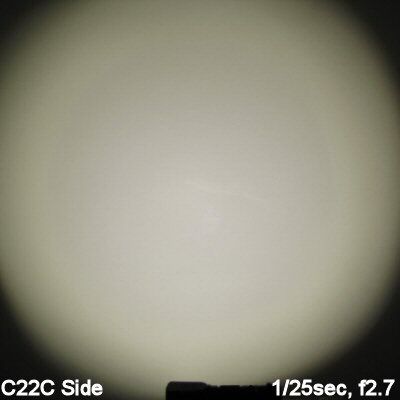

    Thanks for the awesome review, so much infomation everywhere !!
    Wow there is a big difference between sunwaymans spec and your findings on the side light on the c22, I like the idea of having the ground flooded whilst having the main beam looking around the distance, seems a good walk light.
    It is hard to provide good output estimates with a pure flood emitter, so take my numbers with a grain of salt. That said, the runtime performance makes sense for the estimated outputs, so I think they are in the right ball park.

    I work in industry & often take photos or video. The "flood" is through a (aspheric?) lens so there is no hot spot at all, better than a mule, very even spread of light. Great for photos or video, and having it neutral makes it even better. The LED with the reflector is nice, no complaints. I loosen the tail cap when I put it in my bag. It's a nice compact light for a 18650 light and the magnet in the tailcap is a nice touch.
    I've got a drop-in from Vinz that has a similar lens on it and in the P60 format it really kicks ass, CRI is better as well, but then I need to carry two lights...
    6,936
    Default Re: Sunwayman C22C, P25C (XM-L2 U2 - 1x18650, 2xCR123A) Review: RUNTIMES, BEAMSHOTS+
    Quote Originally Posted by KeepingItLight View Post
    How do these flashlights handle a low voltage condition? Do they flash their main beams or have a blinking LEDs on their bodies? Do they force step-downs to lower levels? Do they have low-voltage cutoff circuits that turn off the flashlights completely? Do they do nothing (except keep chugging along as best they can)?
    You can tell this from the runtimes - the lights simply continue to draw low power as the batteries drain. There is no evidence of flashing or any other warning or attempt to shut-down. Due to this low current draw, it is relatively unlikely you would over-discharge cells (unless you left the light on unattended).
    Quote Originally Posted by Ernst from Germany View Post
    Sehr gute Lichtstrahl from the P25c!
    ERnst-Dieter
    Quote Originally Posted by nfetterly View Post
    Yes, the neutral beam is quite nice, with its very even pattern - I comment on this more in the video than in the review text. I agree, it is very reminiscent of an aspheric. Thanks for the sharing your professional perspective.
    Thanks for the info!
    Prospective buyers now know the burden of preventing over-discharge falls on them. These Sunwayman flashlights do nothing to prevent it.
    In my book, that is a good reason to power these lights with protected batteries. Of course, I would do that even if they had low-voltage cutoffs.
    Redundant systems work great in 747s, and I don't mind having a few in my flashlights, either.

    I have just heard from Sunwayman that they use smoothing of the PWM signal - which helps to explain the unusual effect noted in the oscilloscope traces. Presumably, this is done reduce apparent flicker (i.e., the less sharp the demarcation between pulses, the less likely you are to notice it). It seems to be somewhat effective, because I subjectively didn't perceive the PWM to be as bad as the 500Hz would indicate (i.e., normally I find it far more detectable than I did in this case).
    Quote Originally Posted by TheBo View Post
    Regarding the light, I own the C22C, and despite not having a rel moonlight mode and the obvious "fake" lumen claim i find that light very very nice and genuinely well thought, the magnetic tail, the flood pattern and tint, and the decent throw beam (which tint is too cold for me, but still usable)
    Thanks for providing your perspective - and
