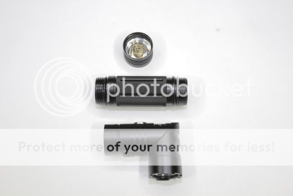

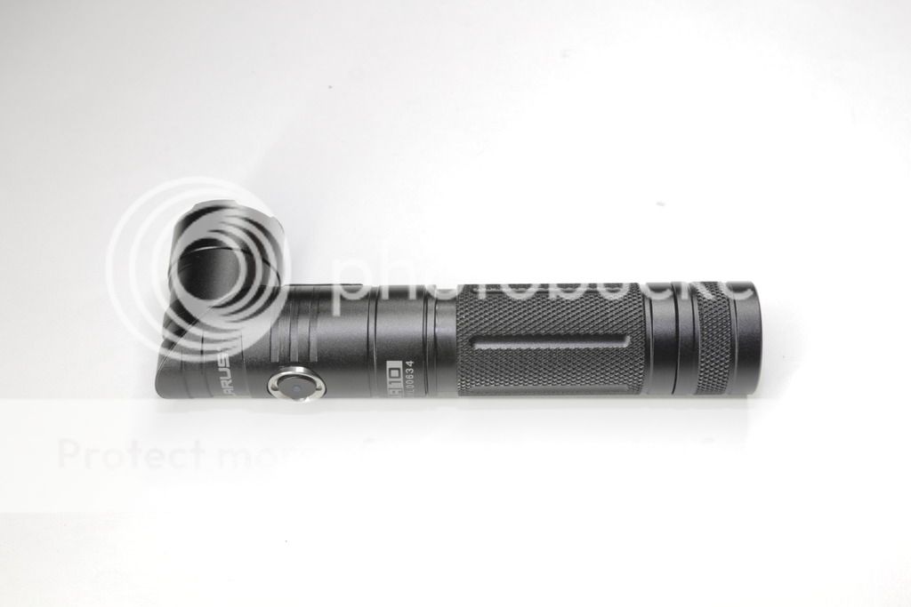

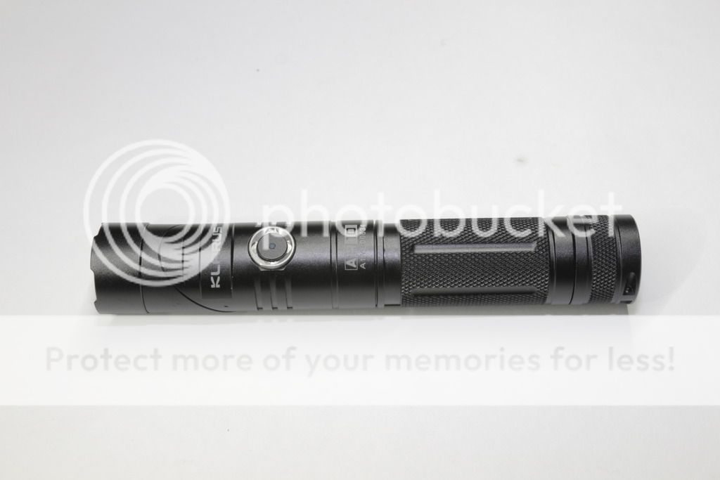

    The AR10 is made from aircraft grade aluminum with a HAIII anodized, black finish.
    The finish is not reflective, but it isn't Matte either.

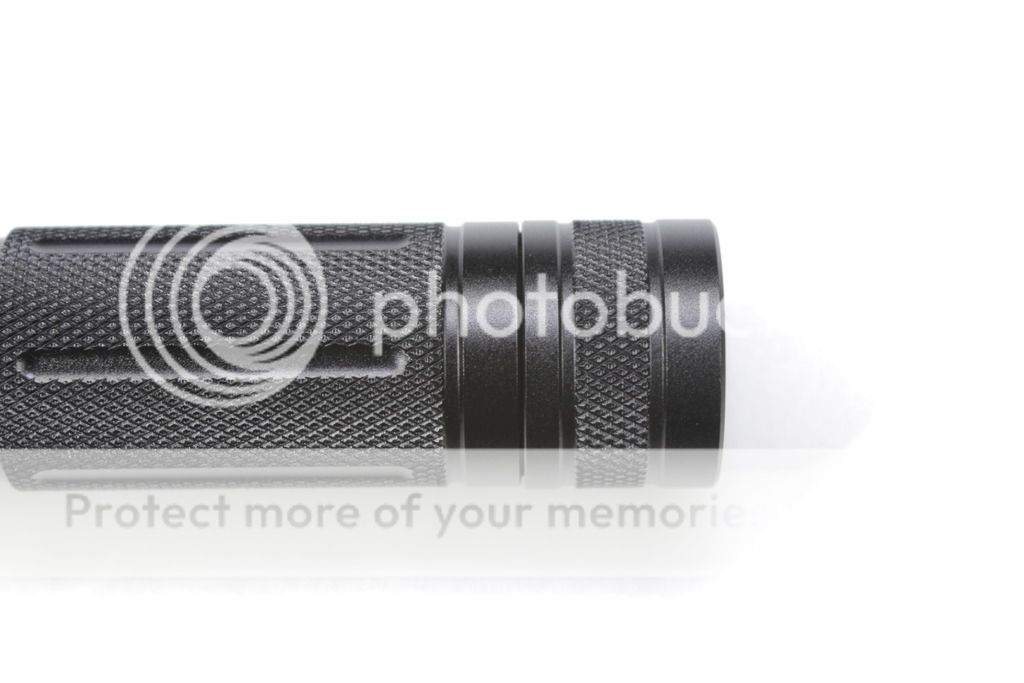

    The knurling is very similar to most Fenix flashlights of this class. The cuts are diamonds and are raised for better grip with good aggressiveness.
    Overall there isn't much in the anti-roll area of this flashlight. not much other than the USB cover and button are preventing this light from rolling. If you add on the belt clip, then your anti-roll is pretty good.
    The markings are a mid-tone gray which makes them not stand out as much as some other manufacturers' lights.

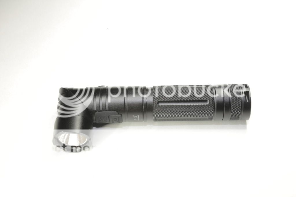

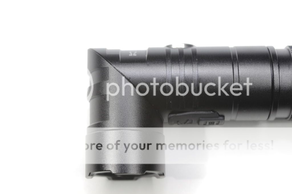

    The feel of the light is good and sturdy with the only moving part being the head.

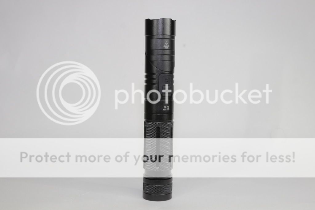

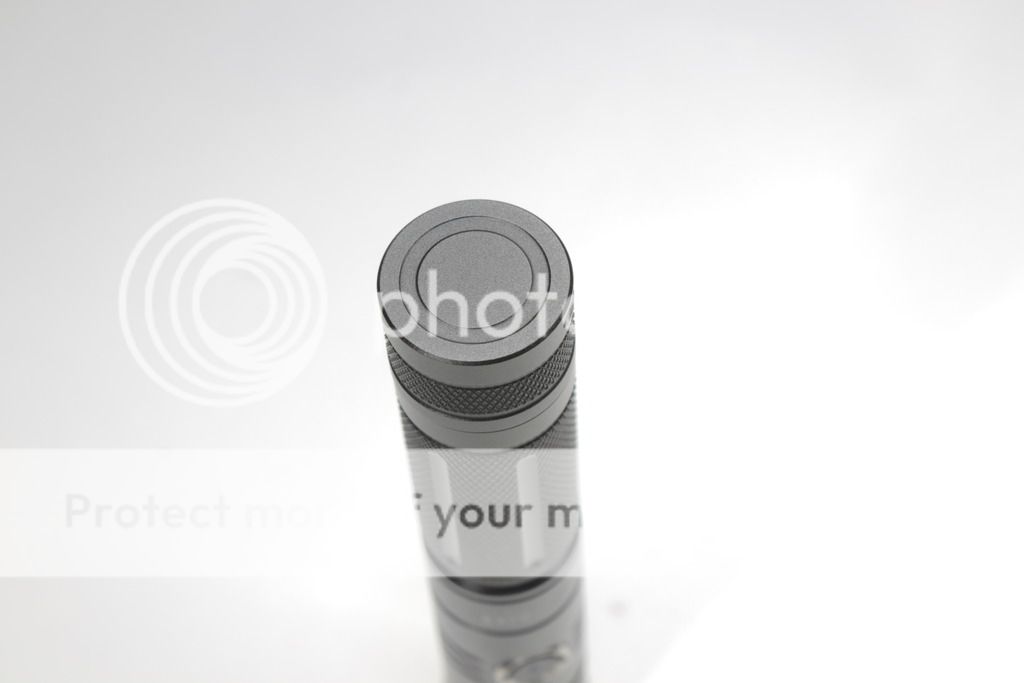

    There is no tactical clicky switch, so the bottom of the light is flat with magnet inside
    My sample came free of any scratches or chips in the finish
    The Interface

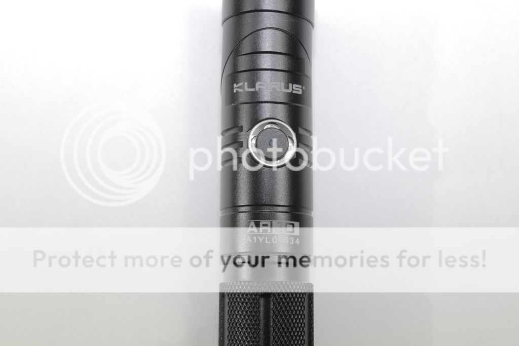

    The AR10 is completely controlled by the side button. To activate the light, simply press the side button. There is about a half second delay upon pressing the button until the light comes on (At least on my sample). To cycle through modes, simply click the side button. The modes on this flashlight cycle from highest to lowest, unlike most other flashlights that cycle from lowest to highest. To turn the light off, hold the side button for about a second.
    To access strobe, double press the side button. To turn the light off when it is in strobe, simply click the side button.
    To turn the light on in turbo mode, press and hold the side button from the off phase, rather than just clicking it.
    To activate SOS mode, simply double click to enter strobe, and double click again.
    The AR10 does have mode memory and will come on in whatever mode you last had on (other than strobe). I find the strobe to be very easily and quickly accessed by just double pressing the button.
    Everything is the same whether the head is rotated or straight.

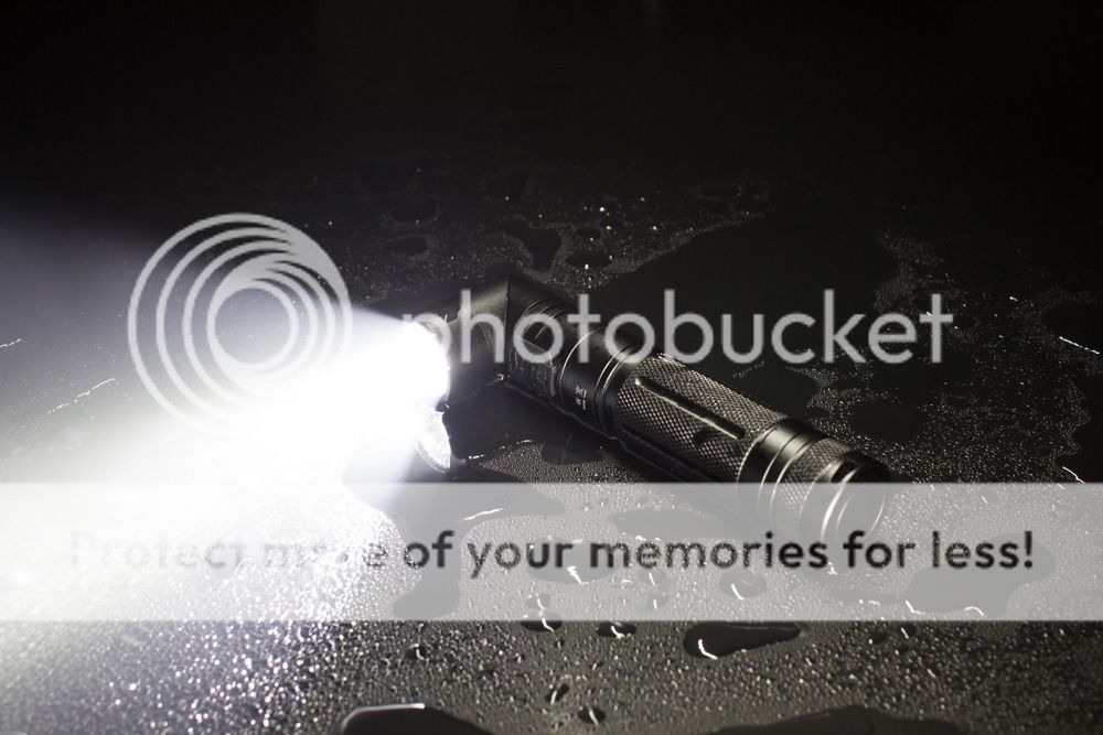

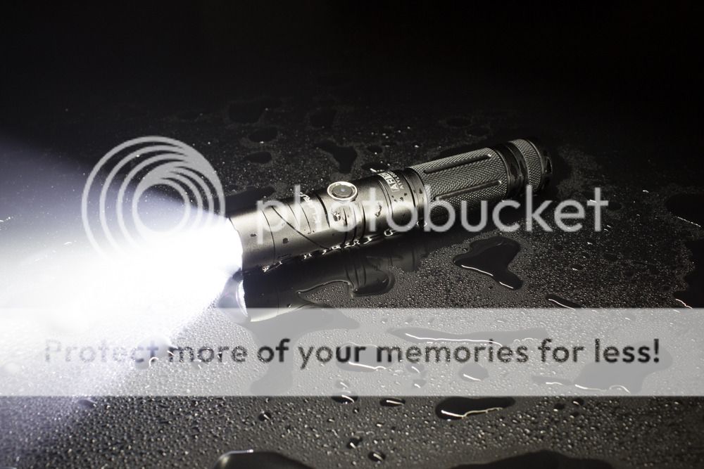

    The AR10 is IPX-8 waterproof to 2 meters
    I submerged theAR10 in water completely while rotating the head and clicking the side button and no water appears to have entered the flashlight.

    When the AR10 is on, there is a small LED inside the side button that will light up either green, orange or red. Green = 70% - 100% battery. Orange = 30% - 70% and red = less than 30%

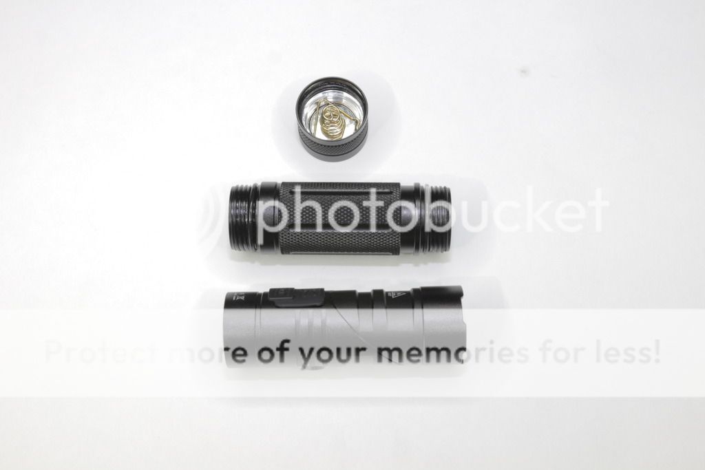

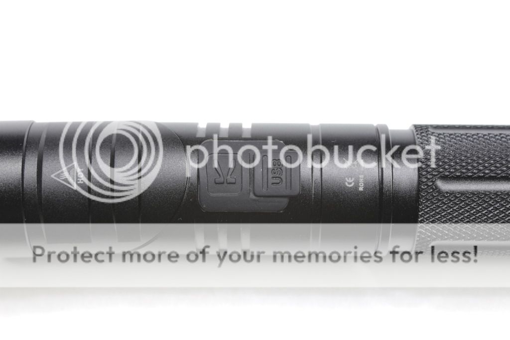

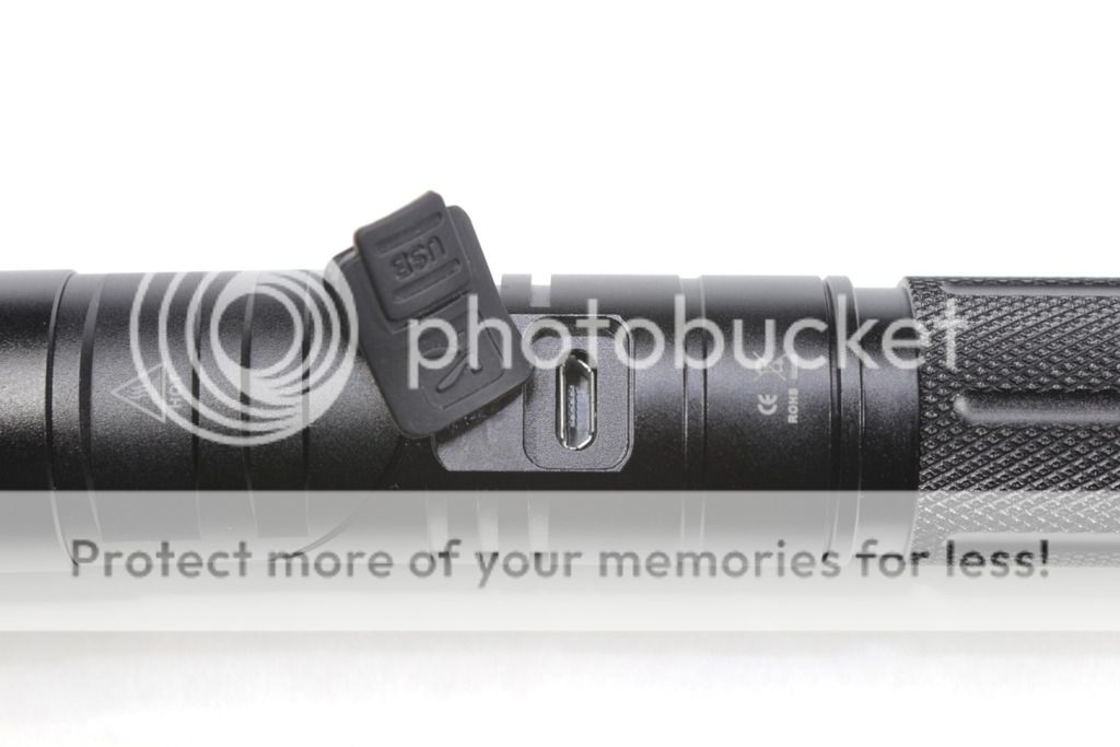

    There is also a USB recharging port on the side of the AR10. The flap opens to reveal the micro-usb slot where you can recharge the flashlight. The LED inside the side button will be red whilst the light is charging and green when it is finished.

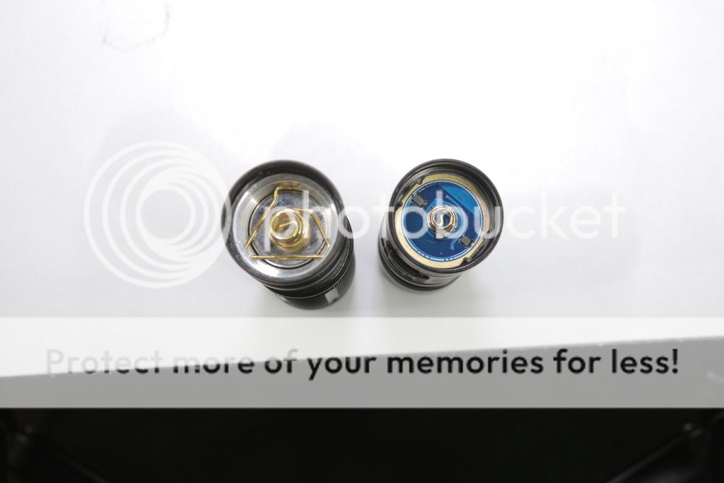

    There are springs in both the front and the back of the battery tube for the AR10
    The AR10 also can tail stand extremely well because the bottom is flat

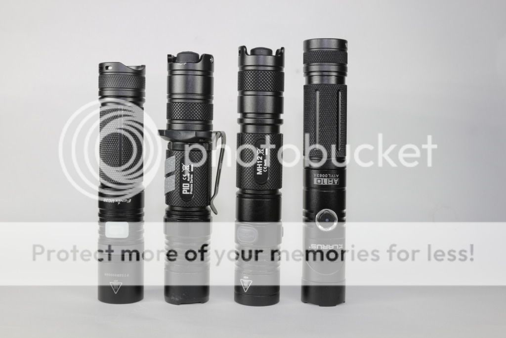

    From left to right:
    Fenix UC30, Nitecore P10, Nitecore MH12, Klarus AR10

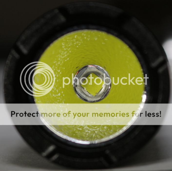

    The AR10 features a CREE XM-L2 U2 LED emitter and an OP (Orange peel) textured reflector for a smooth beam.

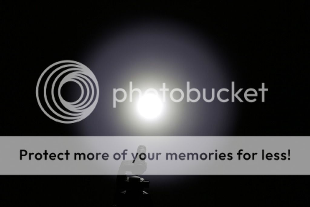

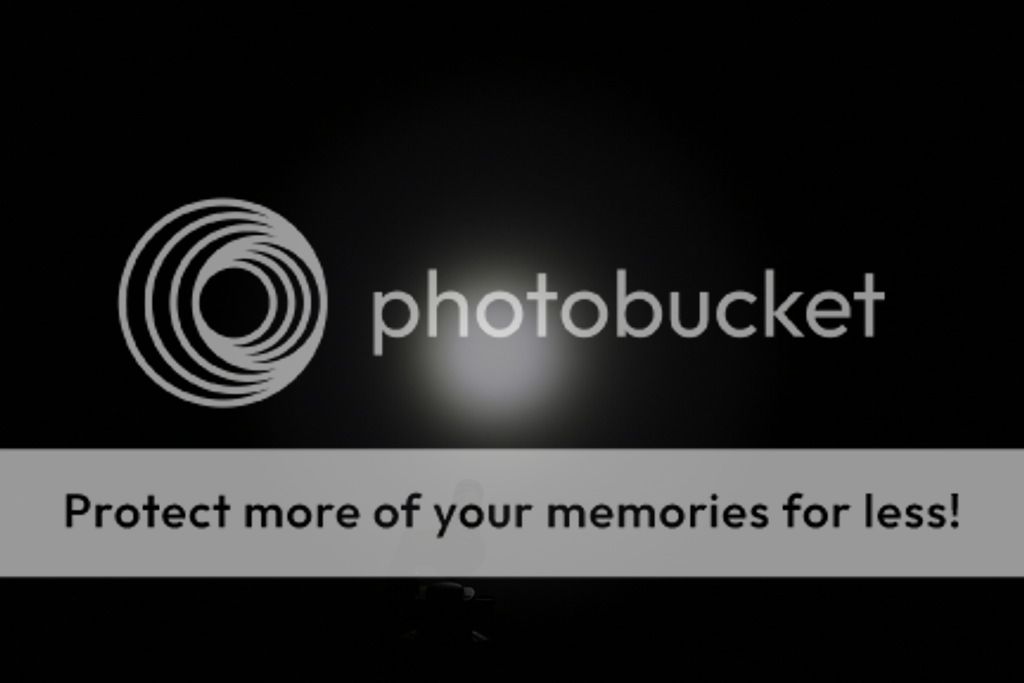

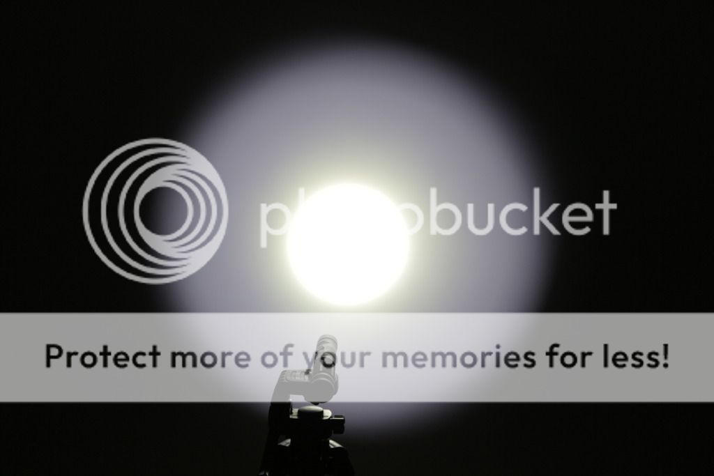

    Beam Profile
    The AR10's beam profile is very smooth and does not have any artifacts due to the textured reflector. There is also no visible donut hole!
    ISO 100, f/3.5, 1/60
    ISO 100, f/3.5, 1/250
    ISO 100, f/3.5, 1/2000

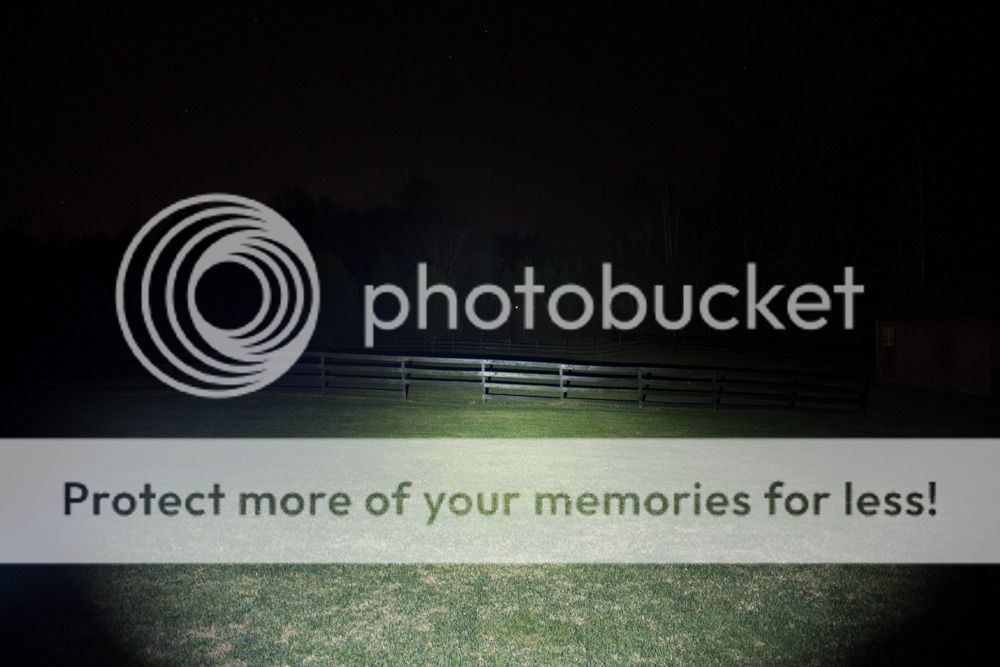

    Beam shot
    The first fence is 82 feet away. the second fence is 232 feet away. The far trees are 376 feet away.
    Zoom up on the picture to see the distance better. The tree trunks are easily visible at that distance. Dark objects are harder to see but anything neutral gray and brighter is visible.
