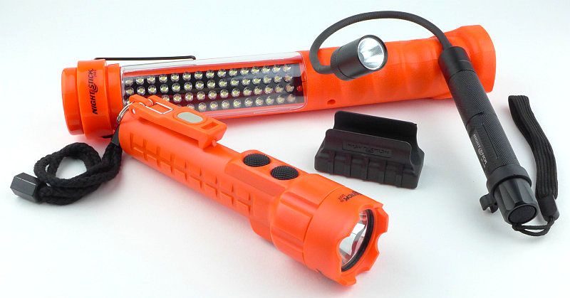

    My second group review of Nightstick lights includes three light from the Multi-Purpose/Work-light/Task-light range. These are general purpose lights for tradesmen, mechanics and DIYers which are ideal for your garage, loft and around the home. In this review I’m looking at:

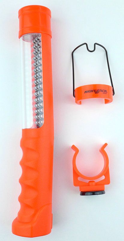

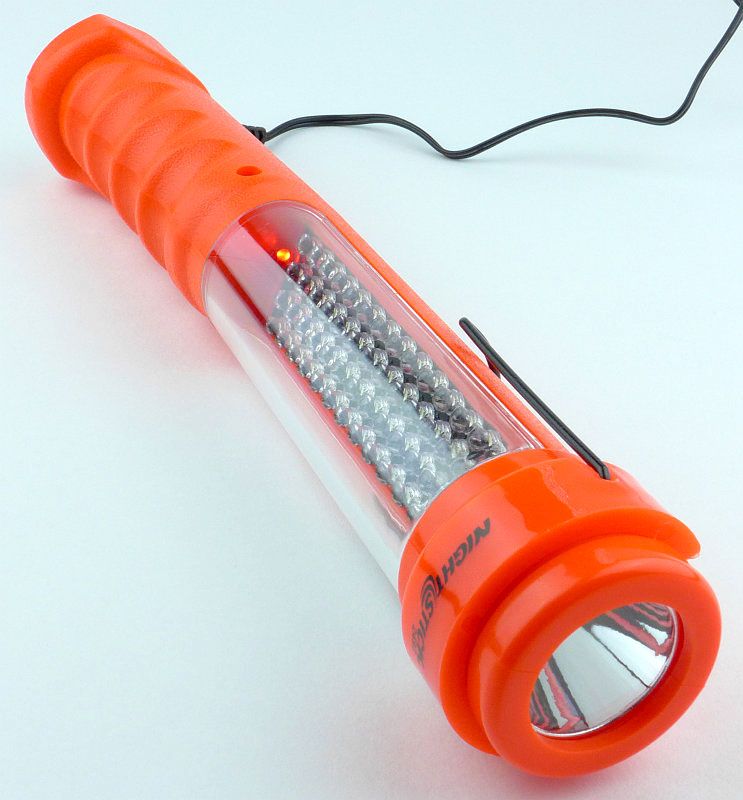

    NSR-2492 Multi-Purpose Work Light

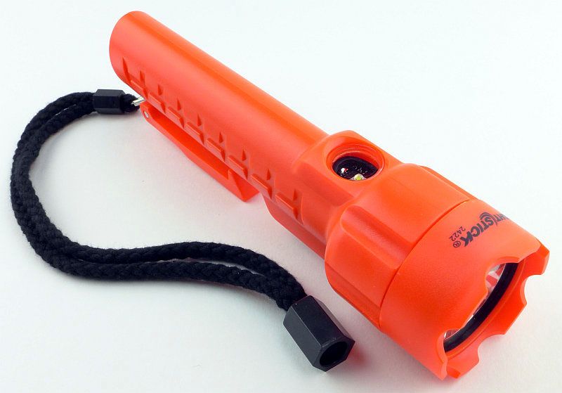

    NSP-2422R Dual-Light with magnets
    MT-130 Mini-TAC Gooseneck
    This set of lights as they arrived.

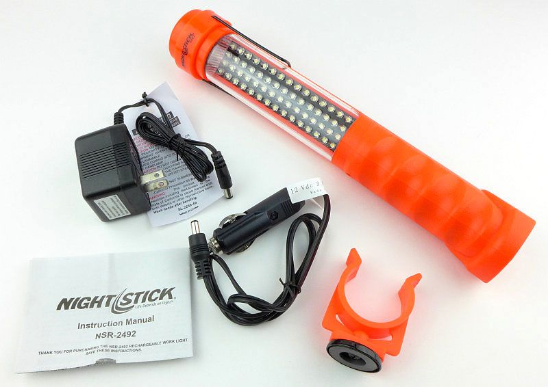

    Taking a more detailed look at the NSR-2492 Multi-Purpose Work Light:
    This light is rechargeable light and comes with two charging options, mains and 12V car charging, and also includes a magnetic hanger and instructions.
    The light arrives with the hook hanger clipped onto the top of the light. This simply pulls off and you can fit the magnet or hook option.

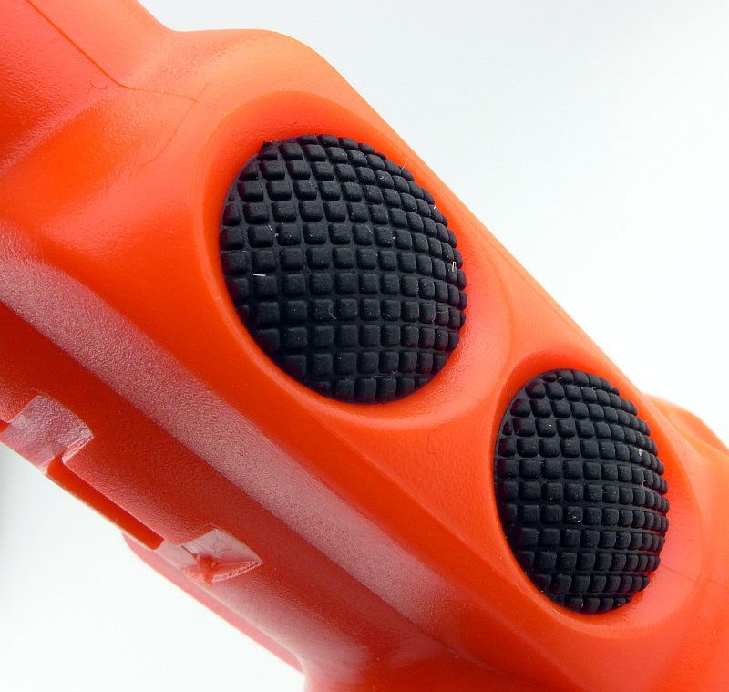

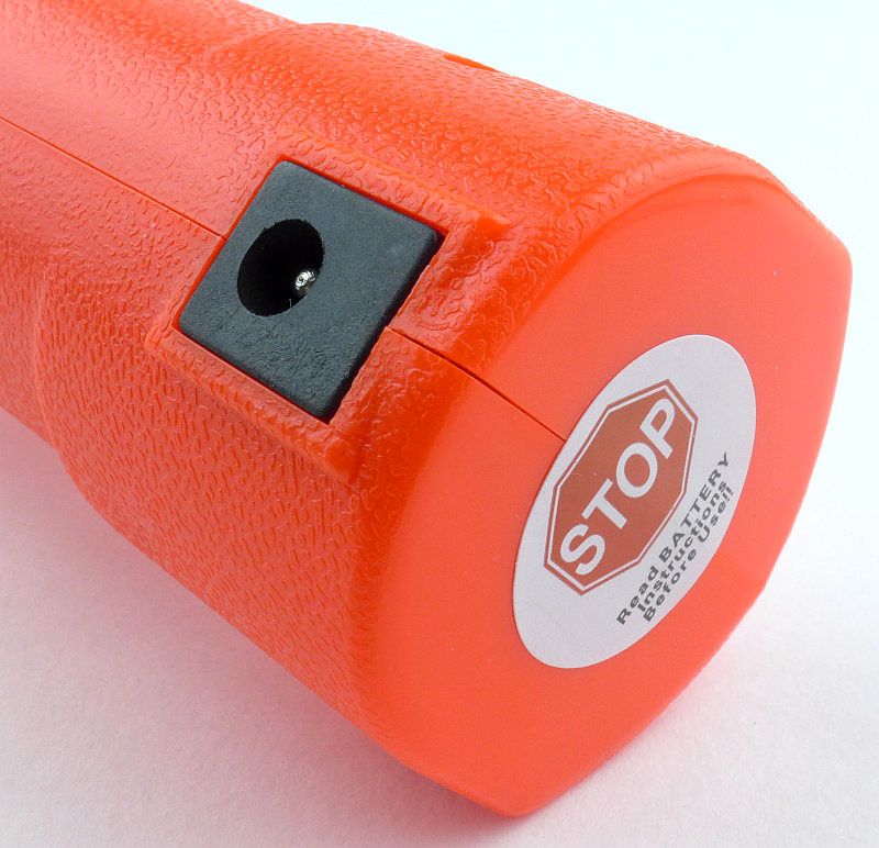

    On the back are the two switches and the charging port.
    The switch covers are textured rubber.

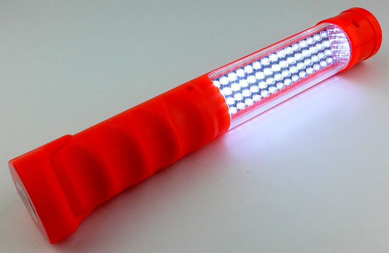

    Nightstick are great at using the latest LEDs (well better than many bulk producers) and this light has an XP-G2 LED for the spot beam.

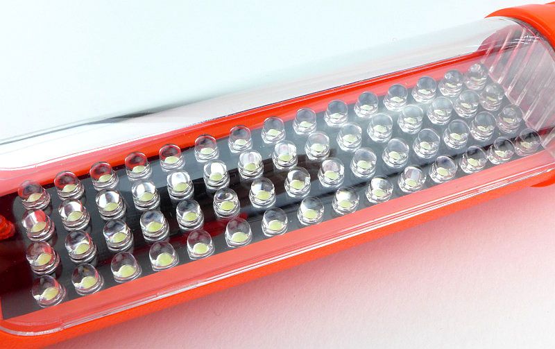

    For the flood beam there is an array of low profile 5mm helmet LEDs
    The flood beam LEDs are a very cold white.
    There is a warning to read the instructions before using the light to check the charging information. The charging port is a standard DC type socket.

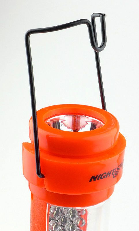

    The hook sits in a folded position against the body.
    And flips round 180 degrees to allow for hanging.

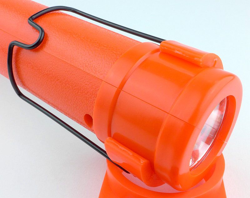

    The NSR-2492 has a flat base so will stand on its own.
    Next to the flood array, is a red charging indicator LED. While charging this is red, when fully charged it goes out.
    The mains charger specifications state it is an 8V output. The car charger has a 12V output, and Nightstick confirmed any input voltage between 8V and 12V is acceptable for the NSR-2492 to charge.

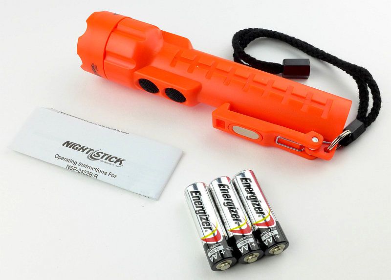

    Taking a more detailed look at the NSP-2422R Dual-Light with magnets:
    This is almost the same light as the Intrinsically Safe Dual-Beam XPP-5422G previously reviewed here.
    The light is supplied with a set of Alkaline cells and an instruction manual.

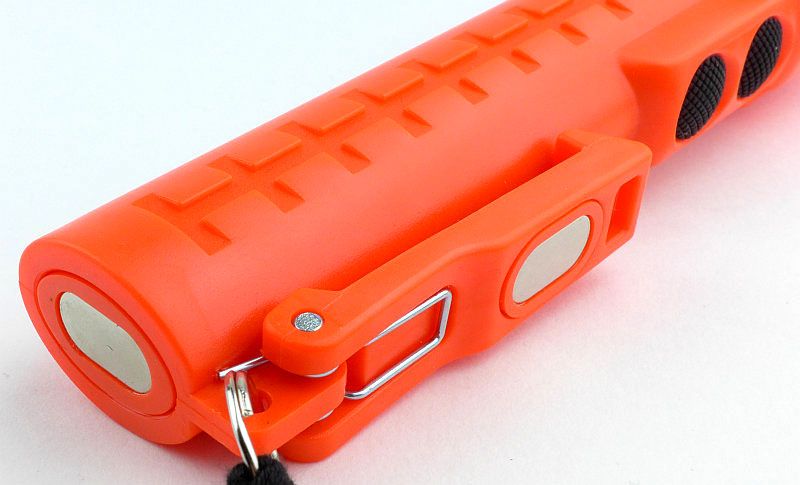

    The two magnets that add great versatility to this light. Very cleverly, the magnets are recessed a tiny amount to prevent the magnet itself touching the metal surface. Only the plastic of the light’s body will touch the metal surface (unless the surface is very rounded).
    There are Dual-switches for the Dual-outputs.
    The flood beam is emitted through a clear round window on the side of the light.
    Both LEDs are CREE XP-E2.

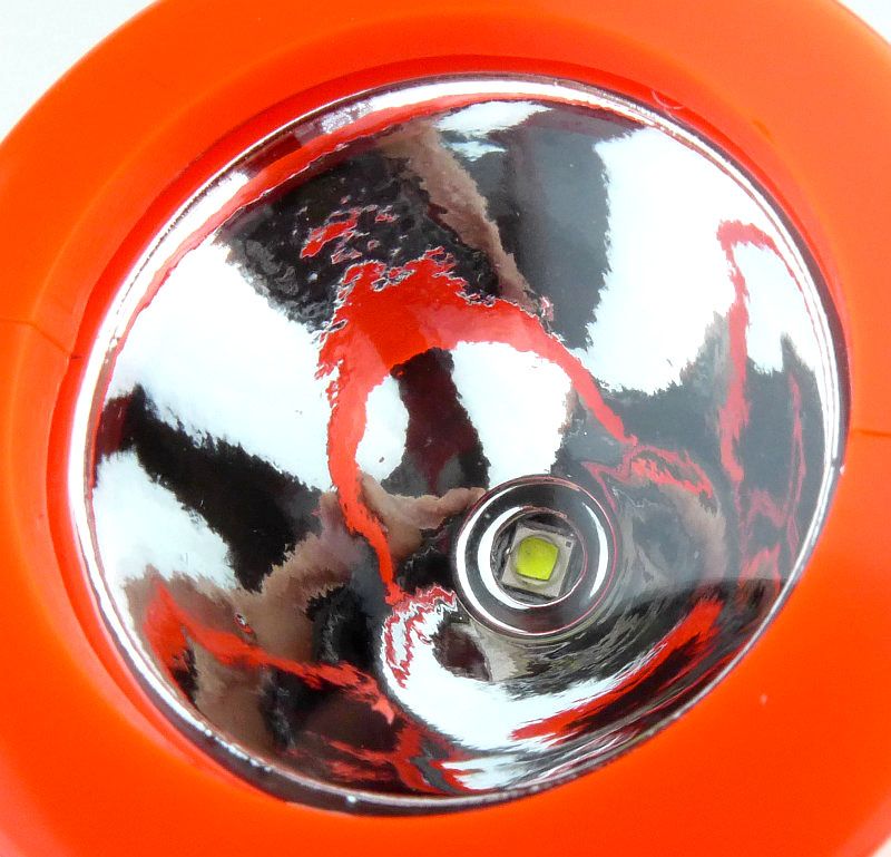

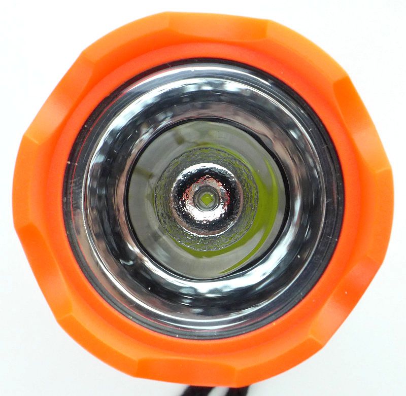

    Looking straight into the reflector, there is a textured part nearest the XP-E2 LED and the rest is smooth.

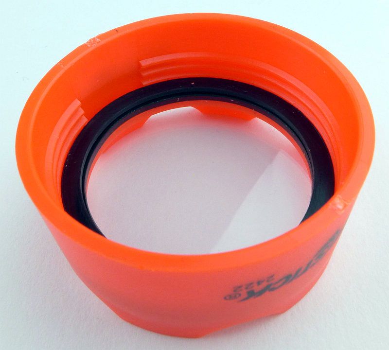

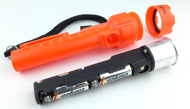

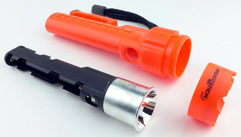

    Inside the casing is a one piece battery holder, reflector, driver and LED module. Effectively the outer housing is one a protective case for this insert. The insert functions fully when out of the case.

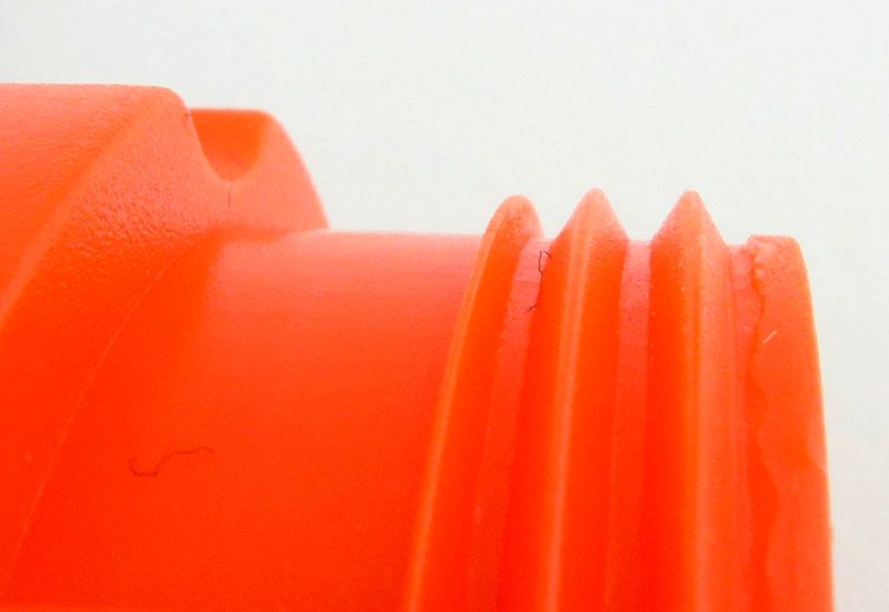

    A look at the moulded plastic threads.
    The corresponding threads in the head and the black rubber seal.

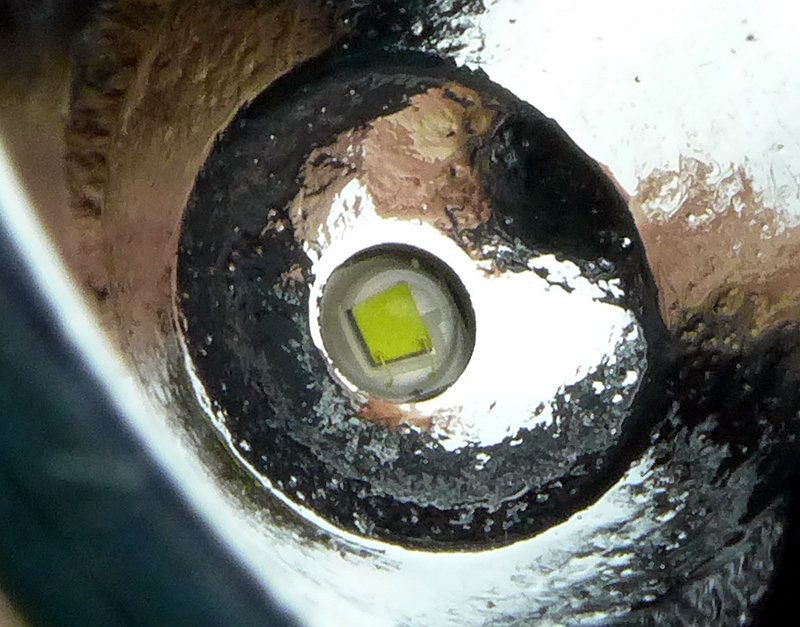

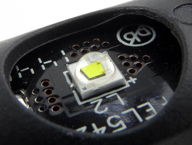

    An even closer look at the flood XP-E2 LED.
    And it is easier to see the spot LED when the insert is taken out of the housing.
    The dual-switches on the insert.

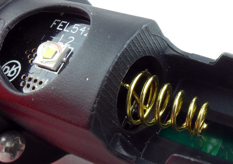

    The battery contacts are gold plated.
    Using three AA cells, these are arranged in 3S1P configuration.
    There is plenty of spring travel and this accommodated all AA cells I tried with no issue.
    After fitting all the cells into the insert, this can then be placed back into the housing ready to go.

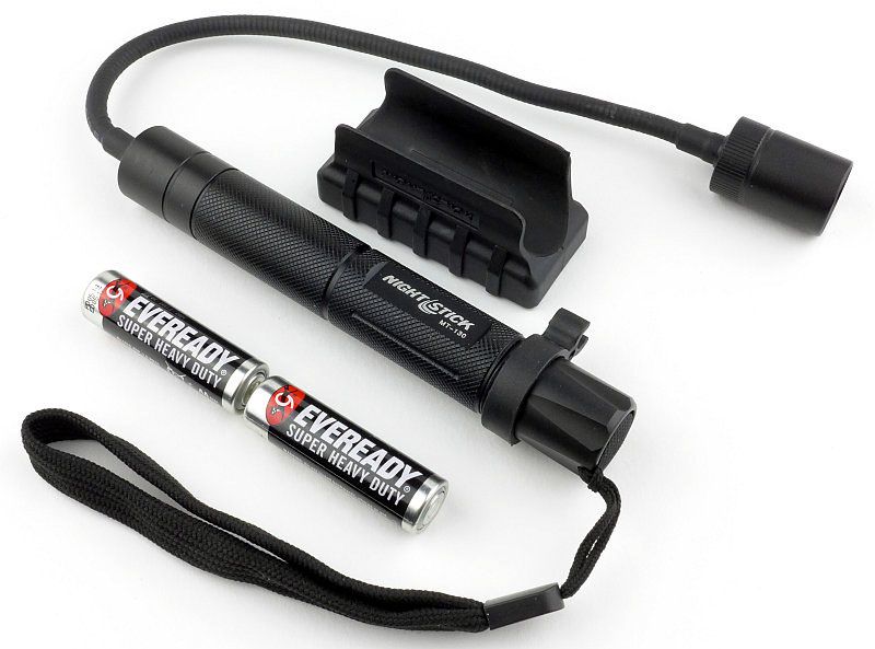

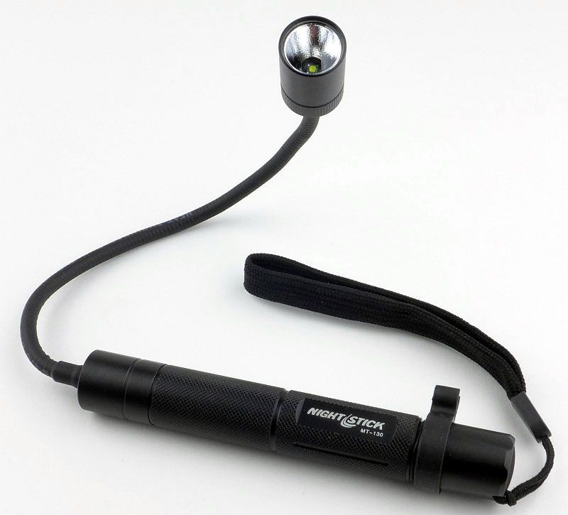

    Taking a more detailed look at the MT-130 Mini-TAC Gooseneck:
    Onto the last of this small group, the MT-130 Gooseneck. As it comes out of the pack, the TM-130 has the magnetic base clipped on and the flexible neck clipped back. Surprisingly the MT-130 was supplied with ZnC AAs. These are the worst type of AA cells only suited to very low power requirements, but Nightstick confirmed that these can be supplied with various lights instead of Alkaline cells.
    Popping the MT-130 out of the magnetic holder and freeing the neck.
    The contact surface of the magnetic holder is bare metal and the ceramic magnet. Not the most anti-scratch of surfaces.

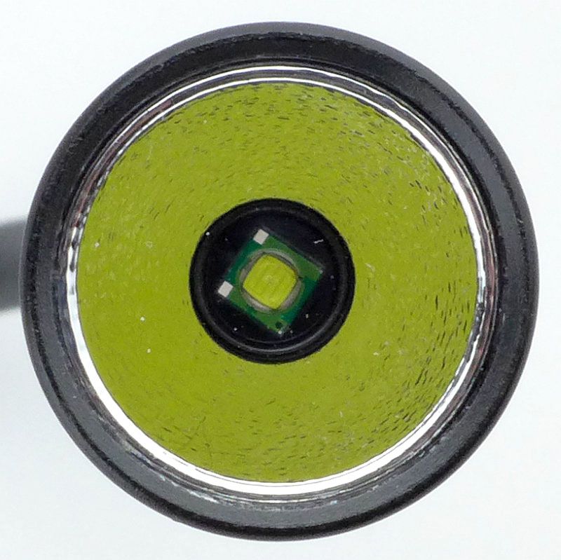

    Ignoring the flexible Gooseneck, the MT-130 has a very conventional 2xAA light body. With clicky tailcap.
    Again, a conventional head and reflector sits on the end of the flexible neck.
    In the centre of the textured reflector is an XP-G R5 LED.
    The gooseneck gives you a great deal of flexibility and means you can access areas other lights just won’t reach.

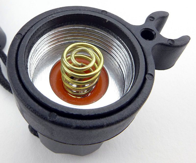

    The negative contact spring in the tail-cap.

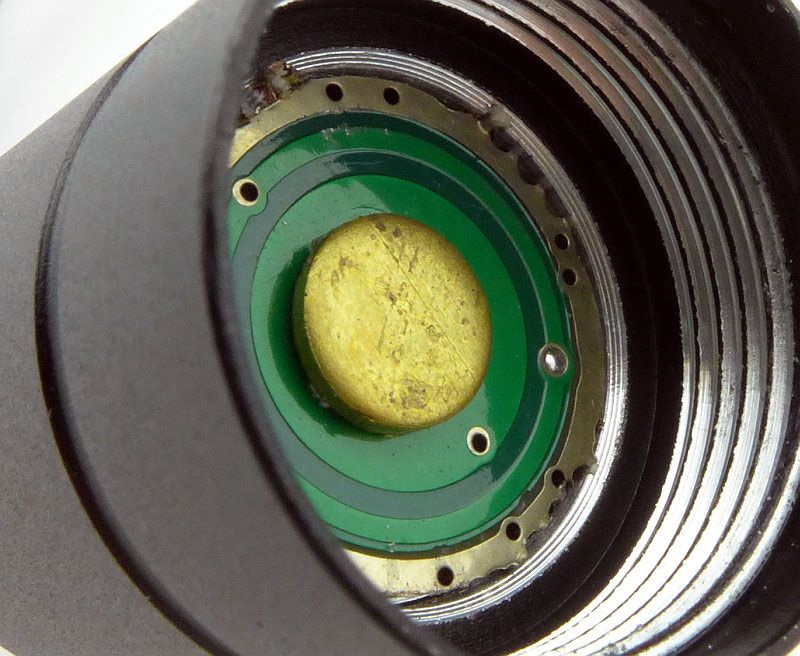

    After removing the battery tube the positive contact can be clearly seen.
    Out of the pack the tail-cap thread is a little dirty, however this does not affect the function of this light.
    The threads on the head end of the battery tube are cleaner.
    One flaw I came across was that when refitting the tail-cap, the o-ring is pushed out. If you take the tail-cap back off and go slowly you can then persuade the o-ring to stay in place, but it does need a prod with a finger nail.

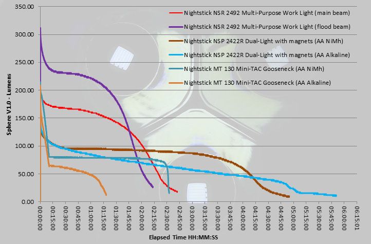

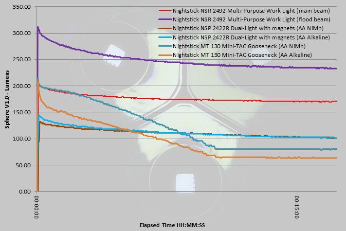

    The runtime graph shows outputs for the various options shown in the legend. This shows the relative performance of Alkaline and NiMh cells.
    Due to the overlapping lines, here is only the first 15 minutes to more clearly show the start of each trace.

    Personally I find the ‘NSP-2422R Dual-Light with magnets’ to be that perfect toolbox light. The two magnets give a range of mounting positions and the clip makes it possible to fix it in other situations. The choice of spot or flood beams allows for the right type of light for the job (spot vs flood makes a hug difference to every task).
