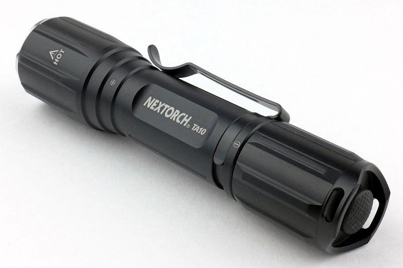

    The Ta10 packaging is very smart, and even has a metal hanger for shop displays.
    You get two spare O-rings, a wrist lanyard and the instructions along with the TA10.

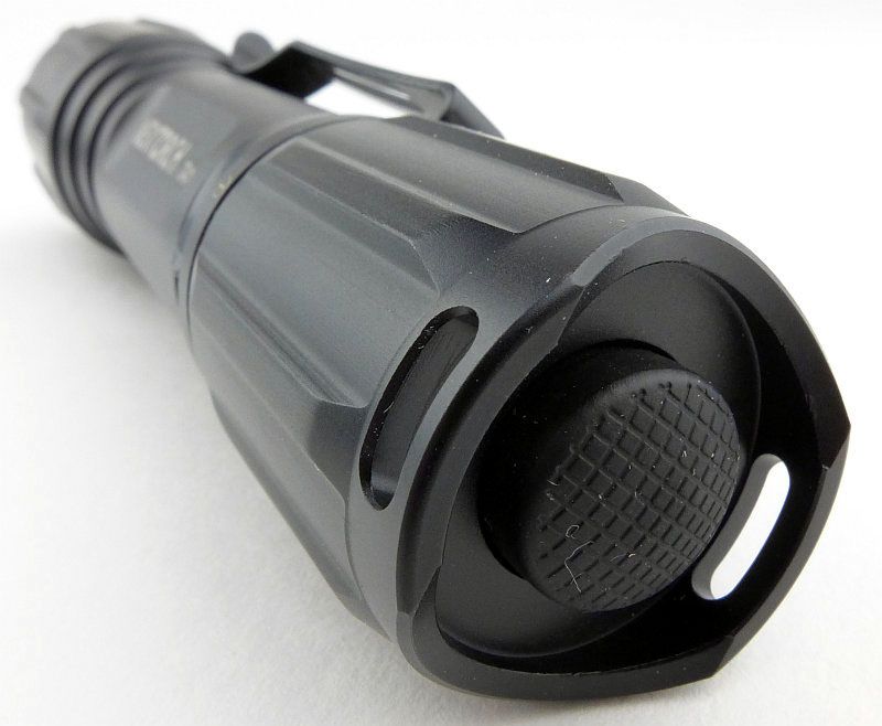

    The switch is semi-recessed so the TA10 will tail stand.
    The cell polarity is marked on the outside of the battery tube. A steel pocket clip is fitted to the TA10 when it arrives.
    All contact surfaces in the tailcap are gold plated.
    The threads are fully anodised and come well lubricated.

    As first reported in my reviews in relation to the TA40, Nextorch have a DUO-SWITCH which is also used on the TA10. Effectively this is a forward and reverse clicky switch combined.
    The DUO SWITCH gives you forward clicky momentary operation, but once clicked on gives you reverse clicky mode change capability. An excellent combination.
    From OFF you can access High or Strobe. For High press the switch. For Strobe double tap the switch.
    With either High or Strobe selected you can fully depress the switch and latch the output ON.
    When ON, you can access Medium, Low and High. Tap the switch to change down to Medium, tap the switch again for Low, and again for High.
    In simple terms the TA10 always comes on in High and once latched ON, you can access Medium and Low.
