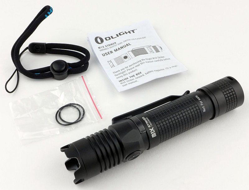

    The M1X Striker in its box.
    As well as the M1X you get two spare o-rings, wrist lanyard and the instructions.

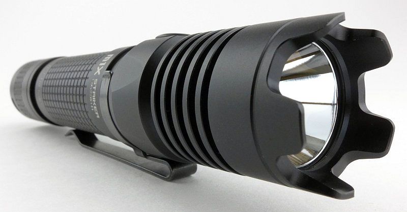

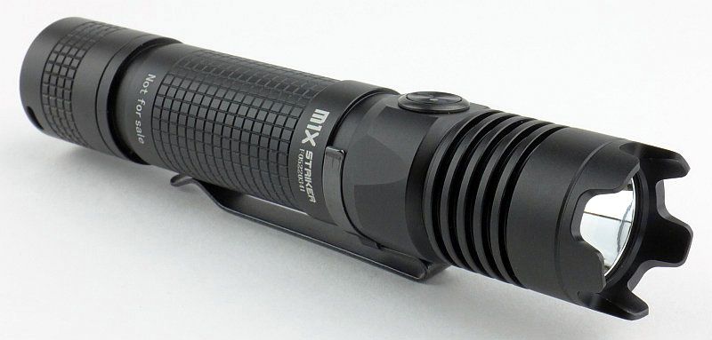

    Immediately you see why this is in the self-defence section.

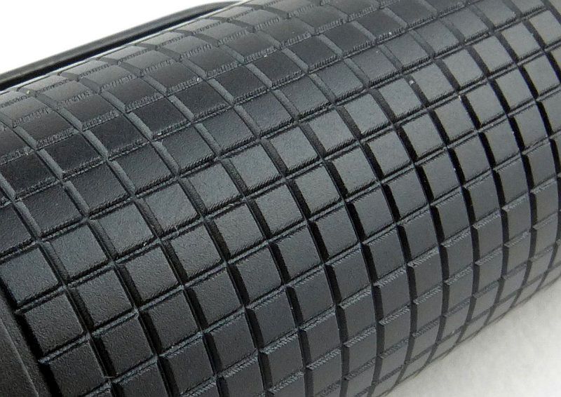

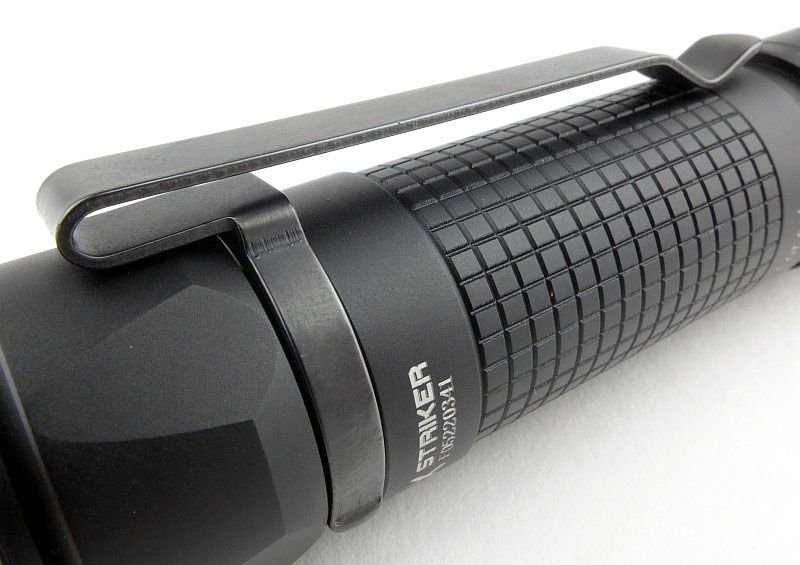

    Rather than traditional knurling, the M1X has a very nice pattern of squares cut into the body and tail for grip.
    A steel clip is supplied fitted. The clip can be taken off and fitted the other way round.
    The head has a set of cooling fins.

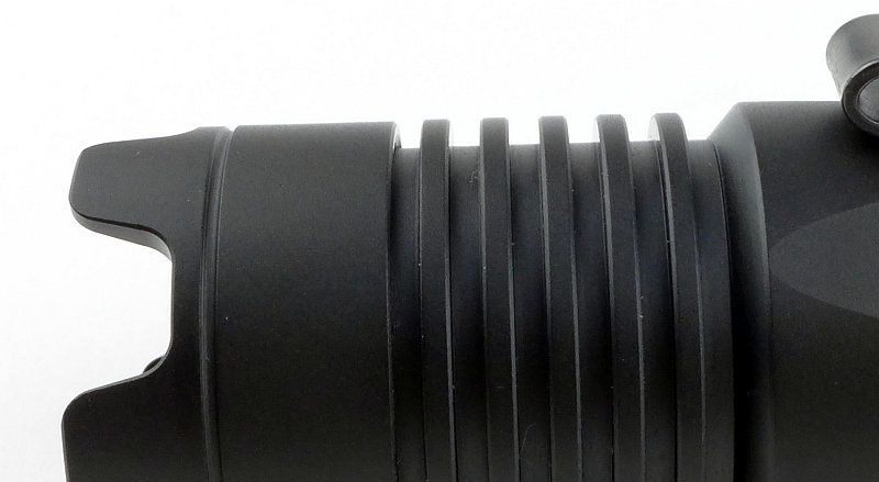

    And there is that strike bezel. Deeply cut, this is a very prominent feature. The bezel is not a screw in feature, on the front of the head, but is integral to the front section of the head. The front of the head is thread-locked into place as it does not want to unscrew.

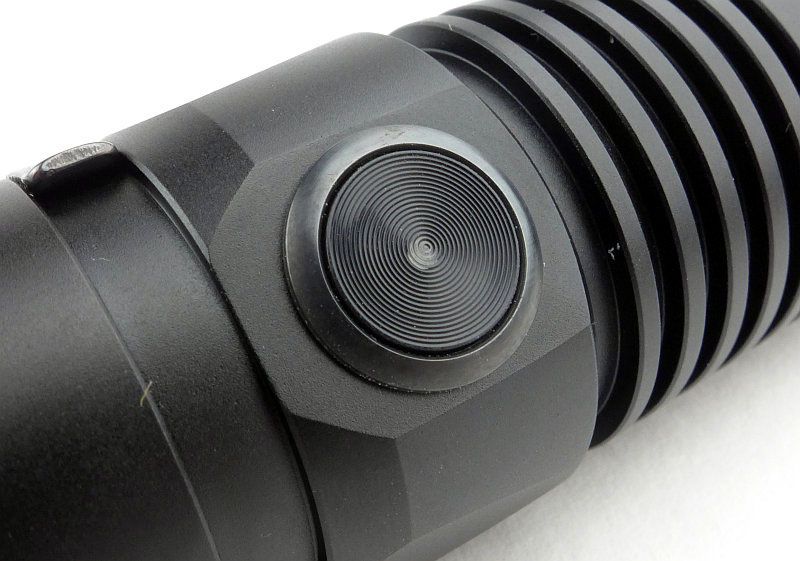

    The side switch is low profile.

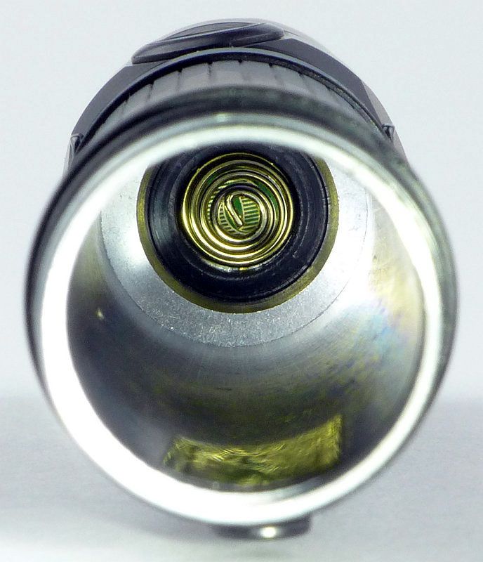

    Inside view of the battery tube and positive contact spring.

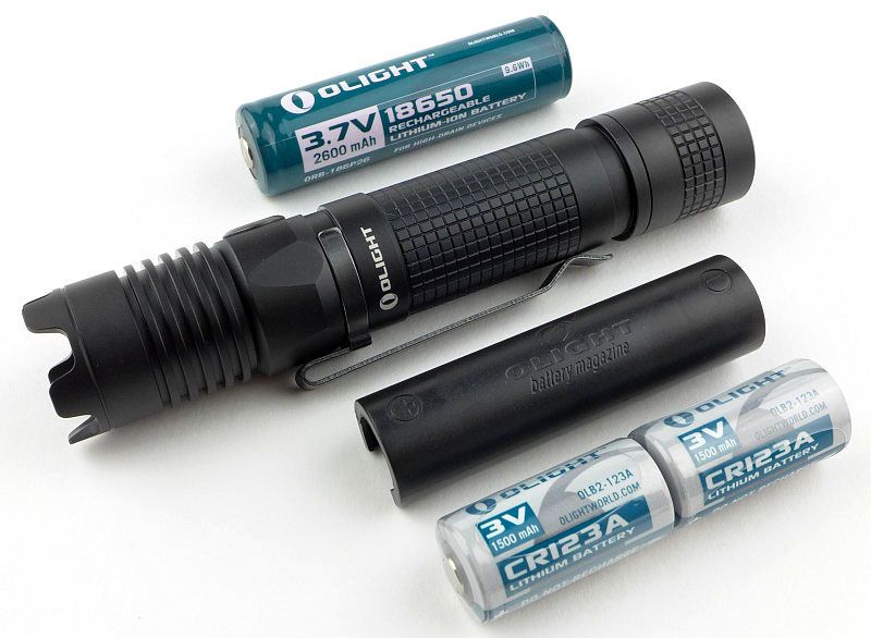

    A CR123 holder is supplied with the M1X to prevent cell rattle, or you can use an 18650.

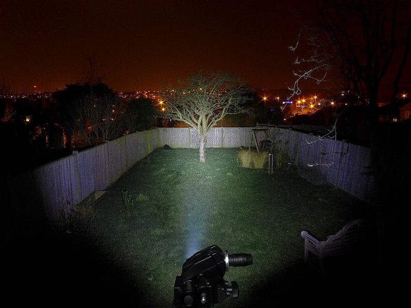

    The beam
    Starting indoors, it is obvious that the strike bezel affects the outer spill, with clear crenulations in the spill edge. Despite the height of the bezel crenulations, the spill is still wide enough for close range use.
    The hotspot is focussed enough to give good range, and wide enough not to give tunnel vision.

    The runs on 2x (R)CR123 or 1x18650.

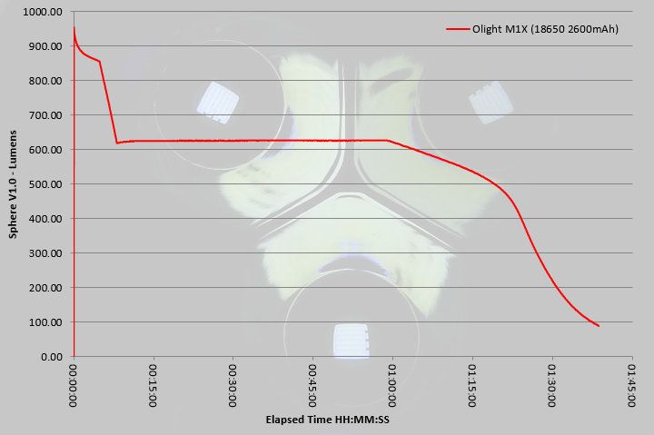

    Turbo output initially sags and then reduces to a steady 620lm after approximately 7 minutes. This is maintained until the cell cannot maintain that output any longer.

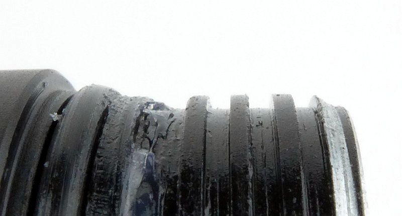

    I've customised this a little:

    For your information, the customising I carried out last night proved the M1X's bezel is tough as it took me far longer than expected to grind it down. I was using an 800W belt sander with a new 120 grade aluminium oxide belt and had to pick on one crenelation at a time to make any progress. I also had to take breaks to avoid heating the head too much.

    I finally got around to modifying my M1X. I didn't grind as much but left about 1/8". That was enough to make the light pocket friendly and much to my surprise really made it look a lot shorter.
    This link will let you view pictures of the moifications to the light.
