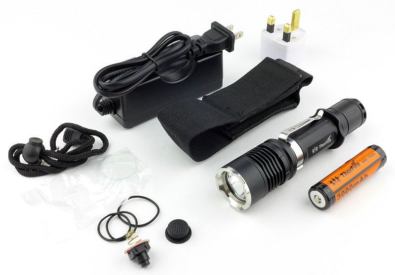

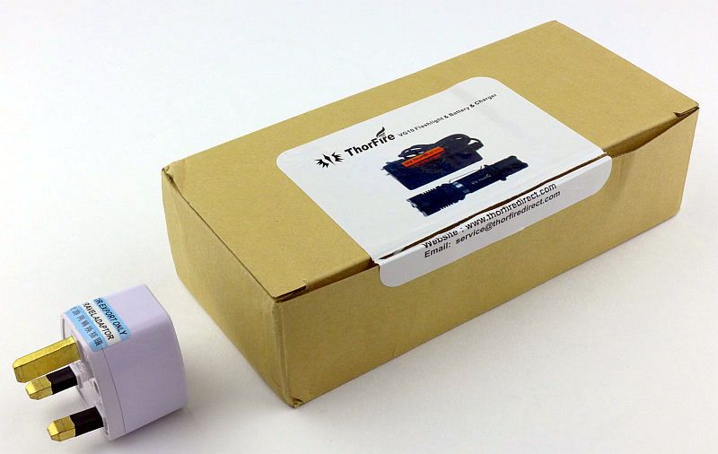

    As well as the boxed VG10 package a mains plug adapter was provided.
    The VG10 kit is comprehensive as you get the VG10, lanyard, spare lens, spare o-rings, spare switch boot, spare switch, holster, Thorfire branded 3000mAh 18650 cell and a basic 18650 charger (with US plug).

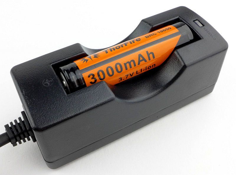

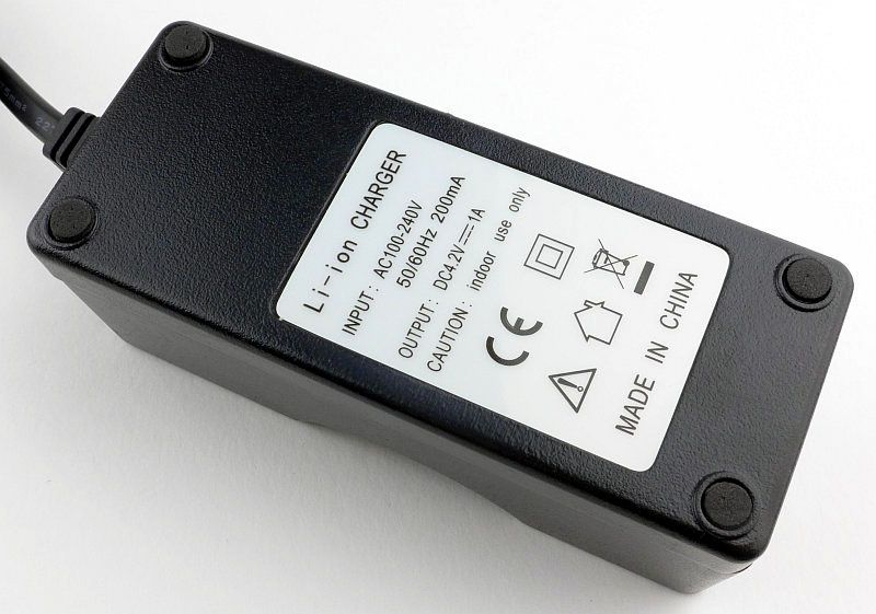

    The supplied charger is for a single 18650.
    This charger is rated at a 1A charge current.

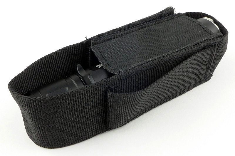

    The simple holster has a fixed belt loop.

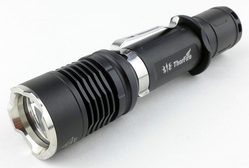

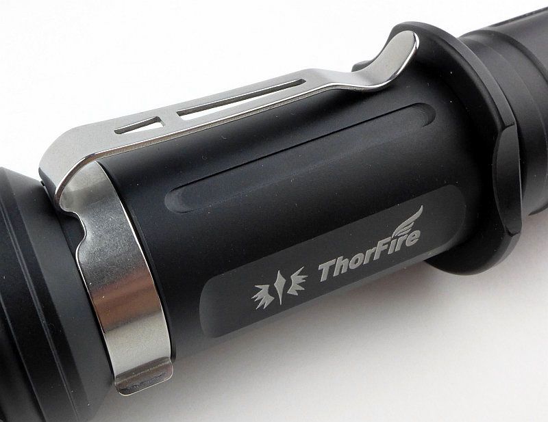

    Already fitted to the VG10 is a stainless steel pocket clip.

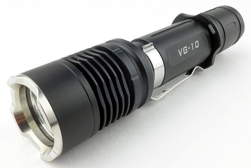

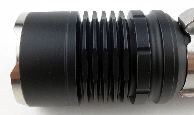

    The solidly built head has heat dissipation fins cut into it.

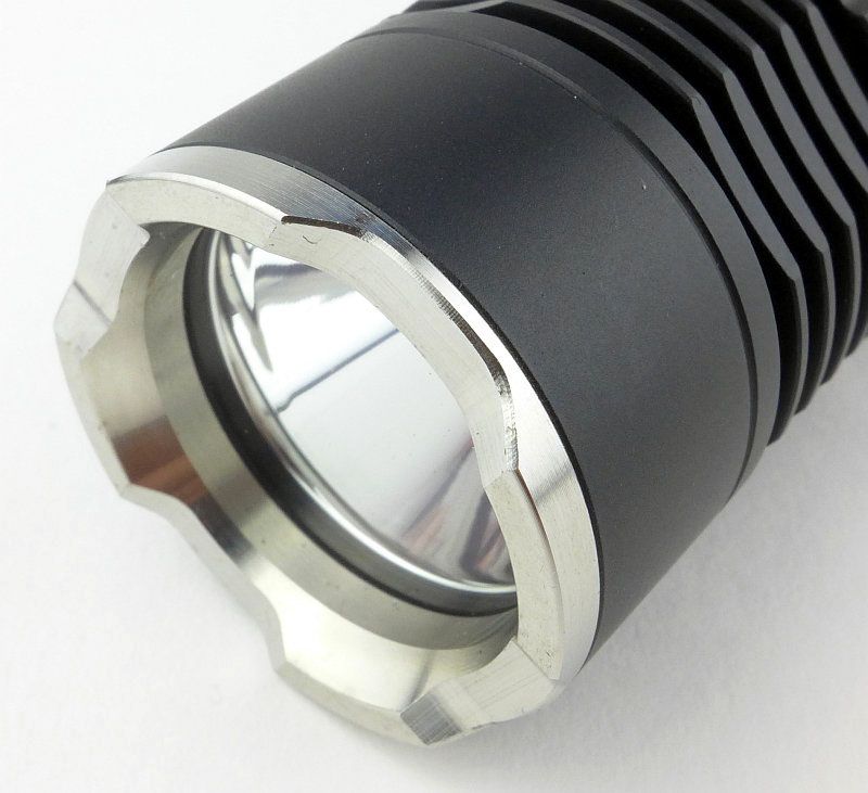

    The stainless bezel is cleanly machined and the outer rim has been bevelled to take off any sharp edges.

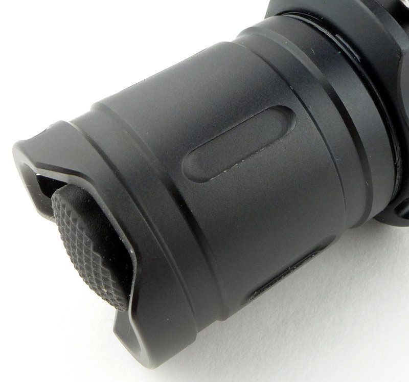

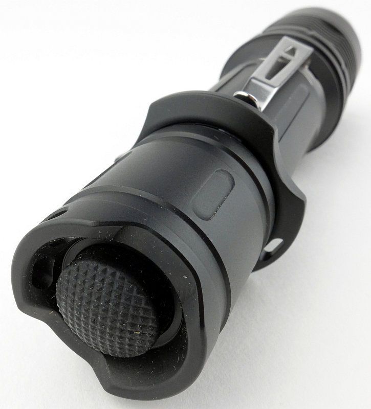

    You can see that the tail switch is semi-recessed.
    The switch boot does protrude a tiny amount making the tail standing slightly wobbly, but it does tailstand.

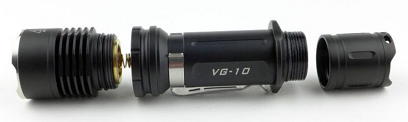

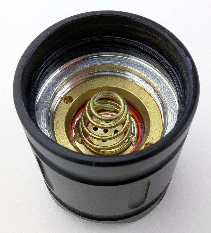

    A view of the tail-cap contacts and the switch retaining ring.

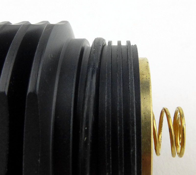

    Fully anodised square cut threads are used for the tail-cap. These come well lubricated.
    The battery tube also unscrews.

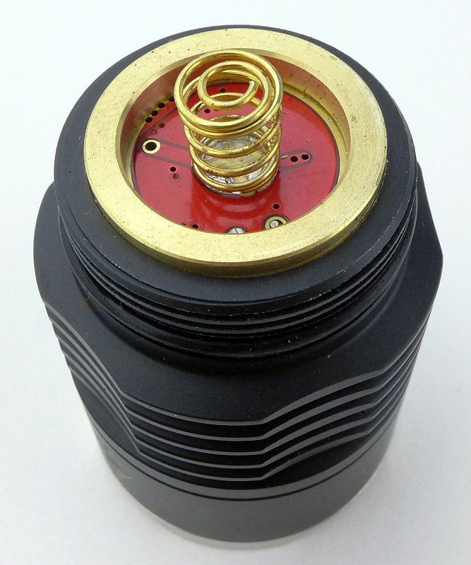

    Allowing us a close look at the contacts in the head.
    As with the tail-cap, the head end threads are square cut.

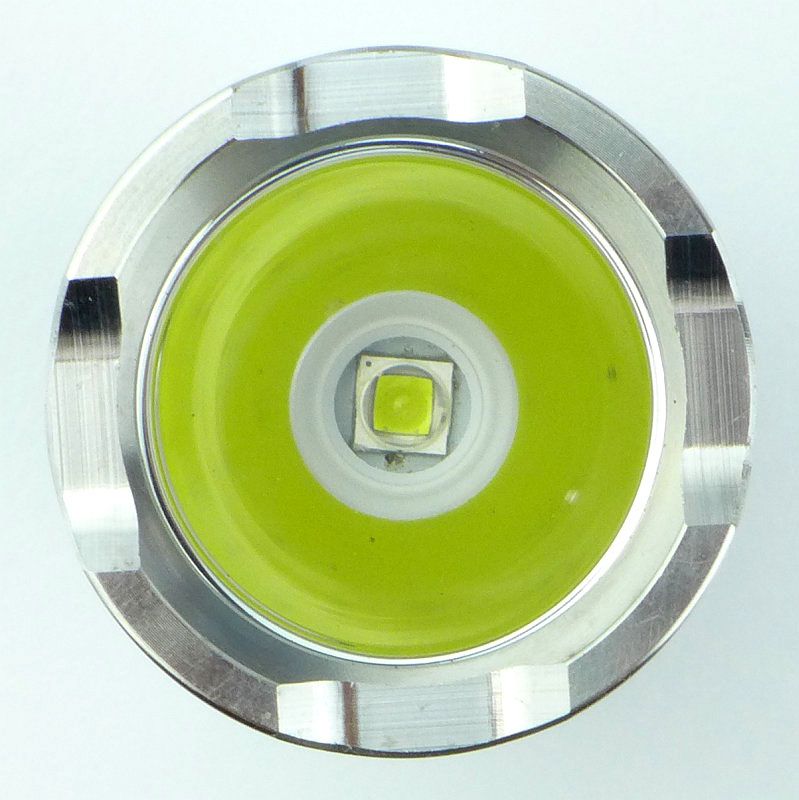

    An XM-L2 LED is used as well as a smooth reflector.

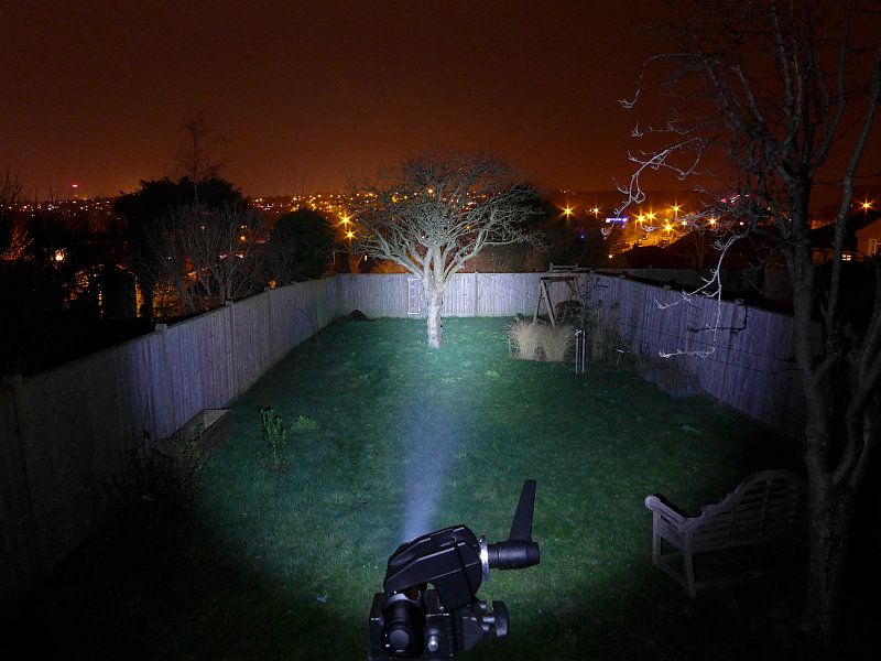

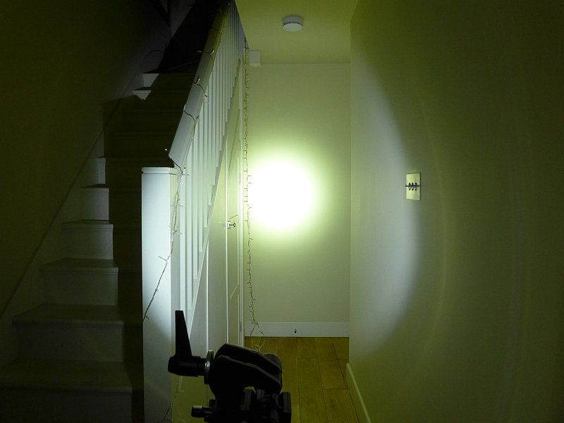

    As soon as you switch it on, you see a bright disc projected, as the VG10 has a focussed beam. Starting indoors, we can see the well defined hotspot and relatively dim spill. The stainless bezel has a minimal effect on the outer spill.
    And outdoors we see the hotspot giving a usefully wide brighter area. The spill, though dim, is still enough to give a broad view.

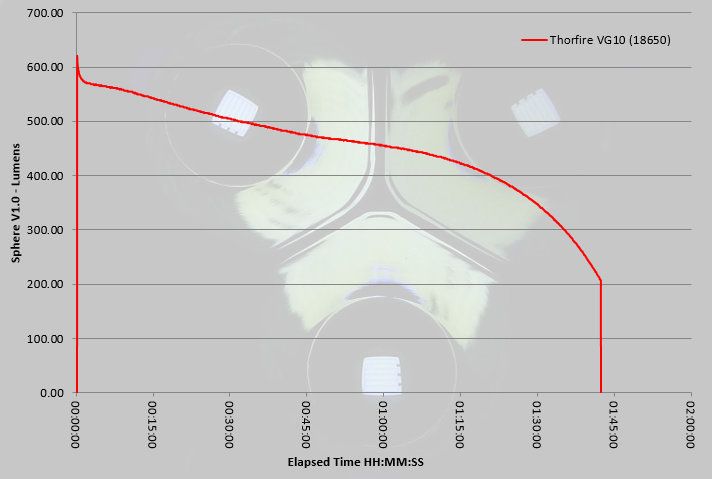

    Thorfire VG10 using Thorfire 3000mAh 18650 I.S. measured ANSI output Lumens PWM frequency or Strobe frequency (Hz)
    High 580 0
    Medium 245 3840
    Low 22 3840
    Moonlight Below Threshold (<1.7lm) 0
    Peak Beam intensity measured 7500lx @1m giving a beam range of 173m.
    There is no parasitic drain.
    There is no evidence of regulation as the output is in constant decline.

    There is one thing I'd like to say though, concerning the mains plug adaptor. I've seen one that looks very like it, and the one I saw didn't have safety shutters to cover the contacts when there's nothing plugged into it. The shutters are required by British Standard (BS 1363), to prevent small children poking metal objects in and making contact with an energised circuit.
    If you get one of these adaptors, please check for the safety shutters, especially if you have small children or might be visited by people who do.
    I've posted more information on what to look for here:
    http://www.candlepowerforums.com/vb/...UK-mains-power
    An interesting observation regarding the universal adaptor. It is a tricky one. The UK style shutters rely on the Earth pin to unlock the Live and Neutral. Even this is not ideal as in domestic environments Earth is not really Earth and is normally shared amongst several neighbouring houses (so if you short something to Earth, your neighbours get a voltage spike on Earth). I would think that in order to be able to make working shutters you would have to make a dedicated adaptor for that plug, so you now end up with several different and more expensive adaptors. The one included with this light is also useful in that it accepts EU and UK plugs as well which means I don't have to take it out of the socket to use different devices.
    It is very worthwhile being aware of the dangers to small people and like many other hazards around the home, parents need to be aware and take measures to protect their children. This involves asking people they visit to consider any potentially dangerous items. Unfortunately we can't make everything 'safe' in life and people need to understand 'danger' and have a respect for kitchen utensils, tool, bulb sockets etc.
    I'm not an expert on standards, but I suspect that fixed wall sockets need to meet British Standards as these cannot be removed to make an area 'safe' whereas adaptors can be removed.
    We are all responsible for our own safety and to have an awareness of the potential dangers and consequences of our actions and choices.
    Several of my reviews have included these style of adaptors, and I've got two in the draw next to me as I type this.
    Though these adaptors do not appear to be intrinsically dangerous (when used as intended they should not present a hazard), thank you for highlighting the potential danger.
