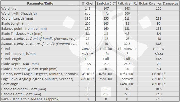

    Most knives specifications have a basic description of the blade geometry, but in this section I will be taking a more detailed look at geometry and balance.
    Using a set of gauges and precision measuring equipment including a Vernier protractor, callipers, fixed radius gauges and the unique Arc Master adjustable radius gauge (the one that looks like a crossbow).
    These measurements have been tabulated and are presented along with a few reference blades (8" Chef's Knife, 5.5" Santoku and the popular Fallkniven F1).
    Key aspects such as the primary bevel angle, grind type, blade depth, blade thickness, length, weight are detailed, along with balance information.
    The 'Balance relative to the front of the handle' tells you if the knife will feel front heavy, or if the weight is in your hand (a positive value means the weight is forward of the front of the handle). The 'Balance relative to the centre of the handle' indicates how close to a 'neutral balance' the knife has in the hand.
    In the case of full convex grinds the approximate centre of the grind is used for the primary bevel angle estimate.

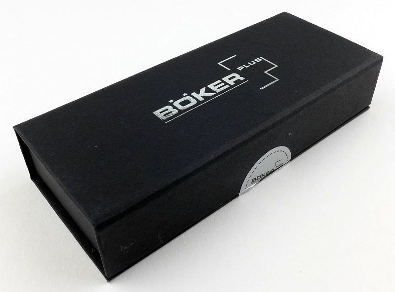

    The Kwaiken folder arrives in a sealed presentation box.
    The box lid is held closed by a magnetic catch, and the knife is plastic wrapped and held in a foam liner.

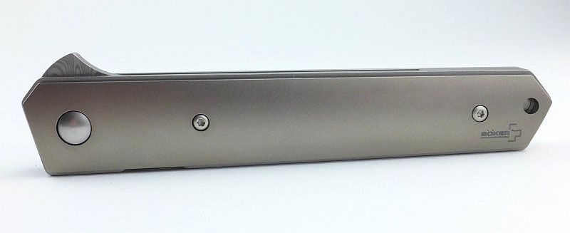

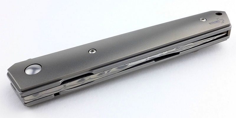

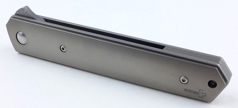

    The first full view of the super sleek Kwaiken flipper fresh out of the box.

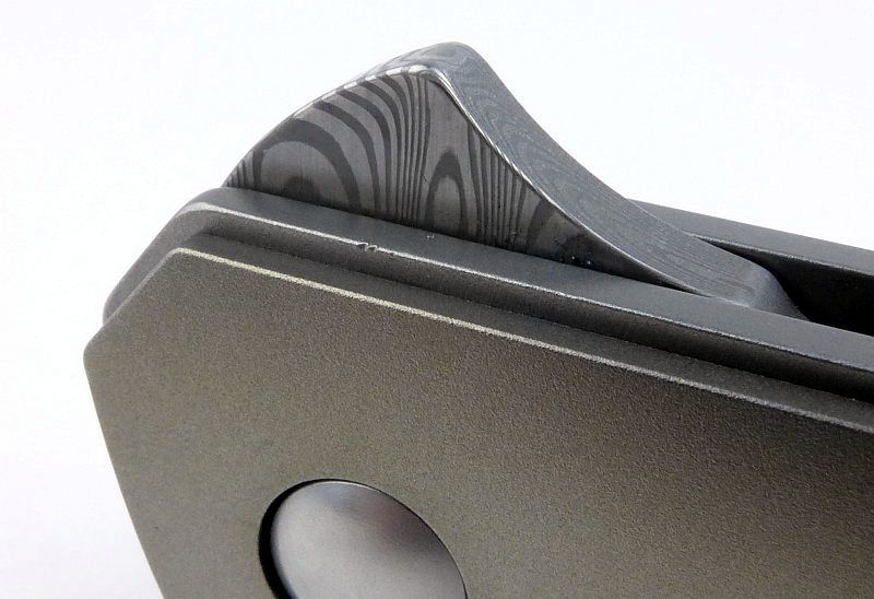

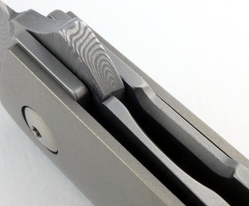

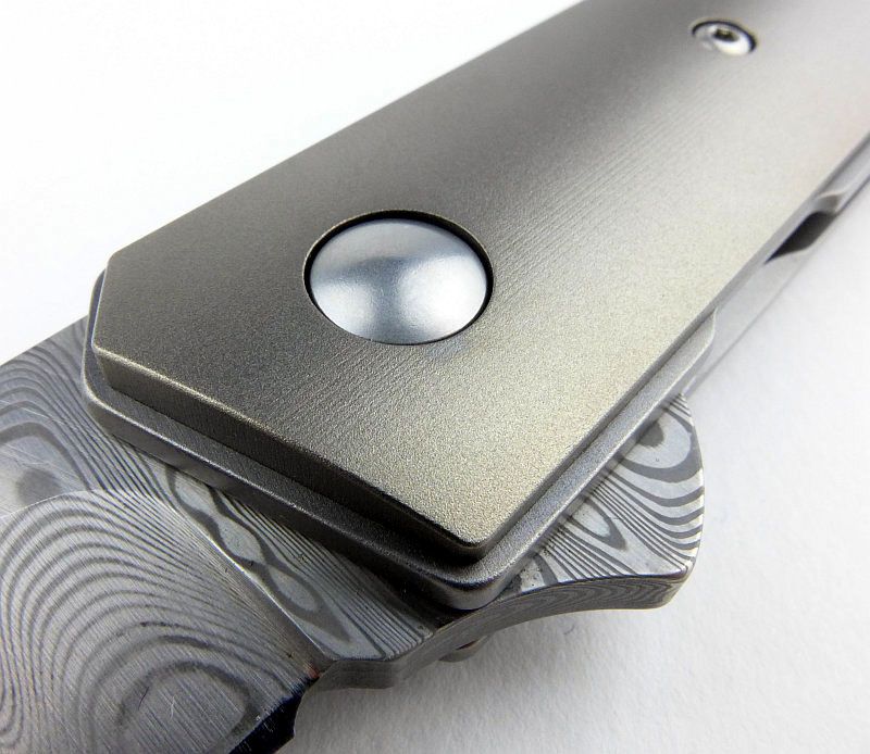

    A couple of hints of something special. First the flipper is clearly Damascus steel, and secondly, the folded knife is sitting upright with the blade opening downward – not something you can do with most folding knives. Oh and let’s not forget the Titanium scales.
    Yes that definitely is Damascus.

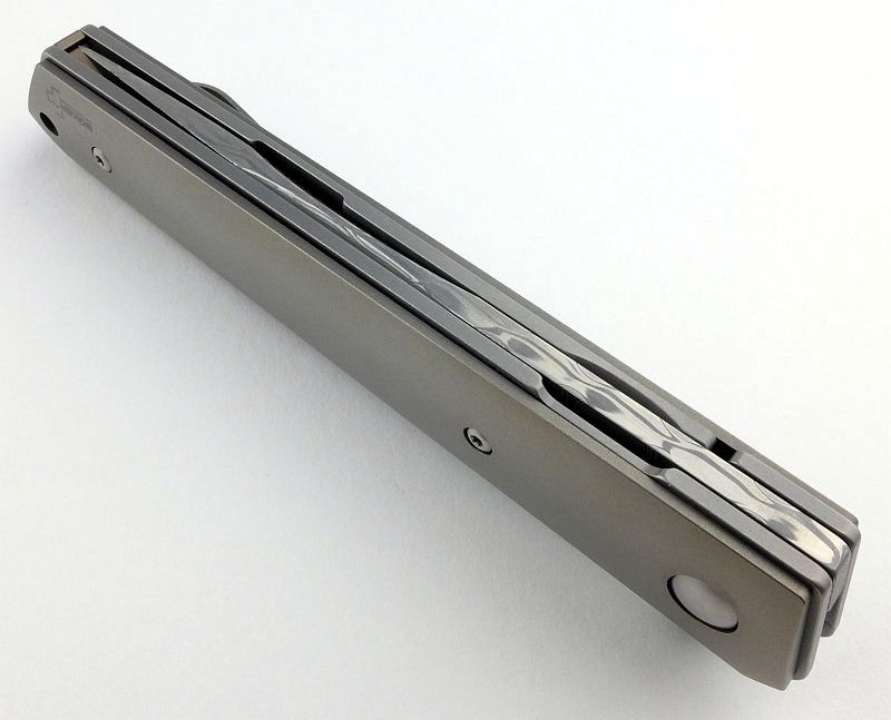

    Turning it over to look at the spine of the blade and you can see it sits flush with the liners giving a completely flat profile. The only part of the blade protruding from the handle is the flipper.

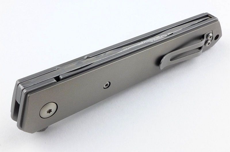

    The small pocket clip is steel.

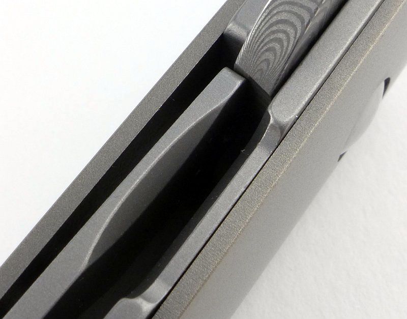

    Looking down into the handles, there is still something we haven’t seen, a stop pin. This is because the Kwaiken folder uses a hidden stop pin which runs in a slot cut into the blade tang near the pivot, allowing it to be totally out of sight.

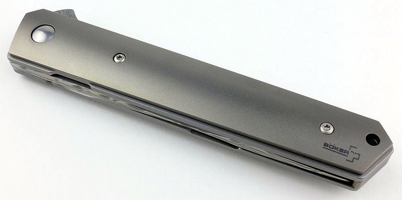

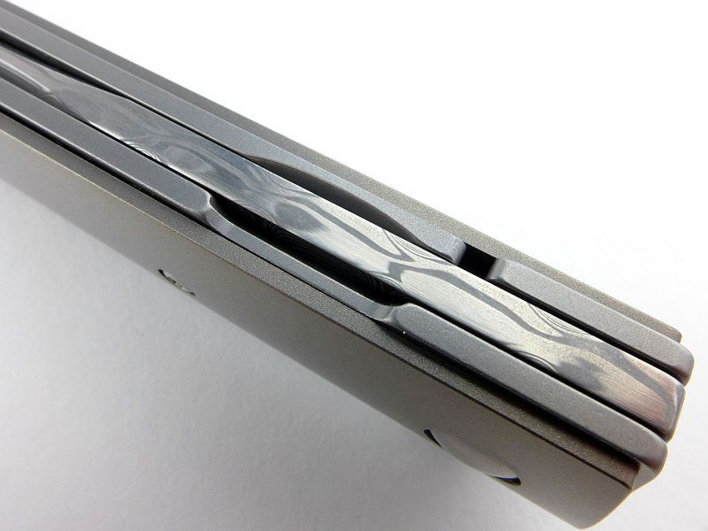

    We can start to take in the details on the blade-side of the handle. The spine of the blade shows the Damascus pattern etched into it along with some sculpting. There is also the liner lock detail from its spring section to the lock release cut-out.
    Moving closer there is just a small cut-out to give just enough access to the lock bar to release it, and the lock bar has a shallow bevel to ‘ease’ the corner of the lock bar where you press on it.
    Two long scallops on the blade spine sit near the thinned liner which acts as the lock bar spring.

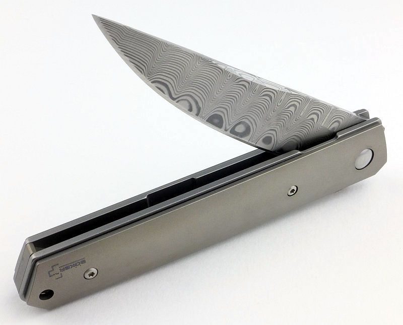

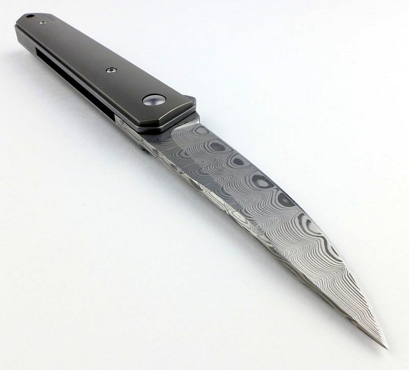

    And the blade emerges…
    …allowing us to take in the beauty of that Damascus blade. The etching of the blade brings out the layers, but you can see how the polished edge conceals those layers. (To those not familiar with Damascus steel, it is only the etching that shows the layers, otherwise it would look no different.)
    This image has several details of note. The blade has a sharpening choil – this is a favourite feature of mine. The entire blade side is etched including the flipper (the effect this has will be discussed later). You can see some diagonal grinding line remnants on the blade flat as well as some machining lines running along the Titanium handle scales.

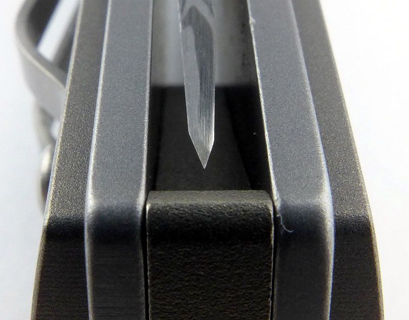

    Looking very very closely at where the point sits when the knife is closed, you can see it is the tiniest bit off centre. However, for some reason this photo makes it look much worse than to the eye. You can also see a slight unevenness of the final edge bevel, but these are tiny details magnified significantly.

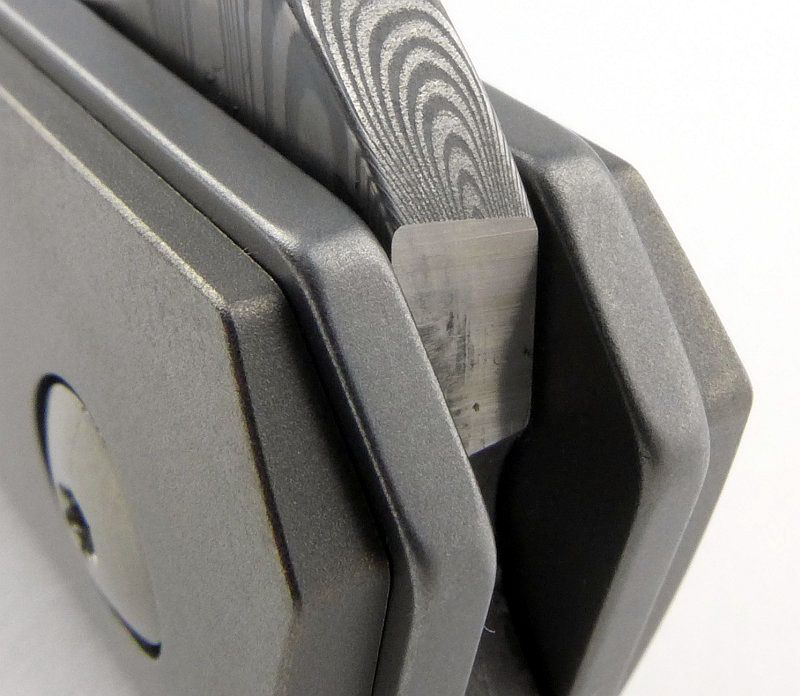

    Now to concentrate on the lock and its engagement. Here the full lock-bar is shown from where it bends inward at the thinned section of liner, to the lock surface.
    The lock bar does not quite get to the centre of the blade.
    A view from the other side.
    Having operated the lock quite a few times a set of marks show on the blade’s lock surface giving a better indication of the contact point.

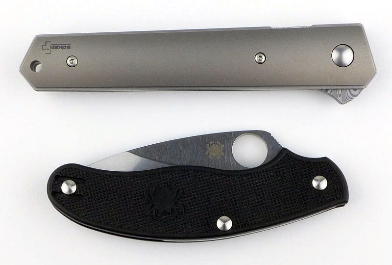

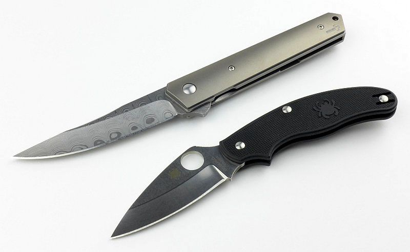

    To give an idea of scale, the Kwaiken flipper is being shown next to a UKPK FRN. Also notice again the fully enclosed blade unlike the UKPK.

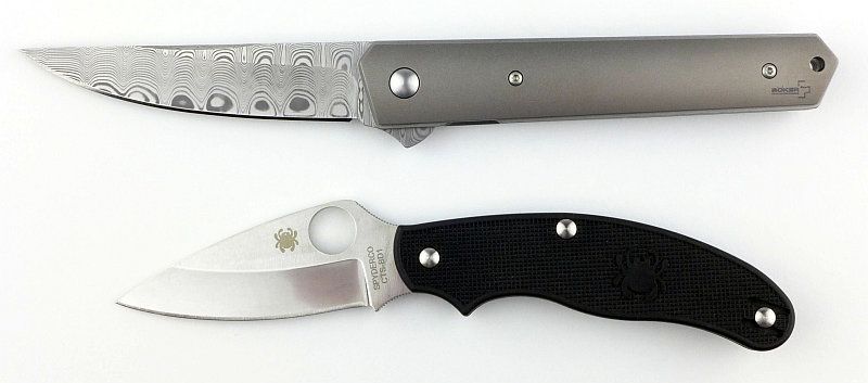

    And with the blades open. Compared to the UKPK with its contoured grip, finger choil and negative rake, the Kwaiken looks straight, stiff and not very ergonomic, but don’t be misled by this. Actually it sits very well in the hand, not for extended periods of heavy cutting, but for general EDC work it is fine.

    In the Blade and Handle Geometry section and the table of parameters you will find the 'Balance relative to front of handle' and 'Balance relative to centre of handle' which tell you by measurement exactly where the balance is.
    In this case it is 48mm behind the front of the handle and 13.5mm forward of the centre of the handle. So this means that the weight you feel is more or less in the middle of the handle so the knife weight is 'in the hand'. You can open your hand and the knife will sit on your fingers without tipping forward.
    This is due to the weight of the handle and makes the Kwaiken flipper feel very manoeuvrable.
