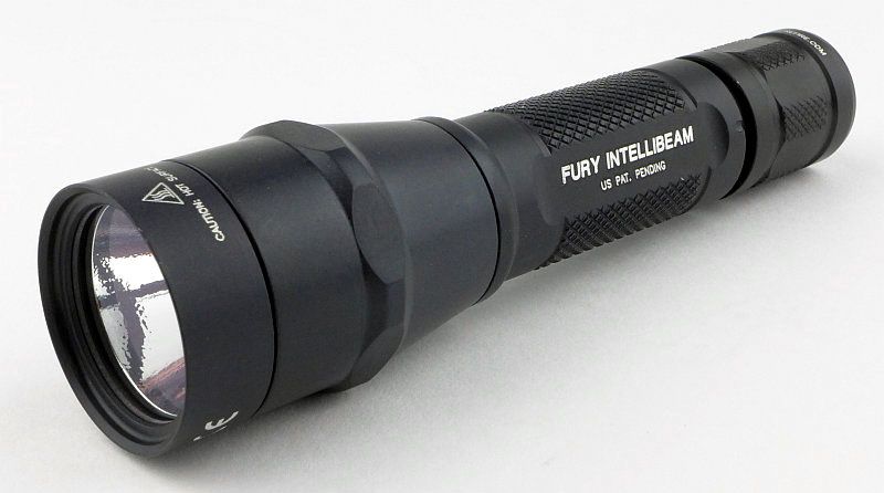

    The P2X Fury Intellibeam with a couple of Surefire accessories used in the review, the FM44 flip-up diffuser and V25 holster.

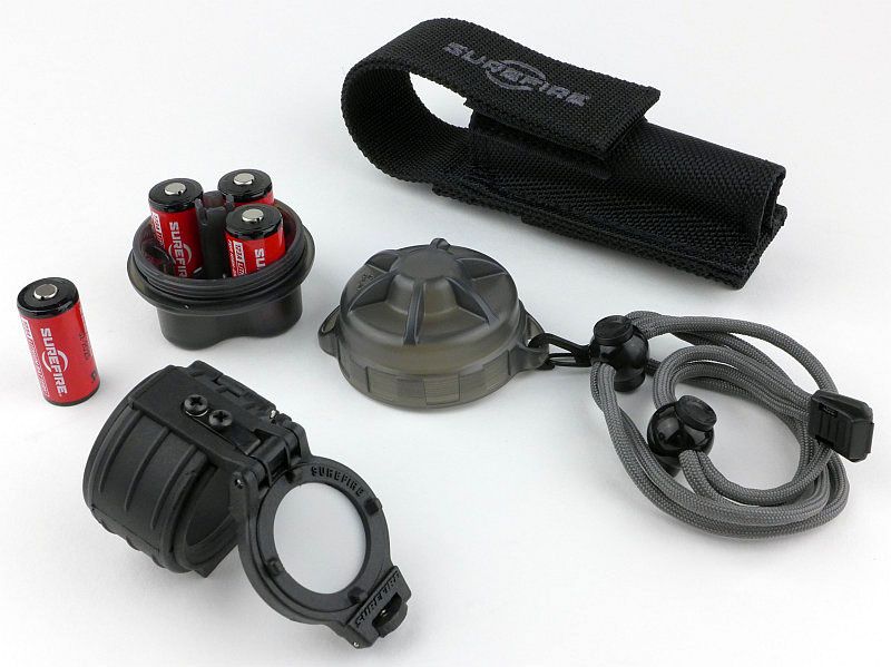

    These are all the extras used during the review.
    Surefire’s FM44 flip up diffuser is a heavily engineered accessory.

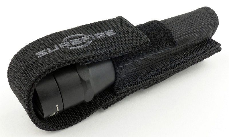

    The optional V25 holster is a robust and functional holster.
    Unlike most holsters with fixed loops or Velcro loops, the V25 has a steel spring clip designed to make fitting easy while resisting accidental removal.

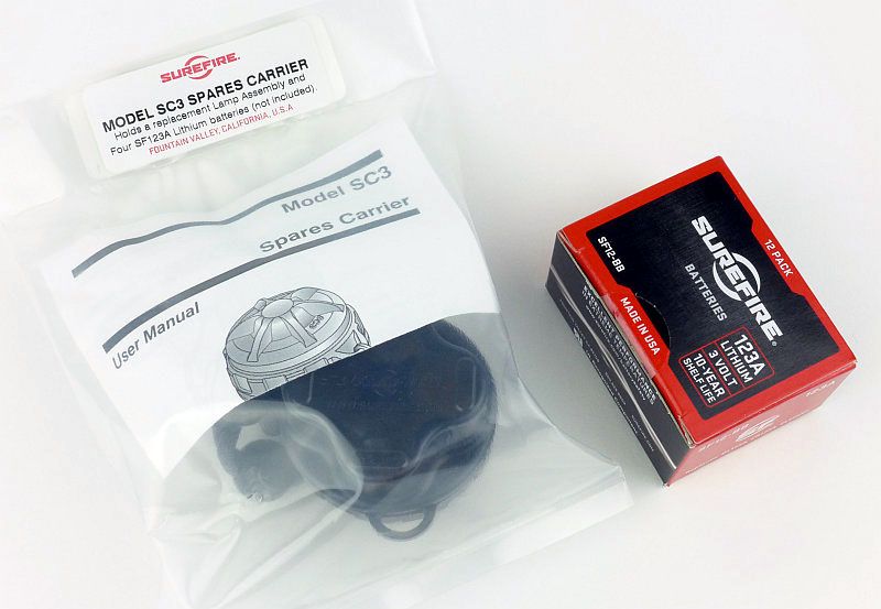

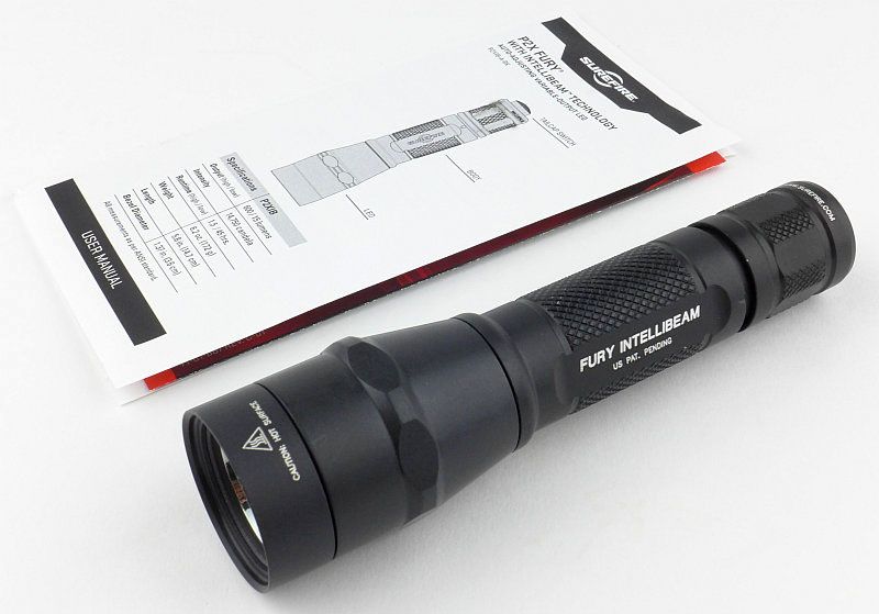

    With the P2X Fury you get the light itself, a set of Surefire CR123s and the instructions.

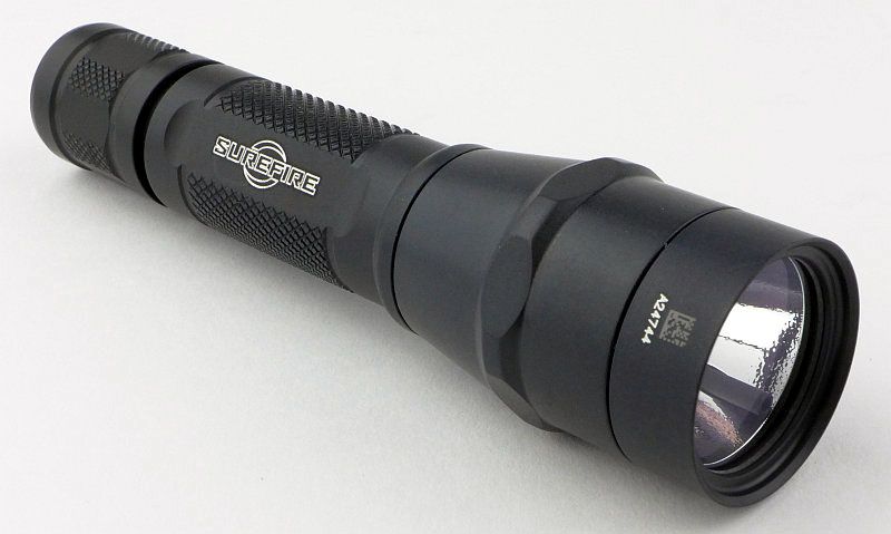

    Each light has a serial number, and if you look closely at the reflector you will see a sign of this being the Intellibeam model.
    A tactical tailcap is used with protruding forward-clicky switch.
    No tail-standing with this light, but the switch is easily accessible.

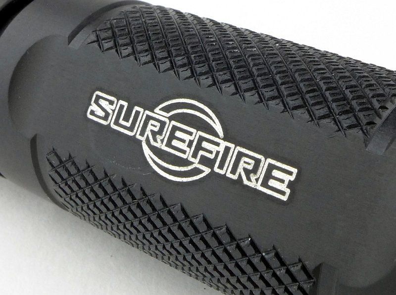

    The Surefire logo is nicely engraved through the anodising without going too deep.

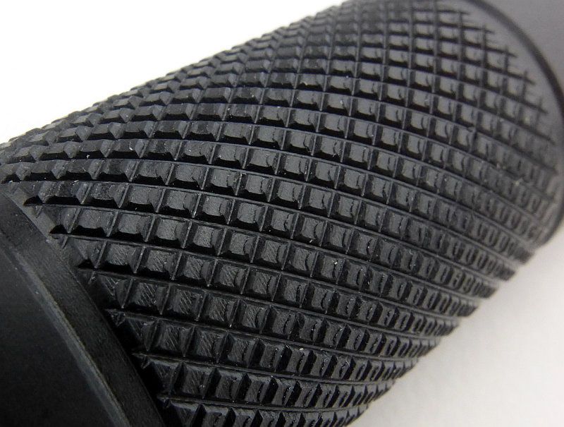

    Its knurling is rolled, and there are unshaped crests left from the rolling process which actually add to the grip available, making the knurling very effective.

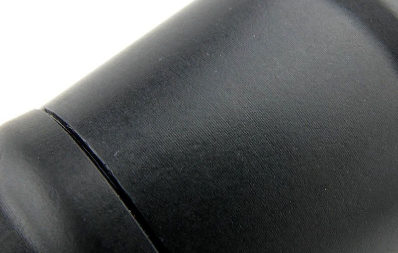

    In this photo I was attempting to show the quality of the surface, but it does not show exactly what I intended. The surface of the P2X looks as if the bare aluminium has been stonewashed and then anodised. The effect is a slightly matt surface (with reduced reflections) which feels more refined than the majority of anodised aluminium lights. The faint machining marks which you can see here are not visible to the naked eye and you need a loupe to see them.

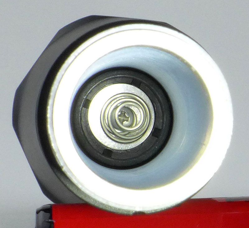

    Inside the tailcap is the negative contact spring and a set of three copper coloured contacts that touch the end of the battery tube.
    The threads are a cleanly cut standard thread of a good depth. If you look at the far right of the photo you can see there is an insert in the end of the battery tube.
    Peering into the battery tube for a look at the positive contact spring.

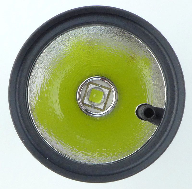

    A Cree XM-L2 LED sits in a textured reflector, and then there is that extra feature - the Intellibeam sensor tube.
    The Intellibeam Sensor tube is a black plastic tube which protrudes through the reflector and right up to the glass lens.

    For a sense of scale, the P2X Fury Intellibeam is shown next to the 2x Surefire CR123 cells and an AW 17670 li-ion cell.

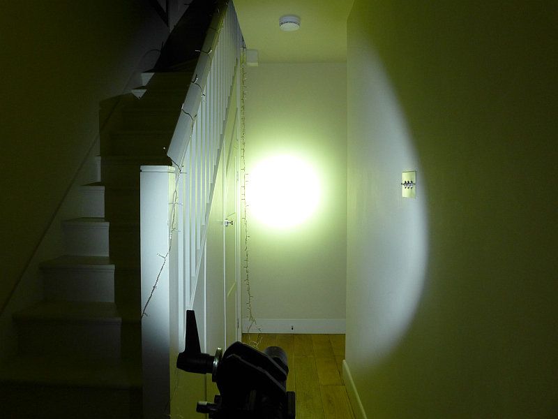

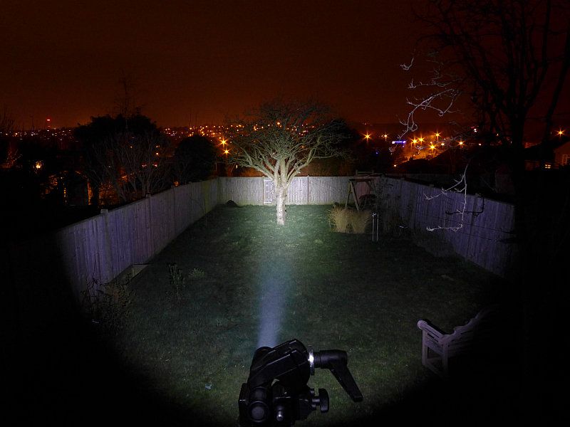

    Starting indoors, and the P2X Fury has a reasonably broad hotspot and smooth spill. Not shown in this photo is that fact that at the edge of the outer spill the sensor-pipe artefact can be seen. In general use you don’t really see this though it is more noticeable at very close ranges. And if you rotate the light.
    The hotspot is broad enough to give you a useful view at middle distances but still has a good range.

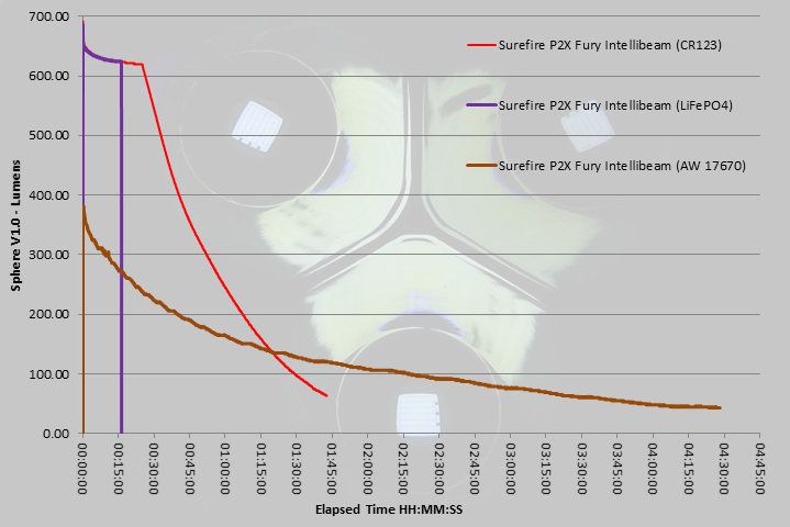

    Altogether the P2X Fury was tested with three types of cell (NOTE: li-ion 4.2V RCR123 cells cannot be used with this light so are not included). Surefire CR123 primary cells, LiFePO4 RCR123 cells and AW 17670 li-ion cells to see if either rechargeable option would function well.
    Here is the result. The baseline performance is the red line for the Surefire CR123 cells. This is how you should expect the P2X Fury to run.
    In this graph pay most attention to the 17670 output. I use AW cells to ensure the cell is the best quality and is not the reason for any performance issues. As you can see, on 4.2V, the P2X Fury is not giving its best and provides a usable but rather lack-lustre performance.
    Look closely at the 17670 output and you can see the individual output levels the P2X Fury steps through in its adjustable range.
    Taking out the longer output of the 17670 allows us to focus on the output with Surefire’s CR123s and the LiFePO4 rechargeable option that does somewhat work. The lower voltage LiFePO4 cells follow the same output profile as the Surefire CR123s, right up until the protection kicks in. At only 17 minutes on full output these are not going to be a top choice for anyone relying on the P2X Fury. Using primary CR123s you get reliable predictable output.

    This other review shows other kind of runtime behaviour.
    http://www.led-resource.com/2015/09/...libeam-review/
    Hove, UK
    2,468
    Default Re: Review: Surefire P2X Fury Intellibeam (2xCR123)
    Quote Originally Posted by tokaji View Post
    Not sure what you mean. Clearly there is a different scale to the graph and in mine the 3V RCR123s hit their protection for a sharp cut off.

    I tried to compare the runtime graphs using CR123 primaries, and I can't see the step down in your graph. Maybe I missing something.
    Hove, UK
    2,468
    With lights like this, manufacturers often tweak the firmware and adjust the output characteristics. Initially I had a very early one that flickered on its lowest output. A new updated firmware version was supplied that completely fixed this. It is highly likely the one I tested and the one in the other review had different firmware. Which is the latest I could not say.

    It would be interesting to know the performance with a 16650 battery. Anyone tested?
    Hove, UK
    2,468
    Quote Originally Posted by Swedpat View Post
    If you check my runtime graphs I did include 17670 which will give you an idea. You don't get maximum output.
    Tactical Reviews by Subwoofer
    Jan 2008
    Boden, Sweden
    3,334
    Sorry, my miss. I read the graph for CR123 and LiFePO4 but missed the 17670 graph. Pretty bad performance with 17670 so I would not consider this light for 16650 either.
