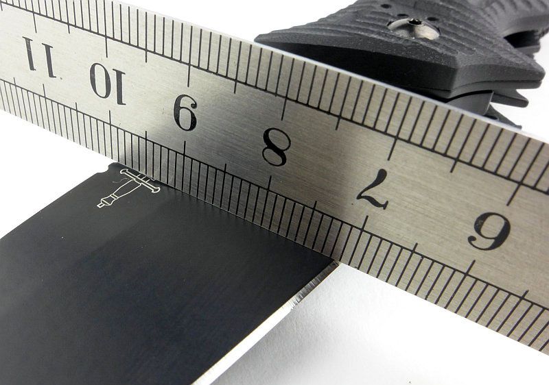

    Most knives specifications have a basic description of the blade geometry, but in this section I will be taking a more detailed look at geometry and balance.
    Using a set of gauges and precision measuring equipment including a Vernier protractor, callipers, fixed radius gauges and the unique Arc Master adjustable radius gauge (the one that looks like a crossbow).
    These measurements have been tabulated and are presented along with a few reference blades (8" Chef's Knife, 5.5" Santoku and the popular Fallkniven F1).
    Key aspects such as the primary bevel angle, grind type, blade depth, blade thickness, length, weight are detailed, along with balance information.

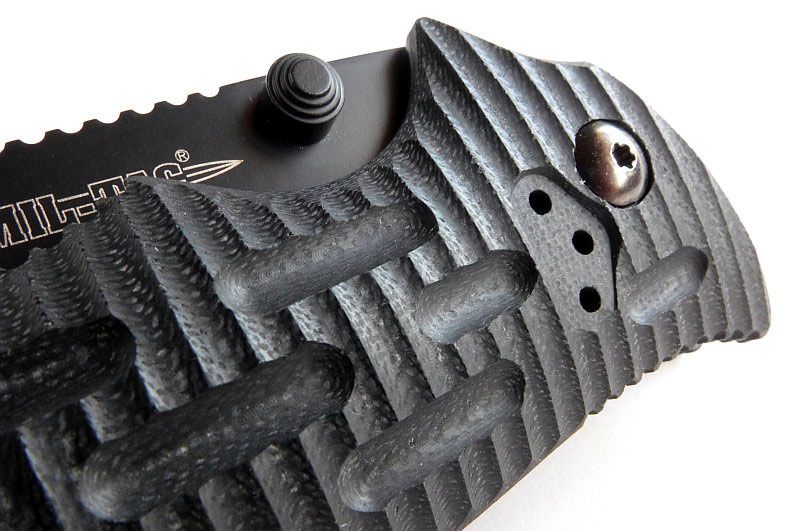

    One of MIL-TAC’s distinctive features is the use of 3D milled G10 grips, and MIL-TAC are well known for making some of the best custom 1911 pistol grips.
    Whatever tool you are using, the grip is one of the most important design aspects. It needs to allow you to hold that tool securely, and work with it for long periods without causing discomfort due to rubbing or pressure ‘hot spots’.
    The MTF-4 is the latest folder design to arrive in the MIL-TAC stable and features super 3D-milled G10 handle slabs designed to give you the best grip possible.
    The 3D milling allows for full sculpting of the handle with a palm swell and contouring to fit the hand. Also milled into the surface is the grip texture providing you with a fantastically stable grip in all conditions.

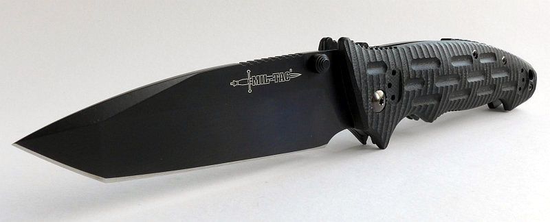

    The MTF-4 comes in a few different options. The blade in this example is the American Tanto plain edge Teflon coated version. Also available is the drop-point and part serrated versions of both blade shapes depending on preferences.

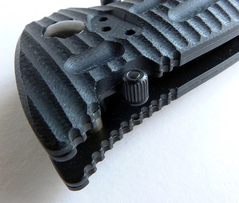

    Though the lock engagement is very good, the MTF-4 has a safety-lock. This is a lock-for-the-lock and once engaged prevents the liner-lock bar from disengaging.
    Continuing the great-grip theme, the MTF-4 also has a jimped spacer and jimping round the safety-lock.

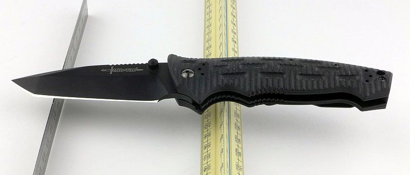

    The MTF-4 is a good size knife. Shown here next to a popular Falkniven F1 fixed blade, it is a similar proportion, but with a much more ergonomic handle and increased grip.

    In the MTF-4’s case I found the clip detracted from the special grips so much it had to go completely. Taking a minute with a T6 screwdriver to remove the clip released the full potential of those 3D milled handle slabs.
    Now that the full surface of the handles is exposed, the amount of traction I get with the MTF-4 it is almost as if I have Spiderman’s hands and can barely let go of it.

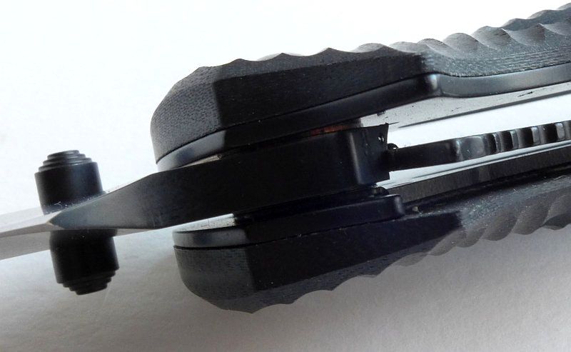

    When checking for blade play, there was none side to side, but I did find a very small movement when pressing on the spine of the blade. Looking closer, where the liner-lock bar engages with the blade, it slips a very small amount under pressure and then settles. I was not able to make it move any further, so don’t see any issues here, especially with correct use of a folding knife.
