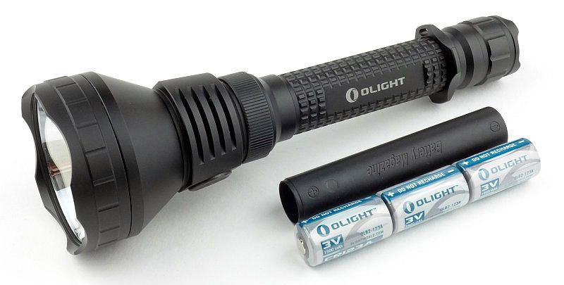

    Like all the Javelots I’ve tested, the M3XS-UT comes with a plastic carry case rather than a disposable cardboard box.
    Inside, the contents are held in place with a foam liner. The empty slot would contain the CR123 holder, but in this case this demonstration light had a set of cells fitted into the light when it arrived.

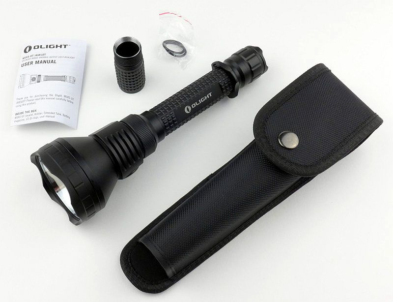

    Included are the M3XS-UT, an extender tube, holster, two O-rings and the instructions. (the CR123 cell holder is already in the light here).

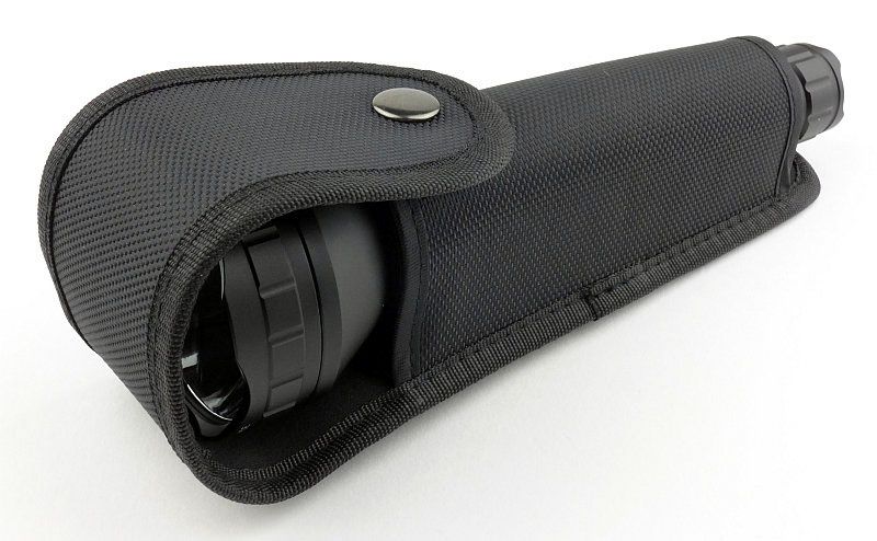

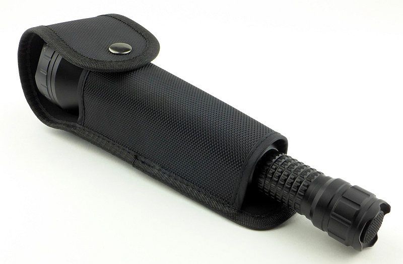

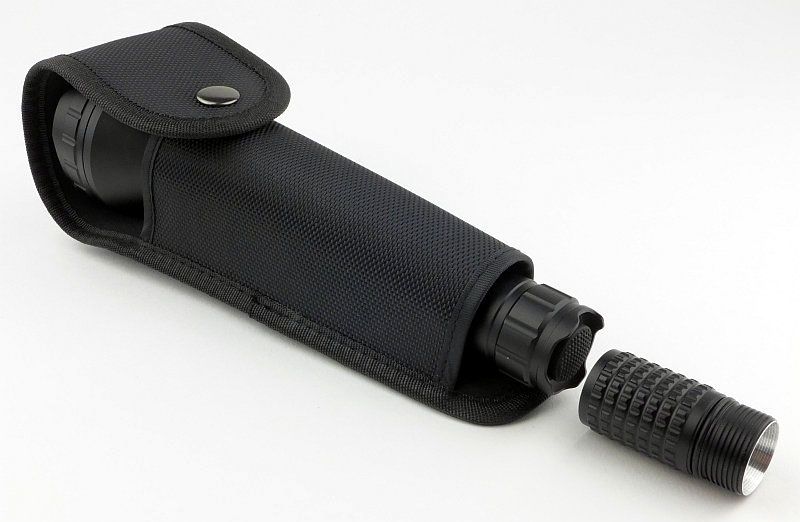

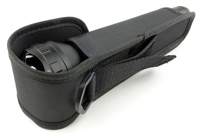

    Out of necessity, the M3XS-UT has an open bottom holster.
    You have the choice of D-ring or Velcro-closed belt loop.
    This is why there is an open bottom in the holster.
    This holster can be used with or without the extension tube.

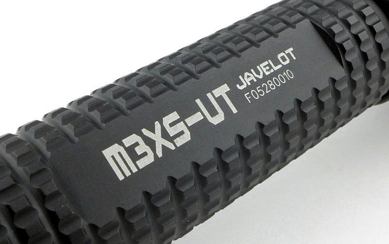

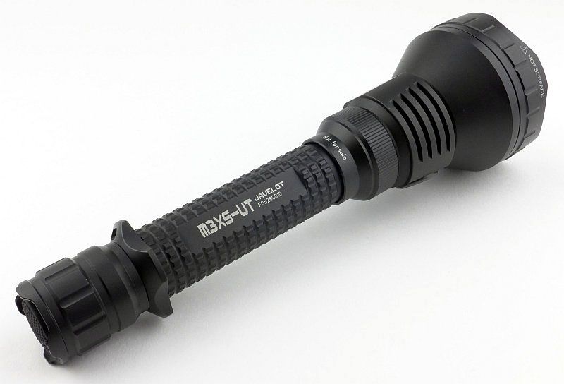

    The M3SX-UT has a removable grip ring.
    Instead of standard knurling a very effective pattern is machined into the body.
    In addition to the tail-cap switch, there is a side-switch for mode selection.
    Either side of the side-switch are heat sink fins.
    The switch boot is wider than most and the tail-cap has four small raised lugs which allow it to tail-stand (though not very stable).

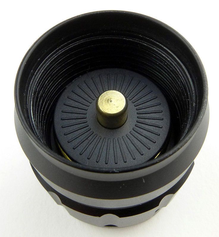

    Looking into the tail-cap, the negative terminal is clearly visible, but the contact for the battery tube is only seen as small glimpses. This is due to the design not using a contact point on the end of the tube, but instead fitting into the cone shaped inner edge.
    Removing the battery tube completely shows the positive contact in the head as well as the circular battery tube contact.

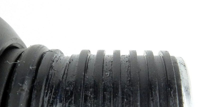

    For the tail-cap end of the battery tube, the threads are a square-cut.
    At the head end of the batter tube, the threads are standard and two O-rings are used.

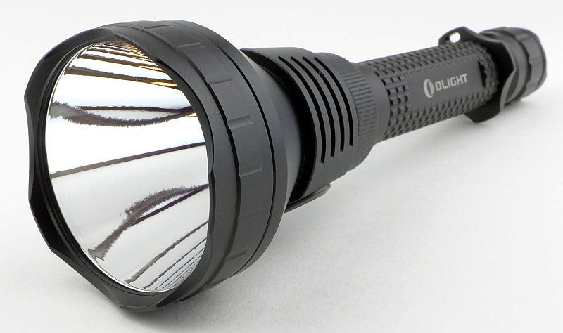

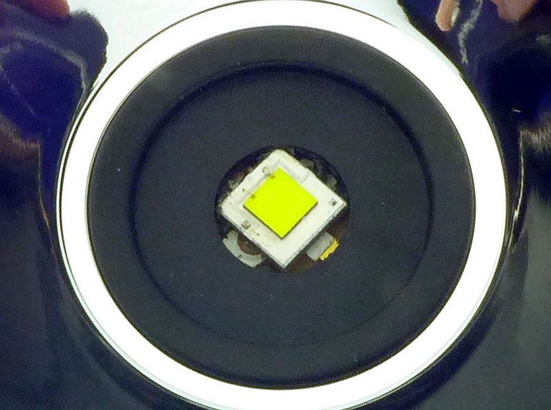

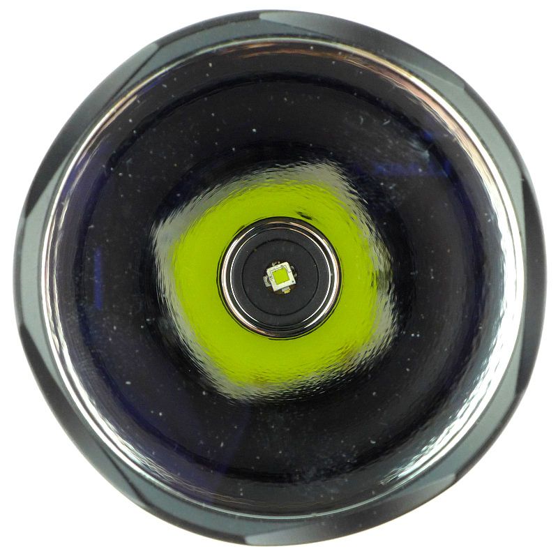

    There is just a tiny hint of texturing in the large reflector, and at its heart, a fully exposed XP-L HI LED.
    A closer view of the bare phosphor of the XP-L HI.

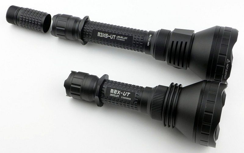

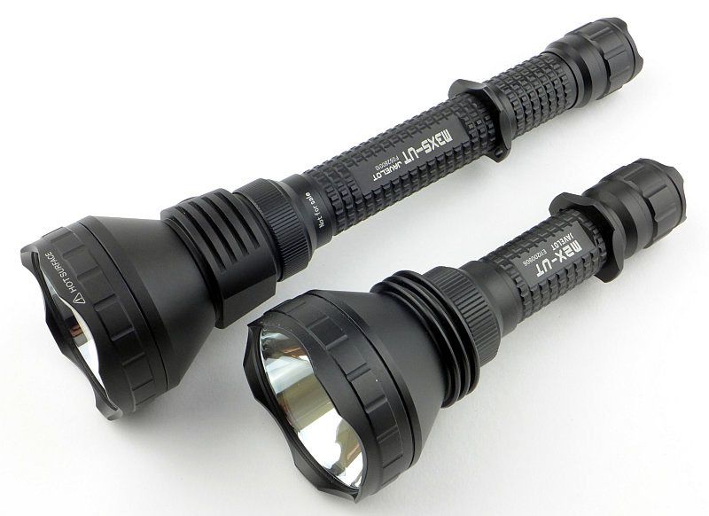

    Making comparison to the M2X-UT (using 1x18650), this larger version is clearly longer from the lens to the battery tube due to the inclusion of the side switch and larger heat sink. The non-extended battery tube is also 3xCR123 in length.
    Comparing again with the extension tube fitted.

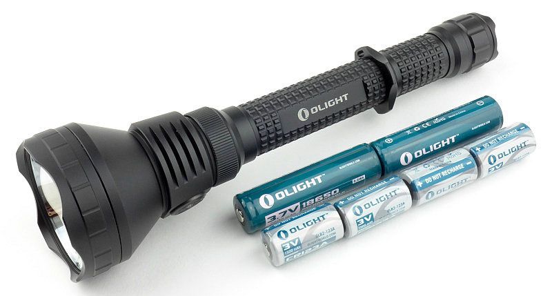

    Taking the M3X-UT at its smallest size, it runs on 3xCR123 and has a cell holder to stop any rattle.
    Stepping up to the full length M3XS-UT it runs on 2x18650 or 4xCR123.
    To get the most runtime out of the M3XS-UT use it with the extension tube fitted.

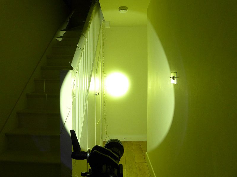

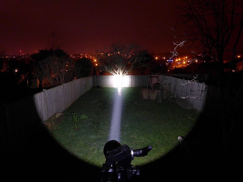

    Starting indoors, it is immediately obvious we have a super-high intensity hotspot. In fact what you can see in this photograph is the effect of the hotspot being of such high brightness it is acting as a significant source of light. The edge of the spill is easy to see, but the whole scene is lit behind the spill edge due to the hotspot’s light bouncing back.
    Outdoors the hotspot burns out the centre of the image.

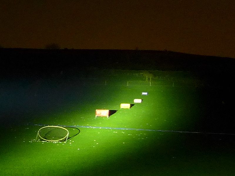

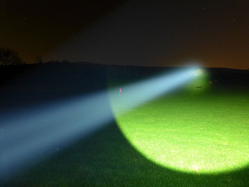

    To really appreciate the full power of the M3XS-UT we need a little more range. How about a driving range?
    The beam is aimed at a set of four distance markers behind a circular net. The closest marker is 100 yards, with the others set 50 yards apart going up to the furthest at 250 yards.
    The beam lights well beyond the markers.

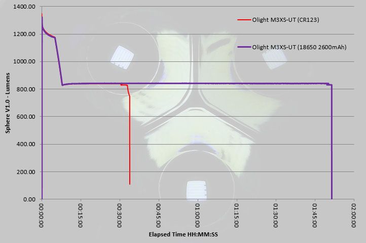

    After 8 minutes on High (using either CR123 or 18650) the output makes a controlled reduction to 832lm which is then maintained as a regulated output for as long as the cells can manage.
    Running on 2x18650 you have a huge difference in total runtime with the CR123s running into the ANSI cutoff at 35 minutes from turn on, but the 2x18650 (and only 2600mAh cells) gives you up to 1h51m at which point the protection cuts in and the output goes off.
    The regulation used in the M3XS-UT means that you get little or no warning of the output cutting out. On 18650 the protection activates, and with CR123 the output plummets once the cells are depleted.

    subwoofer, thanks for the review.
    Per the pic of the emitter shown in your review, that's a dedomed XPL, not a XPL HI.

    Quote Originally Posted by scs View Post
    Olight's specification states XP-L High Intensity and I know from some of the samples I've had that Cree initially had a completely bare emitter then found that an almost flat mini dome (more of just a very thin coating) increased output efficiency and improved tint.
    The light on test will be one of the first production units (as it was a demo sample) and has the first generation of XP-L Hgih Intensity. I suspect the latest production batch will have the XP-L HI we are more familiar with.
