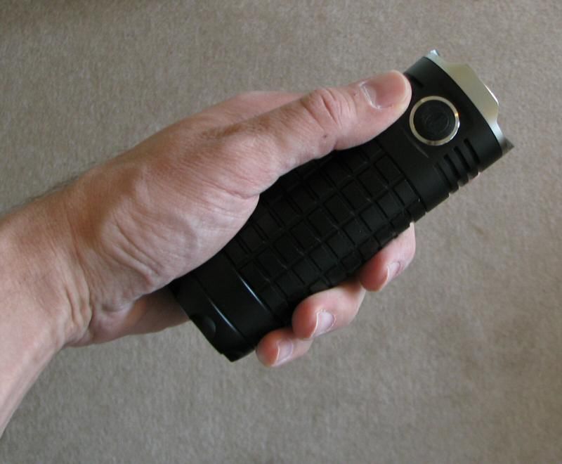

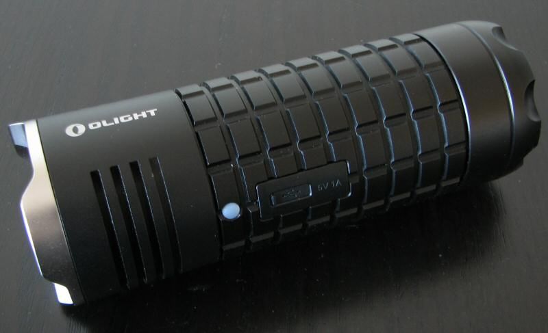

    Overall build is similar to the original SR Mini, but with a number of updates.

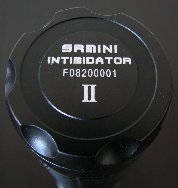

    Physically, the light is quite compact as before, but with a more rounded tailcap and lower profile scalloped bezel now. It remains a solid light, with built-in wells for the batteries. Anodizing is matte black finish. There is no real knurling to speak of, but there is a large checkered grid pattern all over the handle, as before. Grip is ok, but I do think some actual ridge detail on the body segments would have helped further.
    Body labels are minimal, with most of the info is on the tail cap. Lettering is bright white and clear against the black background.

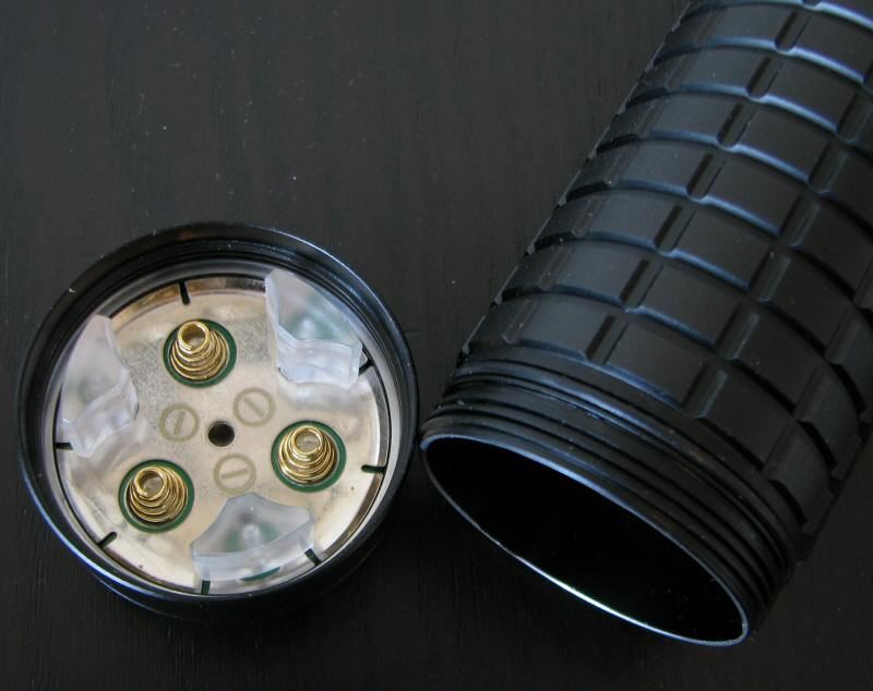

    The light opens at the tailcap only. Tail threads are square-cut, and anodized for lock out. Tailcap design has been revised – previously, there was a locking column that held the rotating tailcap internals in place as you screwed down the tail. Now, there are three plastic guards that serve the same function (same as on the most recent SR52). More significantly, the cells are no longer arranged in series: now, all three cells are in parallel. This is presumably to accommodate charging, as there is now a built-in charger, using the same micro-USB port design as the SR52. Scroll down to see an analysis of the charging pattern.
    The built-in wells take all widths of 18650s in my collection. However, only button-top cells work in the light (i.e., the positive contact points in the head are not raised).

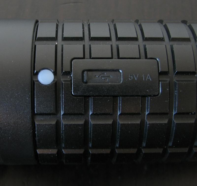

    The control button has changed from a hard plastic switch with a green LED underneath to a more traditional textured rubber switch. The switch LED previously illuminated any time the light was on, so it served a very limited function. Switch feel and traverse is more typical now. Note there have been changes to the interface as well, as described below.
    The three XM-L2 emitters appear to be in very shallow wells, directly below a flat diffusing optic. Beam pattern should thus be largely flood, as before. But the optic has changed, and no longer has the "honeycomb" appearance of the original SR Mini. I expect this will result in somewhat better throw (i.e., a bit less diffusion). See beamshots for more info.
    There is a slightly scalloped stainless steel bezel installed by default now on the light (previously, this was a flat bezel, with a higher profile bezel option). It is held in place by three hex screws.

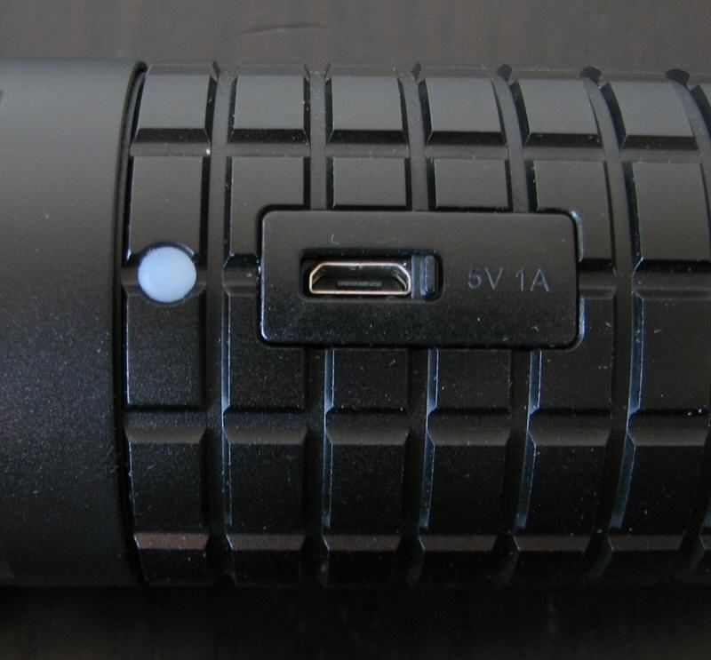

    There is a low voltage LED indicator near the charging port. According to the manual, when the battery voltage falls below 3.25V, the LED will blink red. It will change to constant red at 3.05V.

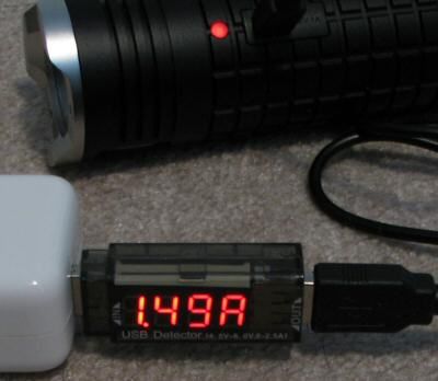

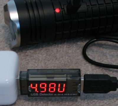

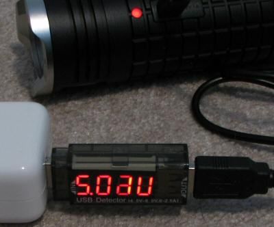

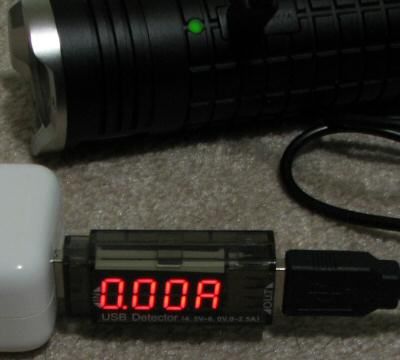

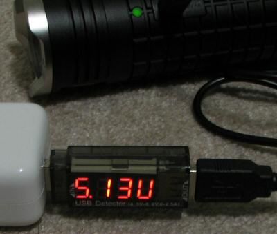

    Charging Current
    For these measures, I am using a Xtar VI01 "USB Detector" (basically a specialized USB current/voltage meter). This model has recently been favorably reviewed by HKJ here. For all these tests, I left the USB detector in place for all readings. Note that the voltage reading on this device refers to the input voltage (i.e., from the charging brick). I am using drained Keeppower protected 3100mAh batteries for charging.
    The SR Mini-II uses a higher charging current than typical, and Olight recommends use of a 2.1A-rated adapter (i.e., a tablet charging adapter, not a phone charger). A higher rated USB adapter is necessary to allow max charge rate (otherwise, you will be limited by the adapter and charging will take longer).
    Initial charging current and input voltage was 1.18A and 4.98V:
    Charging current slowly rose over the next several hours, peaking at 4 hours at 1.49A and 5.02V:
    Charging current then declined over the next several hours, terminating shortly after 8 hours of charging, at 0A and 5.13V:
    Here is a summary of the charging stats (again, this is input voltage on the USB detector):
    Time 0hr: 1.18A, 4.98V
    Time 1hr: 1.33A, 5.03V
    Time 2hr: 1.37A, 5.04V
    Time 3hr: 1.42A, 5.03V
    Time 4hr: 1.49A, 5.02V
    Time 5hr: 1.34A, 5.03V
    Time 6hr: 0.64A, 5.07V
    Time 7hr: 0.20A, 5.08V
    Time 8hr: 0A, 5.13V (green)
    Overall, the SR Mini II seems to use a good charging algorithm, but it is not exactly CC/CV. Charging time was reasonable for 3 cells. All cells read out exactly at 4.19V at the end of the charging cycle. Note that the above is consistent with the report spec of 1500mA charging.

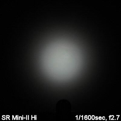

    All lights are on their standard battery, or protected 18650 ICR. Lights are about ~0.75 meter from a white wall (with the camera ~1.25 meters back from the wall). Automatic white balance is to minimize tint differences.

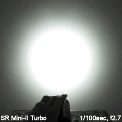

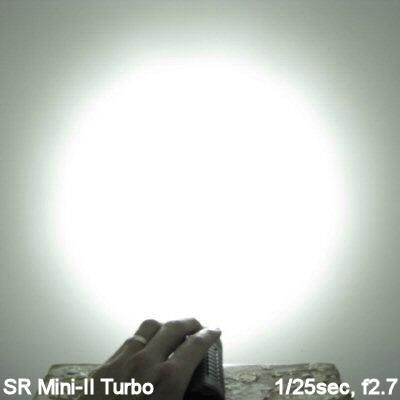

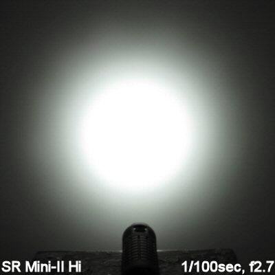

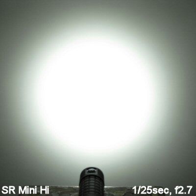

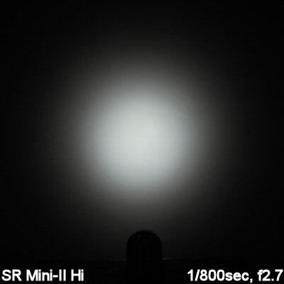

    Let's start with a comparison of the Hi mode, and the "momentary" max mode (Turbo) on the original and the revised SR Mini:
    It is always hard to try and show floody lights at this ridiculously close distance. The point is that there is not much of center beam "hotspot" in actual use – but the brightness difference above is a good way to judge overall beam intensity differences. In that sense, as I hope you can see, there is a lot more light produced on Turbo than Hi – and the SR Mini II is brighter on max than the earlier SR Mini.
    I would also say that the new SR Mini II optic produces a slightly more focused beam, with less corona "spill" than the earlier optic design. You will really only notice with the two side-by-side.
    For the rest of the comparisons below, I will use the Turbo mode.

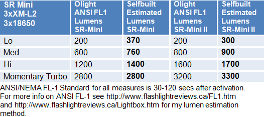

    The output measures confirm the SR Mini II is definitely a bit brighter on Turbo, as you could tell from the earlier beamshots.
    Let's see how the rest of the output levels compare:
    Basically, a slight bump up at the Med/Hi modes, and a slightly lower Lo (although still quite bright at ~300 estimated lumens).

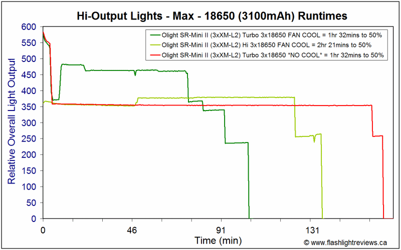

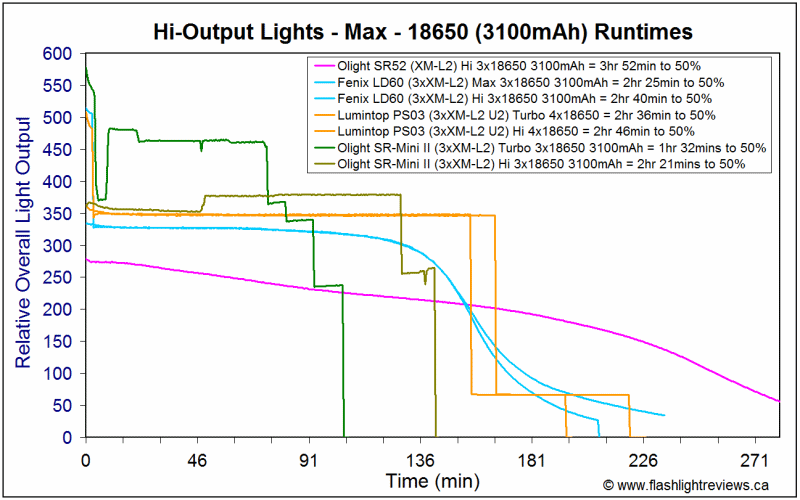

    Output/Runtime Graphs:
    For the last year or so, my standard runtimes are done on Keeppower protected 18650 3100mAh cells, under a cooling fan.
    There is clear evidence of thermal management of the "hidden" locked on Turbo mode (as described in the UI section) – and potentially even the Hi mode. As such, I've done a direct comparison with the cooling fan turned off.
    Ok, so without cooling, the Turbo mode ramps down to Hi mode level after ~5 mins, and stays there for the duration of the run. Note you get very flat runtime on the non-cooled run.
    As always, overall efficiency is consistent with an excellent current-controlled circuit.

    Hi, can anyone tell me if it is possible to charge and use the light at the same time ?
    6,936
    Default Re: Olight SR Mini II (3xXM-L2, 3x18650) Review: RUNTIMES, BEAMSHOTS, VIDEO and more
    Quote Originally Posted by zs&tas View Post
    On most lights, the answer is no - but in this case, yes, the SR Mini II will activate while charging.
    Jan 2009
    UK
    1,075
    Thank you for the reply, Oh wow that is pretty cool, i wonder how long it could run 1600 lumens with charging, its a neat option for sure !
    is that possible to run in turbo while charging or only in low mode? and can it take sanyo ncr18650bf? i dont know sanyo ncr18650bf is button top or flat top.
