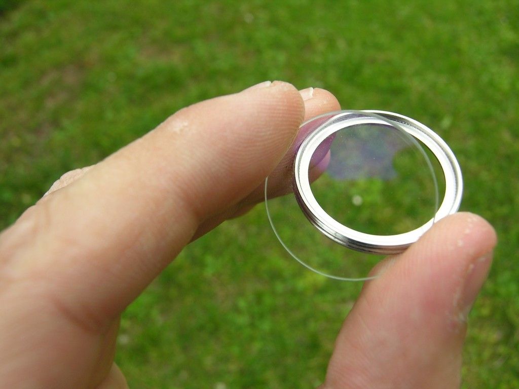

    Untwisting the metal ring the AR treated glass comes out
    Under you have the aluminium reflector, with the space for the o-ring. with this construction it's very easy to mount the light without messing the position of the o-ring.
