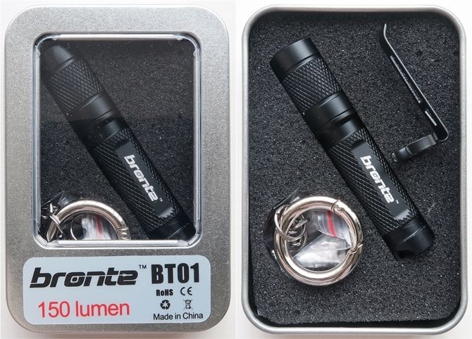

    The BT01 is the latest 1xAAA keychain light from Bronte. The packaging is a small and nice metal case with clear display window.
    The light come with removable pocket clip, spare o-rings, key chain with split-ring and clip, user manual, and warranty card.

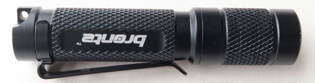

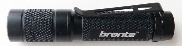

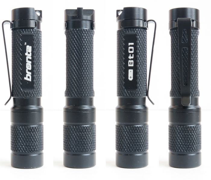

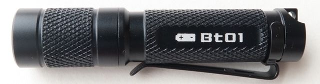

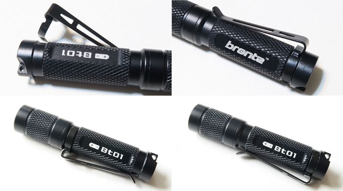

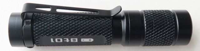

    The BT01 is in keeping with other 1×AAA lights that use a similar structure and mechanism. It's small for the class. My review sample came with in black anodizing and there is neither flaws nor blemishes on the body. Note that 4 colors (Black, Pink, Blue, Grey) are available for this model. Labels are sharp and clear in bright white against the background. The light has no tail switch. Fit and finish look good.
    The light has 2 parts. The pocket clip works as a good anti-roll device as well.

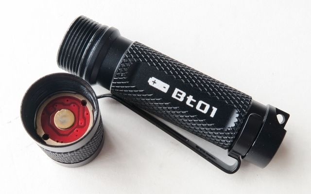

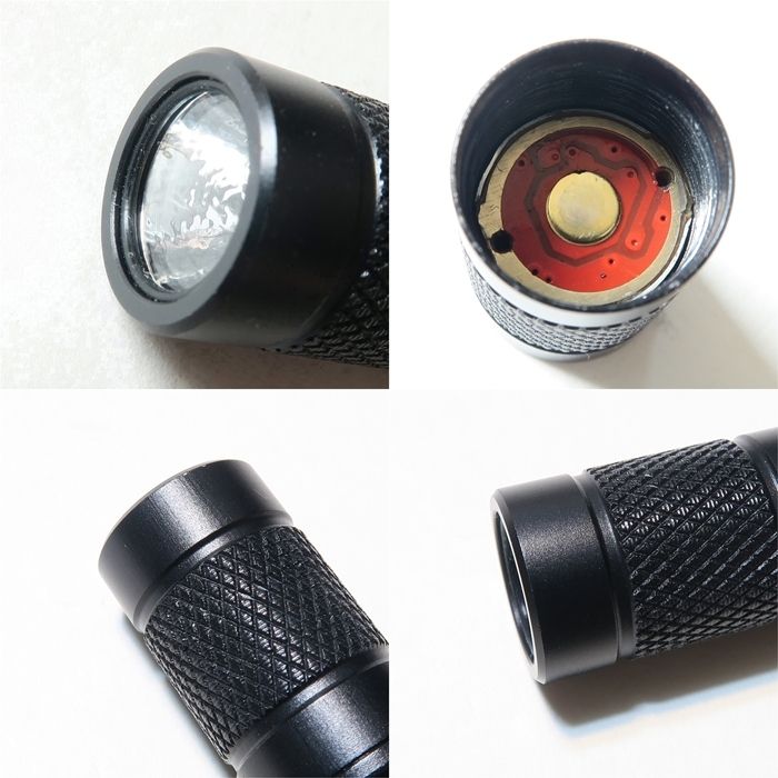

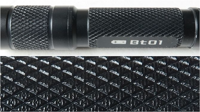

    There is a typical diamond-shaped knurling band on the head. The head has a clean looking cylindrical design. Bronte officially told me that the light doesn't have a reverse polarity protection to protect from incorrect battery installation. But I tried to insert a Ni-MH battery in the wrong position. The body of the light just went warm few minutes later and it didn't cause damage to the light.

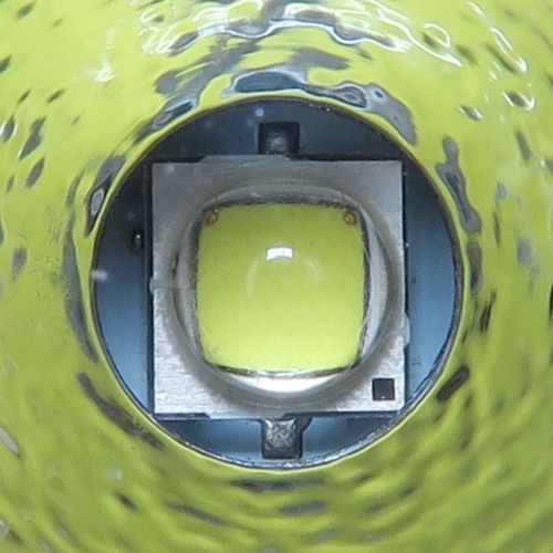

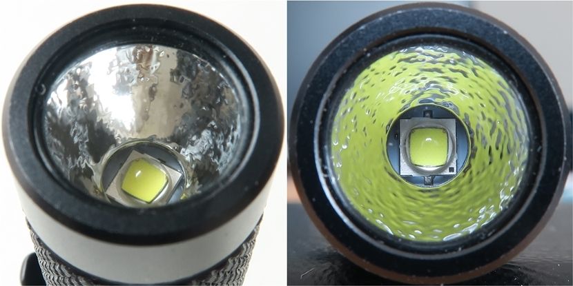

    The light comes with a textured (i.e., orange peel) reflector and uses a XP-G2 emitter. Centering of the emitter was pretty good on my sample.
    The pocket clip is not special, but looks sturdy and hold onto the light securely. It is reversible, allowing both head-up or head-down.
    The battery tube is mostly covered in diamond-shaped knurling. The knurling is not very aggressive, With the pocket clip attached, overall grip is good. Mode changing with single-handed work fine. The wall thickness of the body is 1.1mm. The light feels reasonably solid to use.

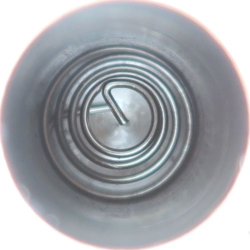

    The light uses a spring in the tailcap, like many lights in this class.

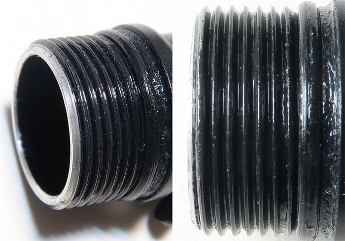

    The screw threads are triangular-cut of good quality, like most lights in this class. Threads are well machined, and anodized which allows the light to be locked-out. As supplied, threads are lubricated. Screw threads action is quite smooth with no cross-threading or squeaking in my sample.

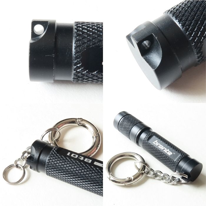

    The BT01 come with an included key chain. You can securely attach the BT01 to the pocket, bag, belt, hat or anywhere you want for easy carrying. This key chain clip can be quickly opened or closed. There is a small attachment point on the tailcap with a cut-out for the keychain split-ring. The light can tailstand stably.

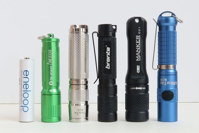

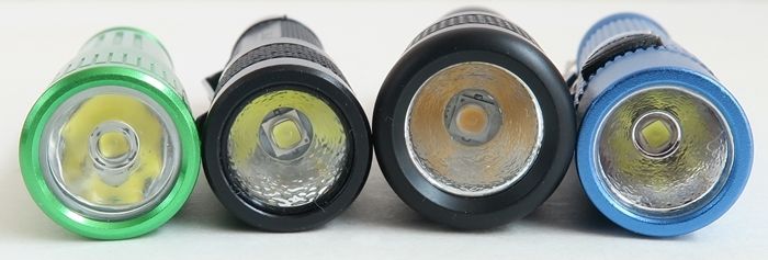

    From left to right, Panasonic Eneloop AAA (750mAh), Olight i3E EOS (Luxeon TX), Fenix E05 (XP-E2), Bronte BT01 (XP-G2), Manker E01 (Nichia NVSW219C), Ultratac K18 (XP-G2 S2).
    From left to right, Olight i3E EOS (Luxeon TX), Bronte BT01 (XP-G2), Manker E01 (Nichia NVSW219C), Ultratac K18 (XP-G2 S2).

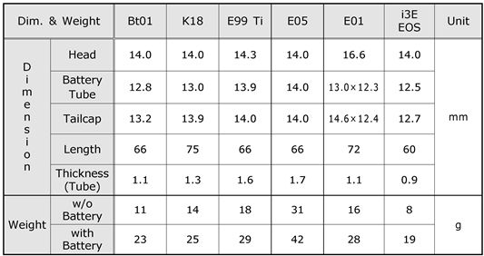

    Measured Dimensions

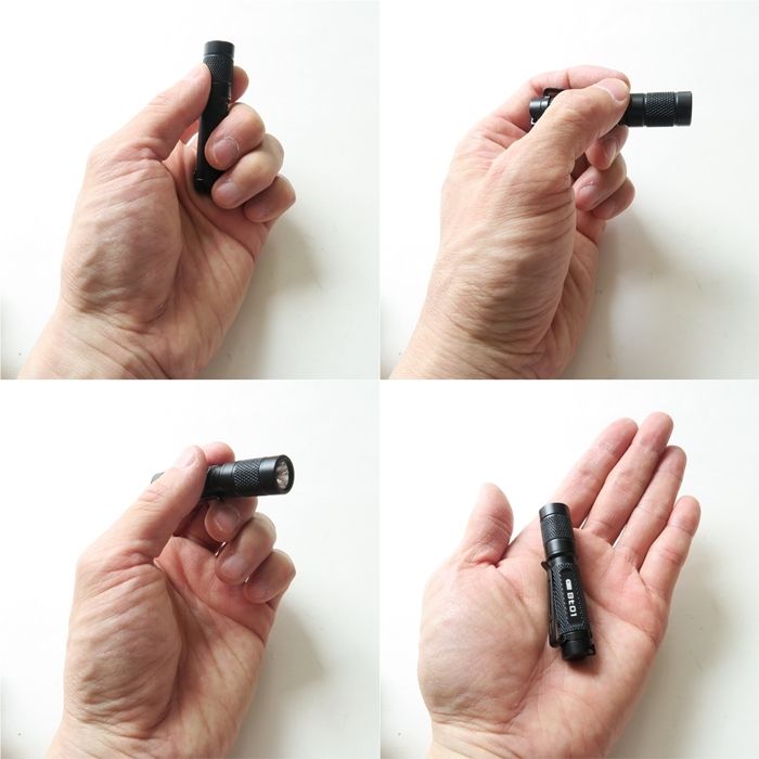

    The BT01 is a small light and good size to hold and use for EDC. Overall build quality is high.

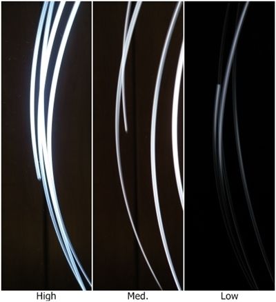

    PWM
    The BT01 shows no sign of PWM at any output level. I can't hear any buzzing sound at any output as well.

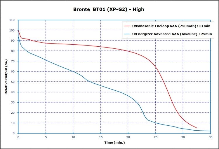

    The runtime to fall to 10% of its initial output from 30 seconds after the point the light is first turned on (i.e., based on ANSI FL-1) for High is as follows :
    The efficiency on Ni-MH is better than Alkaline battery source, like other 1xAAA lights in this class. The BT01 drops down rapidly on Alkaline. Output on High seems higher than typical for this class. The manual doesn't say 10440 Li-ion is supported.

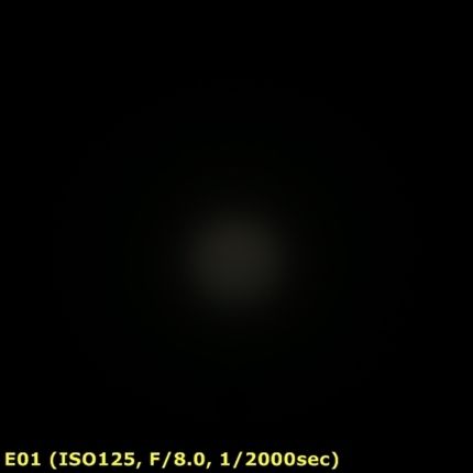

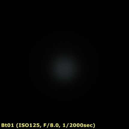

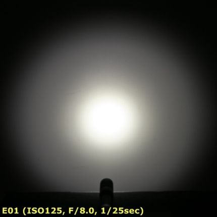

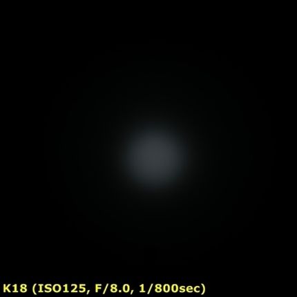

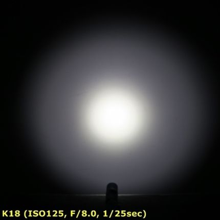

    Beamshot

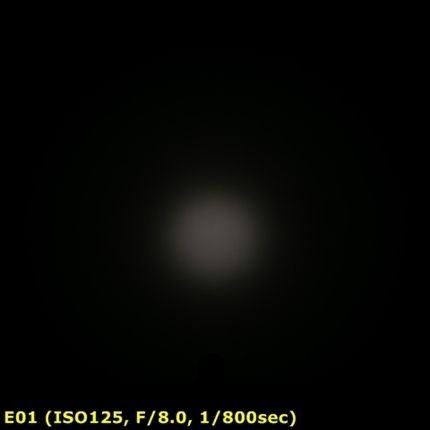

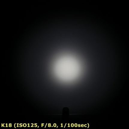

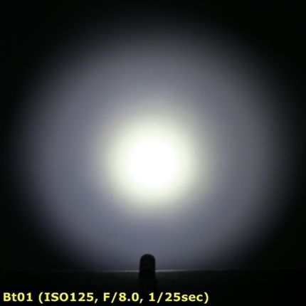

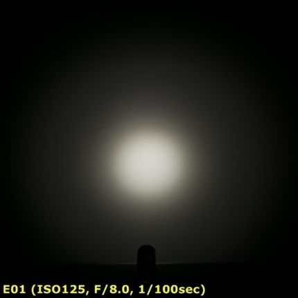

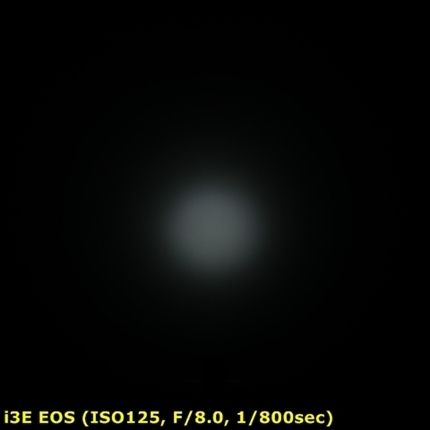

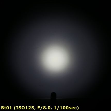

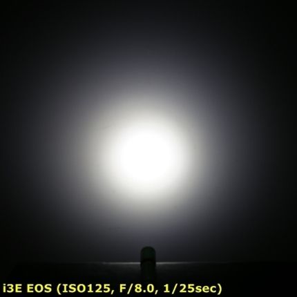

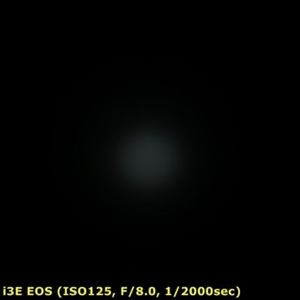

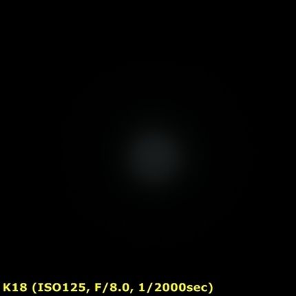

    1. White door beamshot (about 50cm from the white door) on max. output on 1xPanasonic Eneloop AAA (750mAh)
    - ISO125, F/8.0, 1/25sec, Auto white balance
    - ISO125, F/8.0, 1/100sec, Auto white balance
    - ISO125, F/8.0, 1/800sec, Auto white balance
    - ISO125, F/8.0, 1/2000sec, Auto white balance'

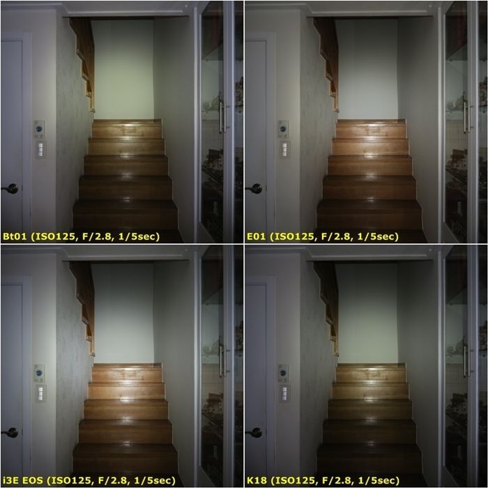

    The beam profile is typical from XP-G2 installed light of this class. The hot spot is slightly less sharply defined, due to corona. A soft corona surrounding the hotspot is slightly yellow. The overall beam profile is acceptable. The beam has a typical cool tint on my sample.

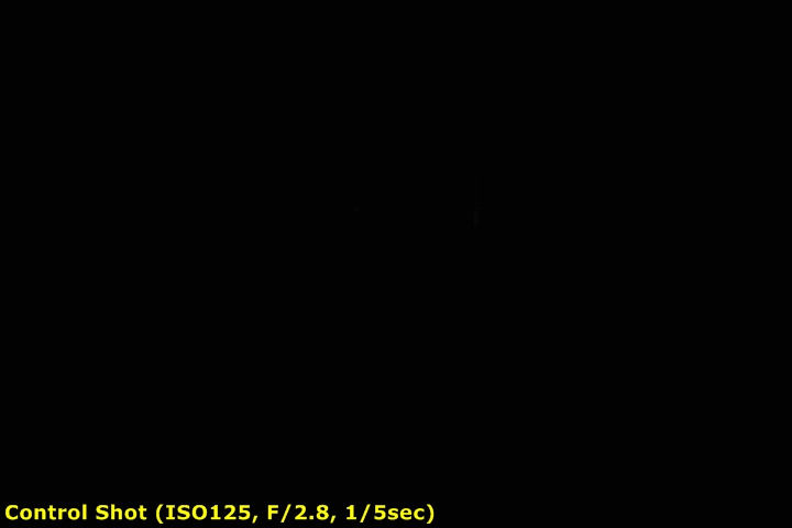

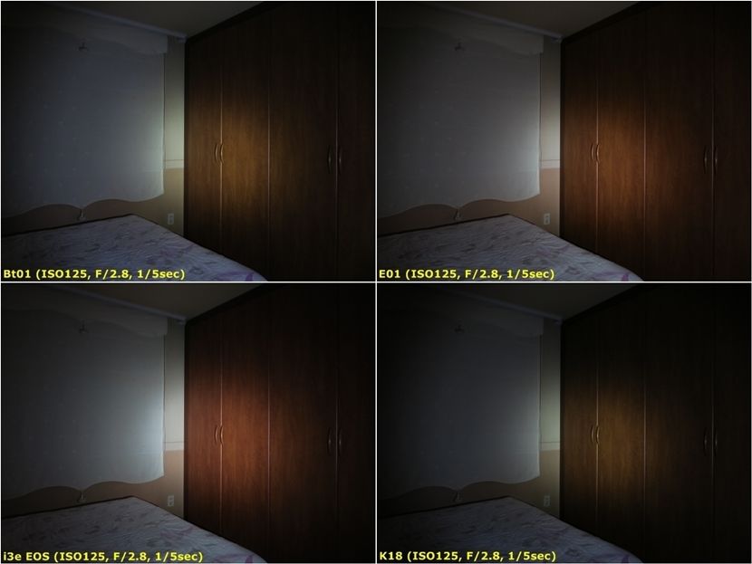

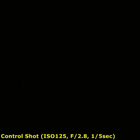

    2. 3.0m Indoor Beamshot on max. output on 1xPanasonic Eneloop AAA (750mAh)
    - ISO125, F/2.8, 1/5sec, Auto white balance
    3. 3.5m Indoor Beamshot on max. output on 1xPanasonic Eneloop AAA (750mAh)
    4. 7.0m Indoor Beamshot on max. output on 1xPanasonic Eneloop AAA (750mAh)
