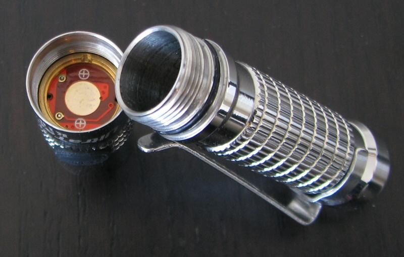

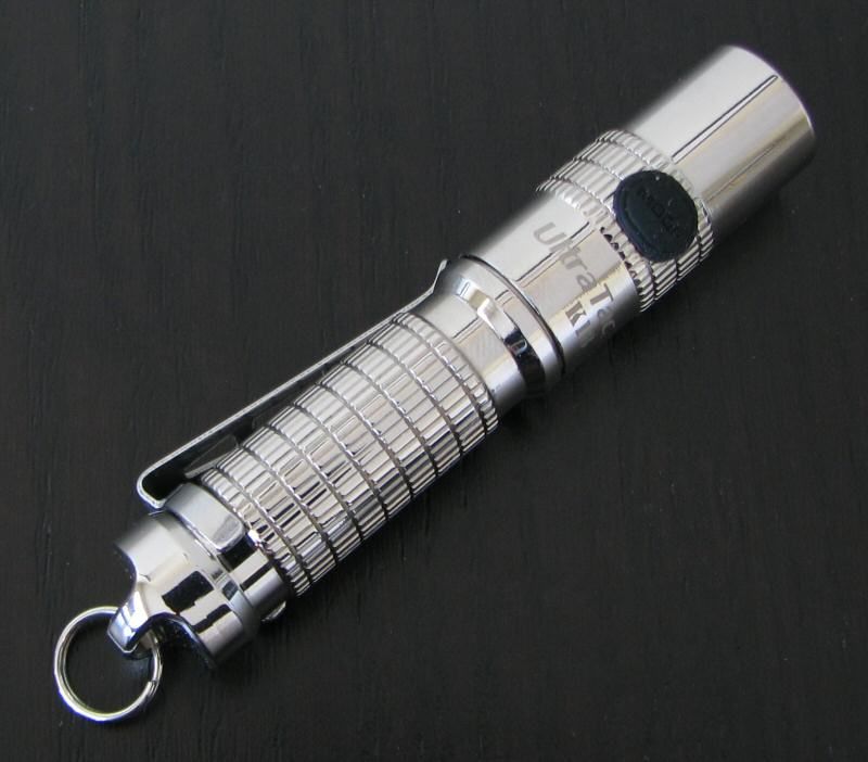

    The side switch has a standard feel for an electronic mode-changing switch, and is located under grippy a rubber cover (easy to find by touch alone).
    Please see my video overview below for more information about the build.
    Press and hold the electronic switch for at least 0.5 secs to activate the light.
    Light comes on in its last memorized mode. Click the switch to advance through modes. Mode sequence is Lo > Med > Hi, in a repeating loop. Press and hold the switch for 0.5 secs to turn off the light. Memory for the last mode used is retained.
    Double-click the switch from On to active strobe. Single click or press-hold to exit. There is no memory for strobe mode.
    Double-click from Off to lock out the light (light will flash once). Double-click again to release the lock out (light with flash twice).

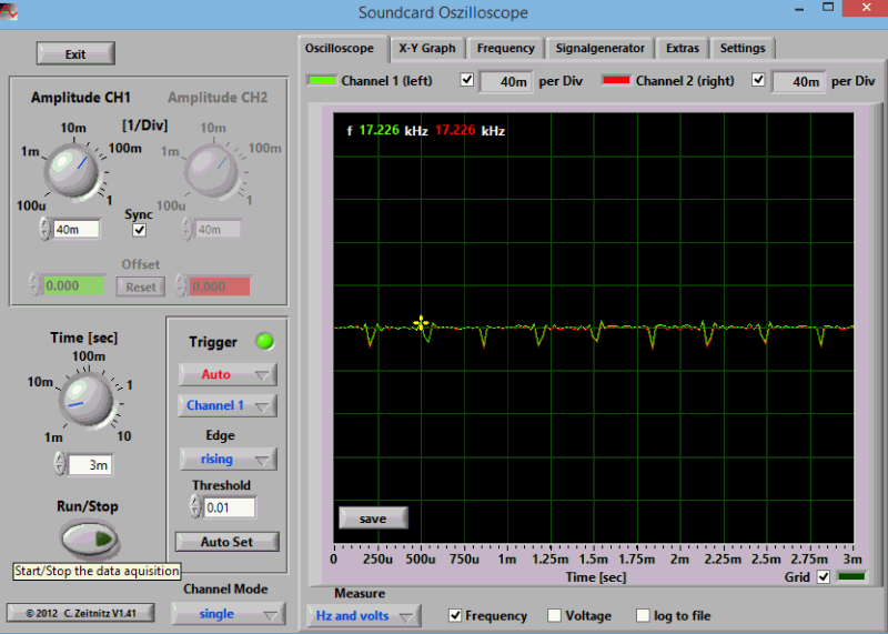

    PWM/Strobe
    The K18 uses pulse width modulation (PWM) at its Lo and Med levels, at a consistent 3kHz frequency:
    Hi
    Med
    Lo
    This PWM is high enough to not be distracting in actual use, although I find it is still detectable at the lowest level (if you are sensitive to it). As usual, there is no PWM on the Hi level.

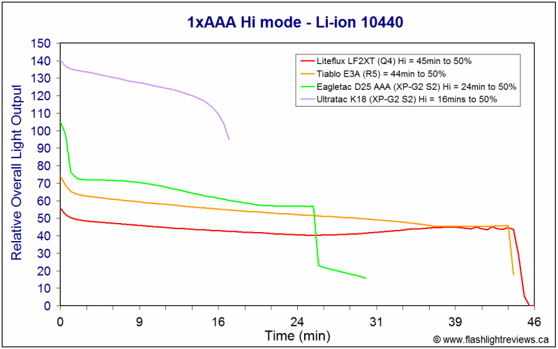

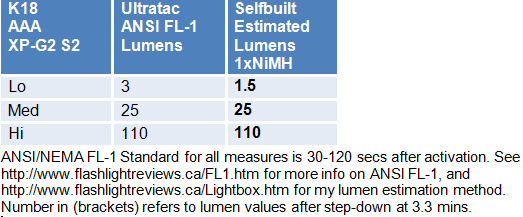

    All lights are on 1xAAA Sanyo Eneloop NiMH, about ~0.75 meter from a white wall (with the camera ~1.25 meters back from the wall). Automatic white balance is set for the Cool White emitters, to minimize tint differences. All beamshots taken immediately upon activation.
    Here is how my lumen estimates compare to the Ultratac specs:
    Impressive levels of output on 10440 and good mode spacing overall, on all batteries.
    Output/Runtime Comparison:
    See my wrap-up section for comments on the runtimes.

    Output/runtime performance of the light is very good for this class, on all batteries - despite the use of high-frequency PWM on the Med/Lo levels. Rest assured, the PWM frequency is high enough (3kHz) that it is very hard to detect it visually and will not be a concern in practice.
    I am actually quite impressed with how well it performed on standard alkaline and NiMH rechargeables. Note the L92 lithium performance was not as impressive as some of the competition. But it is a nice touch that 10440 is officially supported in this light with higher outputs. They have done a good job maintaining reasonable output modes for all battery types.

    Unlike drivers of other 1AAA SS (or Titanium) flashlights, on the K18 SS the driver disc is not electrically insulated against the SS head. Actually this electrical situation is due to the installed/screwed brass retainer crown which is to hold the driver disc in place AND serve as physical reverse polarity protection (RPP) at the same time.
    Today i wanna talk about the RPP (and next time i'll talk about the standby current drain).
    The stepped brass retainer ring ("crown", "spacer") has an inner diameter of 10.00mm, easy to measure. In theory, it spaces AAA battery bottoms ~1.0mm away from contacting the metal(+)contact of the driver disc; on the 2019 SS model the clearance is more like ~0.5mm because it has a raised metal(+)contact. There are two potential issues with this idea/design of physical RPP, depending on the AAA/10440 battery model you insert reversely.
    case1) If the battery is thicker/wider than 10.00mm AND the battery bottom is bare, i.e. not partially covered by heat shrink wrap/tubing/sleeve material or alike, then the reversely inserted battery gets short-circuited, as soon as the SS body touches the SS head. Shorting a fully charged battery can be hazardous, bye-bye battery A commercial example would be your standard Eneloop AAA battery, it has a bare bottom. Another commercial example would be blue unprotected UltraFire TR10440 (600mAh 3.6V).
    case2) If the battery diameter is less than 10.00mm, say 9.8mm, then the battery bottom will(!) contact some part of the driver disc and eventually, depending on the battery model and the K18 SS version, electrically contact the metal(+)contact in the center of the driver disc, thus leading to an established reverse battery connection, bye-bye driver A commercial example would be (fake?) Panasonic AAA Alkaline, which comes in at 9.65mm om*g. So yes and feel free to check with all AAA/10440-sized batteries in your household batteries slimmer than 10.00mm do exist and that is a reason of concern.
    My point being, only because the K18 SS is advertised as having "Reverse polarity protection", in general you should NOT just go ahead and mindlessly insert any AAA/10440 battery reversely for fooling around or testing/trying to understand the RPP. The good news is that some/many batteries, for example the originally included noname blue unprotected 10440 battery, has a thickness of 10.2mm AND not a bare bottom, so neither case1 nor case2 comes into effect yay!
    The "unnecessary" mod. There's nothing much we can do to mitigate case1, hopefully you realize fast enough when you have reverse-installed a blue UF10440 or Eneloop AAA; at least you didn't wreck the driver haha. But we can eliminate case2 by installing a plastic spacer/donut/ring, as we did for the LD01 SS before:
    Here a modding advantage, the conductive brass retainer ring serves as centering aid for our purpose nice thanks and we can friction press-fit the plastic spacer without the need of glues, adhesives, or tapes, hooray:
    Shortcoming:
    Ultratac's idea of physical RPP is a ~1.0mm (~0.5mm) spacing brass ring and maybe they should have tested an inner diameter of 8.50mm to mitigate case2. Ch*nese batteries with w*ld (+)pole assemblies exist, see photo above, so making a spacer out of brass isn't the best idea to start with, because a reversely installed battery could get easily shorted. The advantage of brass is that it is permanent material/installation unlike a taped foam donut lol, and that we can use it for press-fitting a plastic spacer (to mitigate case2). In the end imho it is better to have this brass solution (which can be enhanced with the shown plastic mod) than not to have any physical RPP. Just keep in mind that the original K18 SS RRP is not watertight (see case2) and that case1 is still a potential hazard. By comparison, my modded LD01 SS has no potential issues with case1 or case2 but it has a realistic other potential issue, namely losing the plastic donut spacer because of failing (weak/strong) adhesive! On the K18 SS, you will never lose the press-fitted plastic donut spacer and you will never lose the brass ring, because they are "perma-installed". Maybe that was the main reason why Ultratac decided for a brass solution instead of a foam donut solution. However, imho they should have tried brass rings with 8.00, 8.50, 9.00, and 9.50mm diameter, because obviously 10.00mm wasn't the optimal choice.
