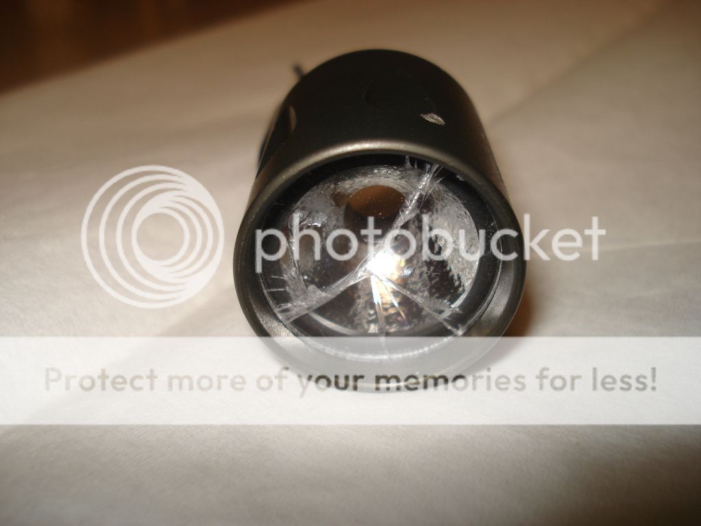

    That's a great question! It's forces the plastic lens into the seating groove inside the head with evenly distributed force around the lens outer circumference. You don't want to apply all of the pressing force across the entire lens. The result will be a shattered lens. I got a pic somewhere and I'll post it a little later. My first attempt was using a tool that was 21mm in dia and flat. After shattering my first lens it dawned on me that it needed to allow some "doming" or flexing of the lens as it passed the retaining lip in the head. After I made a relief cut on my pressing tool it allowed that. And the lens didn't shatter. You could probably just use a piece of tubing providing it was sized properly. My worry was deforming the acrylic as the insertion force increased. Hence the need to use a pressing tool to keep the forces as uniform or even during the seating process.
    It should make a "snaping" or clicking sound as it seats. That's another reason to use a vise to press the lens in. If your pounding it in with a rubber mallet or some form of impact force I doubt you will hear it seat. No need to keep applying force if you have it seated. And you will want to inspect the lens to ensure it is pressed evenly against the flat O-ring. Otherwise the seal wont be waterproof.

    Here's the result of using a hammer or similar impact device. Pretty self explanatory.
