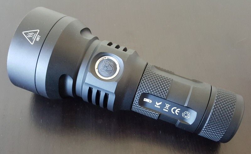

    Anodizing is flat matte black, with no blemishes or flaws on my sample. Labels are clear against the dark background. Knurling is not aggressive at all, but overall grip is ok. Note that the light can roll fairly easily.
    There is a single electronic switch in the head, with typical feel. There is a red LED that serves as a low-voltage warning feature under the switch (activates when <25% remaining).

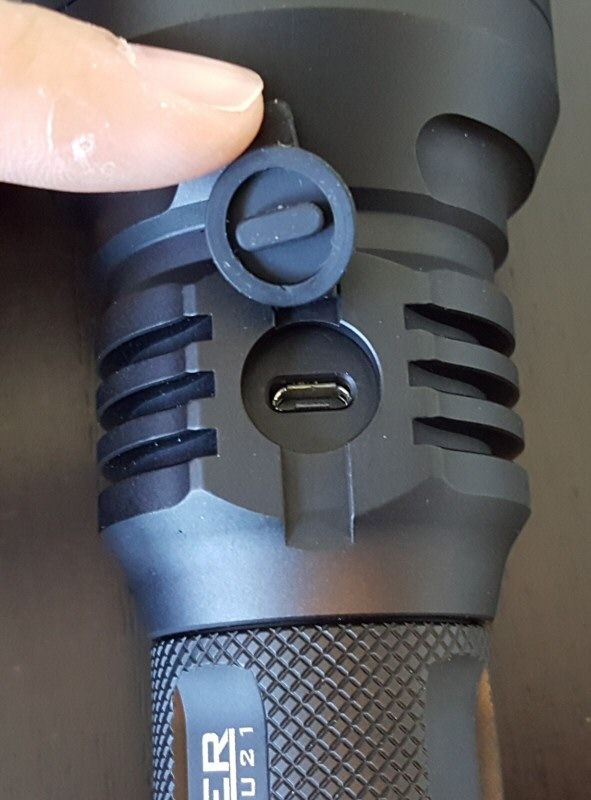

    Charging is done at micro-USB port opposite the switch, under a typical dust plug. Blue/red LEDs under the switch indicate charging status. Note the charger is a 2A charger, so is only suitable for 26650 cells.

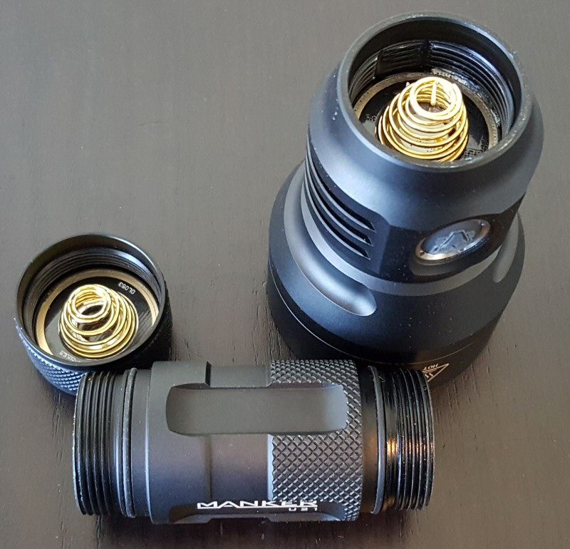

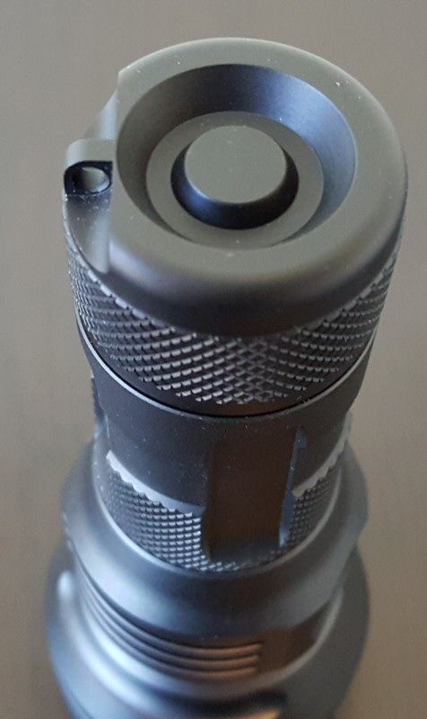

    Screw threads are square-cut, and anodized for tailcap lockout. A quick turn of the tailcap is all you need to lock out the light. The light can tailstand stably.

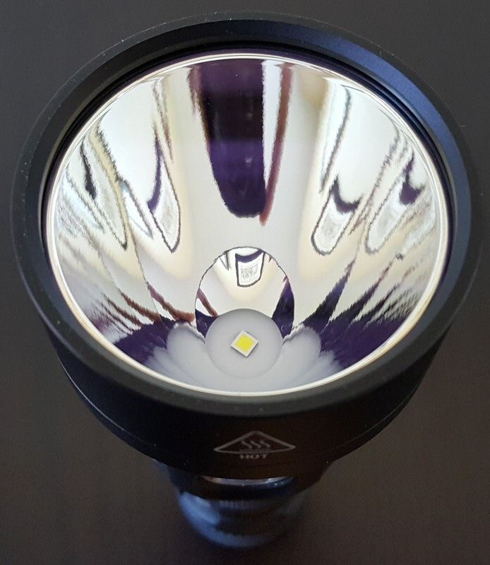

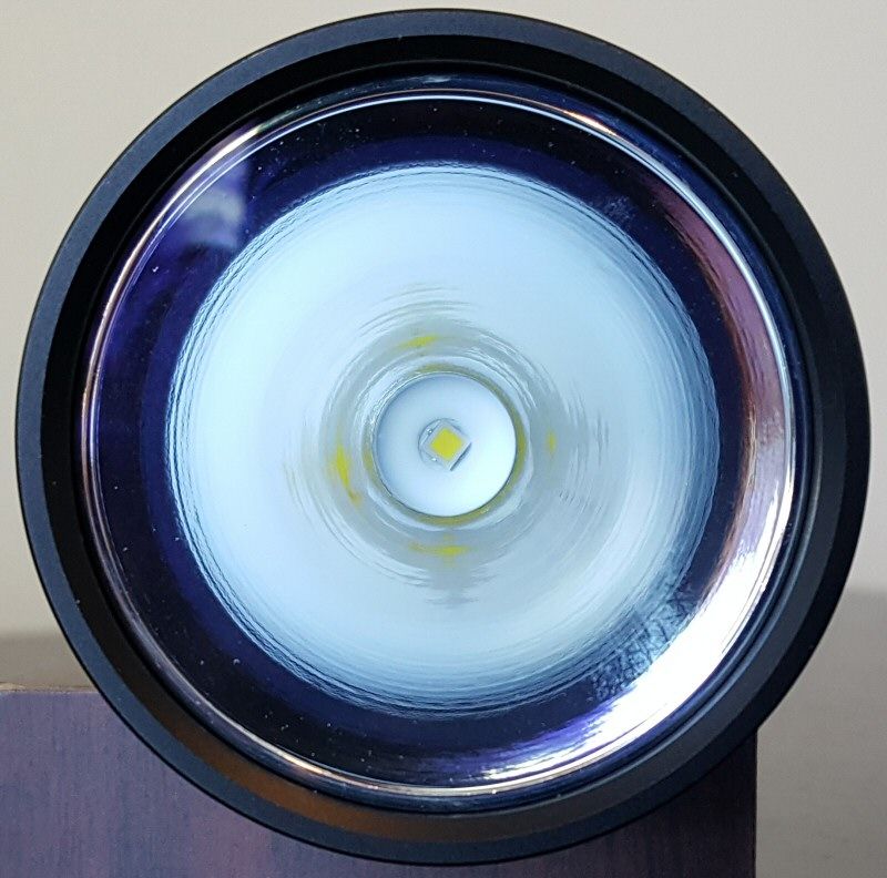

    The XHP35 HI emitter is well centered, at the base of a smooth and deep reflector. This should produce great throw. Scroll down for beamshots.

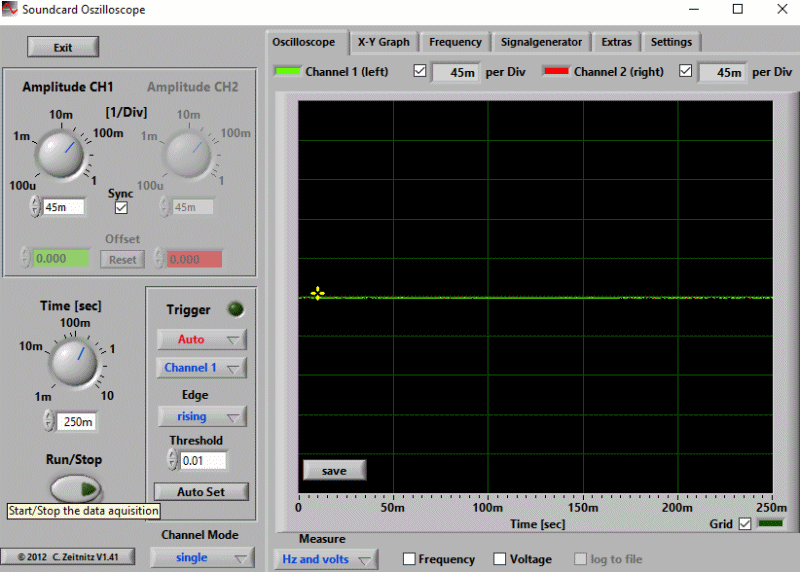

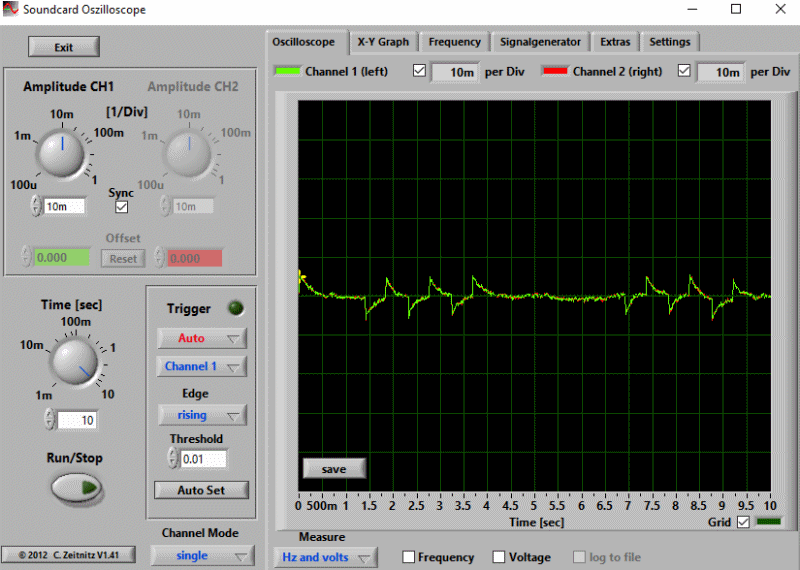

    PWM/Strobe
    There is no apparent sign of pulse width modulation (PWM) at any level. The light appears to be flat-stabilized, and is flicker-free at all output modes.

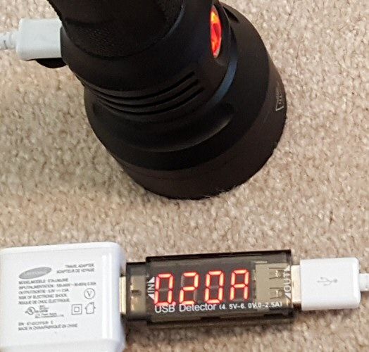

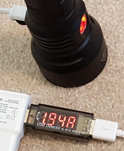

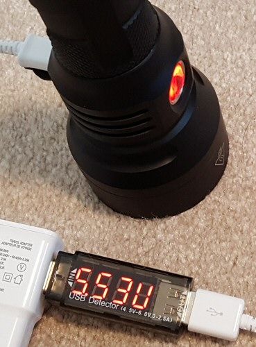

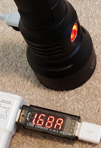

    Because the light uses a USB charging cable, I was able to take direct measures of the charging parameters using my Xtar VI01 "USB Detector" (basically a specialized USB current/voltage meter). There are many of these on the market now, and this model was favorably reviewed by HKJ here.
    For charging tests, I left the USB detector in place for all readings. Note that the voltage reading on this device refers to the input voltage (i.e., from the USB port). I used an Olight 4500mAh 26650 battery.
    Initial charging current was 1.64A, at 5.53V input voltage.
    By just after 2 hours into the charge, current reached its maximum at 1.94A, at 5.59V. Current started to slowly drop off from this point.
    At 3 hours and 10 mins, current was 0.20A, 5.28V
    A complete charge cycle (for a 4500mAh cell) took about 4 hours, with the LED showing blue for termination (and 0A on the detector).

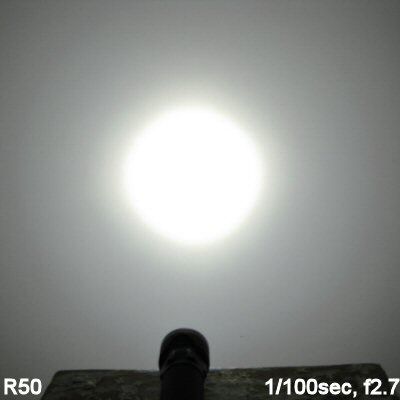

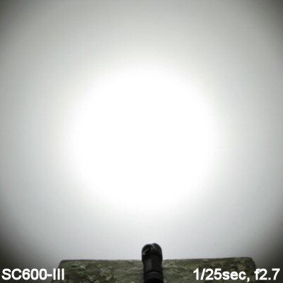

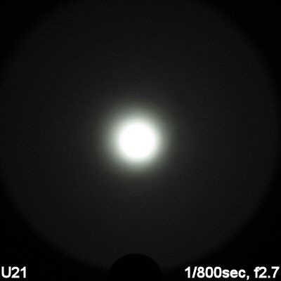

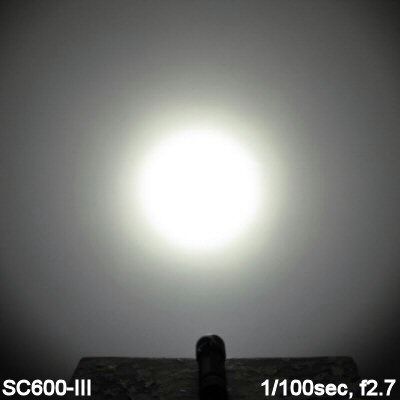

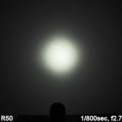

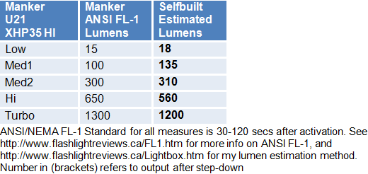

    Max output and throw for the U21 are close to the Manker specs. This is a lot of throw for such a small size.
    Again, lumens estimates are pretty close to the Manker specs across the board. See runtimes below for more info.

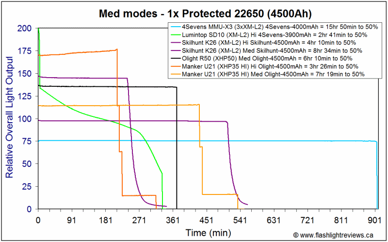

    Output/Runtime Graphs:
    All my current runtimes are done under a cooling fan.
    The U21 shows a multiple-step-down pattern on all levels, so you are never left without light by surprise. Overall efficiency seems good for the class, and the light is very flat-stabilized.
    Note there is a quick initial step-down on Turbo at ~3 mins into the run. You can restore max output by turning the light off/on.
    Note also that there is also a red LED low voltage warning feature under the switch, as the battery runs down.

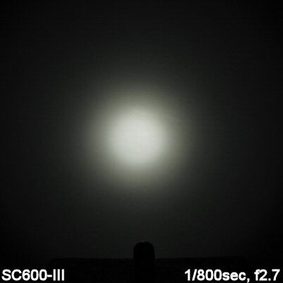

    The beam profile is very good, with minimal artifacts for such a tightly focused hotspot. Also had a broad (but dim) spillbeam.
