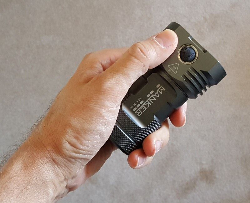

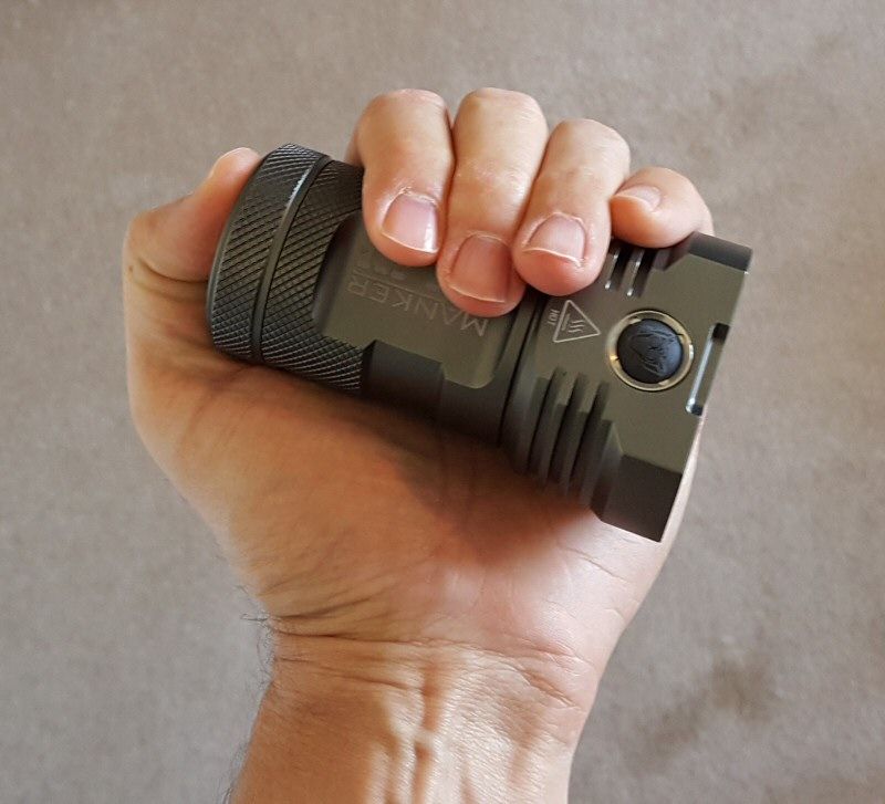

    The MK34 is extremely compact for a 12x emitter light.

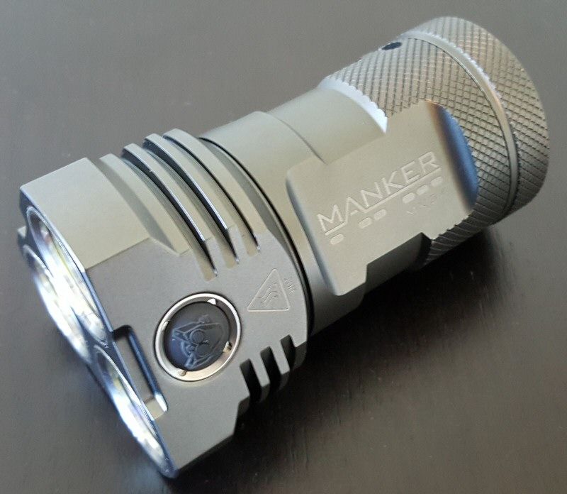

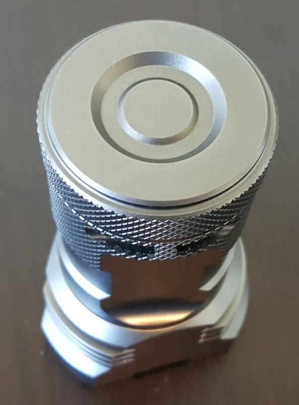

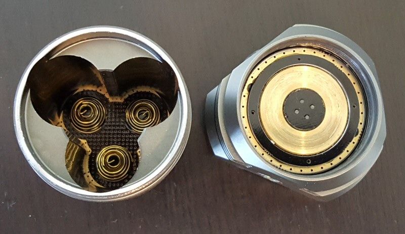

    Build quality is good overall, at least as high as the U21 that I reviewed recently. Anodizing is neutral-gray (which I like), with no blemishes or flaws on my sample. Labels are not too bright. Knurling is not aggressive at all, but overall grip is ok thanks to the triangular head. Rolling is not a concern.
    There is a raised electronic switch in the head, with typical feel. There is a red/blue LED that serves as a low-voltage warning feature under the switch.
    Screw threads are square-cut, and anodized for lockout. Threads are good quality, but desperately need some lube. A quick turn of the head is all you need to lock out the light. The light can tailstand stably.

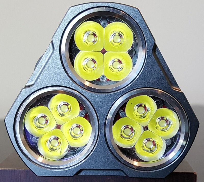

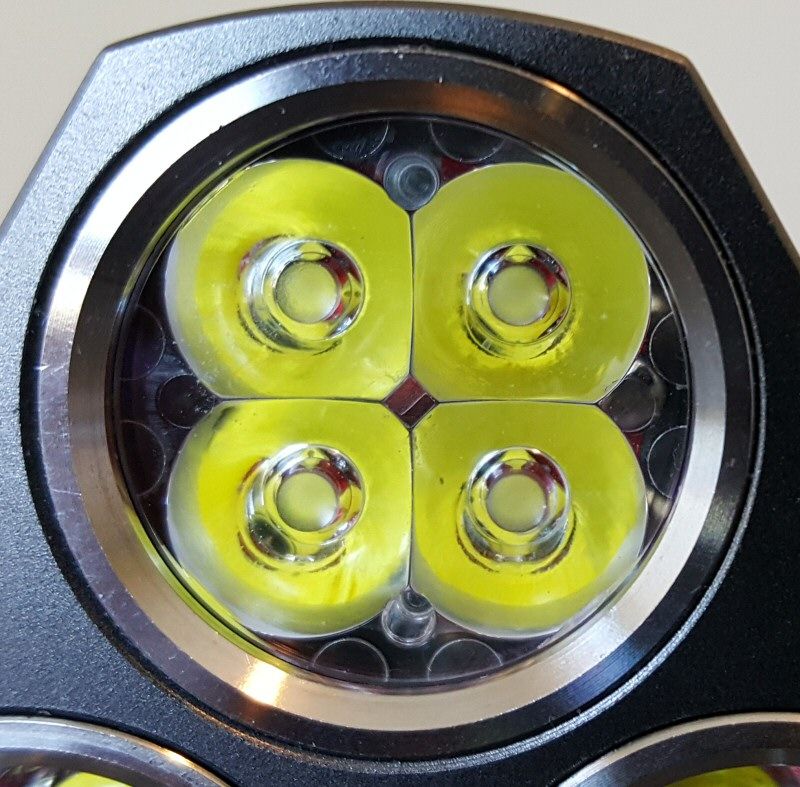

    The XP-G3 emitters are each in their own well, four per triangular head lobe, with a defined optic for each one. This should produce reasonably good flood. Scroll down for beamshots.

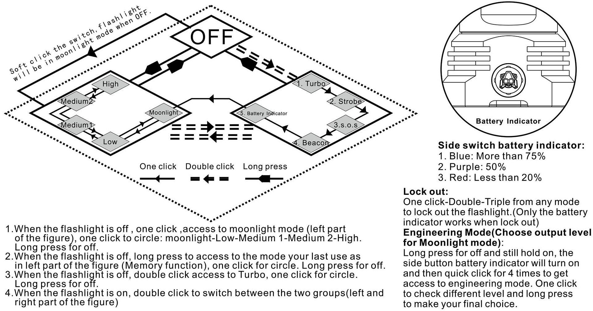

    Here is the programming map from Manker:
    In simple terms, click the electronic switch to the turn the light on, press-and-hold to turn off.
    When On, click the switch to cycle through the main output modes as follows: Moonlight > Low > Medium 1 > Medium 2 > Hi > Medium 2 > Medium 1 > Low > Moonlight, in a repeating loop (i.e., steps up in output, then down). There is mode memory, but you access it by a press-hold of the switch from Off. Otherwise, a single click will always activate on Moonlight.
    Turbo and the blinking modes are accessed by a double-click of the switch (from On or Off). First mode is Turbo. Single click to advance to Strobe, followed by SOS, then Beacon, then battery indicator (blue when >75%, purple when ~50%, and red when <25% remaining). There is no repeating loop for strobe modes, and a single click past battery indicator advances you to regular output modes (starting with Moonlight). Alternatively, double-click to return to standard outputs at any time (i.e., if you want to exit Turbo without cycling through the other modes).
    So, in essence, you can jump from Off to the lowest level (single click), Turbo (double-click) or last memorized (press-hold), as you prefer.
    You lock out the light electronically by doing a single click, followed by double-click, and then a triple-click. The light shuts off and the battery indicator activates. Exit by repeating this sequence.
    You can program the Moonlight mode to one of 10 levels (7 in practice, on my sample). From On, press and hold until the light shuts off and the battery indicator comes on. Now do a quick 4-times click of the switch. The light will activate in Moonlight. A single click will advance you through the 10 output choices repeatedly (but this includes three modes that were too faint to see on my sample – the emitters stayed dark). Note there was some flicker on the lowest two modes that did display on my sample. Scroll down for output mode level measures. Press-and-hold to make your choice and exit.

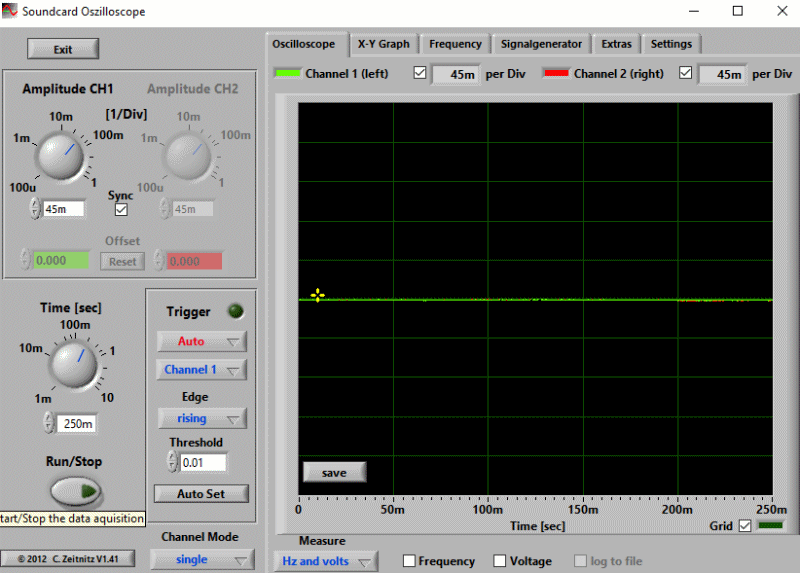

    PWM/Strobe
    There is no apparent sign of pulse width modulation (PWM) at any level. The light appears to be flat-stabilized, and is flicker-free at all output modes (except the two lowest programmable Moonlight modes, see my comments later in the review).

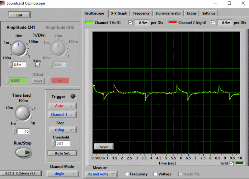

    Standby Drain
    Since the switch is electronic, there needs to be a standby current when the tailcap is connected. I measured this as 86uA. For three 3100mAh 18650 batteries in parallel, that would translate into over 12 years before the cells would be fully discharged – and so, is not a concern.
    Note that you can lock out the light by a simple twist of the head. I don't know if the electronic lock-out changes the standby drain (it may increase it, as it turns on the battery indicator).

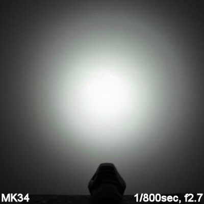

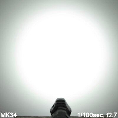

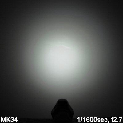

    For white-wall beamshots below, all lights are on Max output on an AW protected 18650 battery. Lights are about ~0.75 meter from a white wall (with the camera ~1.25 meters back from the wall). Automatic white balance on the camera to minimize tint differences.
    The MK34 is a flood light, although with a bit more of a hotspot than I was expecting (likely due to the use of optics). Overall tint is slightly neutral (i.e., creamy yellow-white). There is some tint shifting across the beam though, with a definite yellowing in the immediate corona, and some bluish-white shifting in the outer corona. While there are no artifacts per se, the hotspot seems somewhat irregularly shaped (i.e., it varies as you rotate the light).
    Note that there is a scratch on my wall - that is not an artifact in the beam.
    This is a lot of output for such a small size.

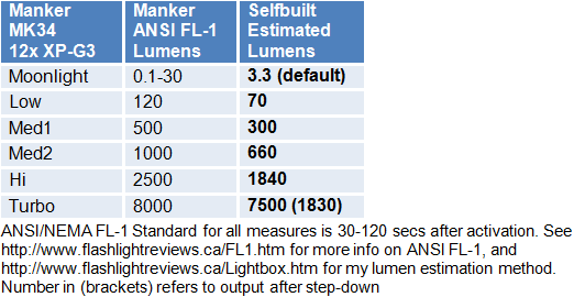

    It seems like my measures are relatively consistent with Manker specs, although consistently lower across the board. See runtimes below for more info.

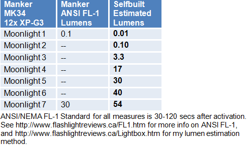

    As mentioned earlier, the moonlight mode is actually user-programmable.
    That is certainly quite a range of options to choose from. Note that the lowest 3 levels are dark on my sample, with no light detected (and so have not included above). I also detect some subtle flickering at the lowest two Moonlight output modes shown above – I suspect this is from the difficulty in maintain a stable constant current at these low drive levels.

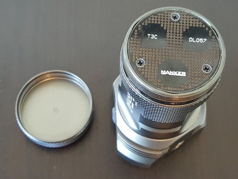

    Button-top 18650s (small or large) are required to make contact, and overly long batteries may be an issue for tightening the head. Also, only high-drain rated batteries should be used on Turbo (i.e. IMR, INR or other suitable hybrid cells).

    Tint comparison shot:
    Zebralight SC600w II L2 - Manker MK34 (Nichia 219b) - Nitecore TIP CRI - Zebralight SC63w
    All set to 10-20 lumens, camera manually set to 5800°K (~sun@noon)
    'I ought never to act except in such a way that I can also will that my maxim should become a universal law.'
